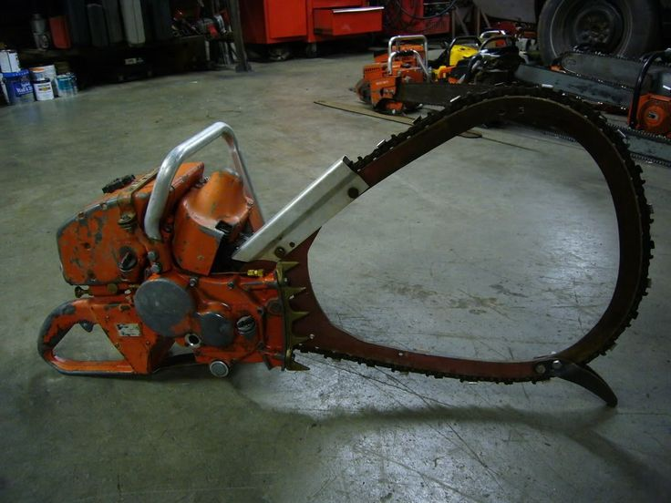

Ever see the bow type bars that guys used to run down south? They'd be useless for a lot of what I do, but I believe the marketing behind them was almost entirely aimed at your situation, cutting logs on the ground from a standing position.
Talk about a large kickback zone! Of course, any kickback force would be far less violet, due to reduced angular velocity around a larger radius. More of a "pushback" feel than the usual snap-action behavior you get off the upper quadrant of a small bar tip.
Back in the mid 1960's we had a McCulloch with a bow on it. Everyone says they are dangerous but we lived without injury and everyone I knew used one. Some had bar saws too but bows were very popular.
