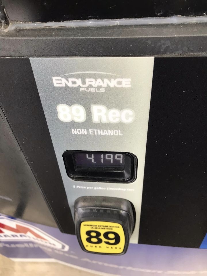

All I need is my Efree 89 and VPracing oil, good for 6 months for sure and have stored longer in boat and gen without ever a problem.
Ethanol 90 days and less and draws in moisture. Crap gas even needs special lines. Melts the old ones to a glob.
Why we see green lines in stihls when started changing over years ago.

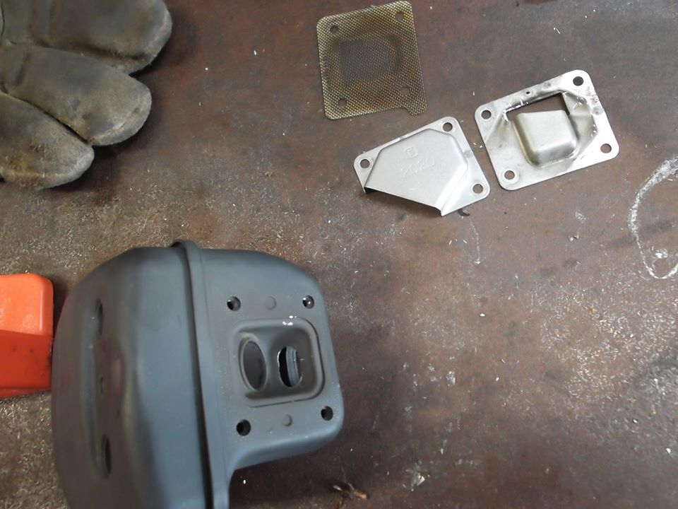

I cannot answer that as I modded it before I used it the first time. One of those people who cannot keep my fingers off any saw, even a new one. I will say, with the muffler mod, it has a nice exhaust note. Very deep.
It's still on 40-1 and will be for a few tanks of fuel before I switch it to 50-1. I like to make sure everything is 'bedded in' properly before going to the recommended ratio and I didn't touch the mixture needles though I did pull the limiter caps.

I tend to do every muffler no matter what, simply because the mufflers are the main choke point with any modern saw, especially Stihl's.

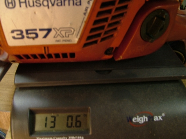

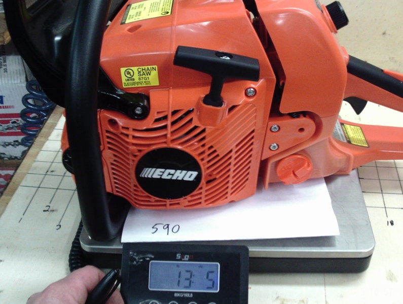

Years back some stock saws were tested by me and a friend.
2 were 357 and 590. 590 are grunt saws they have a long stroke. Look at that bore and stroke I posted.
620 should be ahead of both stock for stock imo.
16" round dry ash.
Husqvarna 357xp - 16.22
Echo cs590 - 16.37

Mine seems a bit heavier than that. I'll have to weigh it sometime. Is that just the powerhead and full of fuel or with a bar and chain included? Conversely, my ancient 028 feels much lighter.
So the 590 is a long stroke saw, that explains a lot about how it pulls a 20" bar in full cut ripping in a seasoned oak log. Never looked at the physical specs myself.
