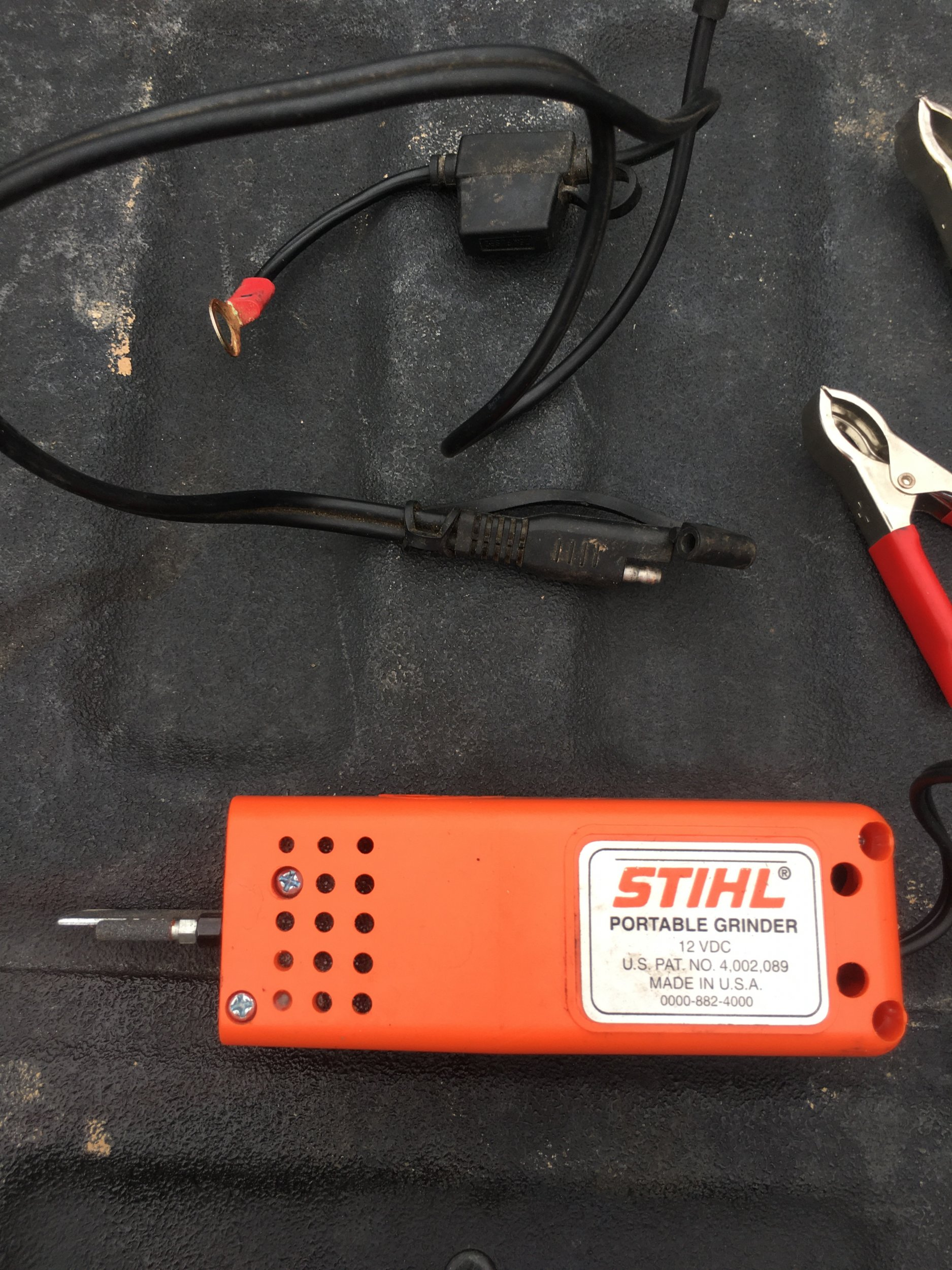

After abusing chain with dirt contact and using Dremel and rotary stone and hand files with poor success, I finally resorted to HF grinder..... BUT found instead of trying to adjust all the gizmos other then angle and depth of grind I let wheel drop and push "head" sideways to lightly contact tooth... Last chain I had to go around at lease twice as I dulled many of the points on the teeth and it took alot or material removal to get it cutting edge again...
See post #22....
There are times that I will have to remove close to half of the tooth to get the damaged area ground out of chains, but those are rare and most of the time not necessary.

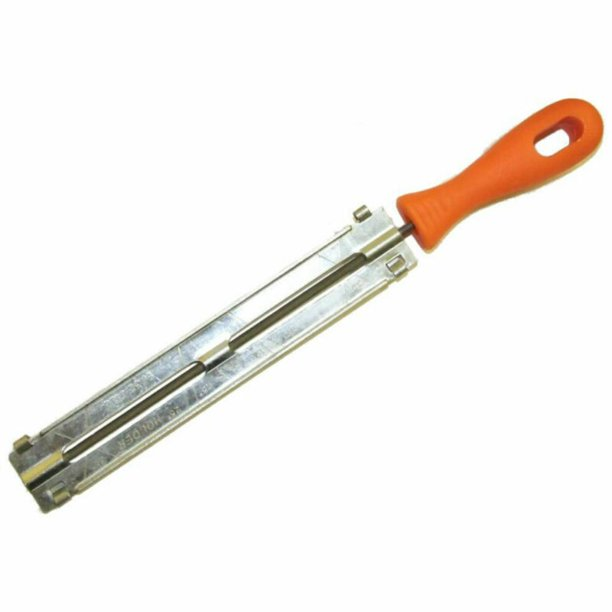

Definitely agree. I find this tool keeps my chains nice and sharp on a consistent basis. Only issue I have is that you have to buy a different tool for each size chain you have. Its too bad that you cannot interchange files with the frame housing. Still worth it IMO.
no big deal to have the correct size one in ea saws gearbag, the chinese are knocking these off now for ccomplete unit cheaper than pferd charge for a replacement raker file.
