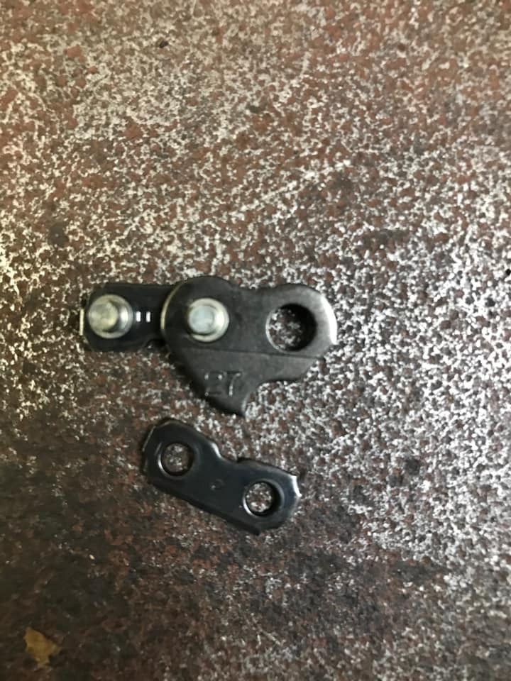

I make chain. Wasnt the rivets on 3/8 050.
What I seen was say a 050 drive link chain in stihl was 063 at top of drive link where goes together. A 050 chain in Oregon was 058 at top. So if you tried to use a oregon preset and tie strap on a stihl drive link it would be to tight to move.
Two different things. The tie straps come designed to fit .050 .058, and .063 drive thickness chain. Stihl traditionally always used .063. The issue was the diameter of the rivet on the Oregon tie strap wouldn't fit into the hole on the Stihl chain drive link.
If you reamed the holes in the Stihl Drive links the Oregon tie straps would work. Not saying it is a good idea.
Told you what I saw on 3/8 050 chain. Stihl and Oregon.
Never seen your issue you been TOLD on 3/8 050 here.
Do you even take chains apart or make chains or just rely on dealer info they tell you?
Guess I could pull both out again and check. But not feeling the need.
I know what works for me.
/ Tough on Husky chains today... ? #20
Only time I ran into something like you describe was on .404 chains. Both Oregon of different series.
Guy brought some 404 for me to shorten for him. He brought his own presets. They were wrong for the oregon series chain he had. Rivet are was way to small and wallow in drive link.
Here is right preset I had for use on the 404.
