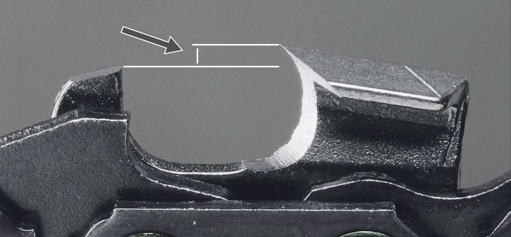

Straight from a husky.
The height difference between the position of the depth gauge and the tip of the tooth (depth gauge clearance) determines how much the cutting tooth will cut. It works much like a plane. When a plane is set up with minimal cutting blades, it cuts a very small amount of wood. The same thing happens with the saw chain if the distance between the depth gauge clearance lip and the tip of the tooth is too small. Also, it’s never good if the depth gauge clearance lip has been filed down too much. This will make the cutting tooth cut too deeply into the wood. The cut will then be more aggressive with high vibrations as a result. The risk of kickback increases and the chainsaw is exposed to unnecessary stress.

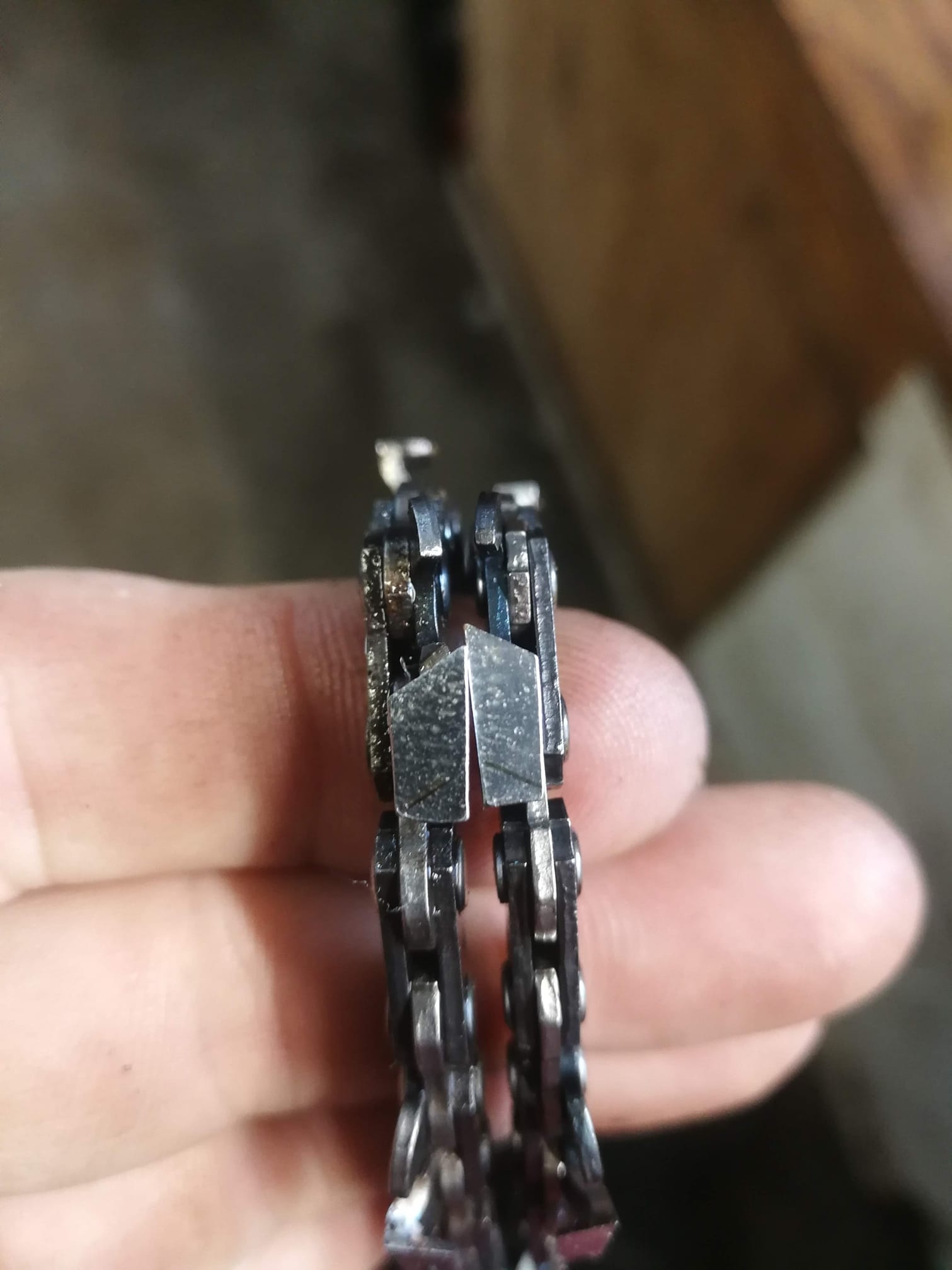

I heat with firewood and cut mostly Hickory with some occasional oak, locust, and white ash mixed in. I've found that I usually break a tooth off before I get down to the indicator marks on the top plates, but that really depends on the saw. 45-50cc saws not so much, but 60cc saws with .325 chain yes. Once I break a tooth, the chain goes in the trash. When it starts getting "close" I set it aside for stump'n.
I've used hand files, dremels, and carbide burs to sharpen my chains over the years. When I hand file, I use the guides like the OP has. If I don't I've found that I have a tendency to let the file go a little too deep. It produces a really sharp edge, but the edge dulls pretty quick. Those guides ride on the top plate and keep me from making that mistake.

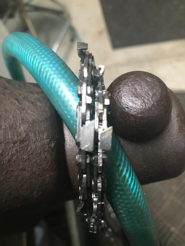

You touch more saws and chain that probably any of us, so you definitely have better methods worked out from sheer repetition. But for a DIY'er / home user, I'm cutting a crap-ton of wood, 10-20 cords per year. This makes my time a big factor in each step of the operation.
So, excepting some very rare case of one tooth somehow way shorter than the rest, I simply eyeball the shortest cutter I can find (quickly check with dial calipers) when setting up a chain on the grinder. Then I set the grinder to that tooth, and just knock all of them back to that same length. I find that faster than re-adjusting the grinder for a few teeth that are of different length than the rest.
If there were a chain where just one or two that are way shorter than the rest, I guess I'd do them individually, but otherwise I find it faster to just set all the same.

See if I did that on some of these guys chains that would take a basically newer chain and take it back at least a 1/3 of it's life. Not worth it to do that to their chain.
Then you have several passes so not to over heat cutters with a big bite.
You just want to kiss the cutters.
Can have most chains done on grinder with adjustments, with rakers done in 10min range give or take so isnt really a time thing IMHO.
Not going to waste a guys chain like that being lazy IMHO.
Most chains I would say 90% are the normal way. Start with shortest and rest right there with it. Do all the same.

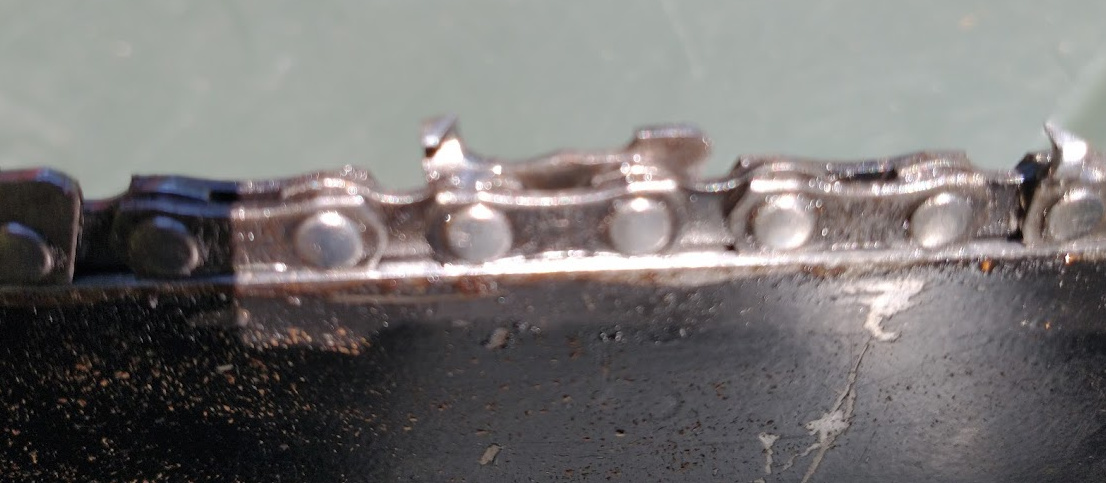

All the chains that I use have a scribe line on them, When the cutter gets to that line I toss it. Cutters breaking off chain is not something I want to be around.
   / When is a Chain at End of Life #30
I used to live by the file it down until there’s teeth broken off or looks like a triangle. Then I cut into a rock that the tree grew around and carried with. Tooth didn’t break off it straightened out and the next time it came around kicked back so hard the handle got broken off and I got 18 stitches, 9 in 9 out across my knee. So now I live by the 1/3 of tooth left is scrap metal.
