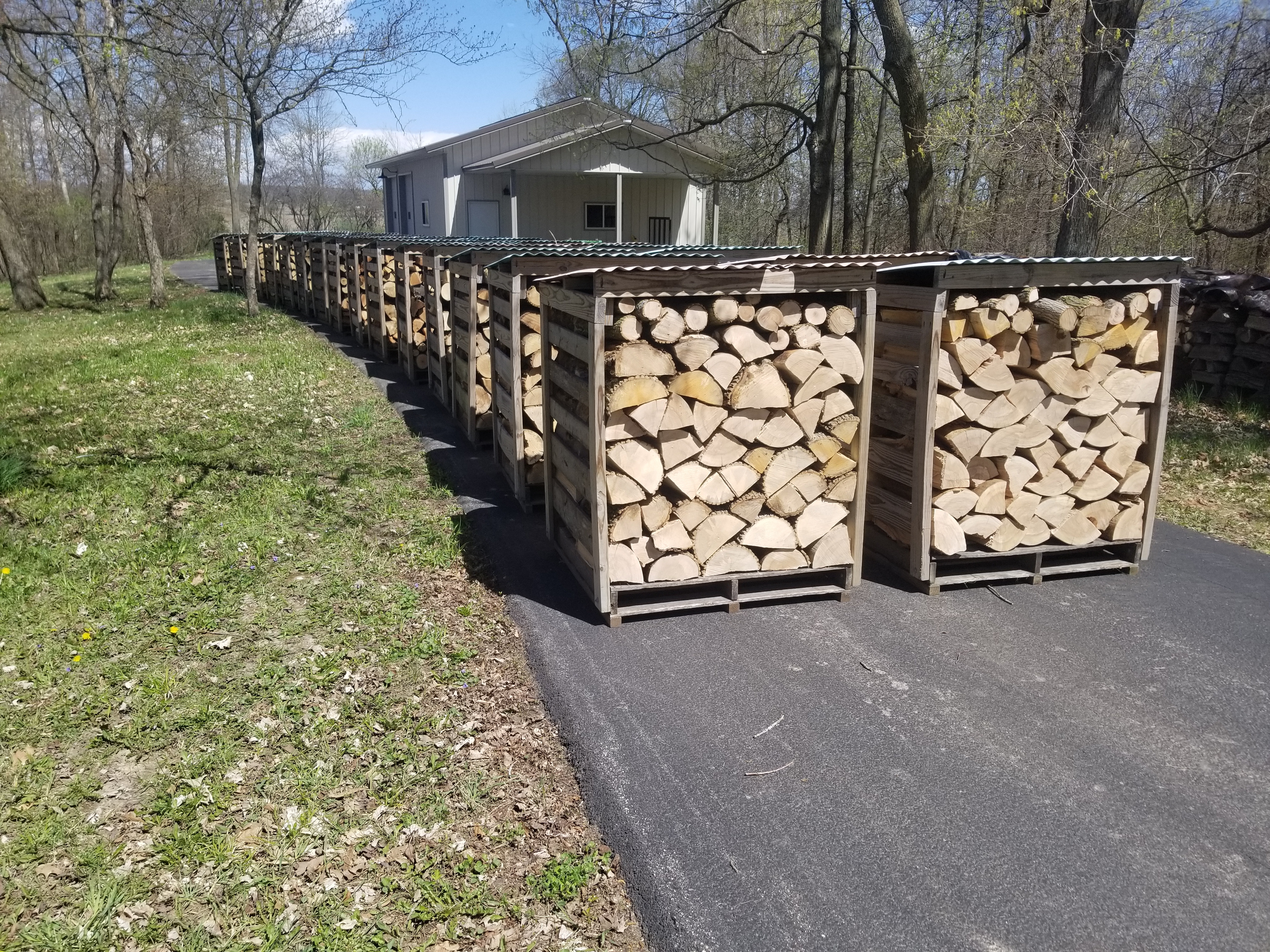

I burn 8 cords/yr. Running a hot saw with a sharp chain brings me back to when I was a kid and could handle a screaming 2 stroke motocross bike. I'd kill myself on a moto bike now but feeling those big chips smack my legs make me  feel like a kid again. I'll quit when I cant start the saw!

If I could redo my wood management system today, it would look like yours. Good job!
I arrived at was probably the most efficient system that could be had, based on the equipment I owned at the time, namely a tractor without pallet forks. But a heavier tractor with pallet forks really changes up the available options!

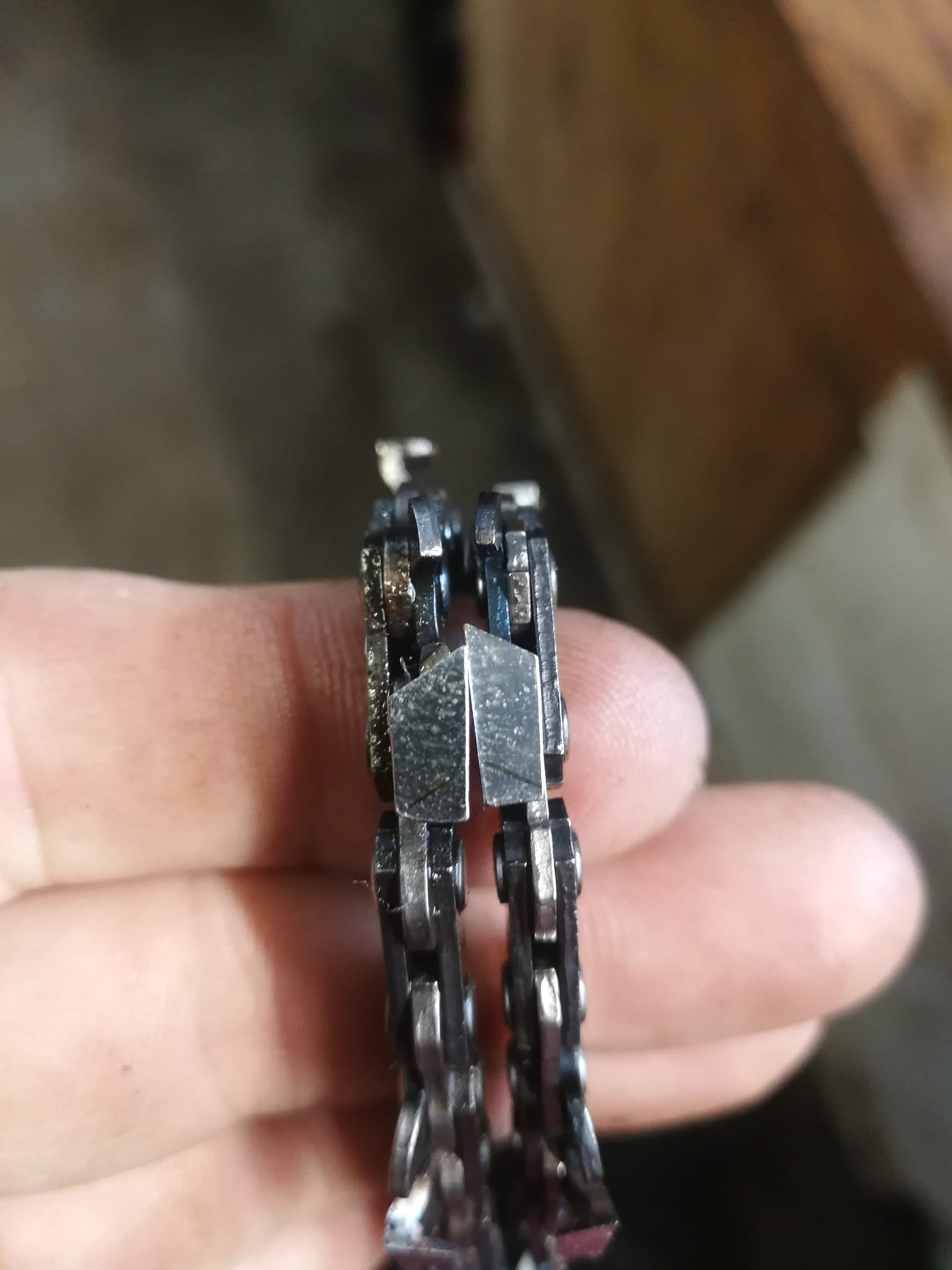

The sthil chains I buy have markings on the top of the cutters.
These slash marks are a visual for the angle for sharpening, and a don't sharpen past that point or the chain becomes cut into point of weaknes.
I throw my chains away once I get close to that slash mark.

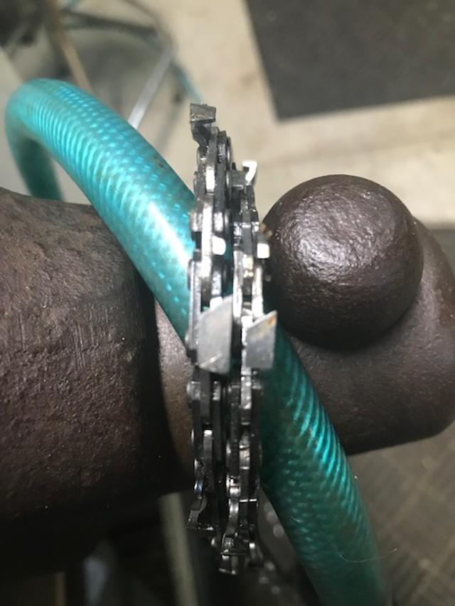

Lot of chains have those witness line and reason for them.
3 stihl and 1 husky chain in pics.
