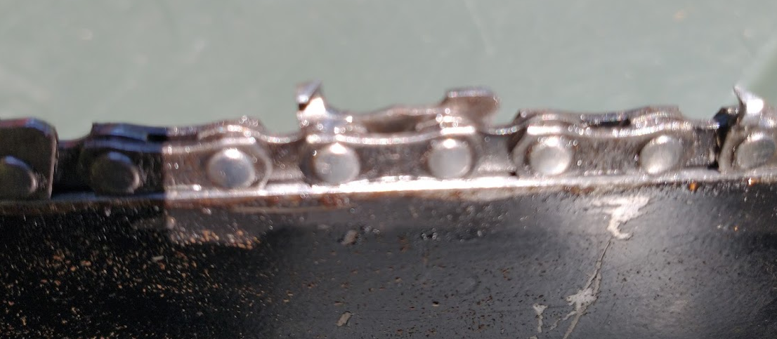

I run them til they start breaking off.
I did that_once. A tooth broke off in an oak tree I was cutting; it grabbed and suddenly stopped the Stihl motor, shearing the flywheel key. The repair shop said I was lucky the crankshaft didn't break. For the price of having the motor repaired, I could've bought several chains.
   / When is a Chain at End of Life #52

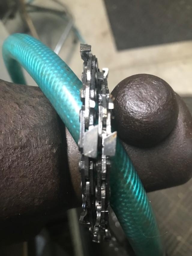

Lot of chains have those witness line and reason for them.
3 stihl and 1 husky chain in pics.
Learn something new daily it seems! I just went and looked at my chains in the garage 12/16/&18" length, Oregon chains and no markings on them. I will be sure to look at any future chains I might buy - but Oregon chain seems common and has served me well for many years. Although it kind of looks as if I might have sharpened up to - or past - the designated stop point! Guess I might have gotten the life that the chain offered!

About here
