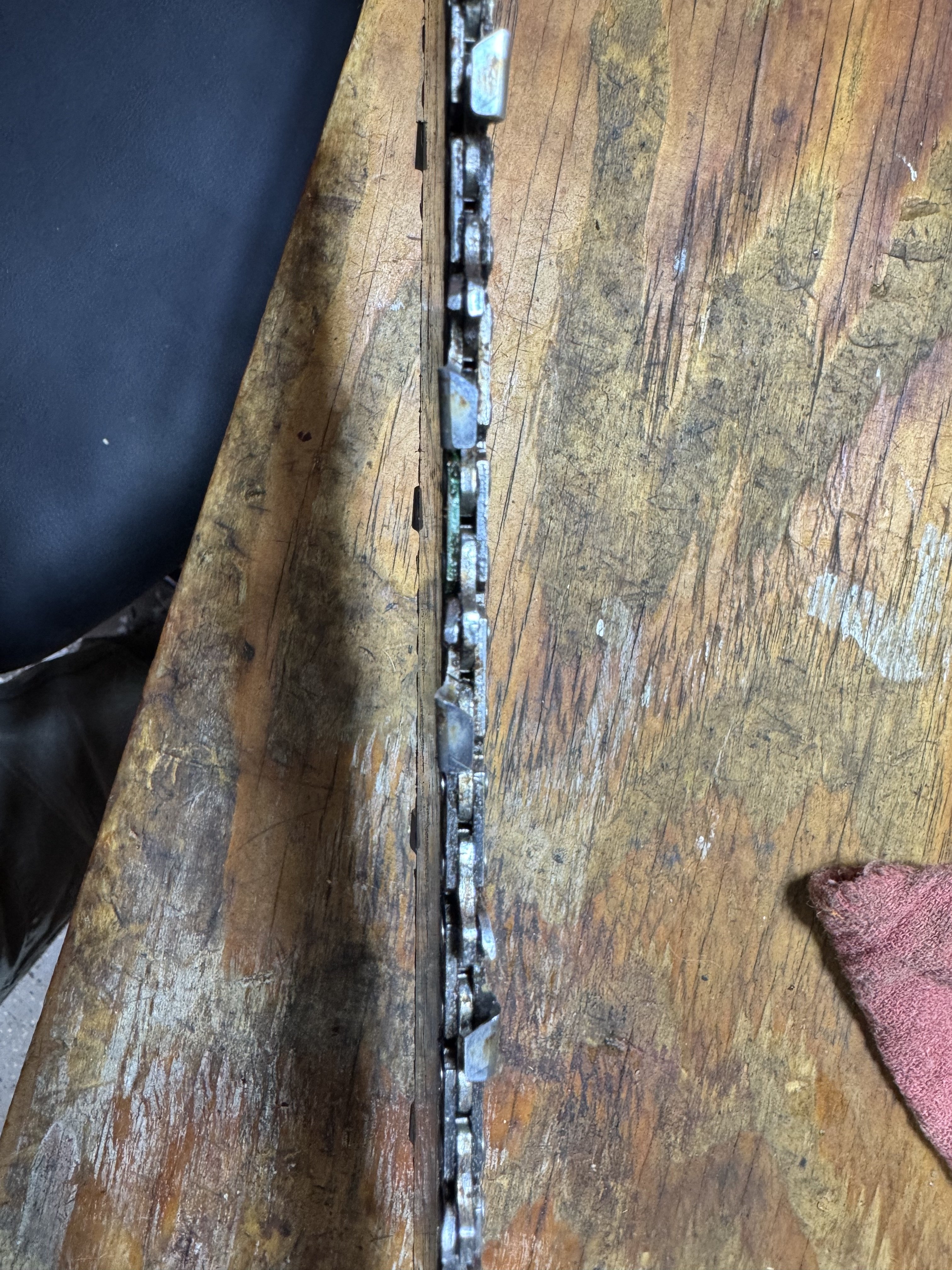

90% of my woodcutting is on my property and a 2 minute drive from my shop. When I sharpen where I cut wood I sharpen it on my car trailer with a wood deck. I just press down and let the chain dig into the wood a little, it’s pretty steady. I do the same on the workbench in my shop. I can see the problem with this being the saw is nose down and harder to get the angles correct.
/ Chain sharpening difference? #105
Nose up or nose down should not be much of a problem as long as the guide you are using is making proper contact with the tooth and the depth gauge. If the saw rocks side to side as you are filing, that can cause the same problem I mentioned as someone lowering the handle of the file as they make the stroke.

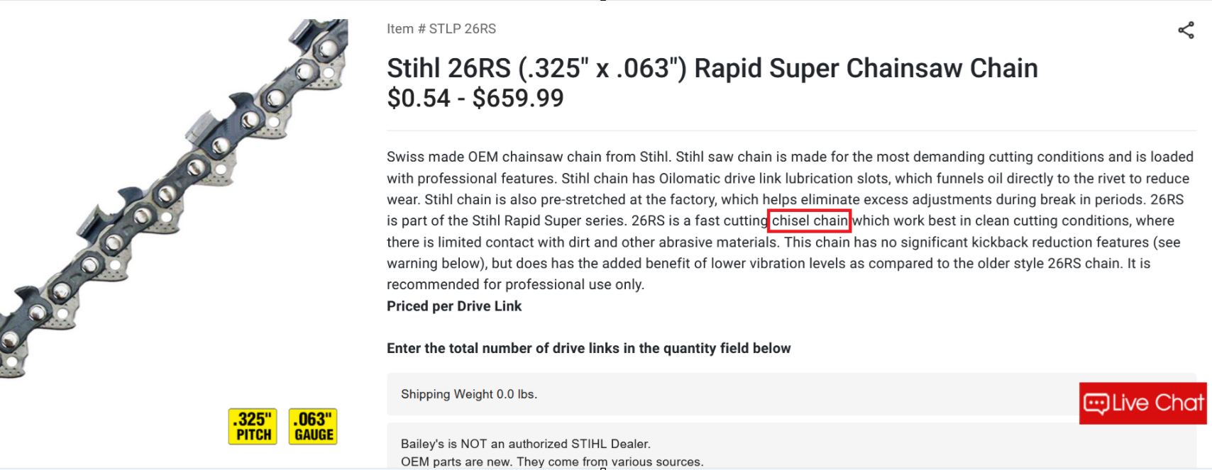

What be interesting for some of you to try is square ground chisel. @John_Mc if I remember right you've tried it correct?
/ Chain sharpening difference? #107

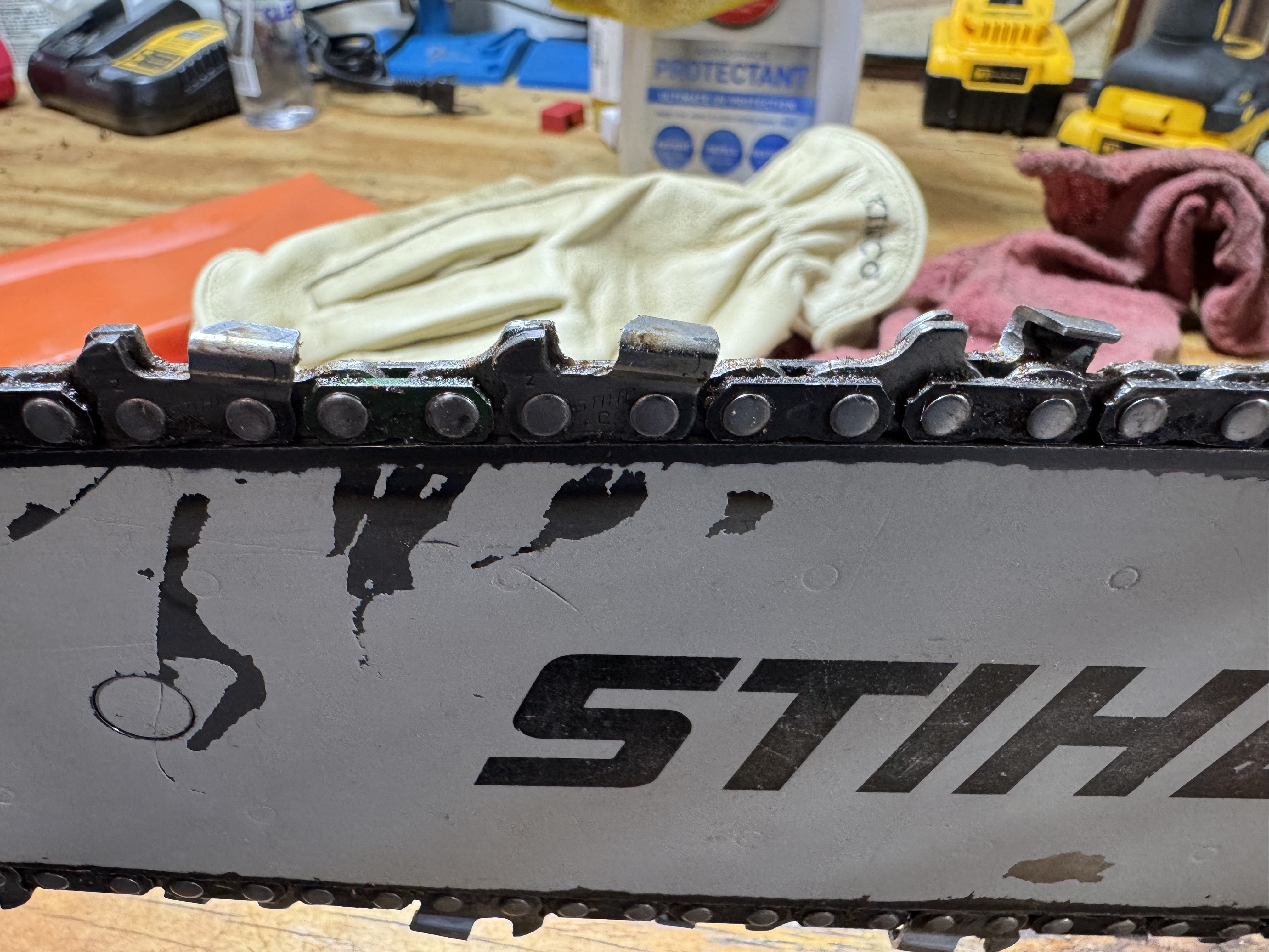

re: filing down the drag sections. I filed one chain down too much. It cut very aggresively and made big chips; then suddenly it locked up. Pulled the bar out of the cut and every other tooth was missing.
I went back to the garage to get a new chain, then I discovered the saw motor had a very stout kickback when pulling the rope.
That saw stopped so suddenly it sheared the flywheel key!
Moral to my story_follow sharpening directions.
/ Chain sharpening difference? #108
Been my experience that it doesn't cut any faster than round ground full chisel chain, but does have less vibration.
/ Chain sharpening difference? #109
I've tried it, but not a lot. It did cut faster than round-filed chisel chain. Not overwhelmingly so, but it was certainly noticeable. It also seemed to hold up well.
It's really touchy to get sharpened correctly, and my eyesight just isn't good enough to do it, so I never bothered to learn to do it myself.
I enjoy hand-filing. If someone made a jig that was as easy to use for accurate sharpening in the woods, I'd probably switch to it. (I enjoy hand filing, and the break it provides while working, rather than carrying multiple chains.)

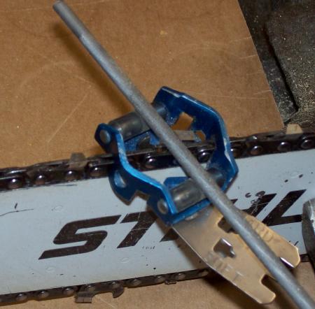

I did read all 12 pages of this thread, lots of great information !
Have a friend that is very good at hand filing he just sets the saw down on a tailgate or workbench, holds the file with one hand and holds the bar with the other hand.
One thing I did learn from watching him was I had been applying to much pressure to the file and chain.
My preferred sharpening tool happens to be a Husqvarna roller file guide. Then occasionally take the chain to dealer and pay to have it sharpened on their very expensive machine.
