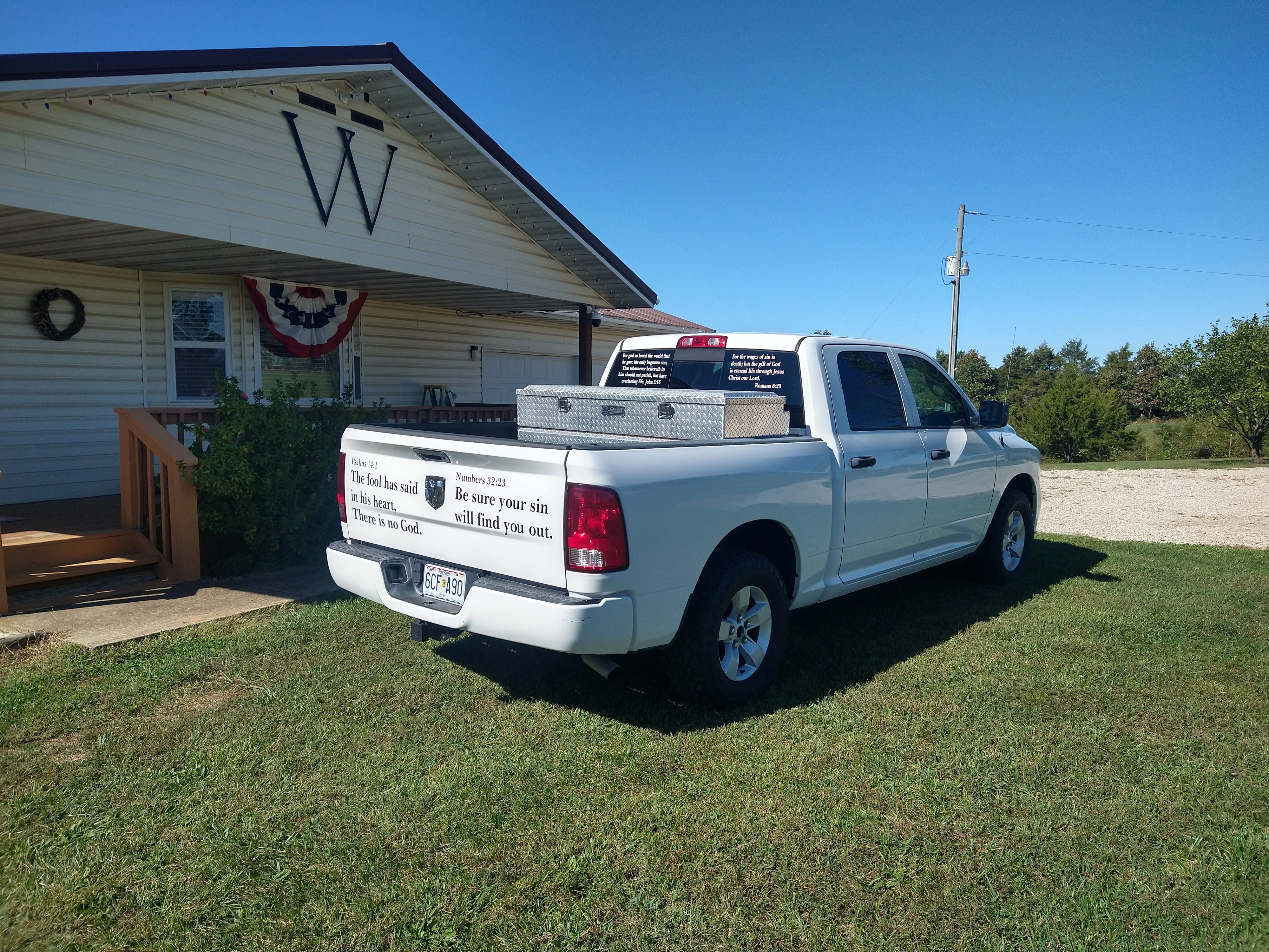

I bought this 2018 1500 back in October of '21, not much to choose from back then, but it's mine now!
I was planning on doing a few things to it when I got it, but ended up finding this current place 2 weeks later, and moved from Arizona ... Just one thing after another ...

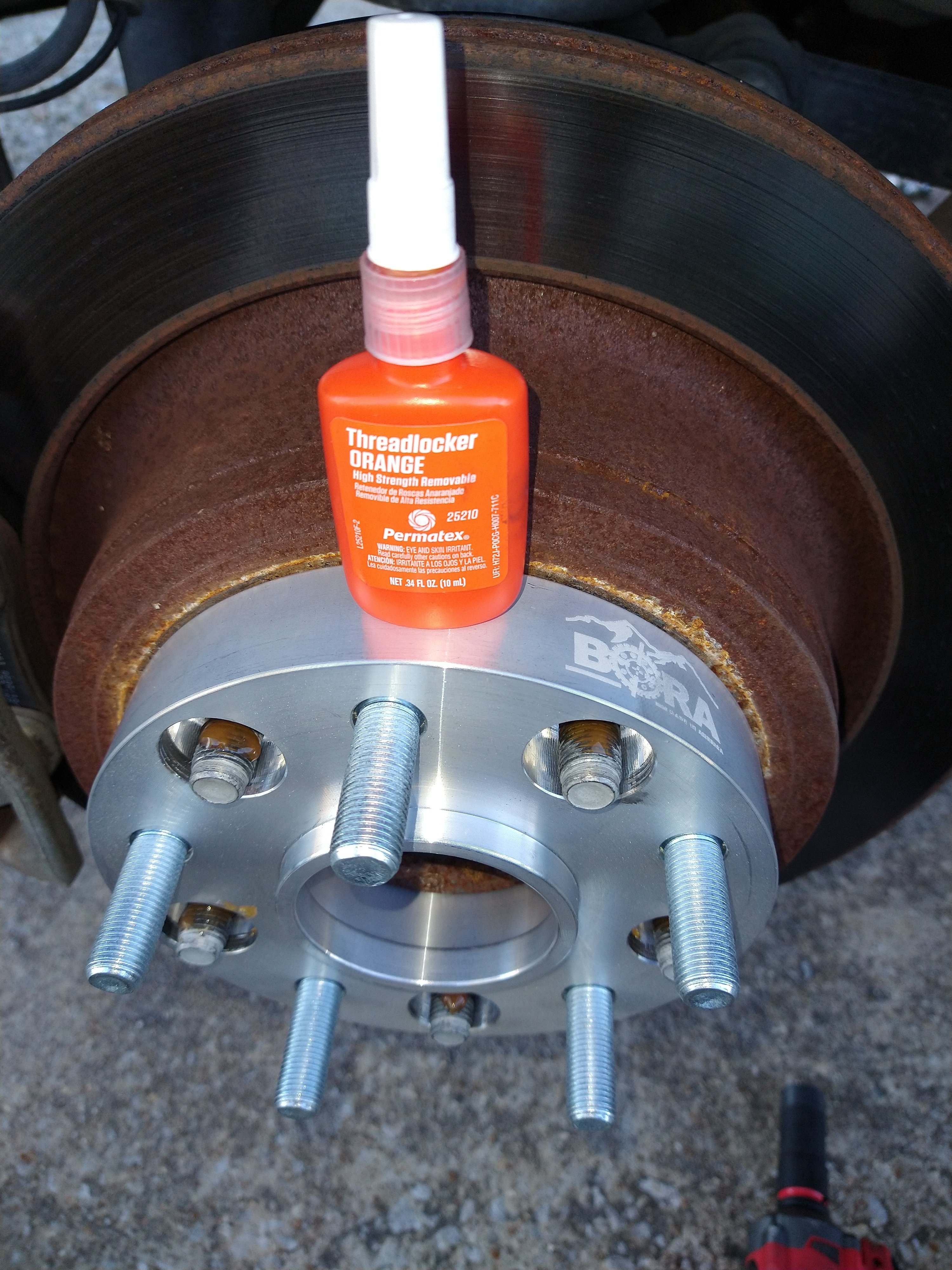

Yesterday I got it up on 4 jack stands and removed the tires, scrubbed them, after they dried I applied a tire dressing that is supposed to reduce ozone degradation, I did both the inside and outside, I'm a long distance truck driver and leave my pickup at my company's terminal for weeks on end (I don't really go for the shiny tire look!)... Then started on a long overdue brake fluid flush ...
Unfortunately I only got one wheel done before running out of the quart! (Since I already had it in the air, and more things to do with the wheels off, I decided to get back to it later!)
Then I added 1.25" wheel spacers so I have the option of putting chains on ... Used the Orange thread locker, the gel doesn't go very far!
This morning I started on adding a 2" front leveling kit ... I was looking for a small lift "kit" but generally they start at 4" and I didn't want that much ... So I got the leveling kit, plus found a 1.5" rear lift ... I want to keep the almost stock "rake" with the tail higher than the front when empty.
Since I added wheel spacers, I decided to install small smooth fender flares.
When I got the truck it had black plastic wheel covers, I lost one, so I took off the other one on that side, so that side would match, but really don't like the look of the factory aluminum rims, and I liked the black and white theme I had going on, so I had to buy a four pack, didn't realize that they are a dull faded black, but they are on one side, I have the shiny black ones which I like better on the other side ... Then I rotated the tires since they were already off ...
I'm glad I didn't go with a 4" lift, this is plenty tall enough for me, probably will add a set of gramps steps!
Now I have room for chains!

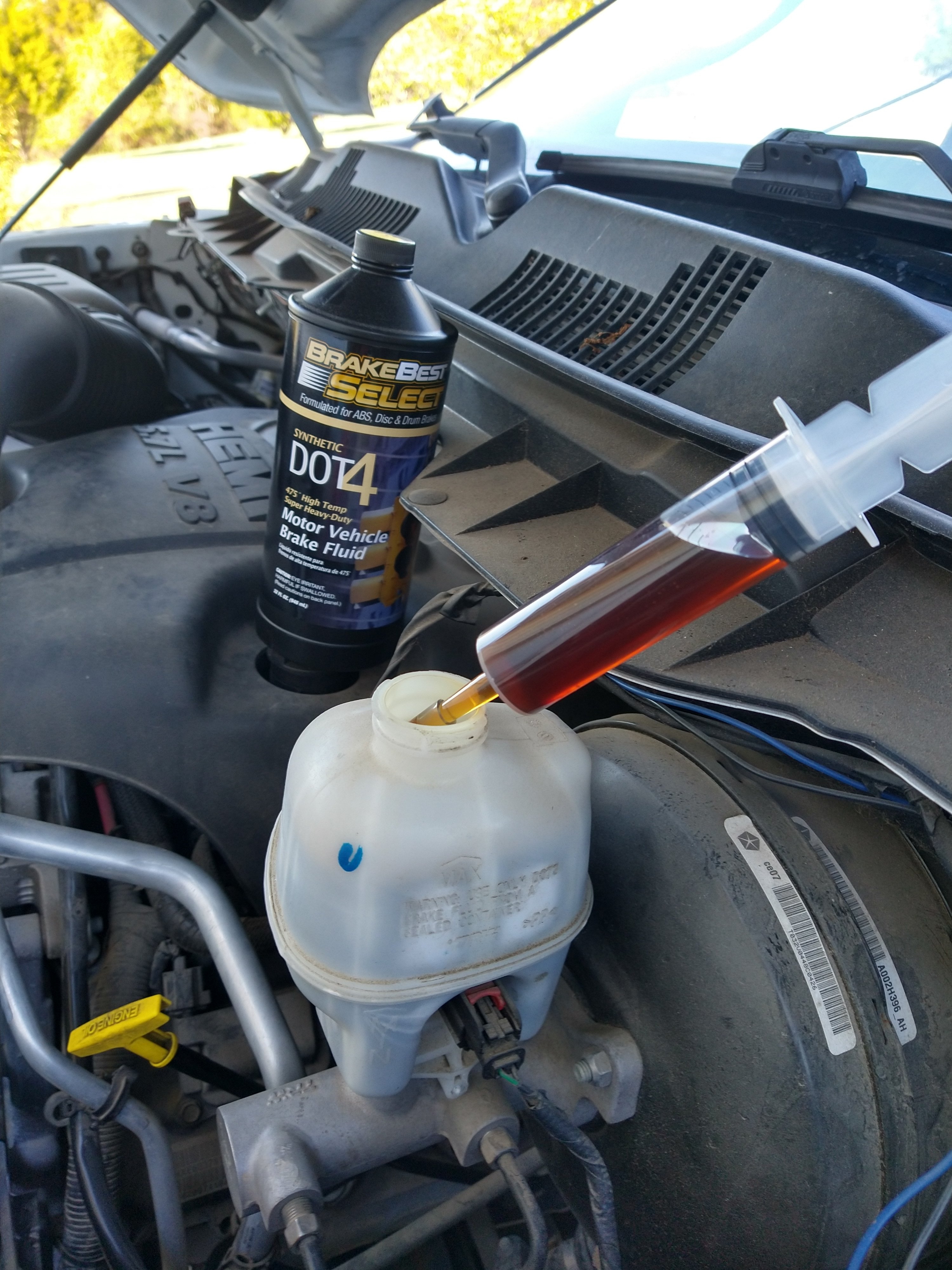

I have a dentist appointment in the morning, so I'll pick up a couple more quarts of brake fluid and finish that job tomorrow ...

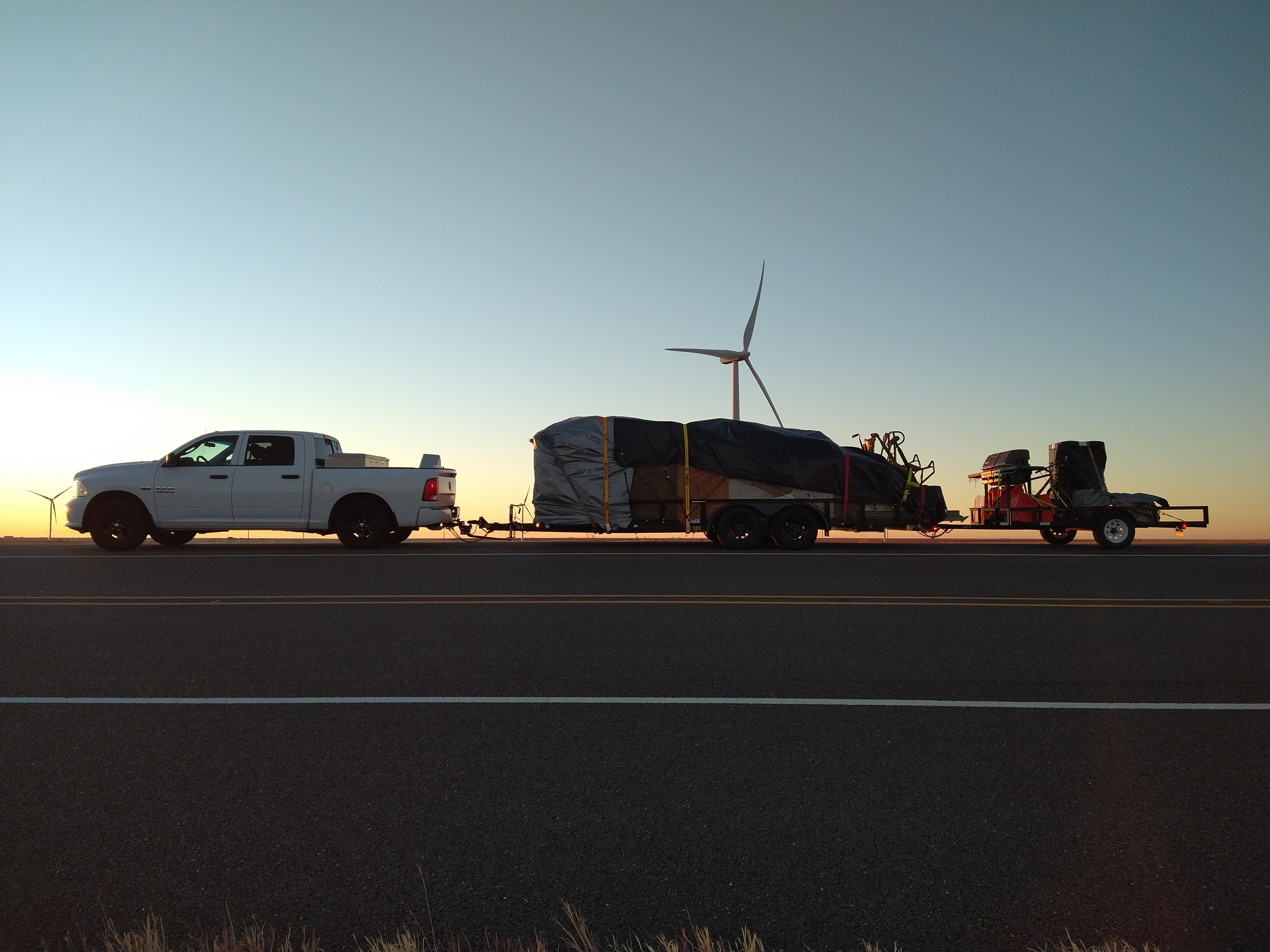

Yeah, this has been a good truck it's 4X4 with the Hemi ... Wish it had a longer bed, and a manual transmission ... Couldn't find a 3/4 ton back then, but I make do with this.
I only drive it about 1000 miles a year now, it was " high mileage" when I bought ... 86K now has 94K, but when I lived in Arizona I put a bunch of miles on it going to Tucson, and my job was 108 miles away (same trucking company) I used it to move here in Missouri, and made a trip to Charlotte, NC for my father's funeral ... But normally it just driven 30 miles to work and parked until I get back, once I home I rarely go anywhere, I have too much to do here ...
Was WAY overloaded on my move, had plenty of motor and brakes, but suspension was over taxed!
I got the new transmission oil pan with filter and fluid, but need to change it, and flush out the coolant too ...

I got a late start today, had a 08:00 dentist appointment, got there 10 minutes early to do paperwork as it's a new dentist that took over my old dentists patients who just retired ... Left there at 09:45! For a cleaning! Stopped at O'Reilly's and got brake fluid and concentrated coolant, plus some coolant flush ... then to grocery store for distilled water ... Got started on truck at 11:00!!!
Drained fluid, filled with well water, drained that, three times ... Added flush, topped up with water, drained that ... Filled and flushed with water three more times!
The last water fill I decided to try my new Schwaben coolant fill tool ... I got it mostly because I believe that my cabbed tractors heater core is actually in the roof, but I'm not sure about that ... Anyways it uses compressed air to create a vacuum to draw in the coolant, much faster, and eliminates air bubbles and "burping" ... The first six times took quite awhile, as it took awhile to get it through the heater core on my pickup ...
Then I added the coolant, RAM say original is good for 10 years, it's 7.5 years old, time to change it!
Then I got to finishing the brake flush, ran 2 more quarts through ... Nice and firm pedal now too! 😀
