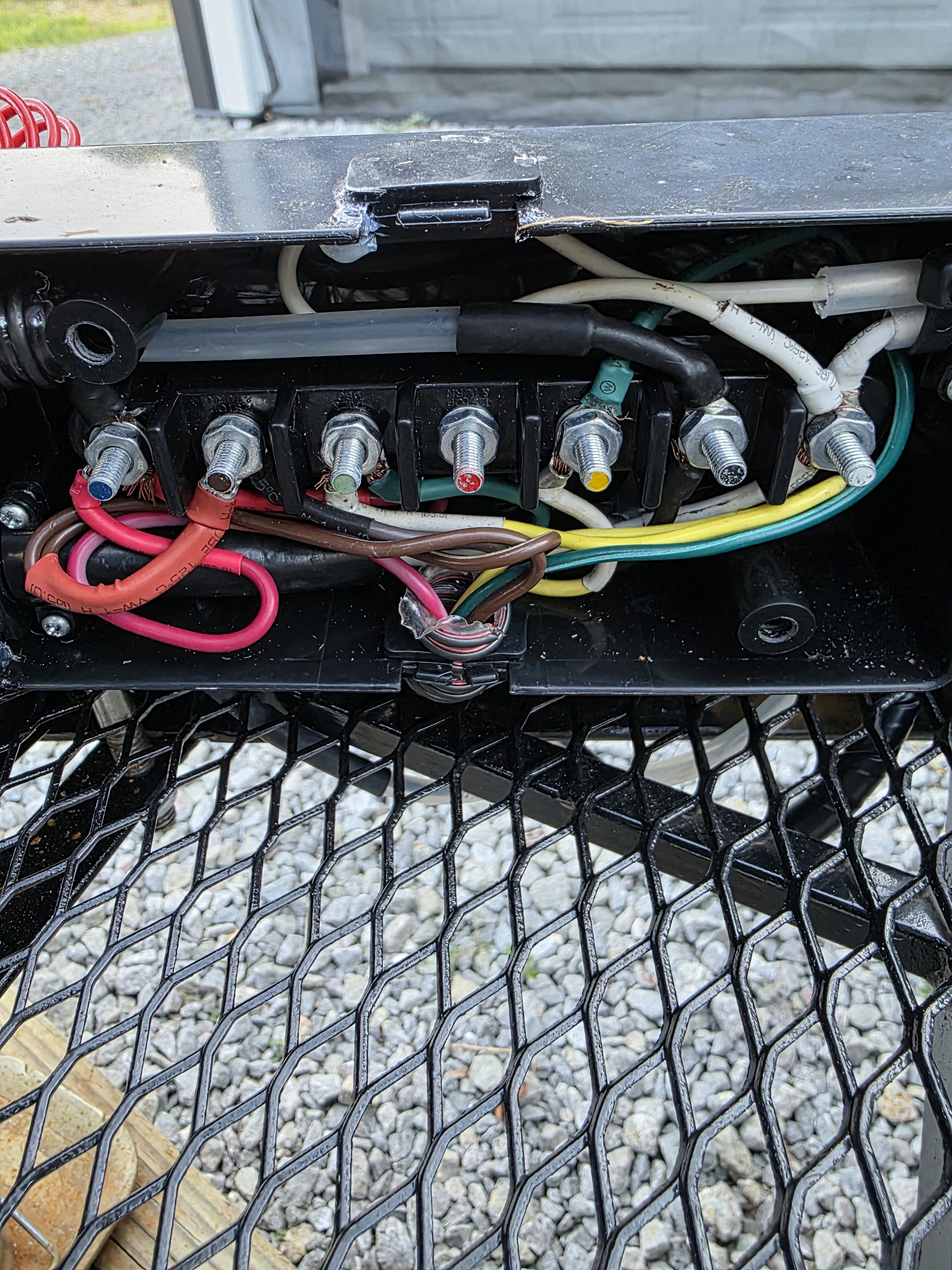

Since I found the loose locking screw and tightened it, everything has been fine.

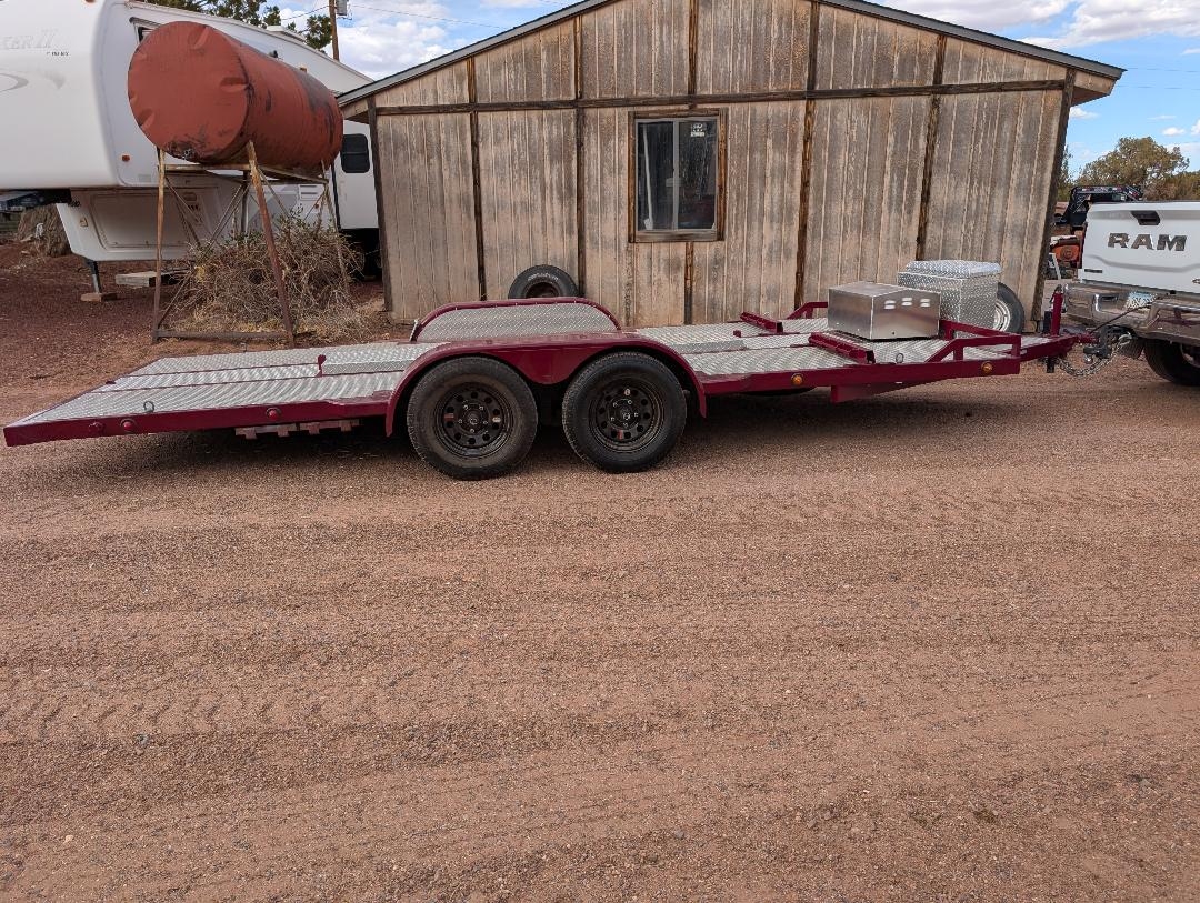

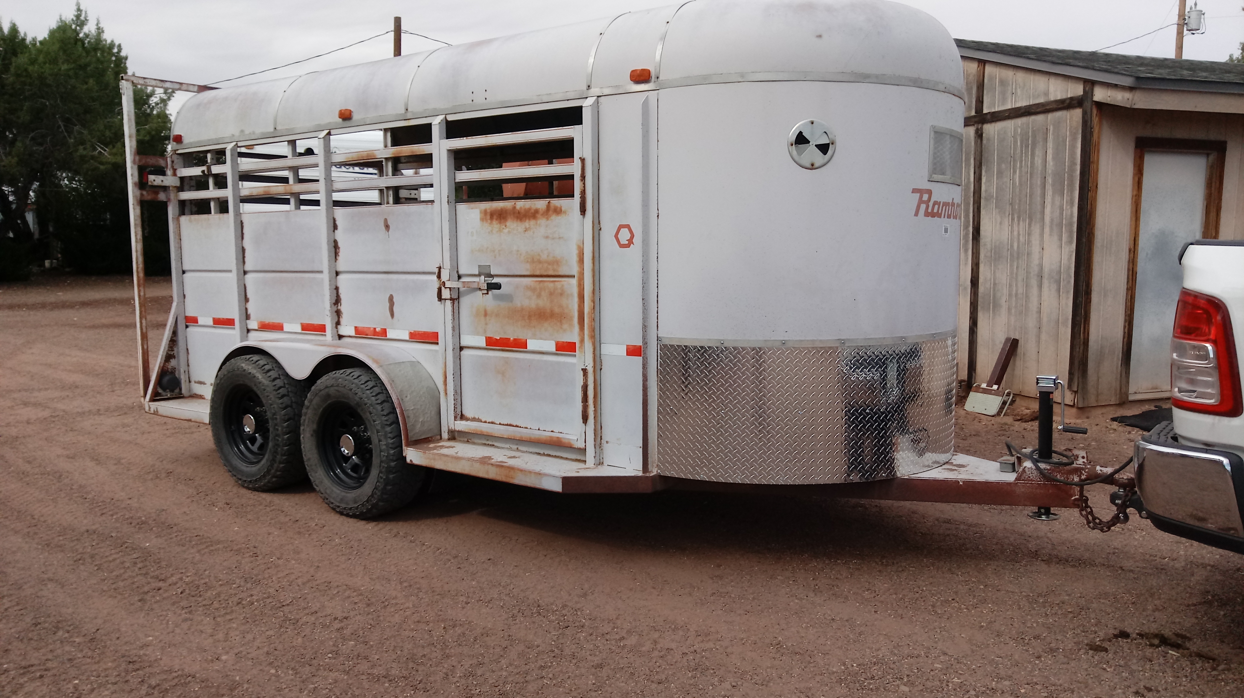

A gooseneck is not always the answer, bumper pulls have there place.
View attachment 4124639View attachment 4124641
Okay, I give up. After thinking about it for days I still can't see how those two trailers would somehow be less useful if they were goosenecks.
I have a little bumper pull flatbed similar to yours, never use it. Okay, three times in 15 years, but the gooseneck version gets lots of miles on it.

I don't see how my deckover power tilt would be any better as a gooseneck.

I like my bumper pull trailers way more than a gooseneck. They’re way easier to hook up for the main reason. I can’t load the bed for the second reason.

I only ever pulled a goosenecks with a flatbed. With my Ram, I could secure it by leaning over. My FL70, I still had to climb up. When I sold a gooseneck horse trailer to a man who's dually had a box, I watched him climb/crawl in to secure it. Not for me.

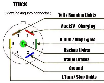

I believe that randomly, that wire anchoring screw would jump into the right spot where the brake connection wire is and ground out with the terminal next to it and cause the brakes to lock. Could this have been the reason the brakes locked?
All of my electric brakes are activated by positive voltage. If your wiring is like these the reverse lights and right turn signal could be a source for voltage due to a short by a fastener large enough to bridge the gap between the two.
If you are actually providing the ground to the brakes to activate them, I might rewire both ends so the brake is not right beside the ground terminal.
