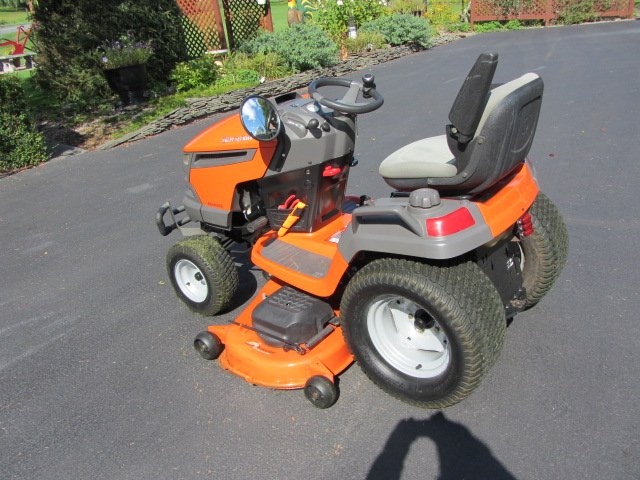

I'll just mention ... It will be a sad day when the Husky 2354 finally wears out.
What's to wear out? My 1963'ish Cub Cadet 123 was still running and mowing fine, when I sold it to make room in the barn for other toys, a few years ago. I did replace all of the HST control linkage and the seat cover around 2015, and did a valve guide job on the engine a few years after that. But other than that and maintenance items, it was all original.
I still occasionally mow with my 1971 (or 73?) Toro, as well. Started on the second pull after more than 2 years in storage, just a few weeks ago, and ran fine. It's easy to never die, when the performance was so low and non-optimized from the start. :D The thing probably has compression no higher than the blow pipe pressure of an ashmatic life-long smoker at age 80... but it runs!
By that token, I'd guess that little Husky could have another 50 years of life in it.
