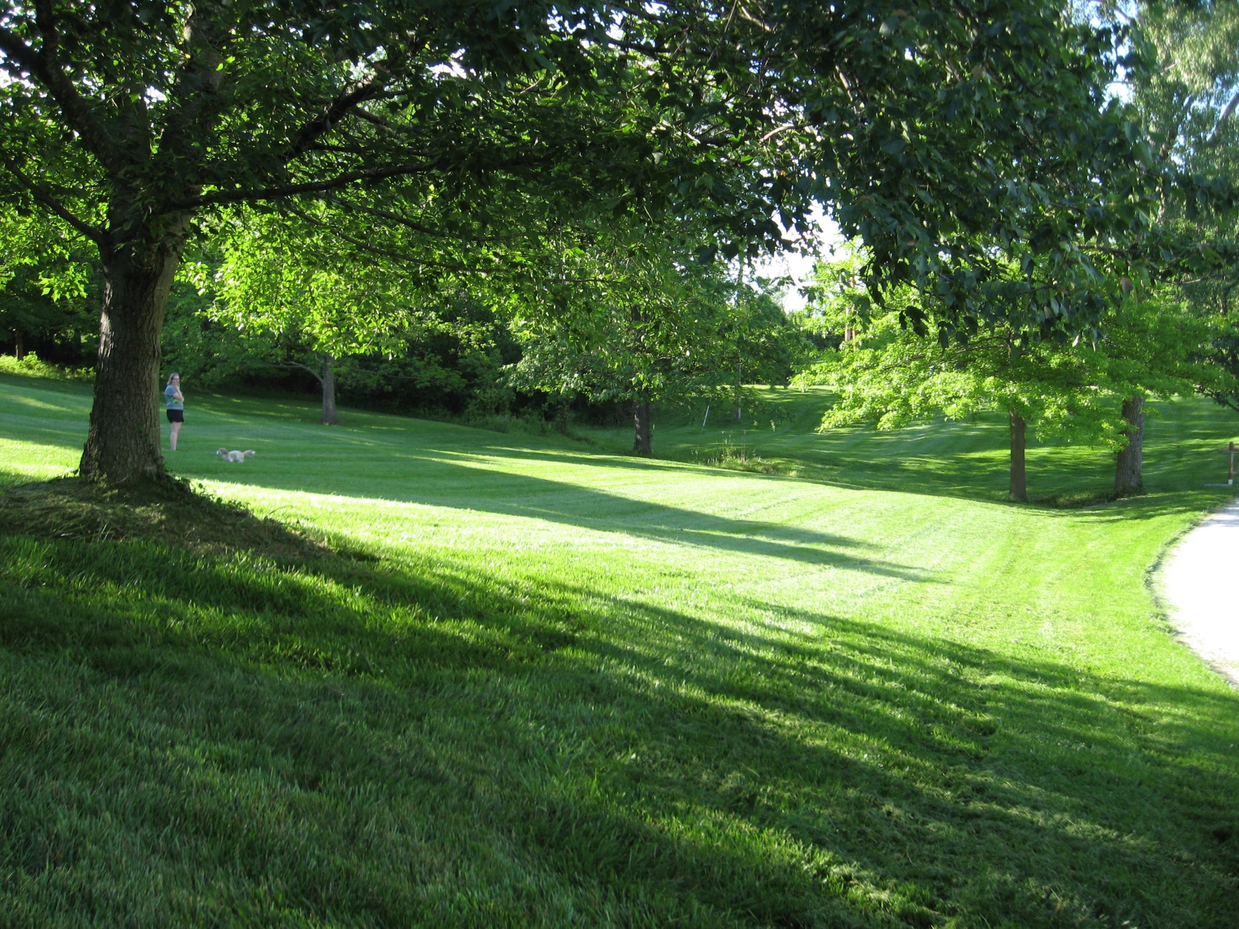

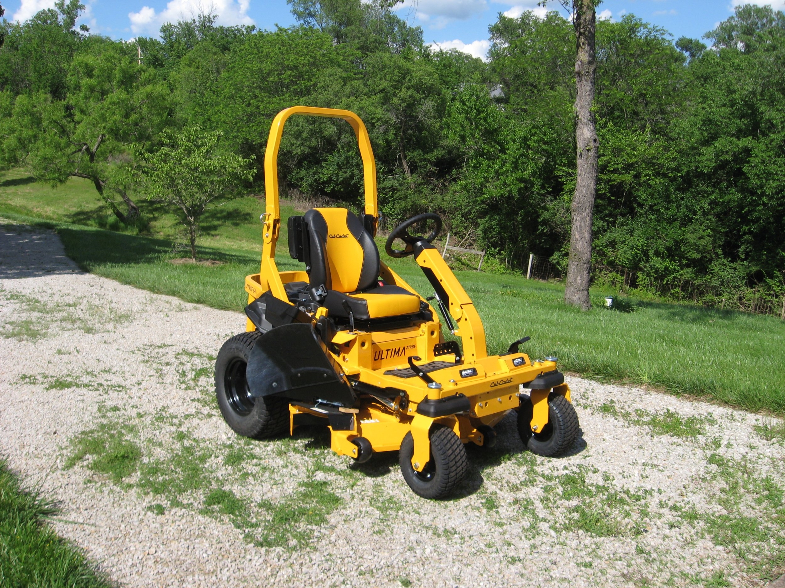

Pulled the trigger on a new 2024 Cub Cadet Ultima ZTXS5 54. This thread will be to document my experience in this journey. Everything about this machine, including the buying process is completely different from anything I've done before.
First, a little background on my needs. I have a 6 acre property, of which about 2 acres is finish mowed and the other 4 is pasture, with some wooded areas thrown in. The property is very hilly and rough, with lots of trees, buildings, terraces, driveways, etc., to mow around, including a small orchard. The steepest slope in the lawn area is almost 24 degrees.

I settled on the CC Ultima ZTXS5 54 because this was the the most heavy duty (non Pro Z) model that CC makes with a 54 inch mower deck. I wanted the 54 inch deck because I believed it would be the best compromise between speed (width of cut), and maneuverability. Also, I will be using a bagger from time to time for leaves in the fall and sometimes for grass to add to my compost pile and I thought the 54 inch deck might work better with the bagger.

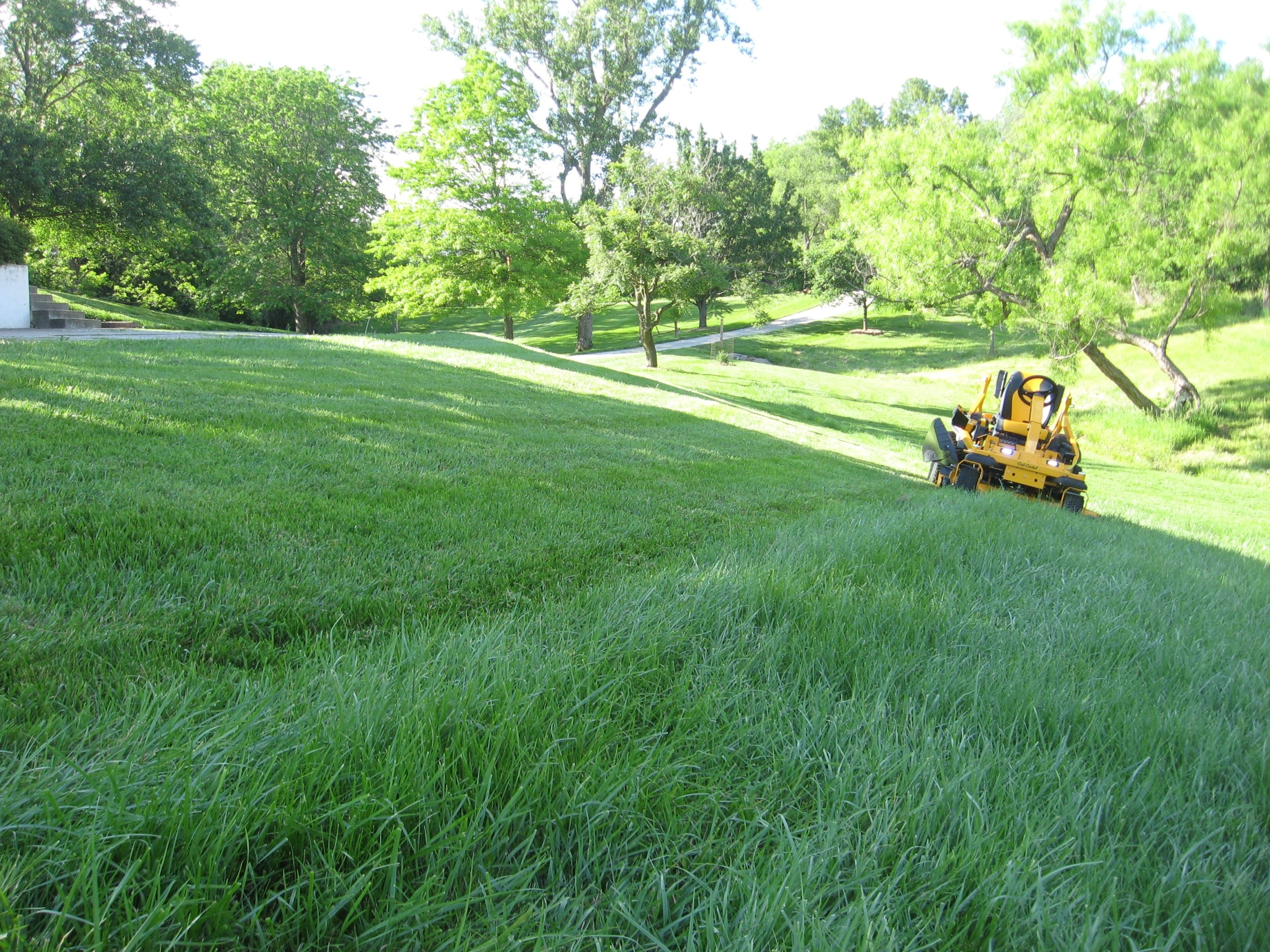

Now for the review: This thing is CRAZY. Like mowing the grass with a gokart. After reading all the lawyer-ese in the manual, I was somewhat concerned how this machine would do on hills. Turned out, my concerns were totally unfounded. It felt rock-solid on slopes from any direction. Part of my yard is a long stretch of near 24 degree side slope. Handled it like a champ and I was comfortable mowing it with the ROPS down. Hanging on to the cup holder to keep from sliding out of the seat and steering with the other hand.
My orchard sits on a near 20 degree slope and I used to have to mow around the trees by making "Austin Powers turns" around them with the old lawn tractor. Not anymore. I was literally laughing and giggling like a school girl while pulling tight continuous turns around these trees with the Cub without loosing traction even once. I probably cut 10 minutes off my mowing time in just this one area.

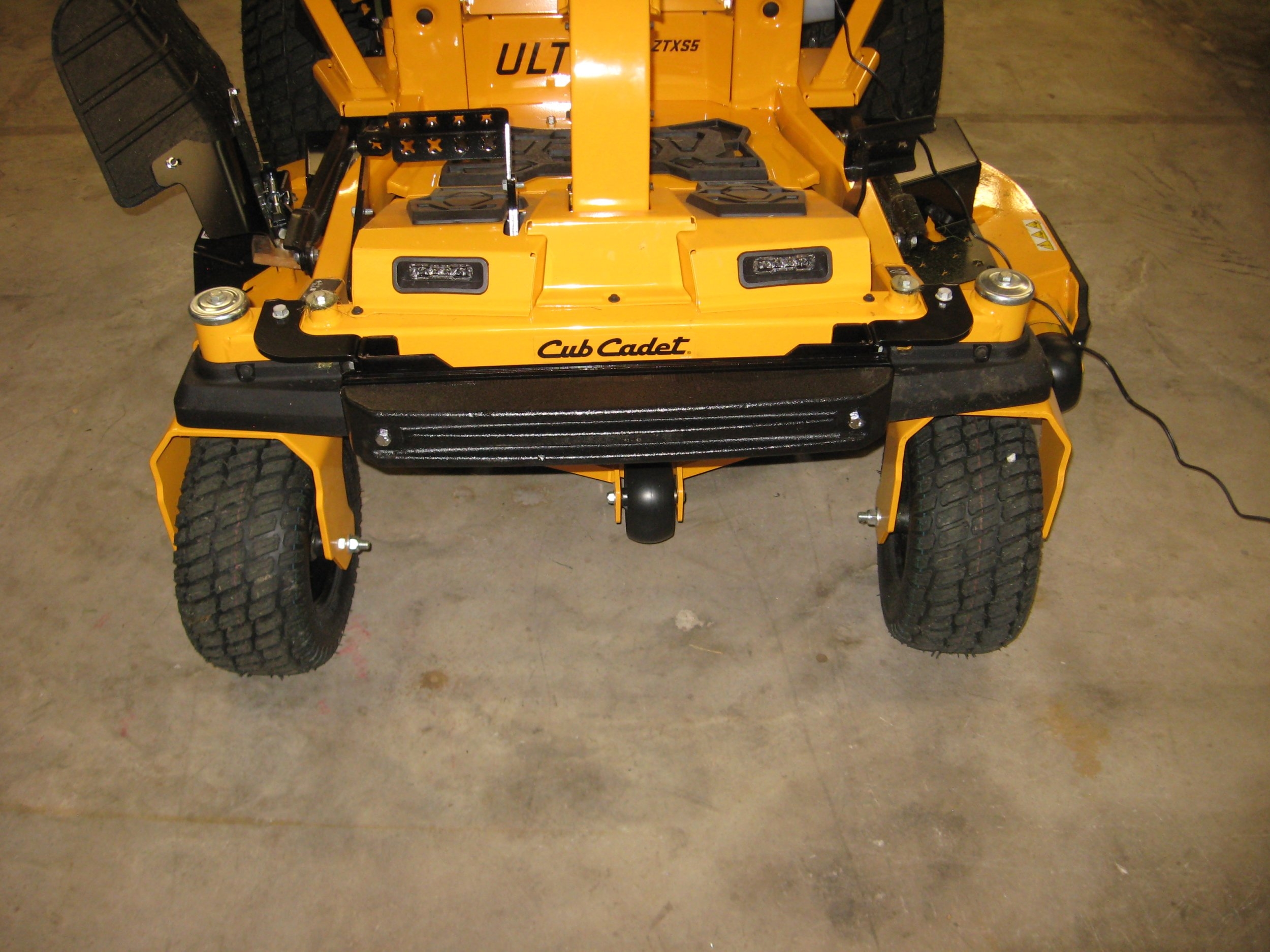

One thing to call out -- I recently had to buy a lock-n-lube grease gun extender to be able to hit the forward-facing zerks for the steering linkage that are accessed via the holes in the yellow plate just below the Cub Cadet logo. The locking coupler won't fit through the holes.

Are those front zerks 90 degree couplings? I think you can access them from underneath if they were just straight. I get that they were trying to make it easier by making them come out the front, but we have to have our Lock-N-Lube!!!! Maybe that's why when I reached under there, all I could feel was a big blob of grease on each one. Perhaps the dealer couldn't get their gun on there either. Definitely needs a closer look.
They're straight, but there's not quite enough room to get the lock-n-lube coupler in there. I believe they make a 90deg fitting/adapter which might work better than the extension adapter I got -- it's easy to just make a mess of grease vs actually get it in the zerk without the locking coupler (didn't realize how spoiled I am with the lock-n-lube!)

Speaking of tire pressure, the massive side plates on the front spindles makes it a pain to get to the valve stems on the front wheels. Had to break out the old inflator with a 90-degree chuck to check them.
