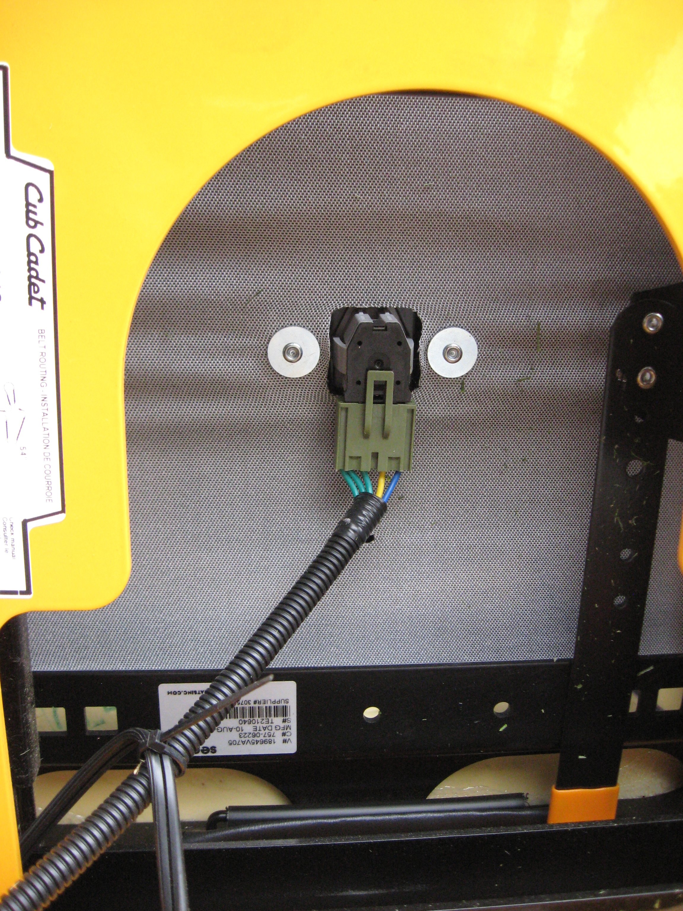

Second mowing of the season today. After getting bounced off the seat enough to activate the PTO cut-off three or four times, I'd had enough and did the plug mod to defeat the "feature".
For those unfamiliar, on MTD products there is a little "buss bar" inside the green plug where the wire attaches to the bottom of the seat. Just pull out the buss bar and reattach the plug to the seat and, presto, no more PTO cut-out.
