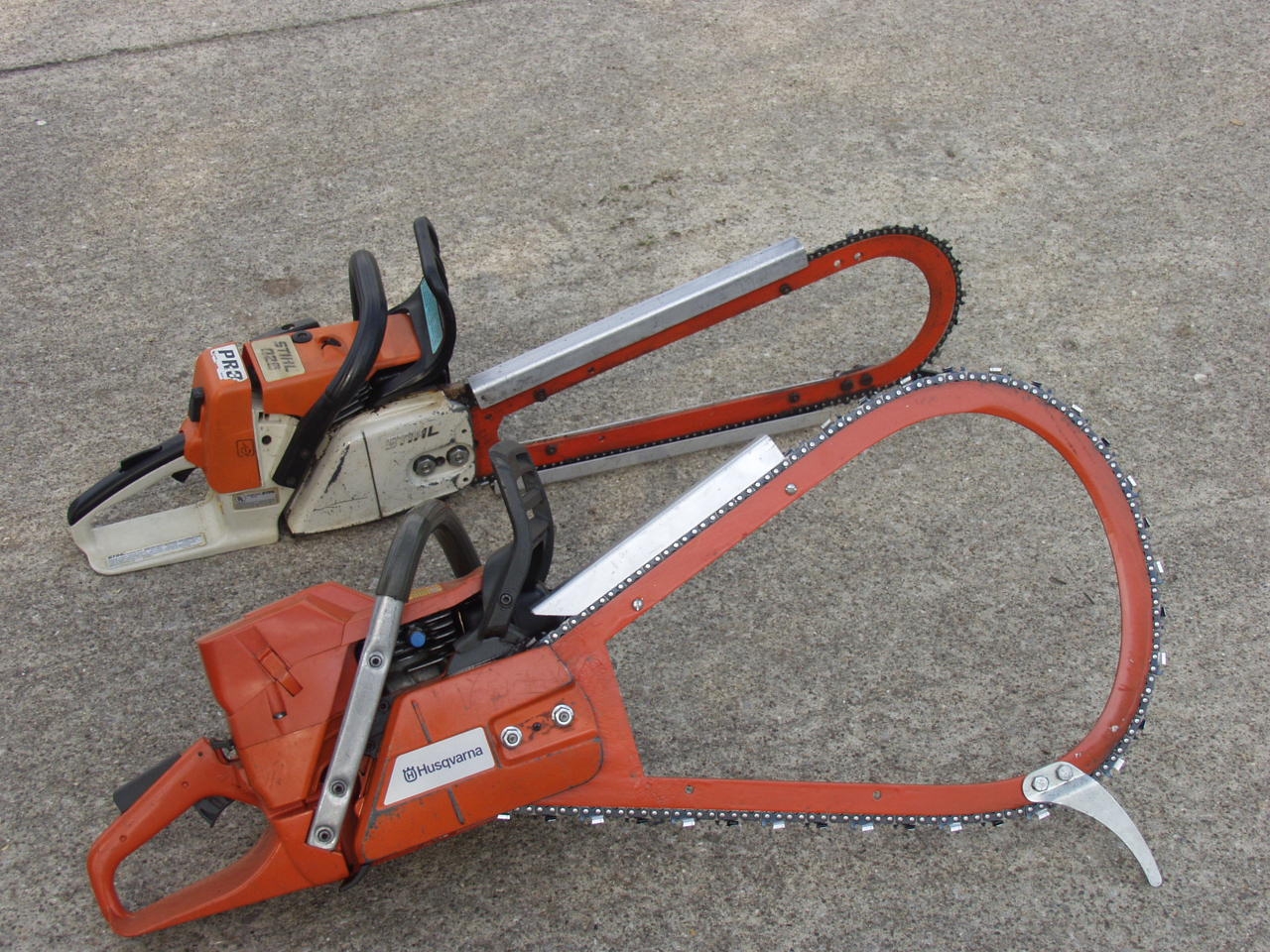

Here you want to know what owner of those bows used for. He did a thread. Bow Bars Are Perfect For Firewood!
026 one = Brush bow and Christmas tree farms used those ones.
All I know is they aint for me.

It seems like a bow bar on saw with the power of a 372 would want to run off the log into your legs and be a death machine. Even with a small saw I imagine the injury rate would be considerably higher on a number used basis.
Recoil will pull the bar away from you, not push it toward you. That's why they usually have a spur on the lower quadrant of the bow, to keep it from walking away from you, as you press it into the kerf.
/ Echo 590 or the X Series? #108
Local friend put 2 bows on some saws I sold him for same reason. Not bending over.
Husky was stock and 026 was ported.
I tell you what running the 371 372 saws even stock with a bow is scary as heck. To me bows belong on slower older saws.
When I was on thinning crew in Arizona we ran bars like the one in the back, but with full guards top and bottom. The trees we were cutting were 8" and under. The bars worked well and were very safe (for chainsaws). With the stinger seated and the chain cutting I could take one hand off the saw and use it to push on the tree. I once tripped and fell backwards with the running saw landing in my lap. The chain didn't even touch my chaps.
The design means less bending over but we constantly got complaints from the cat crews who were piling the slash that we were leaving pointy stumps.

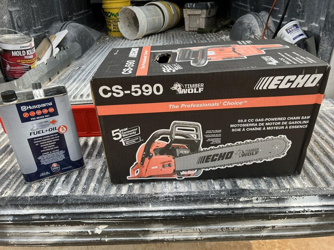

I've barely used it, but so far, I'm very impressed. I think I ran it for half an hour on Saturday, and maybe a little over an hour on Sunday. I'm surprised at how light it is and how easy it is to handle. Starting it is very easy, which is a big deal for me. I hate it when I can't get a saw to start!!!! I think the canned fuel makes a big difference too, so it might be the combination of having a new saw, and better fuel. I might like some of my other chainsaws better with this fuel!!!!
I tried the pull handle to open the fuel and oil caps and it works great. Thanks for that tip!!!
It's probably going to rain, or be muddy this weekend, so I'm doubt that I'll use it. I have 5 nice oaks on the ground that I dug out with my backhoe. I need to cut the root balls off of them and limb them so I can carry the logs to my splitting area with my grapple. If it's dry enough, I'm looking forward to seeing how the saw performs out in the field, on those trees.
The needle greaser for the end of the bar should be here tomorrow. I'm excited to see what it does. I've never greased a bar before.
For $419, I think I got a great deal.

I bought a can of Husqvarna premixed fuel because I was walking down the isle in Lowes and saw it, so I bought it. It has an octane rating of 95. I didn't compare the other brands to see what their octane rating was, but I did look at the pump that sells Ethanol free gasoline. It's 91 octane. The Supreme which is on the same hose as the 87 and 89 octane fuel has Ethanol. If I buy the Ethanol free gas, which has it's own hose, it's a lot less octane then the canned stuff, but it's only $3.50 a gallon plus the oil, compared to $30 for the Husqvarna fuel. Is the higher octane rating noticeable or needed? I'm committed to never using fuel with Ethanol in this saw, I'm just not sure if $30 a gallon for gas is being smart or wasteful?
IMO, you're wasting your money if you can easily get ethanol free gas and good oil. Your saw's manual likely has a minimum octane and you'll be hard pressed to find e free stuff in the Lower 48 that doesn't meet whatever that is. Here in NH it's mostly 91ish and I can get it almost anywhere near me.
For good oil, look for the JASO FD rating. Examples being Echo Red Armor, Husky XP+, and I'm about to dive into some VP Racing 2 stroke oil as it is FD rated but cheaper. Plenty others out there.
That's not to say there aren't cases for dudes to buy the pre mix. If it makes sense for your use case, rock on. You likely already know this, but you should tune your saw when you make significant fuel/oil changes. I'm too lazy for that which is why I'm all in on Husky autotune saws.
