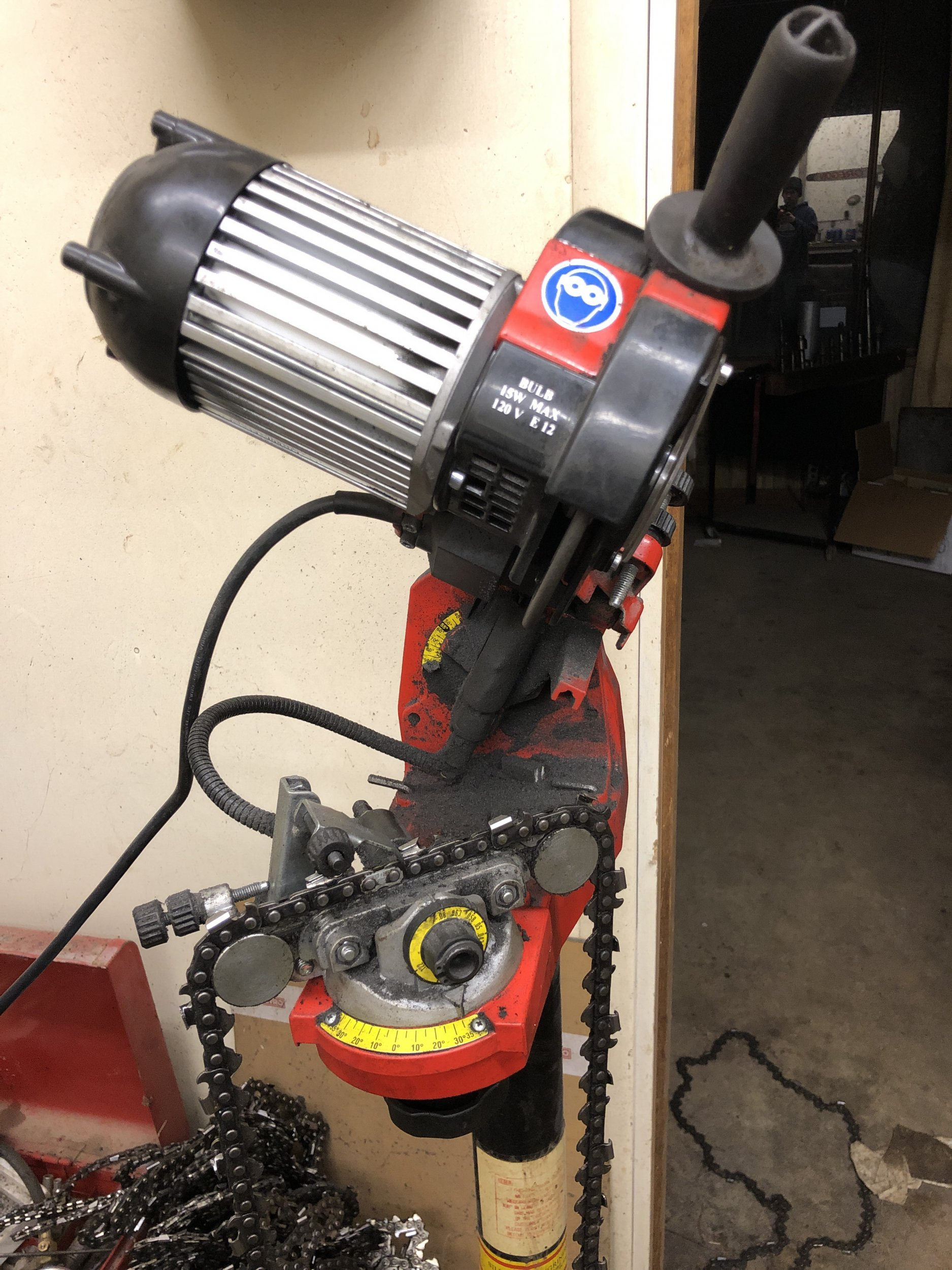

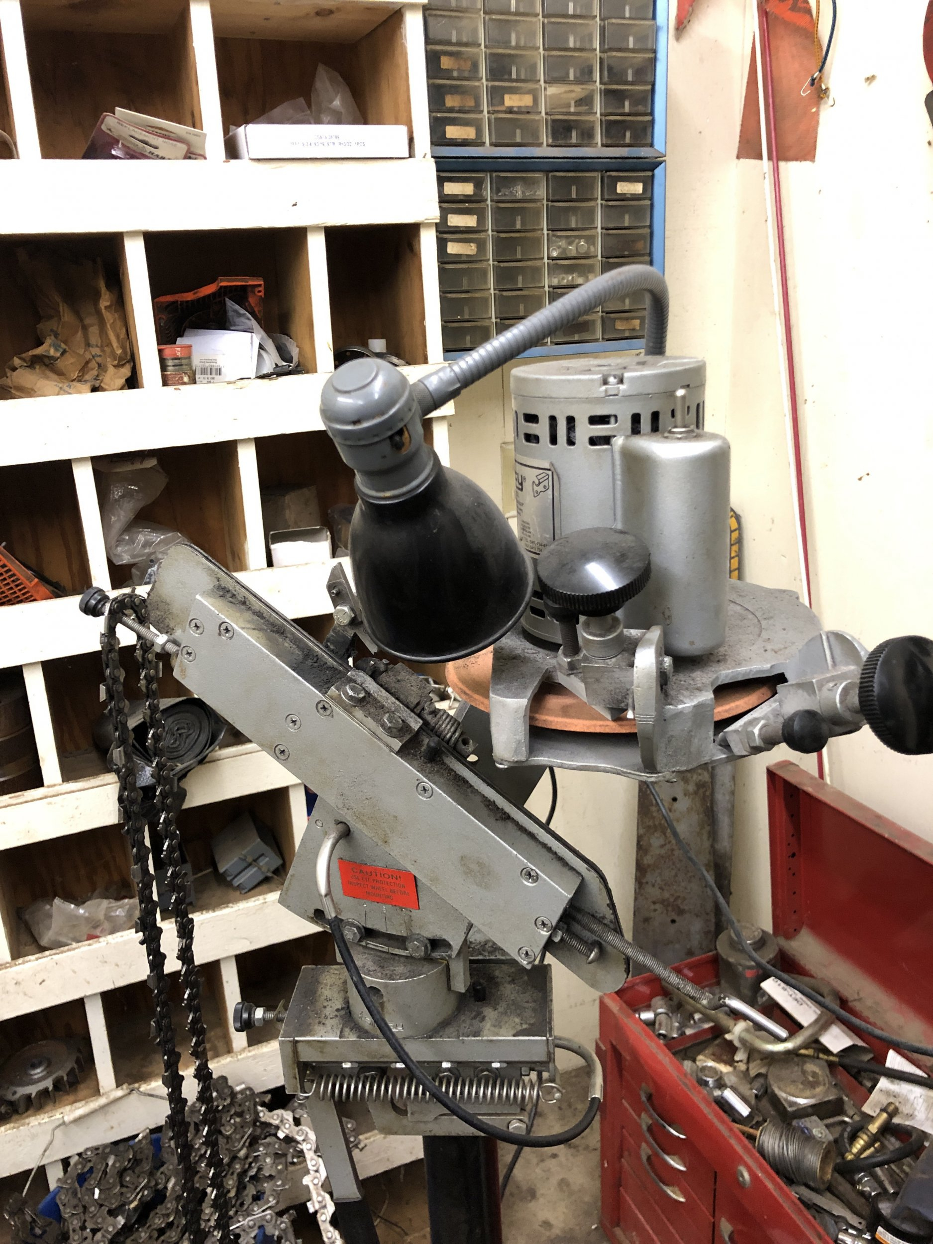

One square grinder, one round grinder and a raker/depth gauge grinder. There’s a huge difference in having a consistent chain when you’re falling timber all the time you need predictability.

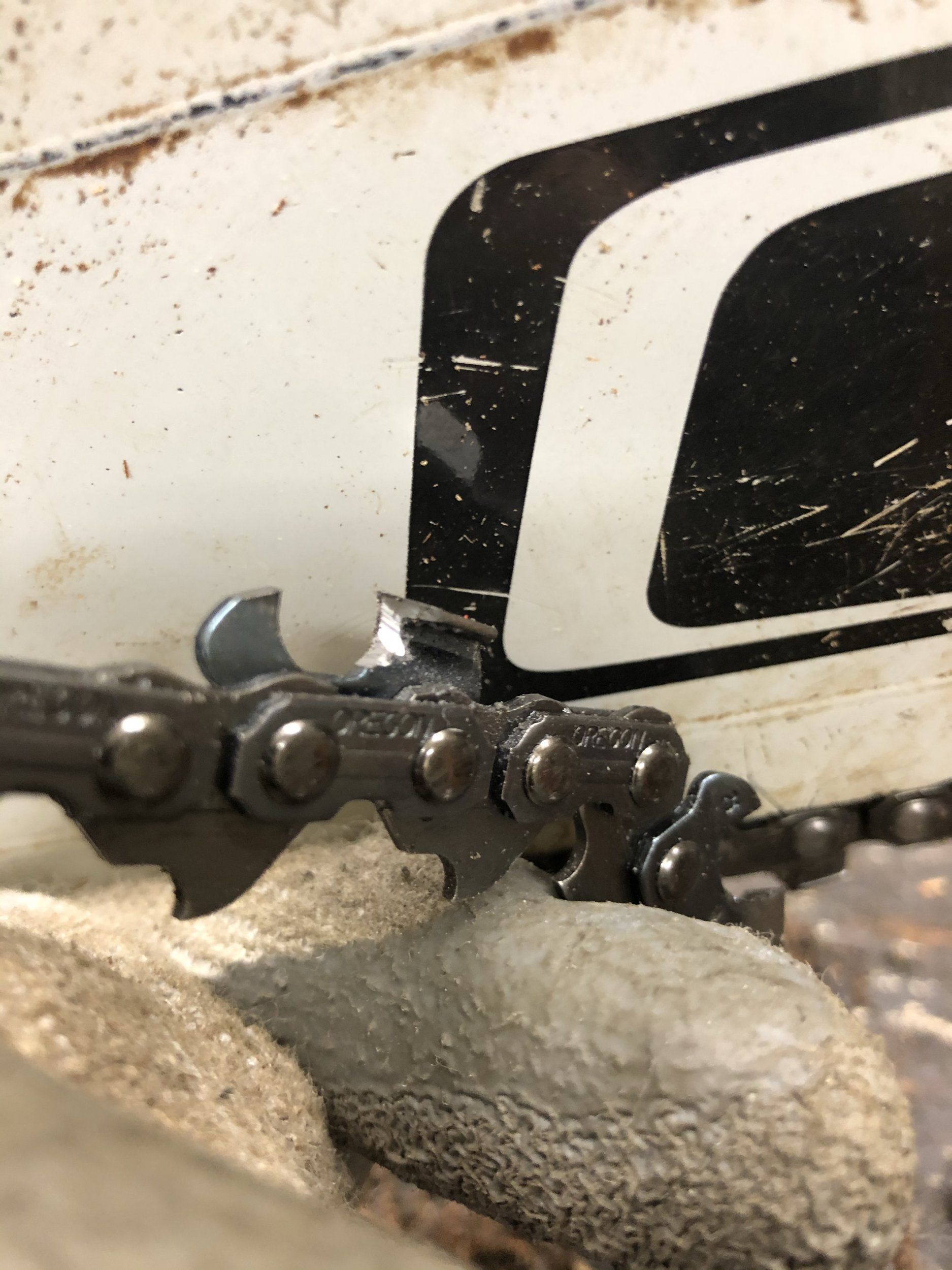

Not cutting straight is usually from the rakers not matching. A good file guide can help prevent that.
/ Chain sharpening #46
There’s two schools of thought on that. I don’t grease mine, allowing the B&C oil to do the job and have never had a problem. If you do grease do it often as it will create a ring around the sprocket, which won’t allow oil to get to the sprocket. Not cutting straight is usually from the rakers not matching. A good file guide can help prevent that.
Not cutting straight is usually from grinding/sharpening one side of your chisel teeth, more than the other. The left and right teeth need to be the same for a good cut.
None of my bars have a grease hole for the tip sprocket. Never had that bearing fail either. I replace about one bar per summer for being bent or simply wore out.. We rarely run out of bar oil but it sure sounds funny when you do! . Ya, we're hard on them.
I’ve had the most crooked cut problems aside from the obvious damaged chain from a worn bar. Once it starts happening I take it off and grind it on my strip sander and that fixes the problem.
