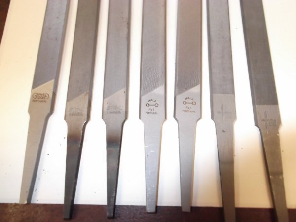

#76
Only difference between a square cut sawfile and a normal file is, the square cut file has no cutting teeth on the narrow side. Like I said, not something I'd be interested in at all.
   / After years of hand filing, went and bought myself an Oregon chain grinder #77
No a square file has a cutting edge even on the narrow side.

Square ground is ok but not my cup of tea. Square ground dulls quicker and takes more power to run.
Square ground is simply a more efficient cutter profile: it cuts faster and takes less power to run. It also holds an edge longer than round ground full chisel chain. This is because geometry of a round ground chain makes for a somewhat more fragile point, so it wears more quickly.
Semi-chisel probably dulls less quickly than either round or square ground chisel, but the trade off is that when all three styles are sharp, the semi-chisel is the slowest cutting of them all. If I were cutting a lot of dirty wood, I'd probably use more semi-chisel chain. I don't do a lot of that kind of cutting, so the only semi-chisel chain I have is on my battery powered saw (because I haven't found a full chisel that fits it... not that I've looked all that hard. It's not the saw I grab when I have serious cutting to do anyway.)
Other than when I'm doing storm damage clean-up almost all of my cutting is in slow-grown hardwoods. I use round-ground full chisel chain. I'd use square ground except that I enjoy hand-filing, and have never developed the knack for hand filing square-ground chain properly. At this point, it's not likely to happen: my eyesight is just not good enough anymore to see the corners and angles to get the square ground point correct, which is critical to its cutting performance.
