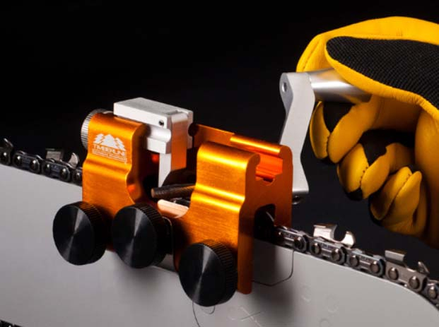

Any of these should help; there are tons of YT videos on how to use the 2in1 sharpeners.

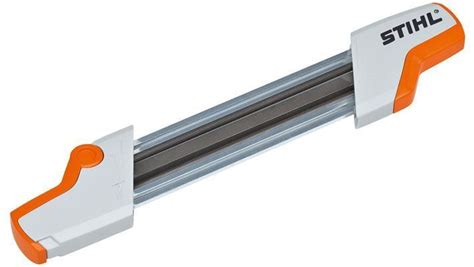

I ordered the Stihl sharpener from Amazon for a tad less than $24. Didn't have a tool for checking filing the depth things in between. Used to have, but I gave all that stuff away when I had to give away my gas powered Stihl.

Note the white handle in the 2nd video's preview. See that diagram? It shows you how to orient the sharpener relative to the chainsaw. All you have to do then is: go in the direction indicated (see the arrow?), keep it oriented at the same angle as the handles and then keep the sharpener flat and at 90 degrees to the bar. Pretty simple.

Tried the new Stihl sharpener. Like the Dremel better. You can easily see the shiny teeth where it has gone. Cannot easily see where the file has gone. Think the Dremel does a better job.
