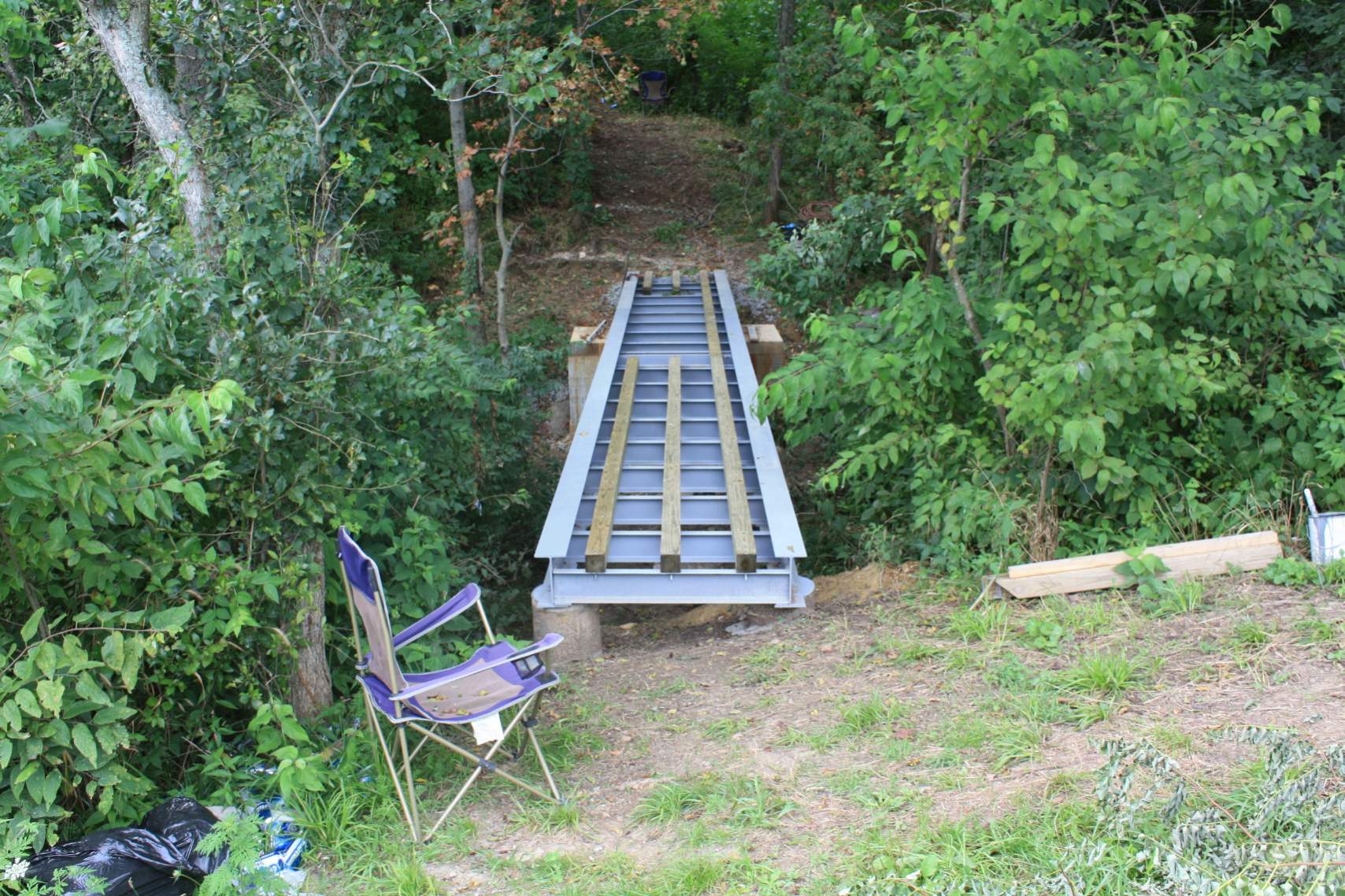

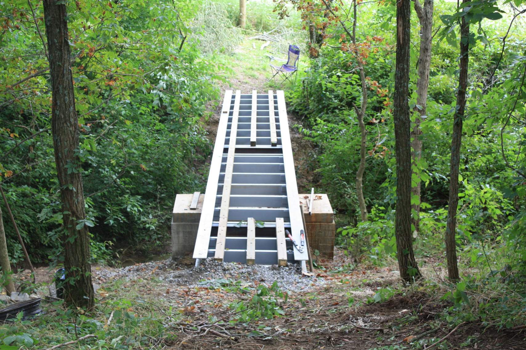

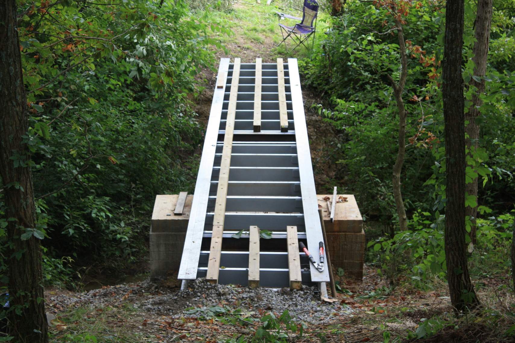

I got the some of the wood-runners in, the heat here is nasty...90+..not my favorite working conditions. I put the Kubota through her paces pulling out small tree-stumps. I used the steal wheel method...worked great (wish i'd taken pics). This was a way bigger project than i thought. Its finally looking like a bridge though. Kinda got rained-out today, and i needed a small siesta. Here's a few pics of the progress.

Why did you decide to use circular piers on oneside, and the square on the other? I also love that you have a lawn chair on each side with a beer can... Just so you have a good resting place close by? ;-)

How wide will the finished bridge be when finished? Looks too narrow for a tractor from the photos?
I used 12" circular piers on both sides (4' deep) with a support wall off center to help support the middle. Ya don't think I do all this work sober do you.
It will be 6 feet 5 & 1/2 inches. It has about 12 inches of over-hang off each side of the I-beams. I agree, the pics make it look narrow, but keep in mind its 35 feet long. I made it a little wider than the first bridge (its 6 feet wide) just to give me a little more room pulling my trailer across it. My tractor (Kubota B2150hst) with the backhoe attached will fit fine.

Today I got the rest of the runners in and started laying the planks (2x6s treated). I ran into a problem...the 4x4 runners are 1/8 of an inch taller than the top of the I-beams (my mistake) creating a small bowed look. Im probably the only one that would notice...but I do. The fix im thinking of is to put a shim in between the I-beams and the planks ( one that is as wide as the beam). Thats 70 feet of shims!!! I could take the runners back out and mill them down but thats a lot of work (105 feet of milling, plus unbolting etc.) Help...any ideas?
/ Bridge#2 #59
That treated lumber will shrink as it dries out over the next few months. I'll bet the 1/8" will be gone by then. You could get rolls of the rubber/tar window flashing they use for building houses and roll that on top of the beams to save time if you think the wood won't shrink. It would be good protection for the beams anyway. The builders used that on my pole barn for every area steel was going to contact the treated boards (along the skirt, up posts, etc). The bridge looks great. Can't wait to see it when it's done.
