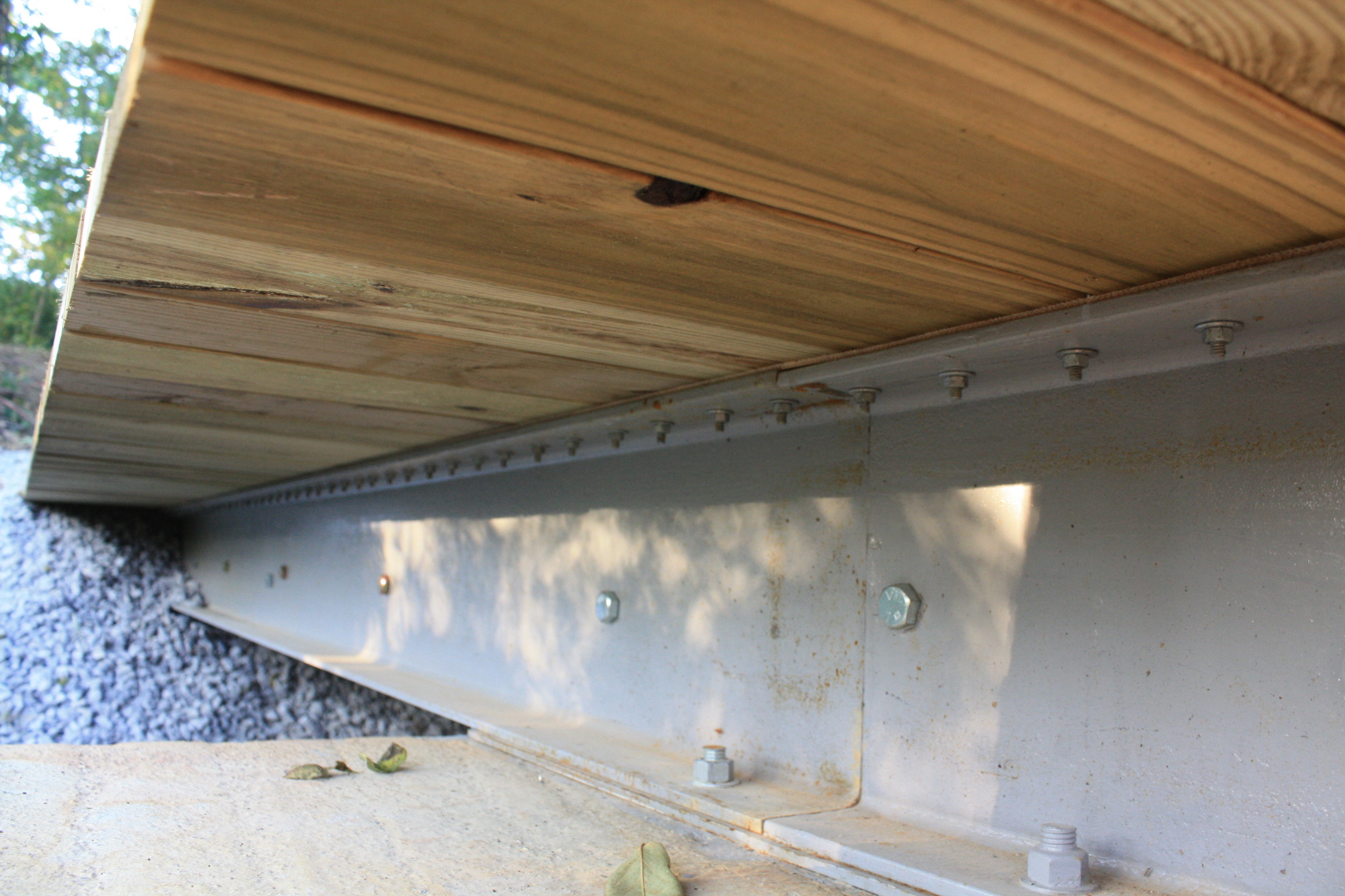

Nice bridge..!! I didn't read all posts, but did see the one where you drilled 300 holes though the wood, and beams... Maybe someone else suggested it, but I didn't happen to see it if they did.
IF it ever needs to be replaced, or you build another... Instead of drilling through the beam, maybe use what we called "bridge deck clips". You drill beside the beam, and a steel strap approx. 3" long, with a hole towards one end. The clip has..., I guess you call it a offset bend in it. It allows it to be flush with the wood, and thickness of the beam. The other end clips to the beam when tightened.
Smaller versions of this, are used on semi lo-boy decks...

You gotta post pics, I would love to see it. Wish I had known about the clips before all that drilling.
