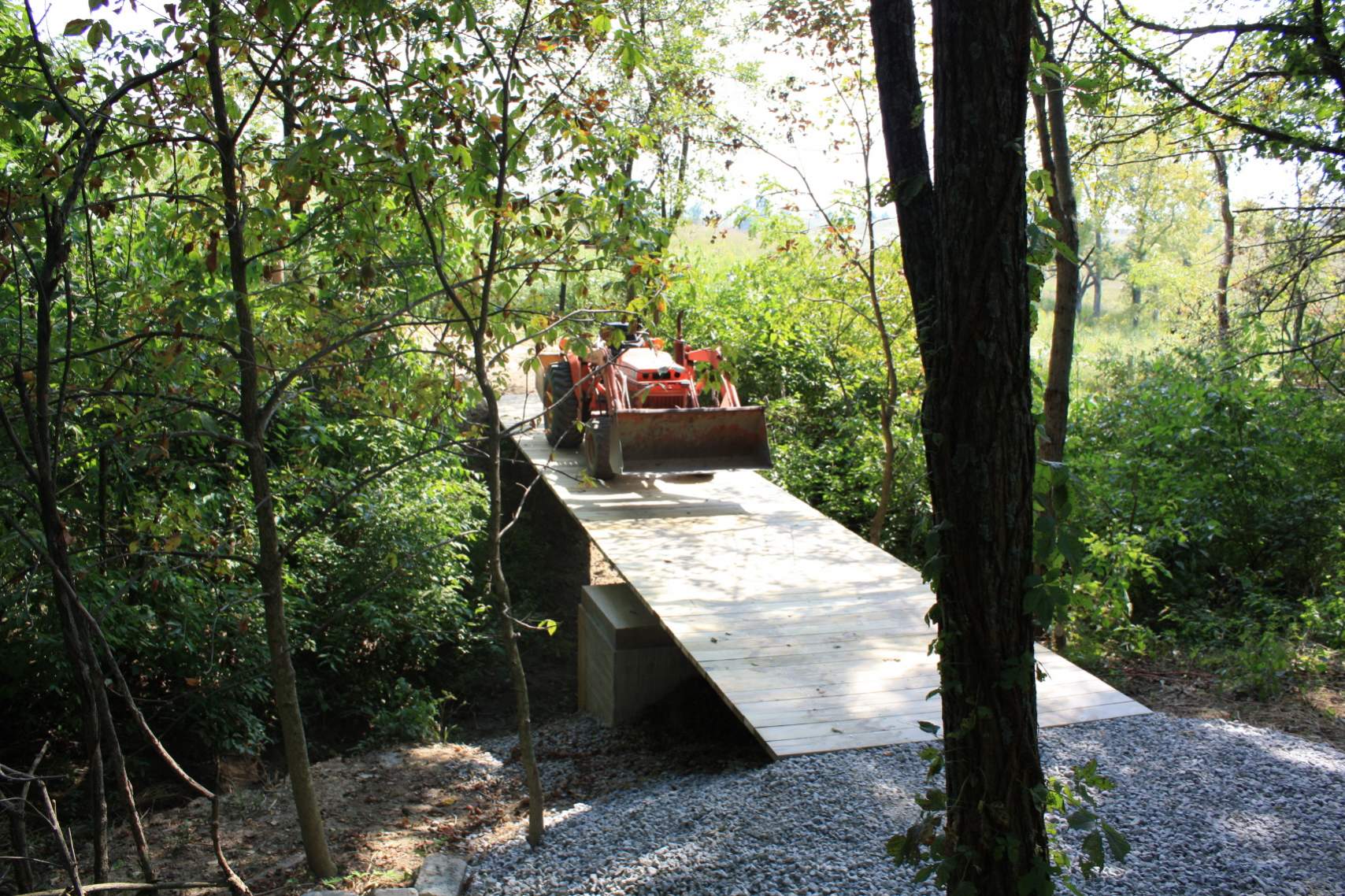

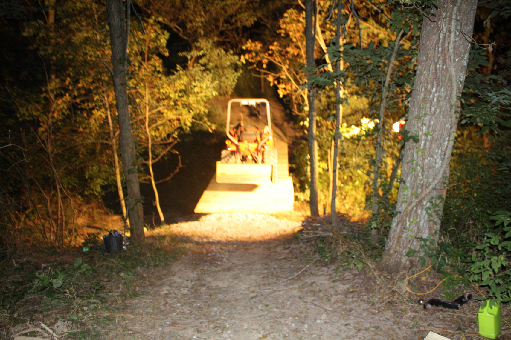

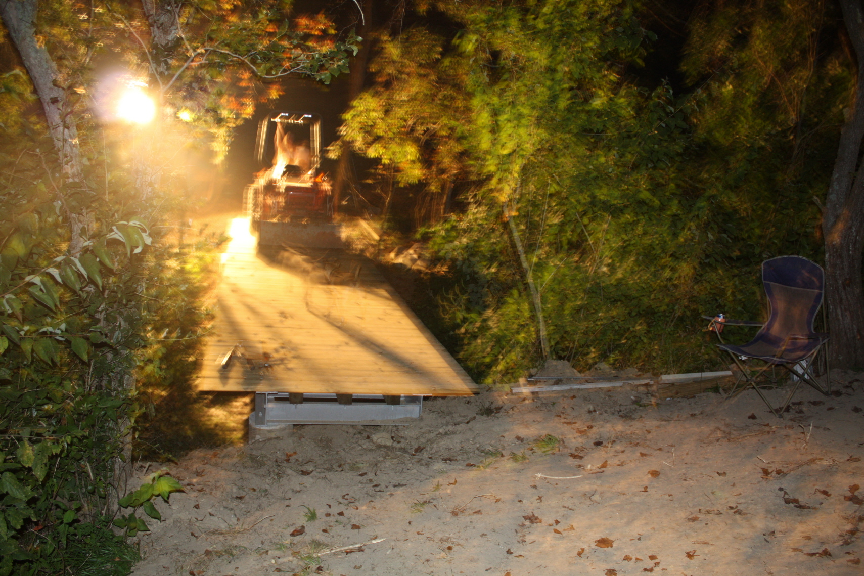

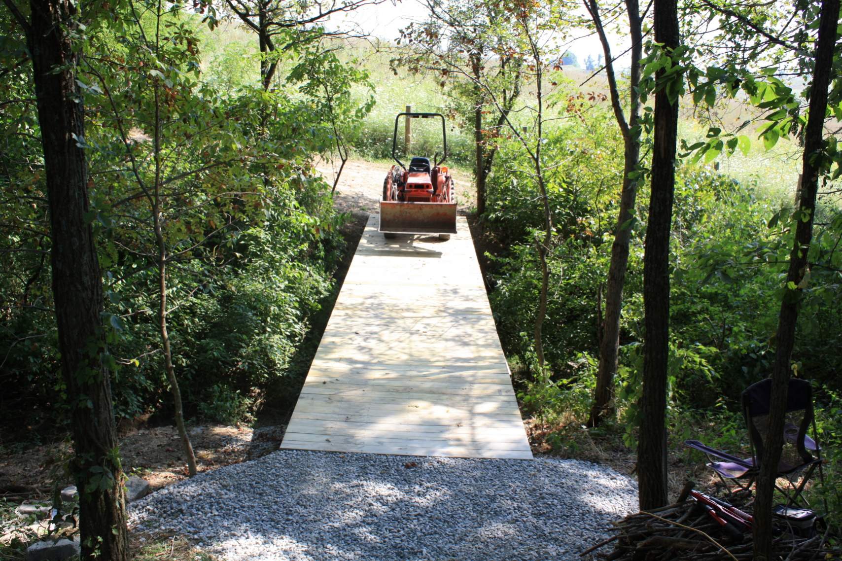

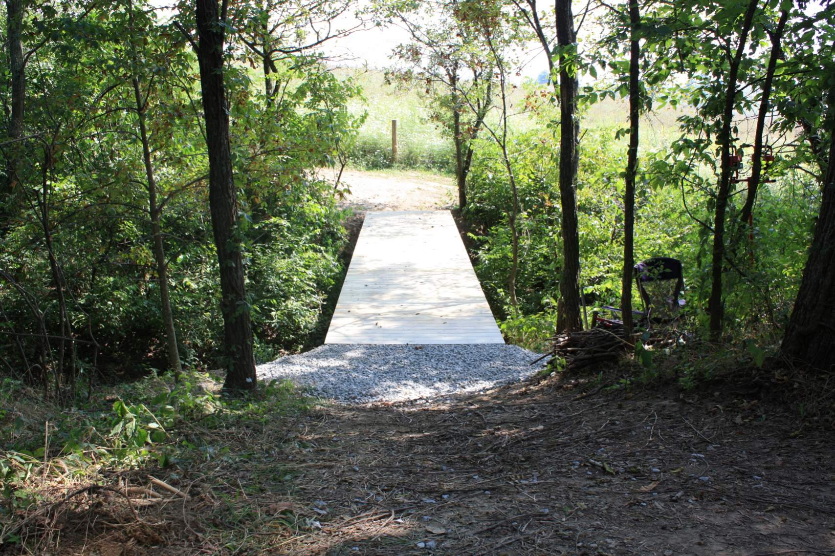

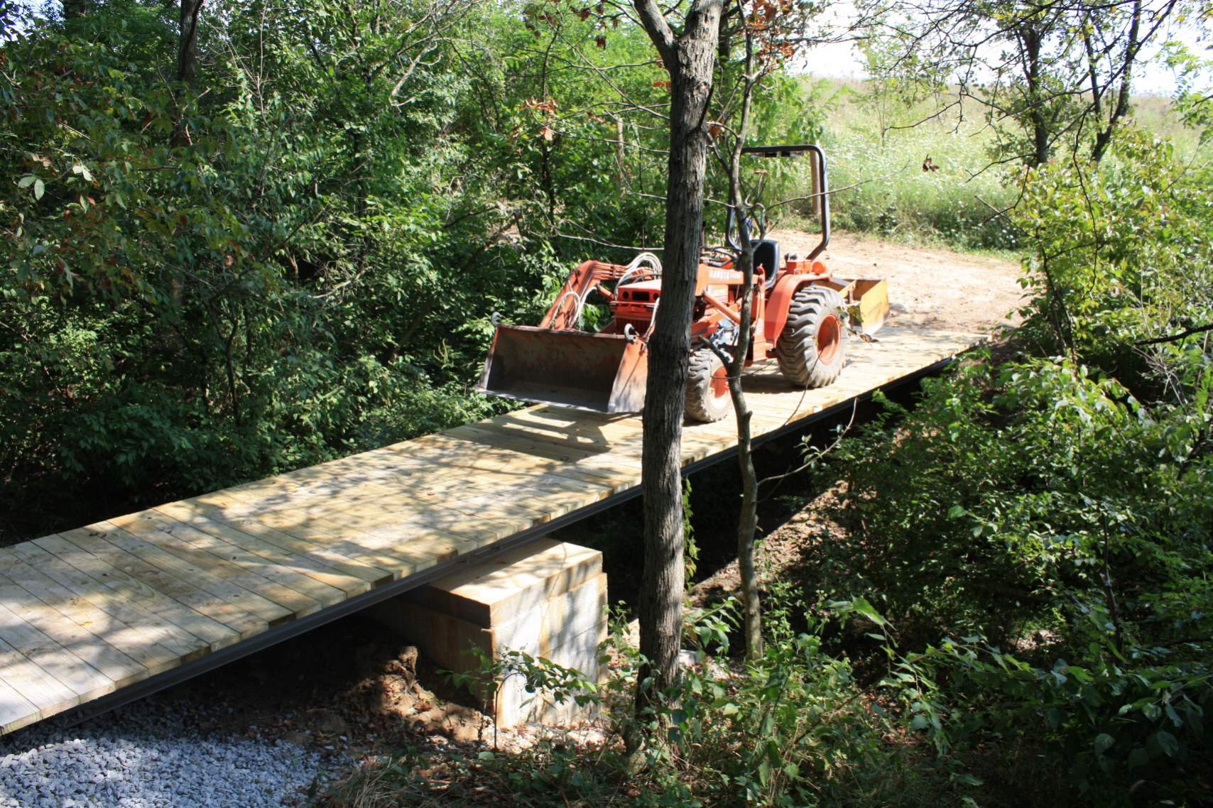

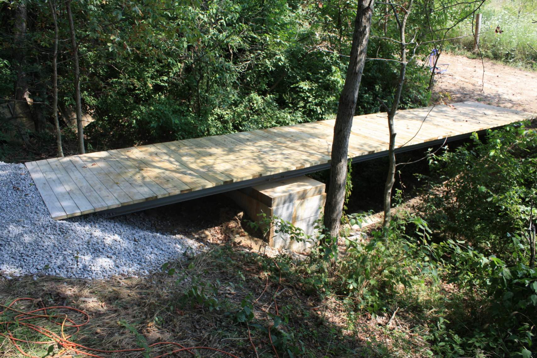

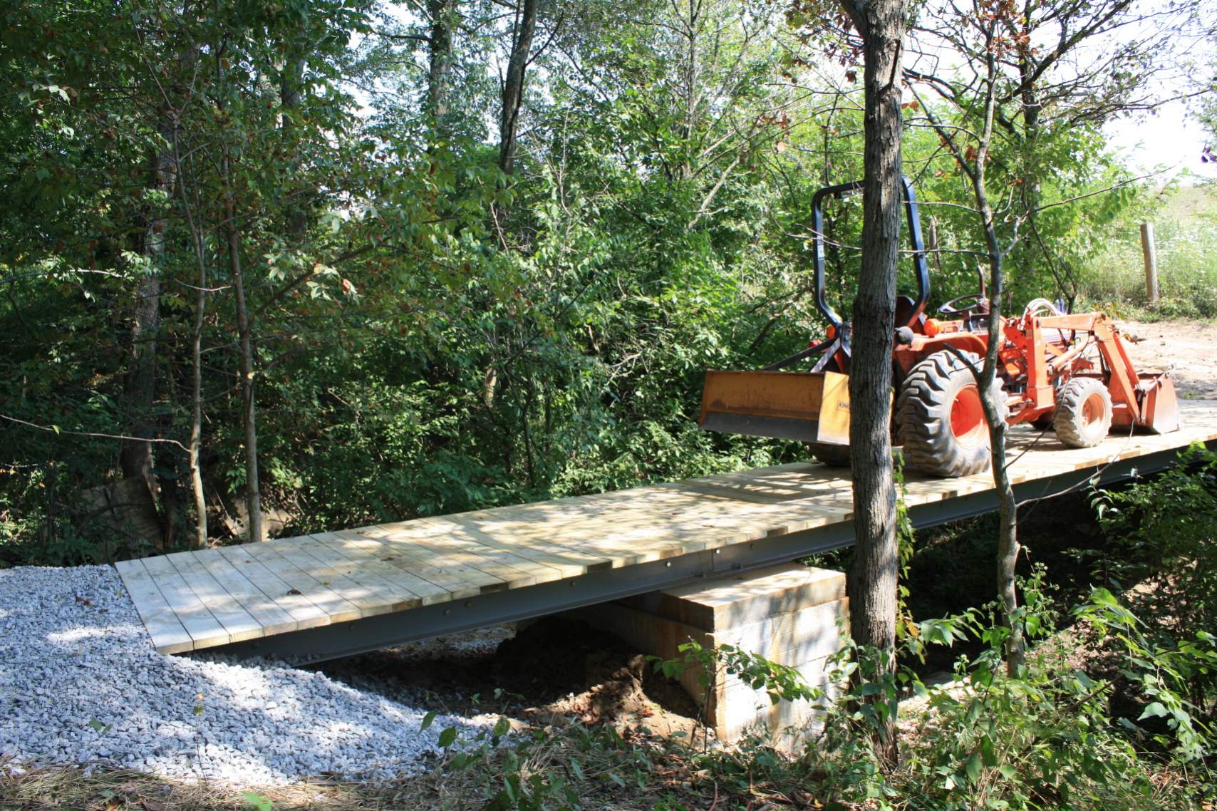

This was really a fun project. I like bridge#2 better than my first one. It was way harder, bigger, more $$$, and more head-scratching than #1. I've learned a lot building them both. I think 2 turned out better, stronger, and just looks better. The dogs love them both (i'll get pics of Salt & Pepper, maybe when I start the fort). Its such a joy seeing them running across them, playing on them, kinda like the pigs in "Lonesome Dove" (jayste). I love that movie (mini-series). I have had a great time talking with everyone on TBN. I've enjoyed showing off what i love to do, and thanks for being interested and so very helpful. It takes a village, TBN came through.

Nice bridge..!! I didn't read all posts, but did see the one where you drilled 300 holes though the wood, and beams... Maybe someone else suggested it, but I didn't happen to see it if they did.
IF it ever needs to be replaced, or you build another... Instead of drilling through the beam, maybe use what we called "bridge deck clips". You drill beside the beam, and a steel strap approx. 3" long, with a hole towards one end. The clip has..., I guess you call it a offset bend in it. It allows it to be flush with the wood, and thickness of the beam. The other end clips to the beam when tightened.
Smaller versions of this, are used on semi lo-boy decks...
