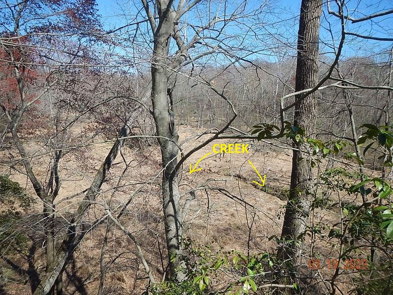

I figured I would start a new thread for how to design/build an abutment,, as my other thread was about beam sizing.
So, my creek runs through a bottom that is about 100 yards wide and absolutely flat.

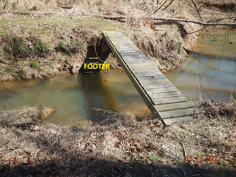

The soil is silty clay,, problem is when I put in a foot bridge 10 years ago, I concreted the post in about 1.5' back from the bank,, but over the years the bank has washed away, exposing the footer.
So, I will be putting my Tractor bridge in upstream about 100 yards,

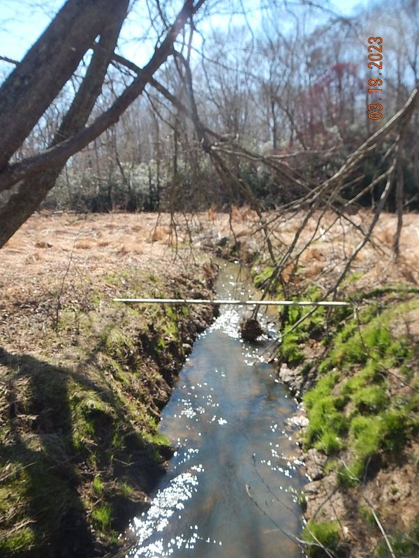

The 2x4 in the picture is 12 feet long,, and has 1 and 2 foot marks on each end (black lines)
The water is somewhat low for this time of the year, but gets a few inches lower mid/end of summer.
One summer it did dryout,, and most spring/summer it over flows it's banks once or twice, putting a foot or so of water across the whole bottom.

No mater what, I want the abutment to abutment distance to be no tighter than the top of the stream bank,, I do not want it to be a constriction when the bottom floods.
Any ideas or words of wisdom??

Is there bedrock below the water or just more dirt?

No bedrock, nothing but clay, silt and soil in this area.
You may find a stray rock 2-6" dia on a rare occasion.

You want to be at least a foot back from existing creek bed with your piers. The pedestrian bridge is failing from scour. Having new bridge footing below the creek bed helps protect against scour
