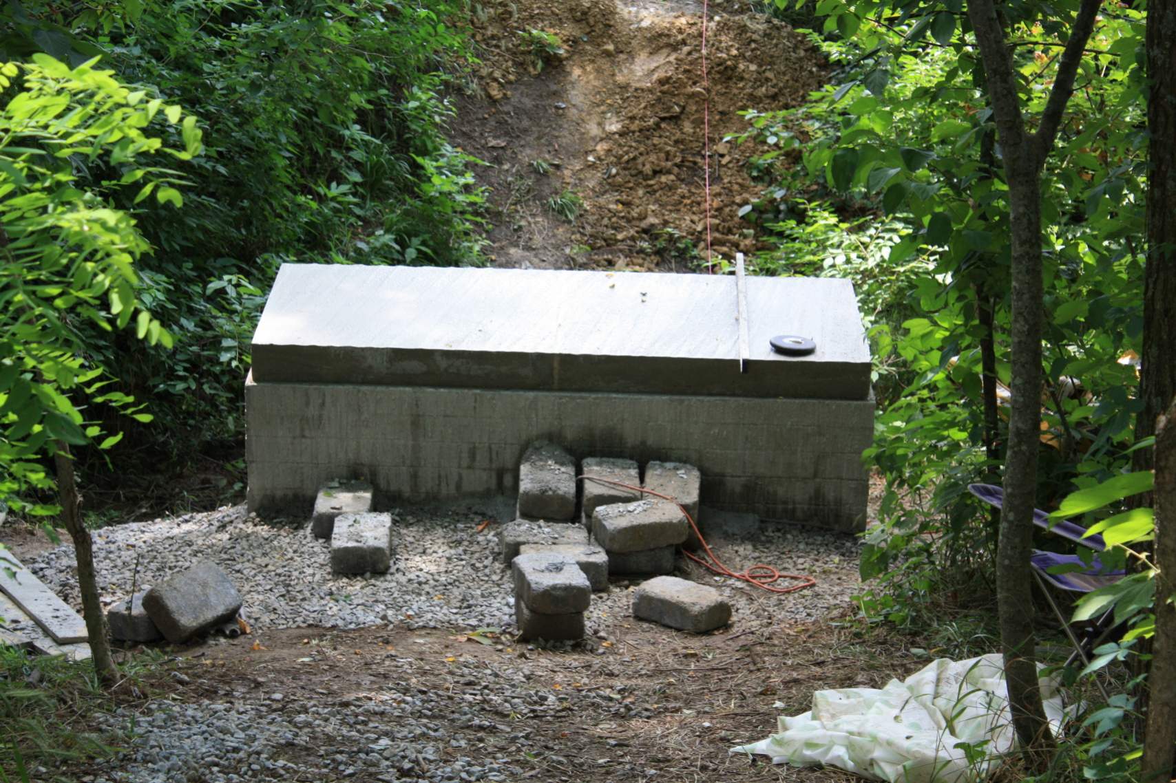

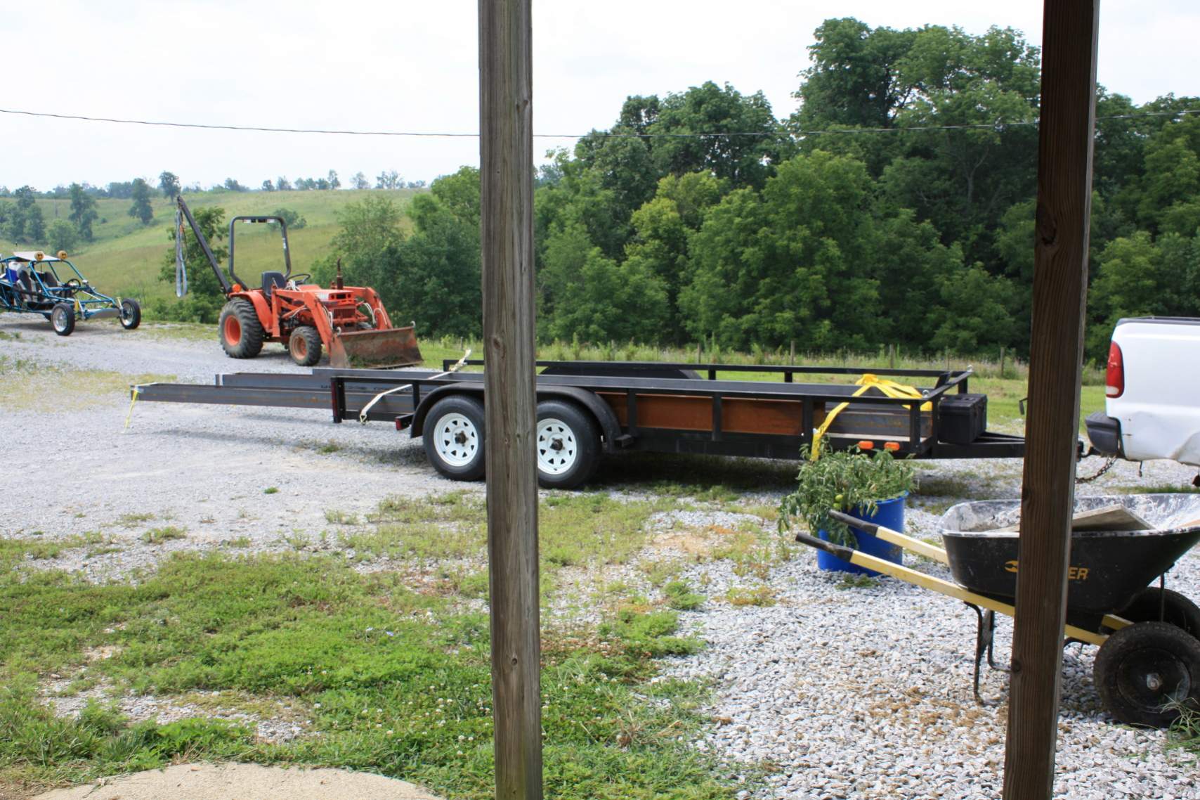

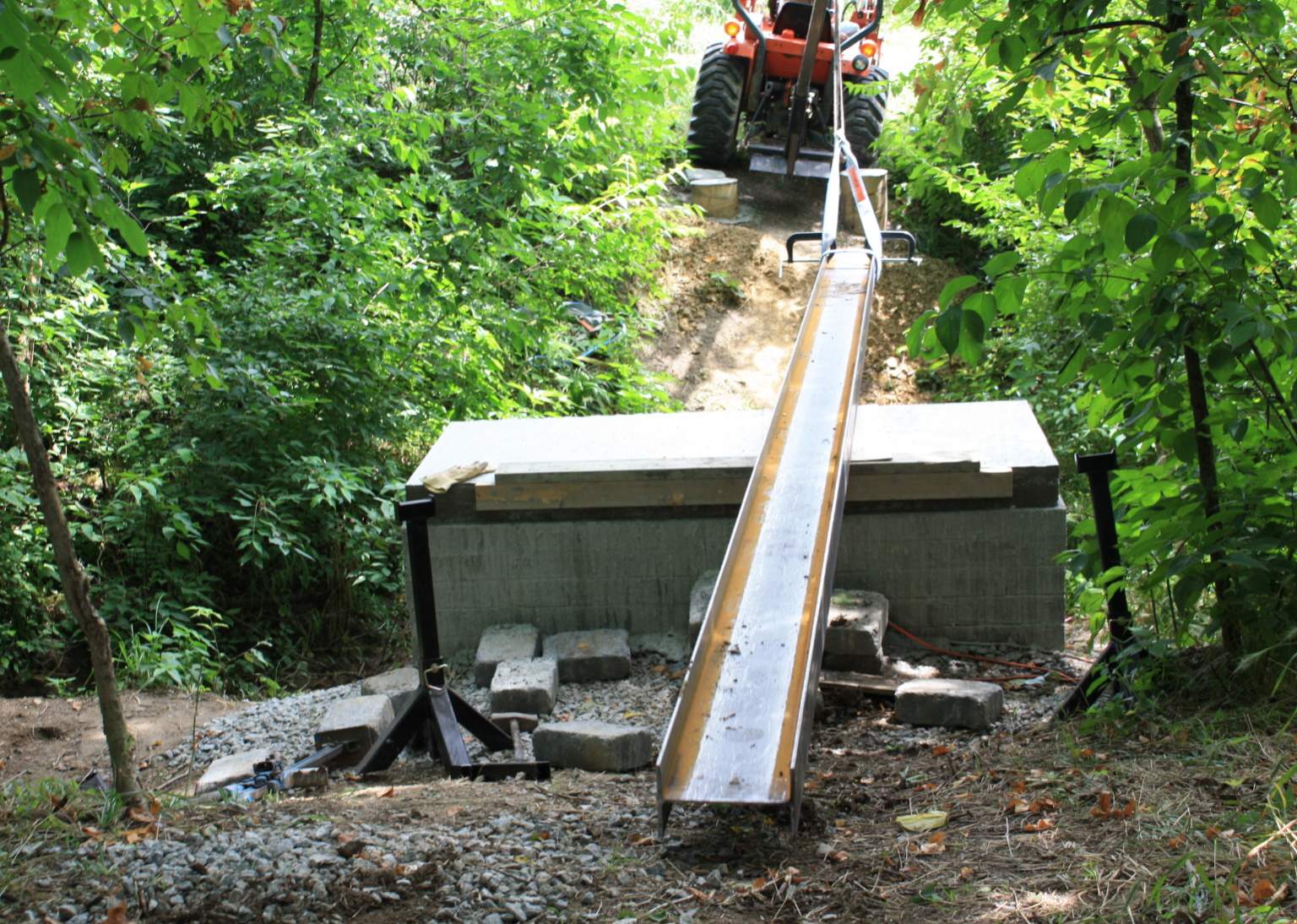

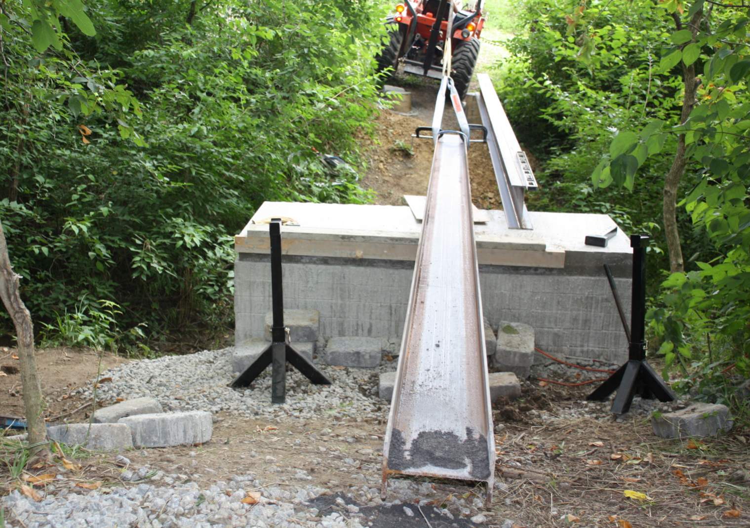

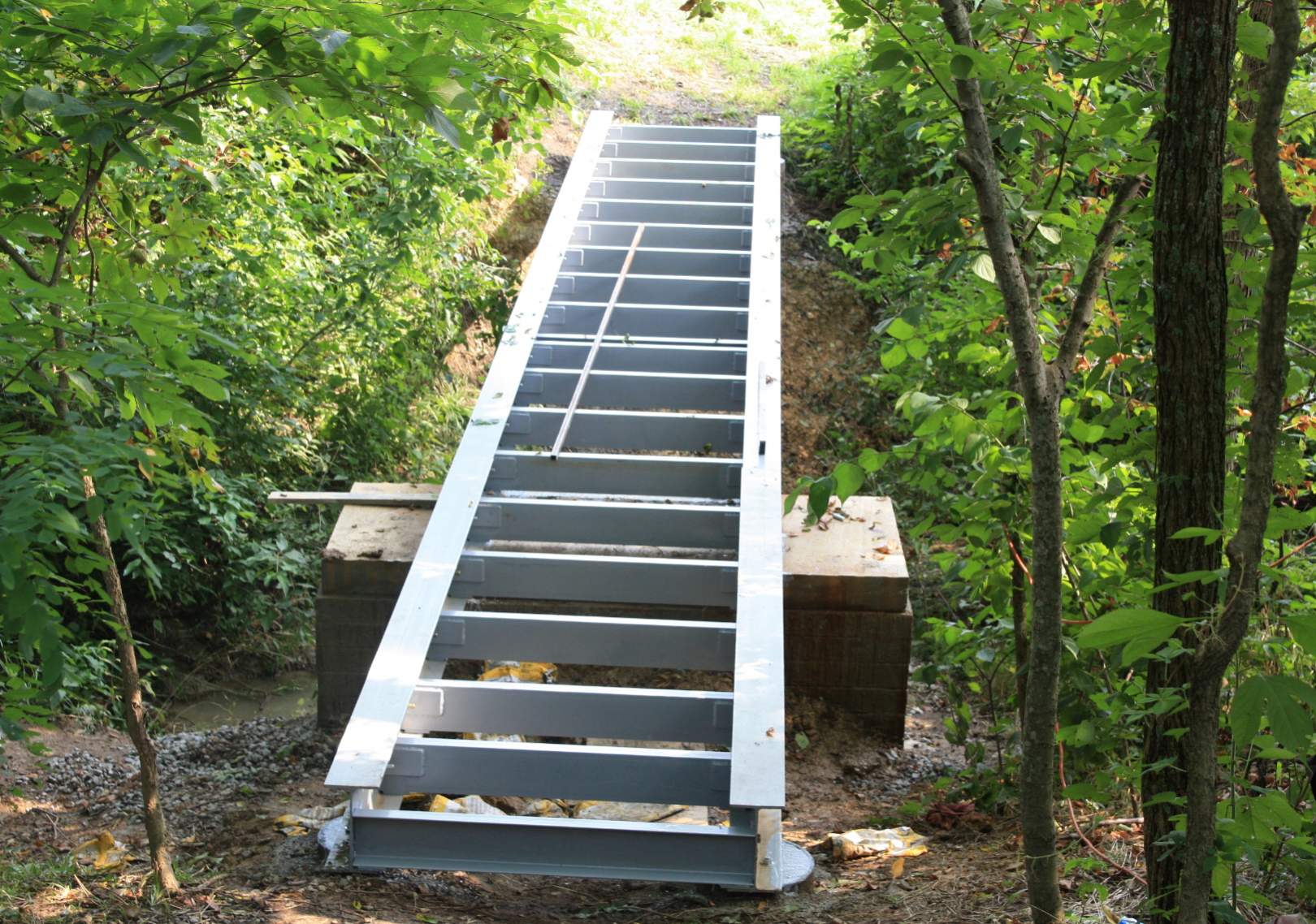

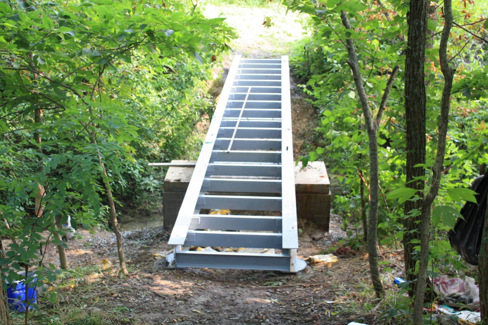

#30
I-beams came in today. Hauling two 25 foot beams on my 16' trailer wasn't as bad as I thought it would be. Here's some pics of us installing the first beam. We used a high-lift jack to lift one end of the beam onto the support, then I pushed it with the tractor half way. Prob. not the safest way to do it, but it worked.

/ Bridge#2

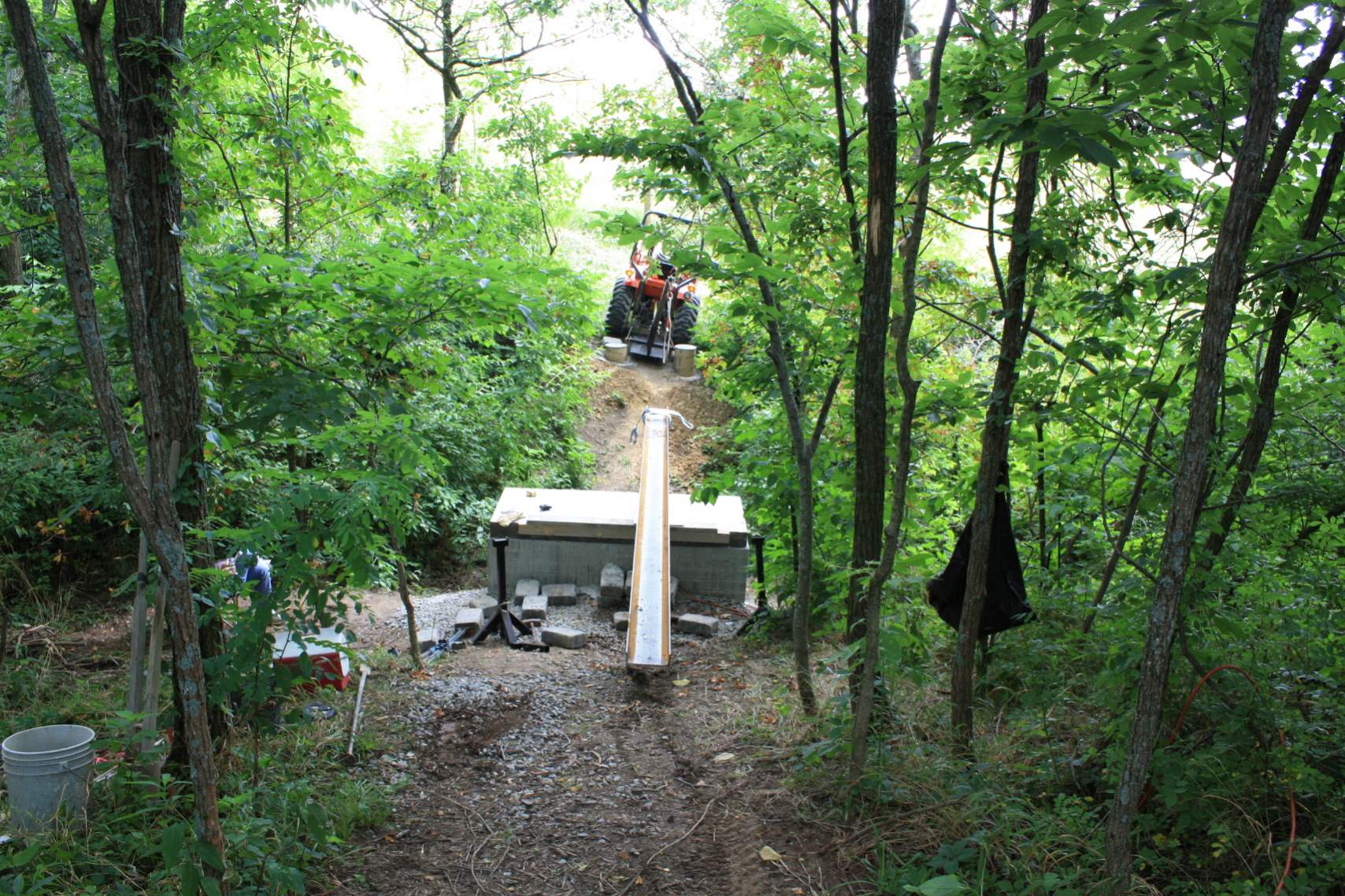

#31
Scared the dog, she hid behind the chair.
/ Bridge#2
#32
I used wood to protect the concrete. The beams weigh 550 pounds apeice, they seemed a lot heavier. It took most of the day to get them in place. They are just sitting there, I haven't lined them up yet. I want to make sure to paint the bottom side before I bolt them down. Again, the pics really don't show how steep it is.

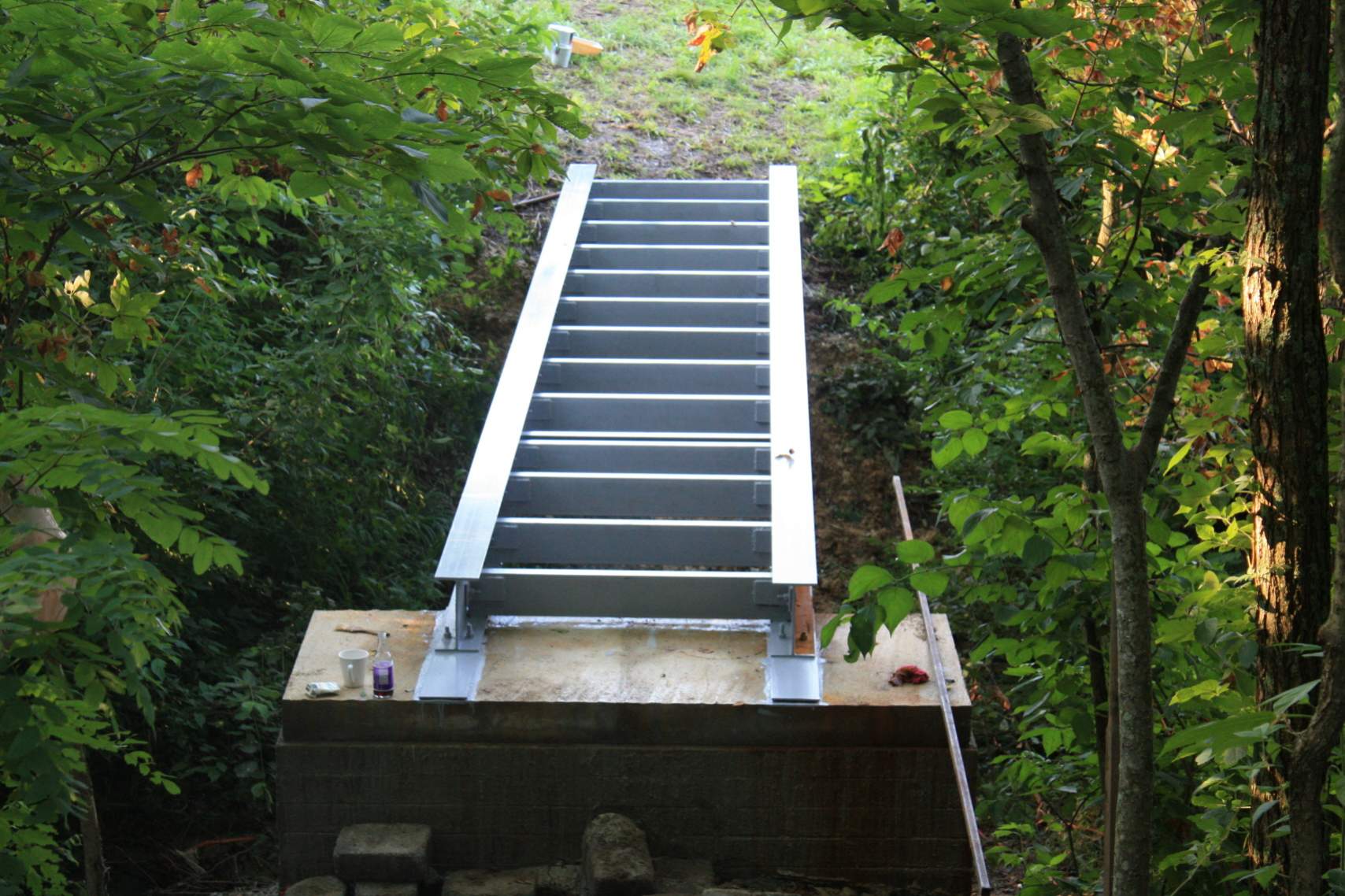

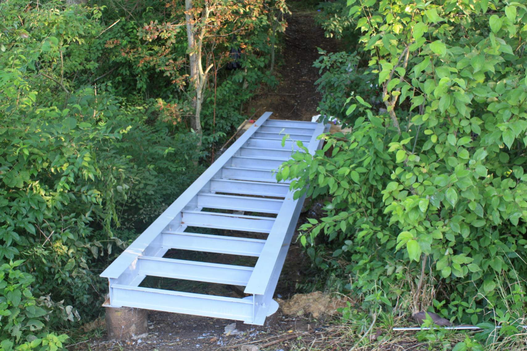

/ Bridge#2

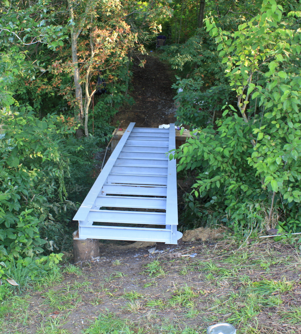

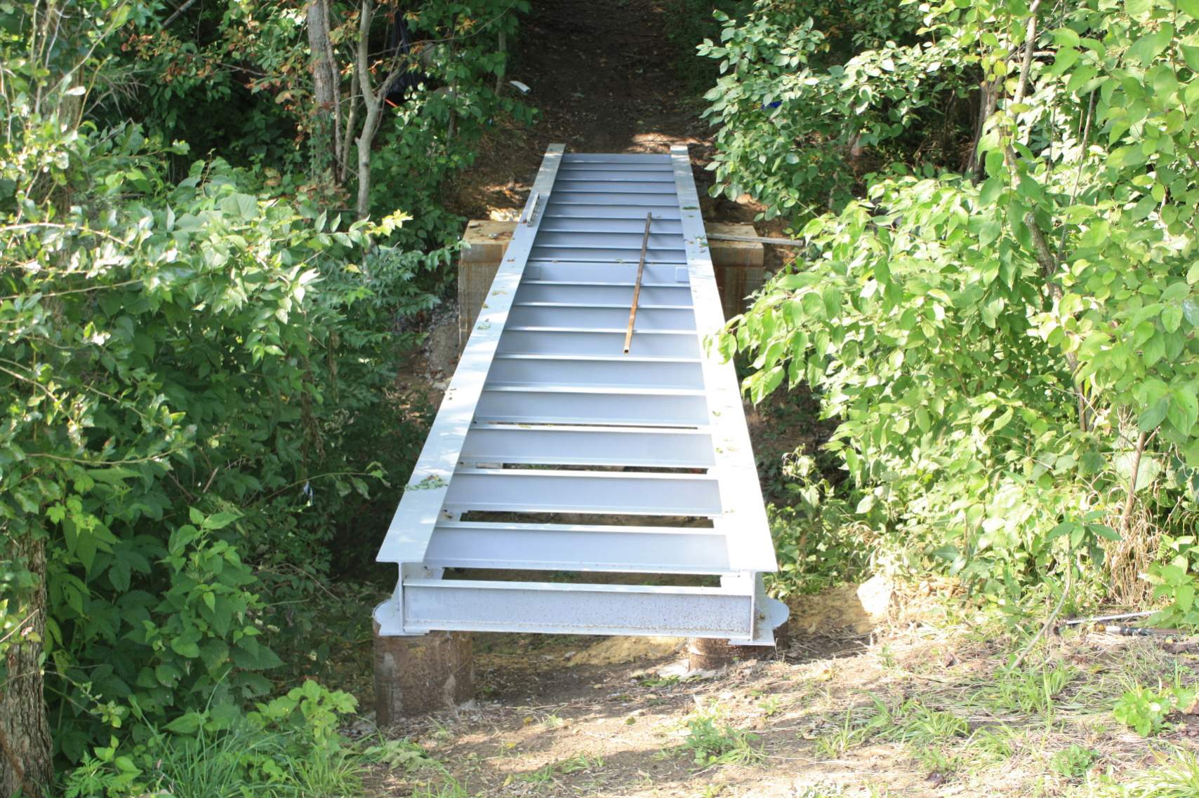

#38
Crossmembers in, acid treated, and painted on the 25' section. I used the garage floor paint, and it seemed to work well. The cross-braces are bolted in with grade 8 bolts.
