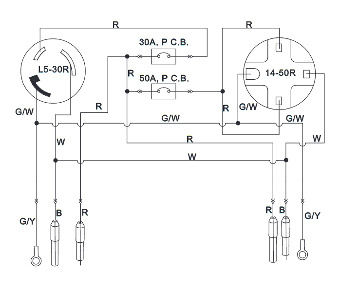

Here is the wiring diagram for the generator link device:
Looks like both hot wires (one from each generator) come in, feed into the 30 and 50 amp breakers, then go out to the hot on the 30 amp receptacle and both hots on the 50 amp receptacle.
The neutrals are connected together and to the neutral terminals on the receptacles and the grounds are similarly connected to the ground pins of the receptacles.
That gives it 120v from either hot to neutral and 0v from hot to hot (vs the 240v that is normal).
As such, anything that uses 240v only will see 0v and wont work (most will have a 3 wire cord). Anything that uses both 120v and 240v (most will have a 4 wire cord) will have the 120v part work, but not the 240v part.
I would love to use an interlock kit rather than a transfer switch. Much cheaper and easier and just as safe. However, my sub-panel (Siemens) does not have a main, only branch circuit breakers. The main for the sub-panel is in the outside panel.
OK, I have another confession to make. I do own a 5500 watt 240 volt generator. It is loud as all get out and the voltage fluctuates pretty wildly when a load is applied (like a compressor starting on a refrigerator, freezer or window ac). I'm very concerned about my electronics using this generator. I CAN use it if I have to. I just don't really want to if I can help it.
The 240v generator has a bonded neutral. (I just checked it) I know the smaller ones have a floating neutral. (Checked them too) If I do buy the 100 amp transfer switch I still do not know how to hook up the neutrals or grounds from either generator. That has been my only question from the beginning of this post. THANKS for your help and advice. I really do appreciate it.
Given that the generator will be running outside, I would install (or given your apparent experience level, perhaps have an electrician install) a transfer switch outside (after the breaker in the outdoor breaker panel), or with an interlock on the main breaker of the outdoor panel with a NEMA 14-50 inlet such as: Conntek GISB5-25 NEMA 14-5 Power Inlet Box & Power Cord Combo
then plug your generators into that, or a larger generator down the road.

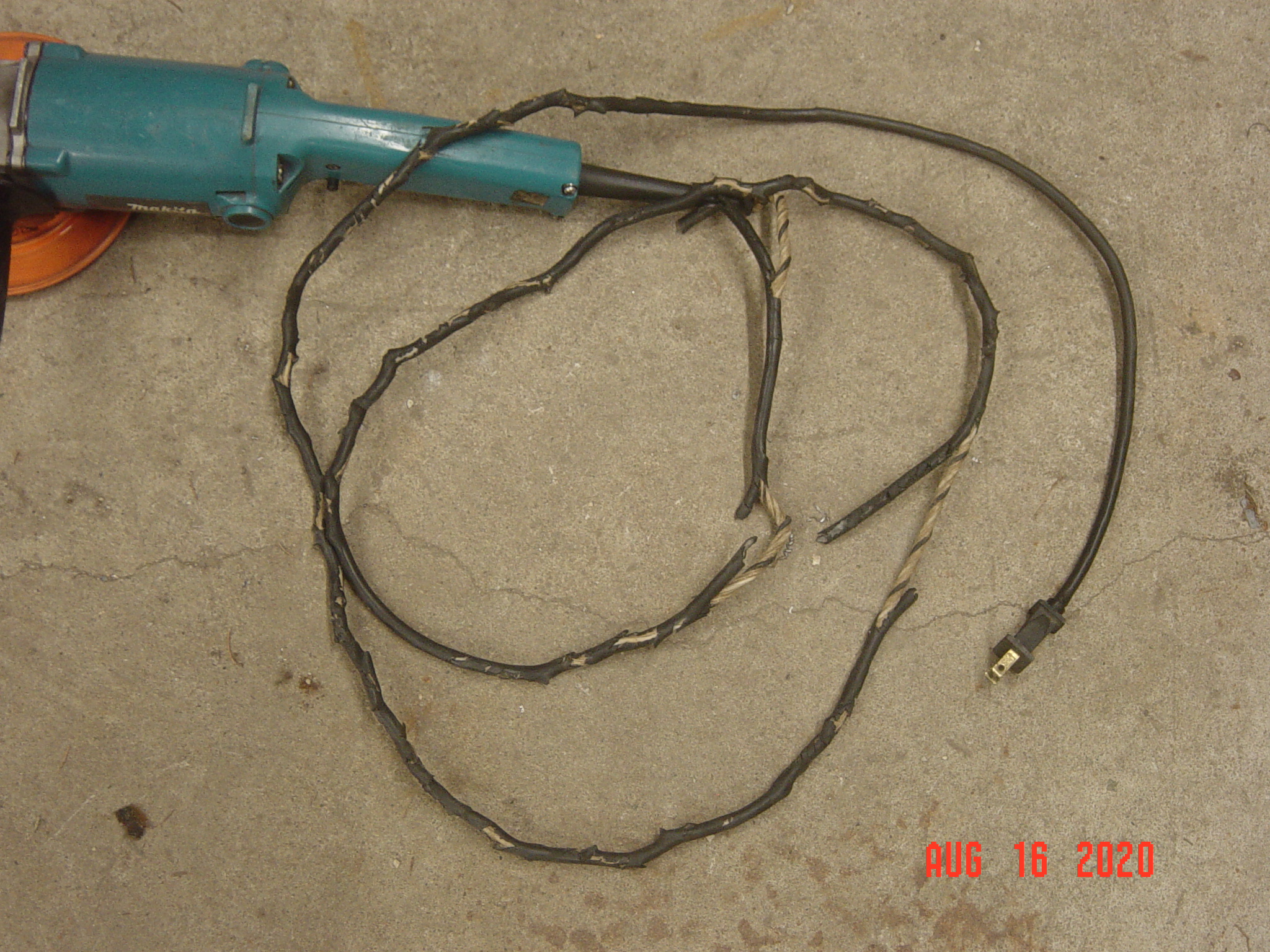

Makita could learn a thing or two about cab-tire I think. My favourite grinder had such a nice cord over my other Chinesium units. Their cords are still as stiff and ugly as new though. Happened when not that old. I have nice flexible cab-tire as old as me!

The picture I posted shows that its just a 120 circuit. Just because there's 2 120v slots on the plug makes it no different than having 10 receptacles in a room and thinking you have 100 amps of power! The 120v leg is being divided into 2. Trying to cobble this setup to a sub panel isn't worth all the hassles and potential for a fire or mishap to take place! Get a generator that provides 240v and generator sub panel or transfer switch. It'll be safer and what if someone else has to hook it up due to you being out of commission!
/ ANOTHER ELECTRICAL QUESTION #99
Someone won't be fussing when they can flush the toilet or take a shower when all the other neighbors are sitting stinking in the dark.... :laughing:
We had a power outage the morning before that big wind that wiped out much of the midwest last week. I had the generator up and running within 10 minutes so my wife could take a shower and go to work, because she couldn't work from home because we had no internet for her. Hubby to the rescue. :D
Setup the little generator during a power outage the other day, ran a fan and a window AC and made the wife happy. Something about no power when its 85 with 90% humidity...
No, 2 28.8 amp 120v legs (3400W/120V=28.888888A) are being combined into 1, run through a 50 amp breaker, then its being made available to both legs of the plug.
Cant pull more than 50 amps at 120V or it will trip the breaker.
Set the panel up like I said and there wont be a risk of a fire or other catastrophe and the OP will be ready for a larger generator down the road if needed.
Aaron Z

That generator link device putting the same 120 volt phase on both hot legs worries me. I know it will work for what the OP has described, but it will be a hazzard on a multi wire circuit since the neutral will be carrying the sum of the 2 hot wires. And multi wire circuits are not obvious when you look in the breaker panel.
