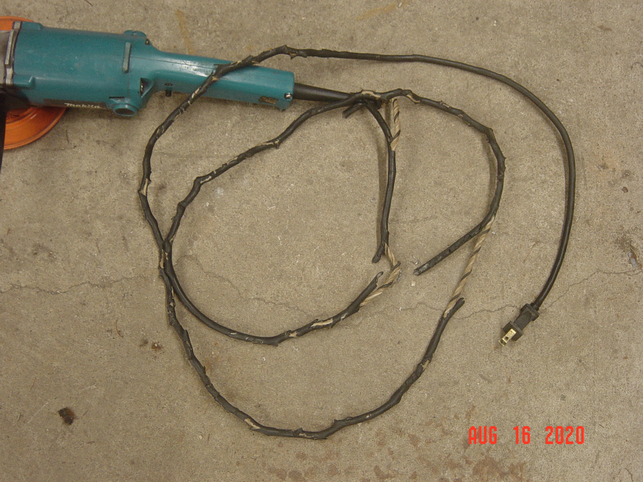

Makita could learn a thing or two about cab-tire I think. My favourite grinder had such a nice cord over my other Chinesium units. Their cords are still as stiff and ugly as new though. Happened when not that old. I have nice flexible cab-tire as old as me!
