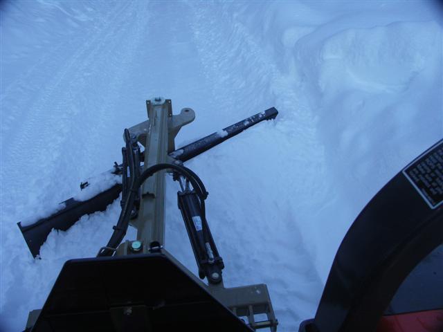

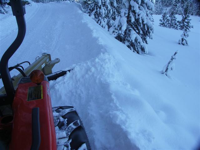

I finally got a chance to get some pictures of the blade in action. The first one is the first pass through 6-8" snow. The second one shows the blade offset and in action "winging" back the tops of some berms. The there is a fair hill off the side, the tractor wheels are on the road, berm is well over the edge.

Nice, looks like 2' of offset?
By the 2nd. pic it looks like maybe if the blade was raised it might push more snow off the top and down the hill instead of banking up as much. or was that intentional to create a natural guard rail?

I find "winging" berms to be a balancing act. As you say, the blade could be higher, somewhat more snow might fall down the far side, but then you have to make more passes with the blade lowered each time, to move the whole thing. It's not clear from the picture, but the blade is up maybe 3-4" off the ground. Without chains I am definately traction limited, if I try to grab too much on a pass I get turned sideways. I'd guess you're about right, 2 maybe 2 1/2' of offset in that picture. It will offset further, but the angle is kicked all the way in that pic. If it's offset further the blade is squarer (less angle) with respect to the work direction, there is more of a dendency to grab and turn the tractor, plus more is pulled back onto the road. I'm finding there is quite a knack to working most efficiently with this thing, still learning. I'm planning on chains for next winter, too broke to afford a set right now.
