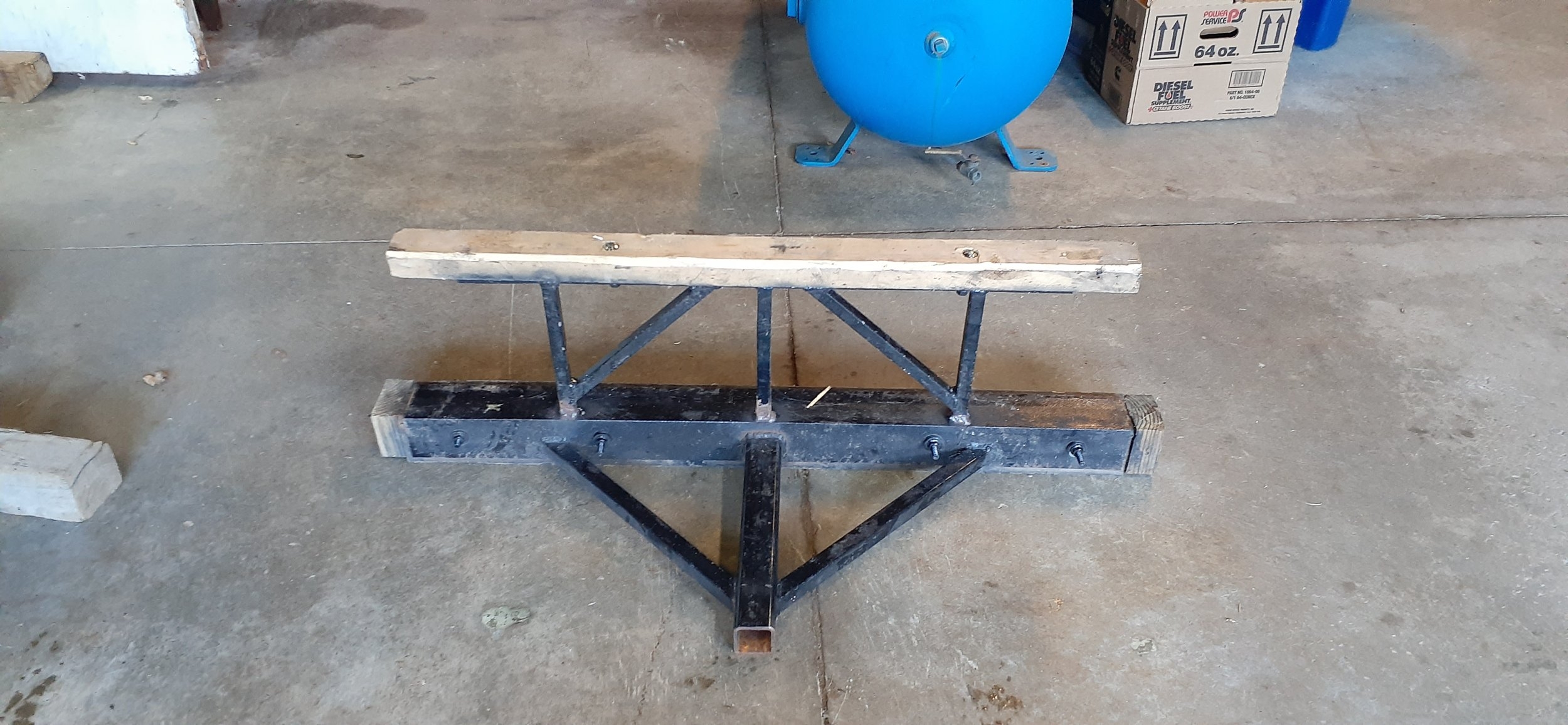

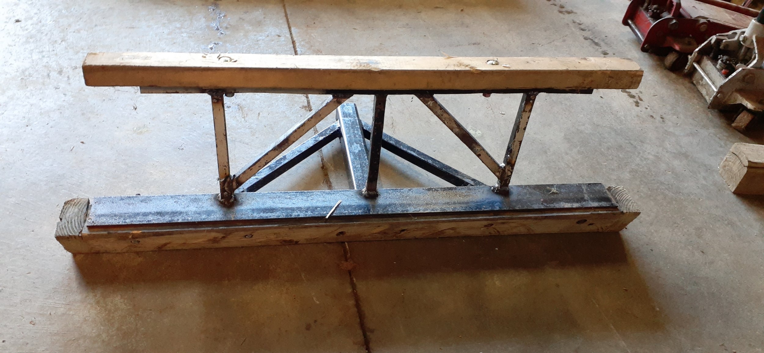

I fabricated my FEL plow from steel, on a low budget.
There are lots of plows, and parts out there used.
Unfortunately, now is obviously the worst time to get one cheap.

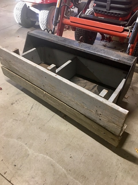

I made one, 4 years ago. It was easier to install/remove, as it sat insde my bucket. Like this guy here:
Mine is beefier than his cuz I used 2x8, I made it to follow the curve of my buckets sides. It doesn't break because i got 2 supporting upright pieces inside the bucket spreading the pressure and cutting the moment of force produced by snow weight. I covered it with old sheet metal for protection. It slides on a bedframe angle iron that i replace every other year depending on wear. The sides are 2x6 lagged and reinforced with angle iron and rods. It works awesome with the snot we been getting these last couple years instead of snow. The blower is useless in the wet stuff,
My 2 cents. Good luck

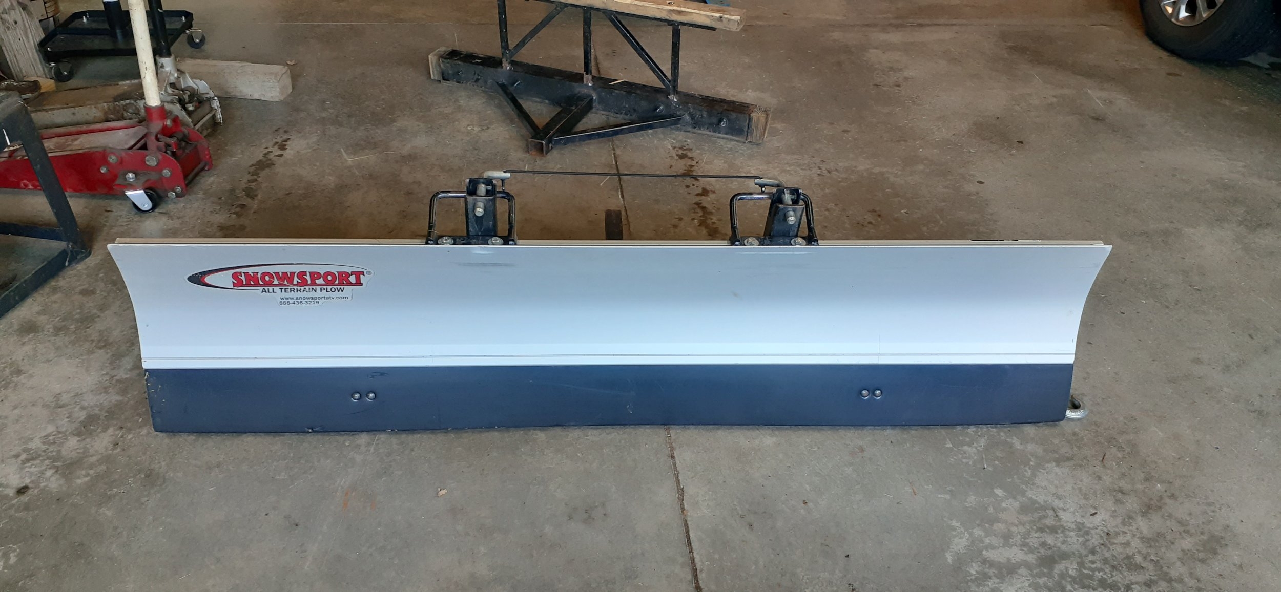

This is the setup I made for my Massey. I found a used ATV/UTV blade and hitch online and bought it, not cheap but a real nice blade. 60" Aluminum, could angle, with a large thick rubber edge.

I could not back drag with this because the blade is meant to lay down when reversing. This was built for an ATV/UTV with no lift.
I could push snow well into the ditch, or stack it high, because it stuck out so far in the front of the bucket.
