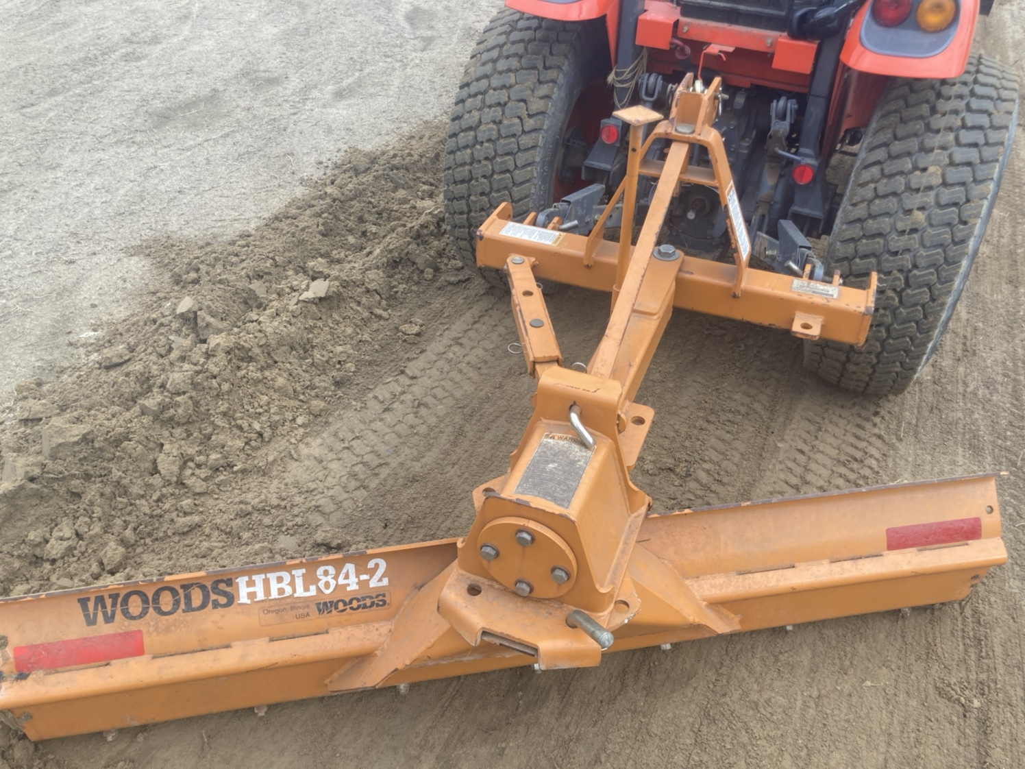

That is a really nice blade!! Have you tried adjusting the top link of the 3 point hitch? If you make it shorter the edge will not cut in as much and if you make it longer the edge cuts in more. This theory also applies to when the blade is swung 180 degrees which is better for smoothing loose material.
Just trying to help.
Thanks, yes I shortened the top link to get it to lift enough to transport. I'll keep using it while I look for another one so maybe I'll get more comfortable.

I HAD that exact Woods blade. What a piece of junk. Could NEVER keep the bolts tightened. The bolts eventually broke, I replaced with grade 8 bolts. Still could not get bolts tightened to keep blade angled. Traded in for another Woods blade without the extension option. Very happy with new blade.
/ Rear Blade Adjustment Preferences #89
I also have that blade. Totally agree the bolts are a complete joke. I finally mounted a side link to adjust the tilt. Lost the offset but well worth it. Its not a super heavy blade but it works surprisingly well.

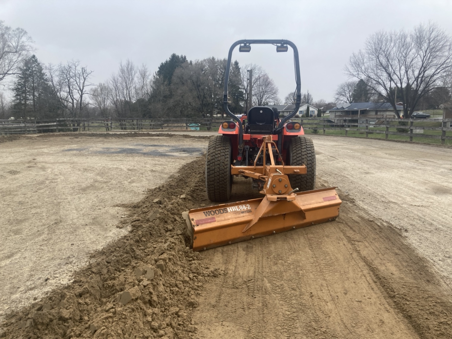

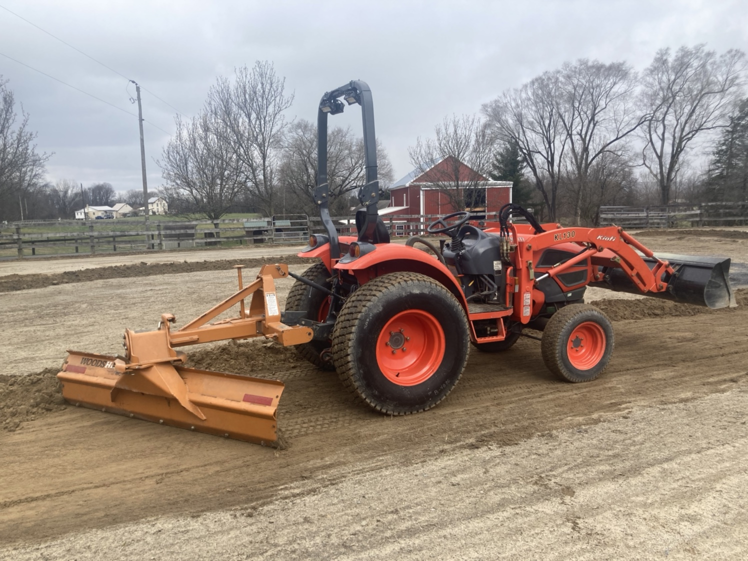

I borrowed on old 7 foot blade that only angled, it was pretty light but worked well scraping the footing in the arena. So then I bought a Woods 7 footer last week and find it too heavy for my uses. Not only does it feel really heavy when transporting (manual says it’s 565lbs), it digs in too much in the material I’m moving. I have to adjust the level constantly, can’t let it float like I could with the lighter blade. Also, the lower lift points are really high so I had to adjust my lift links and it still scrapes on inclines. This blade would be great in harder material, but my uses are loose material and light snow so I’m going to get a lighter one. Live and learn.
View attachment 739337View attachment 739338View attachment 739339
Maybe try rounding off the cutting edge a little with a angle grinder? Or just run it backwards?
For just a general smoothing in an area like that, back dragging with the loader is good and just adjust the bucket angle to suit, or an atv dragging square of chain link fence with a fence post or two on top.
I also find running a boxblade backwards with the tilt adjusted with my hyd toplink is very good for smoothing out loose gravel without moving too much of it.
