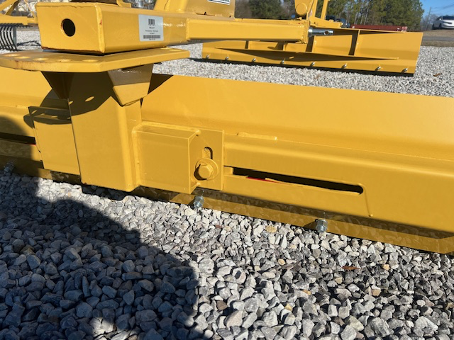

I am considering purchasing a Rural King by King Cutter professional series rear blade. I am concerned though that the tilt and offset features both are adjusted with the same bolts. (see photo) Should that be an issue in any way? For one, I would think a quick adjust pin would be better than having to use a wrench or socket to make the adjustment. If you have this blade, how do you like it?

Would be helpful to see a few more pictures.
Looks like the big bolt in the picture might be used to slide the blade to the right or left, are you sure it’s also supposed to be used for tilting the blade ?

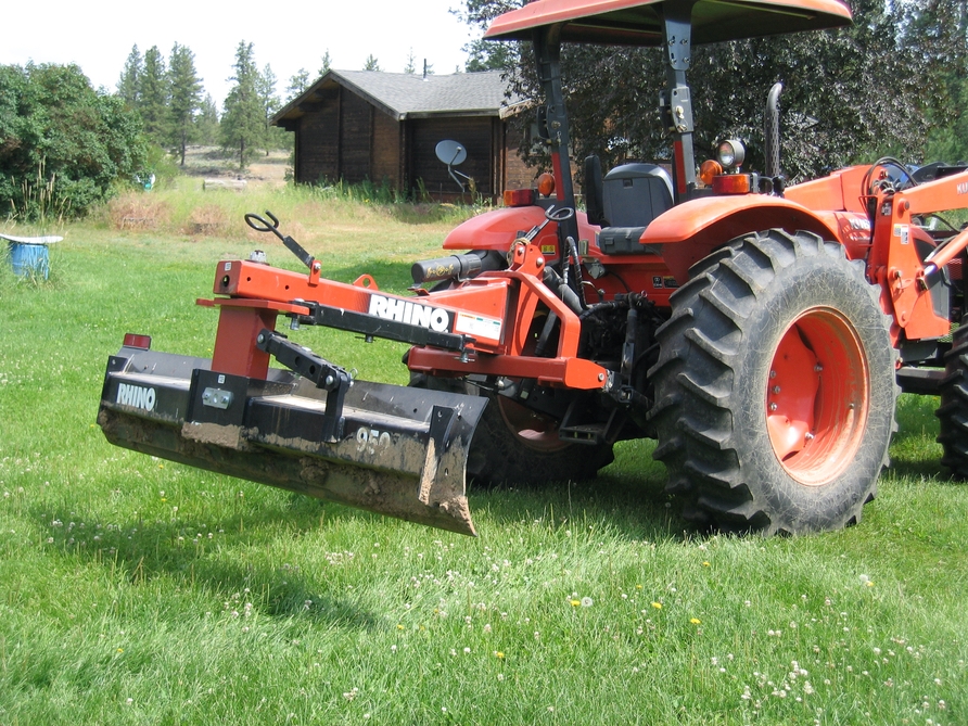

I have a VERY HD Rhino rear blade - 1000#. It's on the tractor most all the time as counter weight for my grapple. Along with the 1550# of RimGuard in the rear tires.
All the blade functions are by pulling a pin and relocating it.

I have one like that, I use a cordless 1/2” impact to adjust it, it stays where I put it.

If you want to actually use the offset and tilt features, then pass on this blade. I had one like that and found the bolt adjustable feature to be really unhandy, especially when you get a bit of rust on the bolt. I bought a Bison blade with pin adjustment for both tilt and offset and now I actually use those features.

Dont buy this style of rear blade. The edge has next to no support. It almost alreaty looks bent in this pic.

The problem with those blades that adjust by bolts is you can’t quickly change the offset while using it. For example, while plowing snow or grading gravel, I like to make the first pass on either side of the road with the blade offset to push snow into ditch or pull gravel from the ditch. Then I like to spin it 180 degrees to do the road center with the back or the blade, so I don’t start moving gravel. This is possible with a pin offset blade.

Bolt adjustment is out of date. Mine is pin adjustment.
See post 6 by oosik. The adjustment is faster/easier and you will be MUCH HAPPIER with a pin adjustment style blade, and find you can do a lot more with it.
