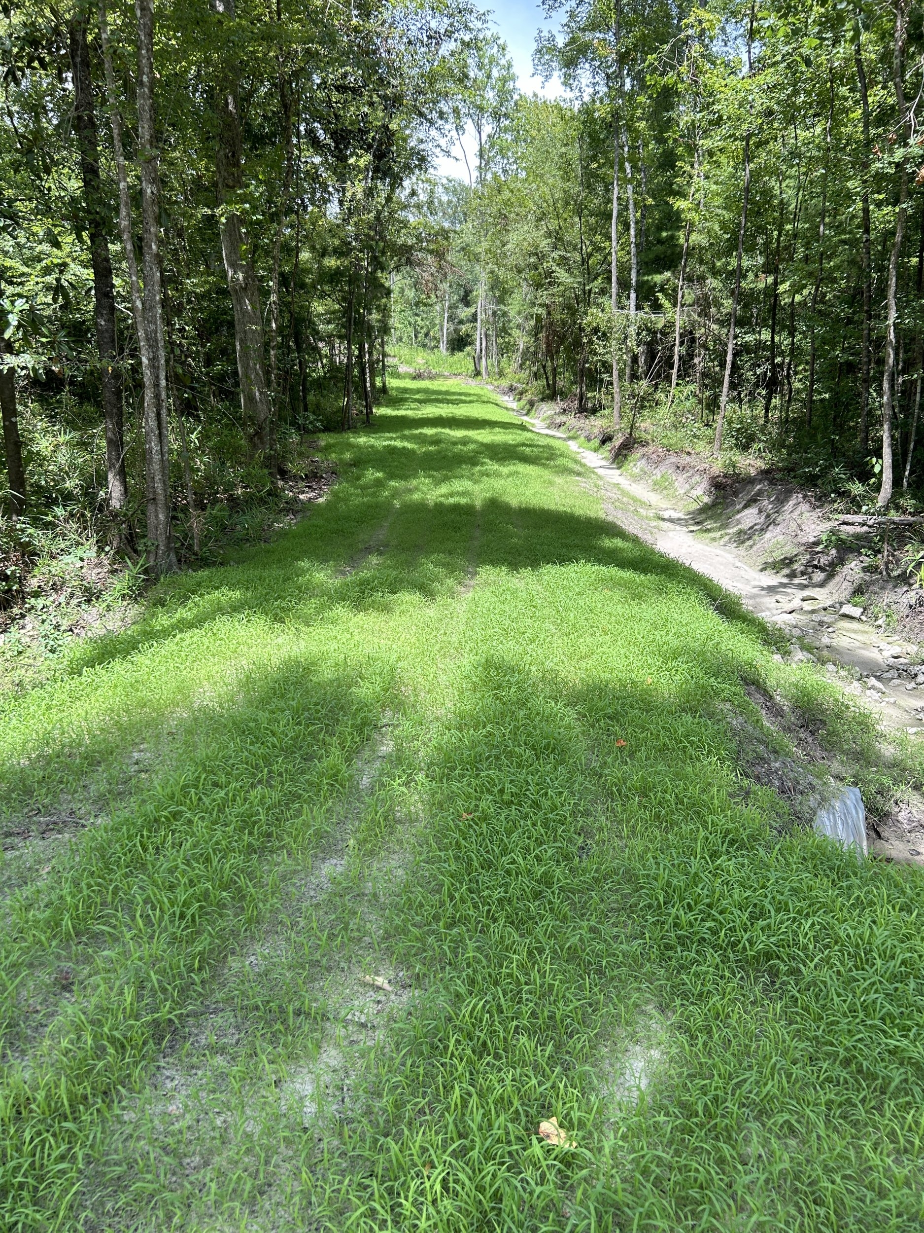

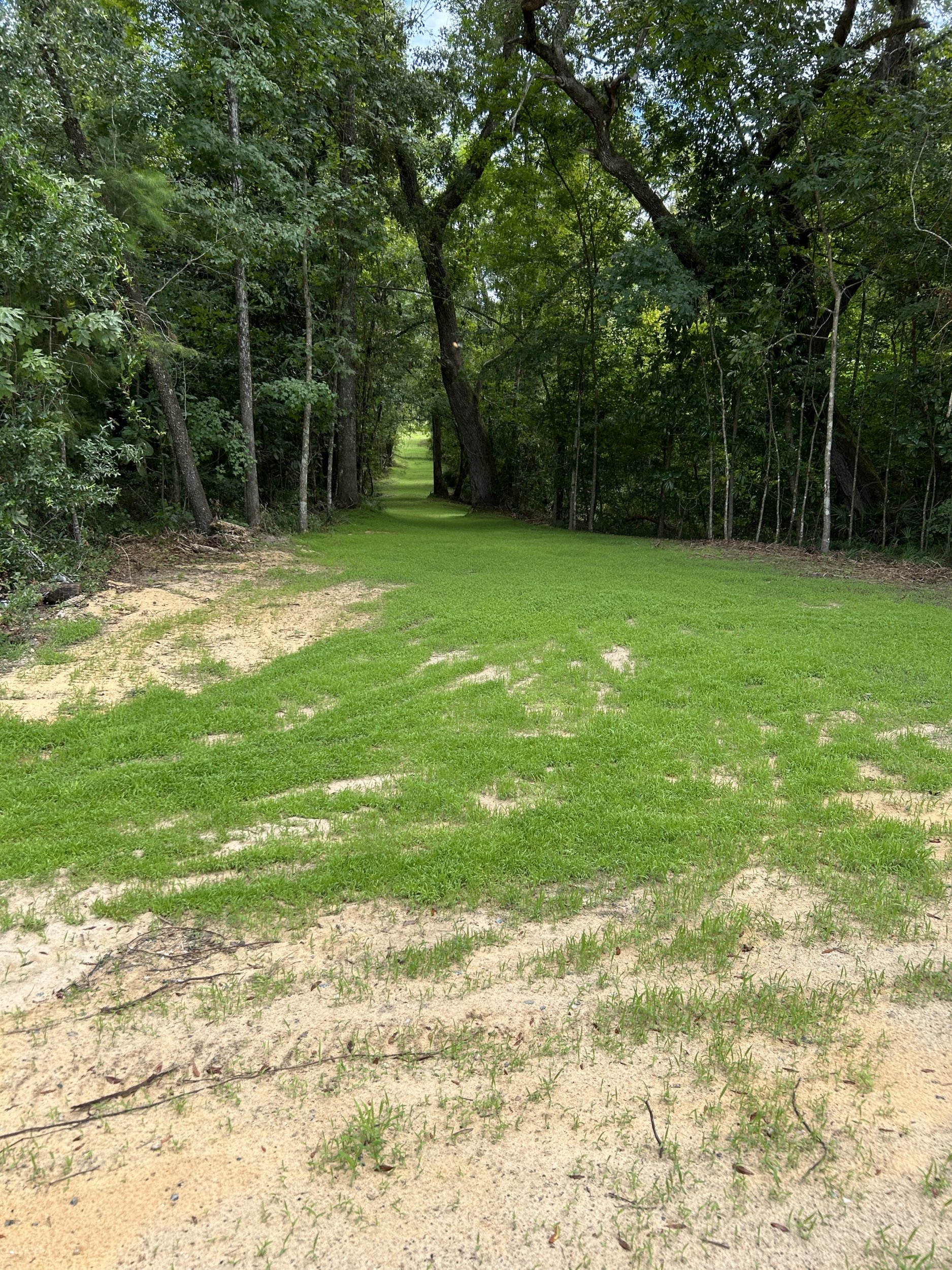

We’ll be putting in on large (but not huge) personal garden.
Now that logging and clearing is done I’ve also added a lot of vehicle width trails around and across our 80 acres. I have a feeling it would get used more for trail maintenance and smoothing until we can get compactible organics built-up in the soil and get the erosion under control.
If I had to guess, 10–20 hours a year. Possibly more depending on washouts and trail condition.

RTA1274 will be entirely adequate for your expressed applications.
