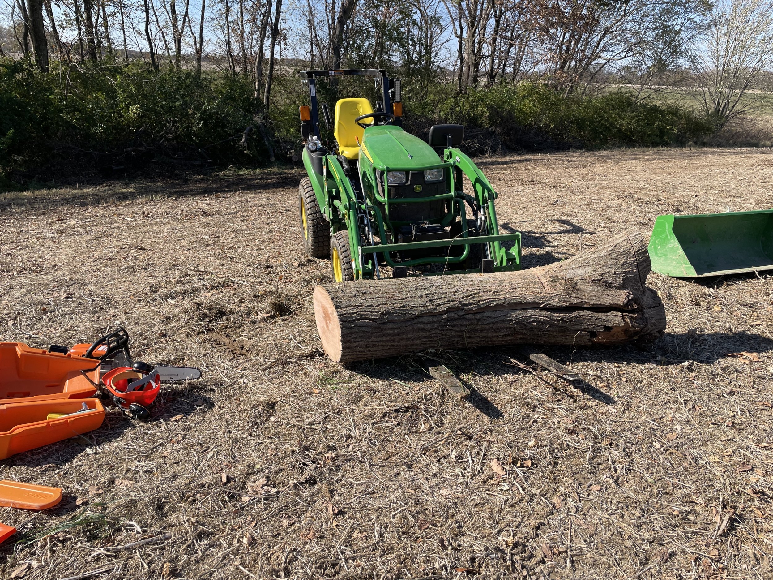

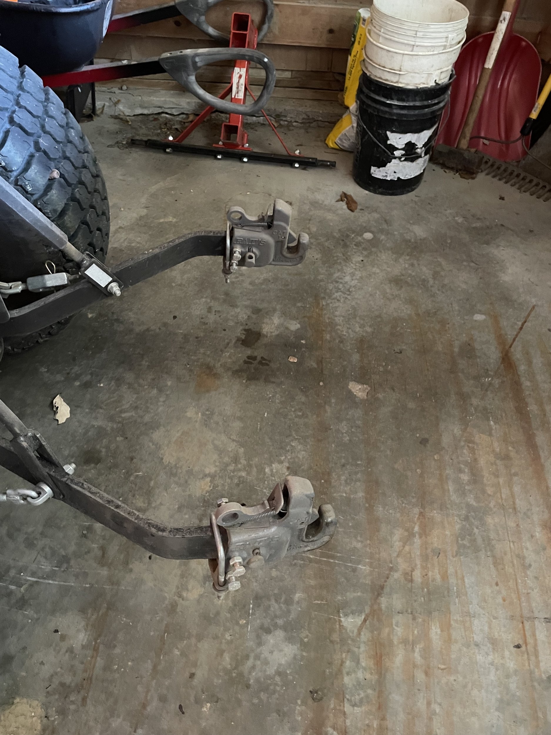

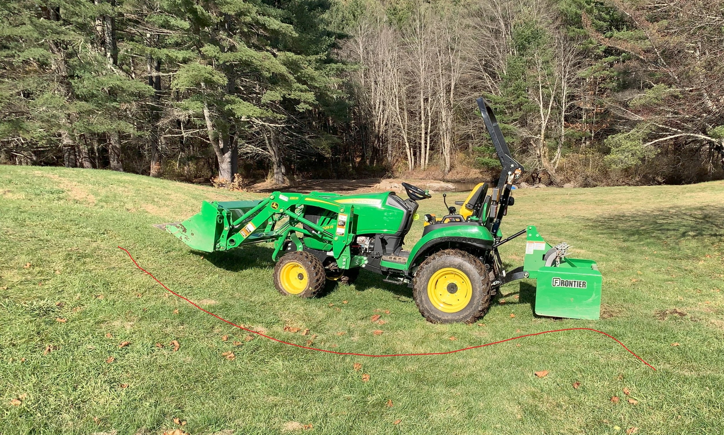

Last but not least, enjoy it. It’s a great toy tool. A recent picture of mine.

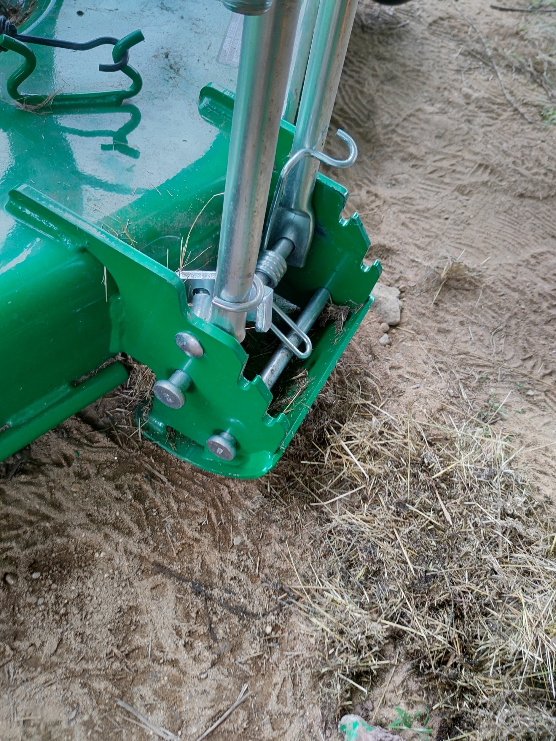

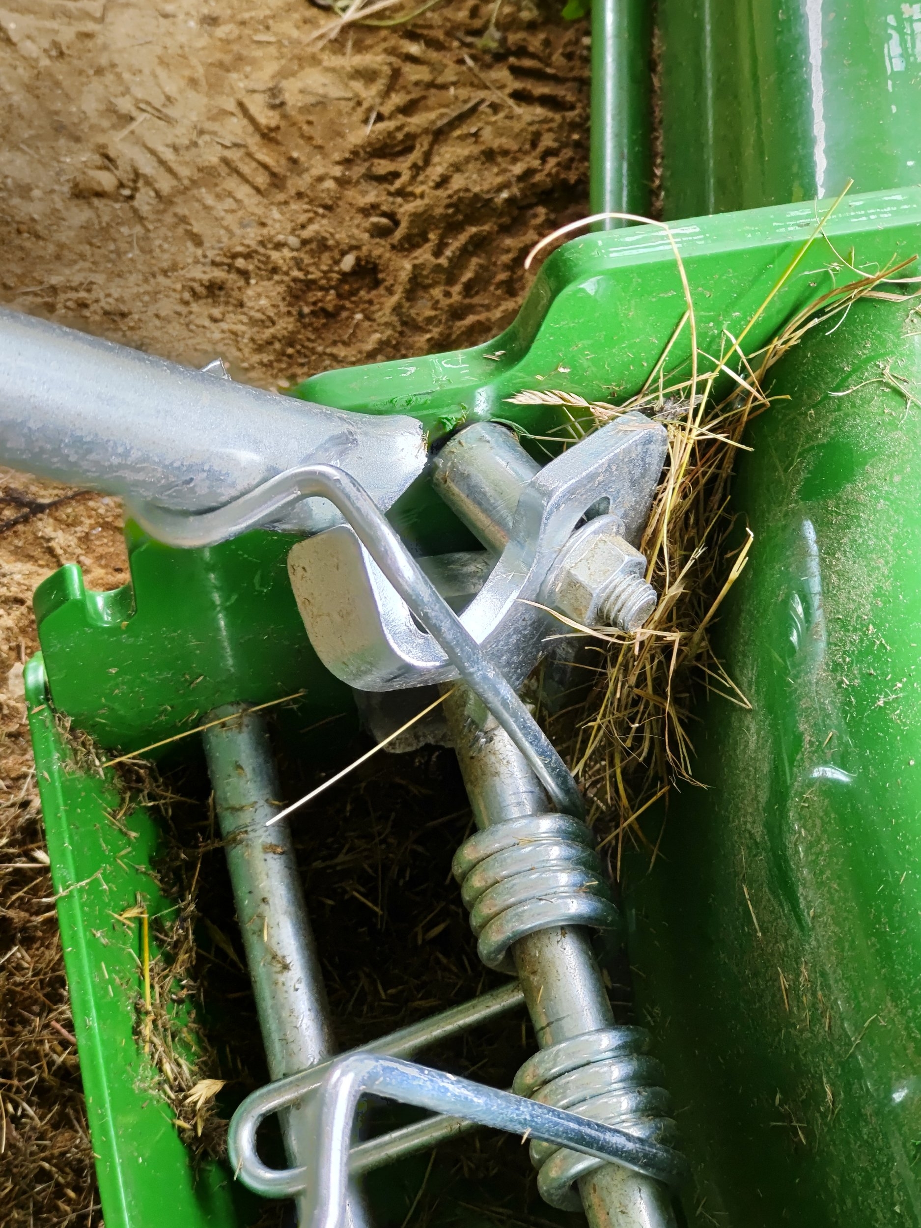

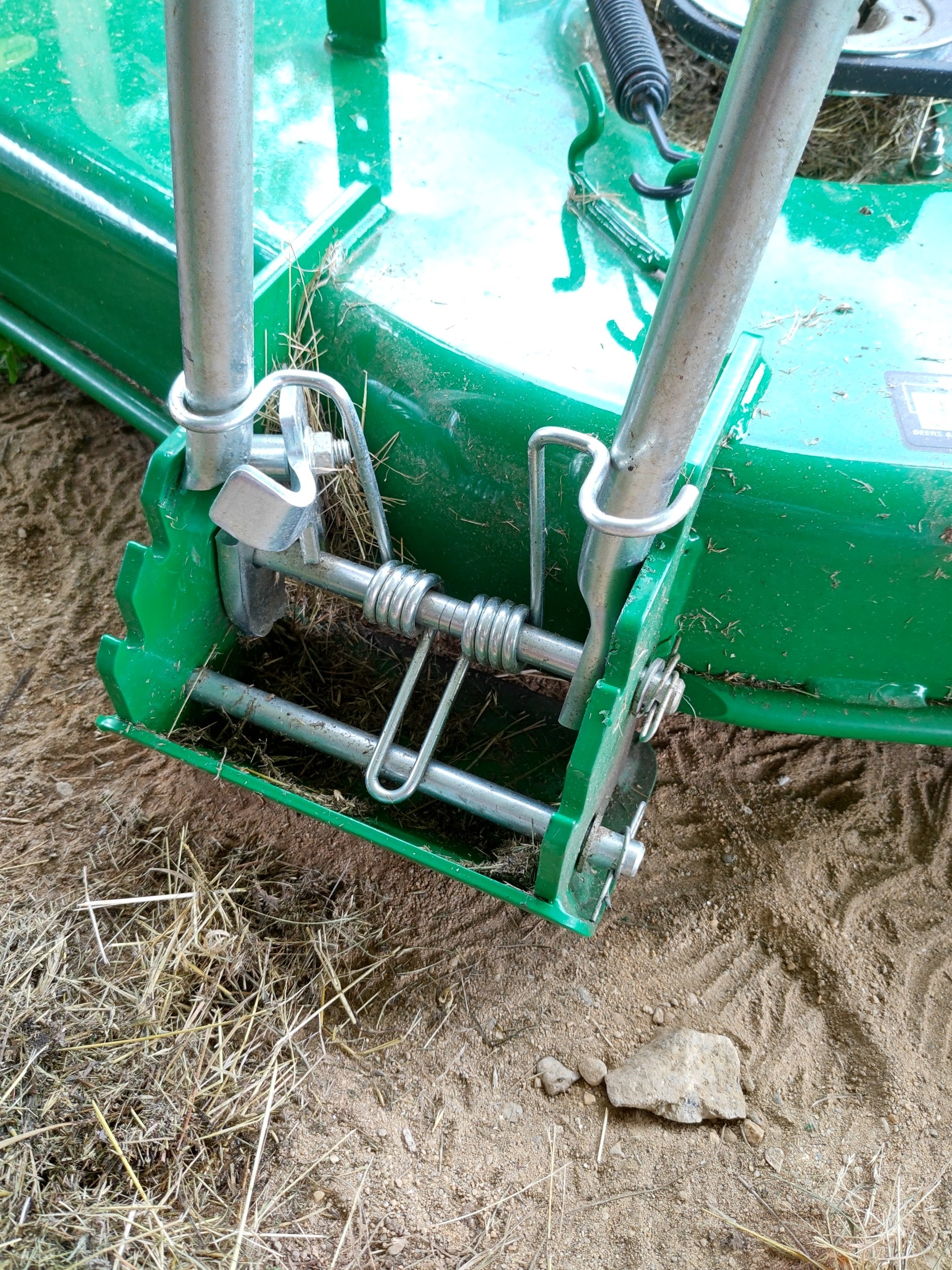

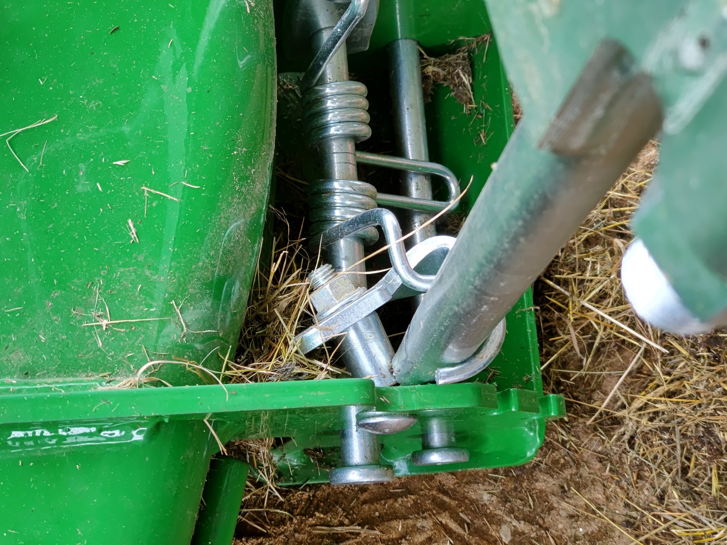

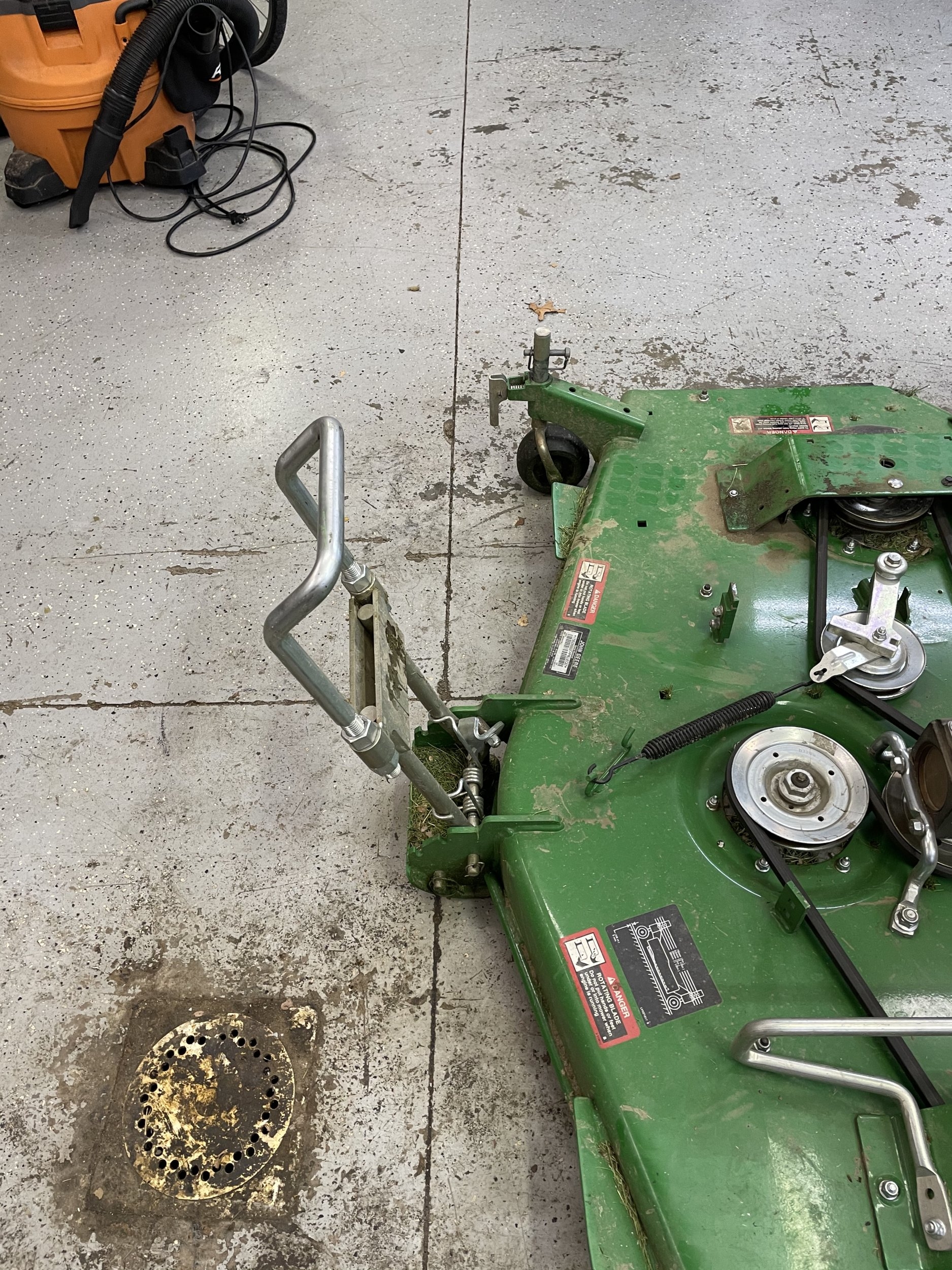

Well you beat me to it, one of the things I was going to write up was how I broke my mower deck attaching it the first time!
I had a very difficult time removing the deck. The right side released OK, but I could not for the life of me get the left side off. I ended up having to use a 2x4 for leverage under the deck, and a crowbar to force the locking pin far enough away from the bar it locks into to flip it up.
When I attached the deck next, I'm not sure exactly what got hung up where but I was having trouble getting the deck to attach. Lots of forwards and backwards and repositioning. Well, one time while backing off the deck, I hear a "pop". Expensive mistake.
I later came across Adjusting The Auto Connect Deck Deere 1025R/1023E and leaned that the front adjustment was too tight. There's supposed to be 2-3mm of play and I had zero! It was tight up against the end of the link. After adjusting the deck properly, it's now very easy to put on and off. I question what the "setup fee" was for from the dealer...

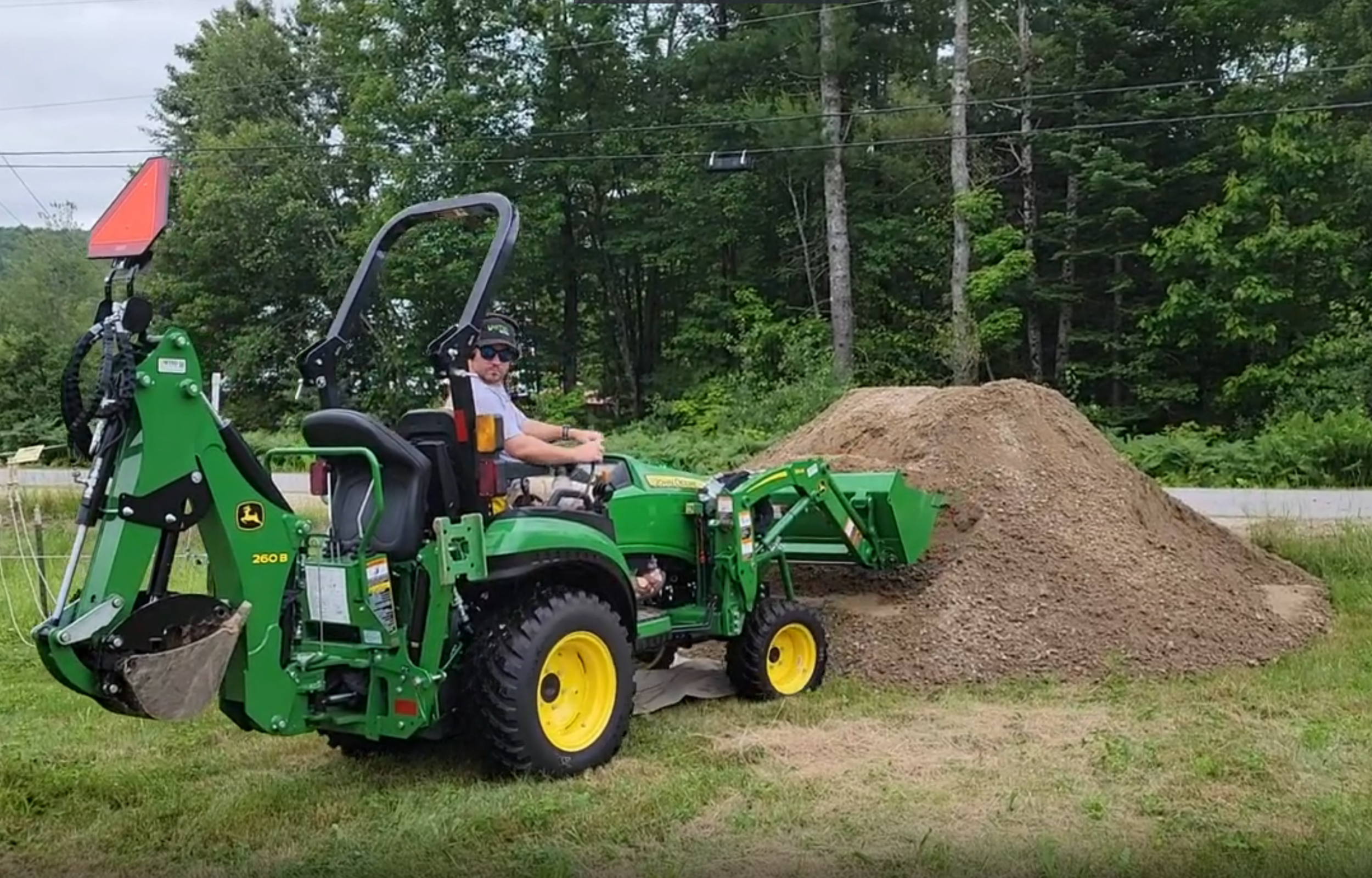

I can see your first picture now. You’re a little younger than I expected. ;) I’ll share a picture of my bent bracket, I’ve done it more than once. I actually tied surveyors ribbon around those two pins you pull out to make sure the loader is off when I remove the deck. It definitely is hooking the loader stand. I’d ask for free parts to fix it. Did they warn you? Believe it or not you can still install the mower deck the way it is bent.

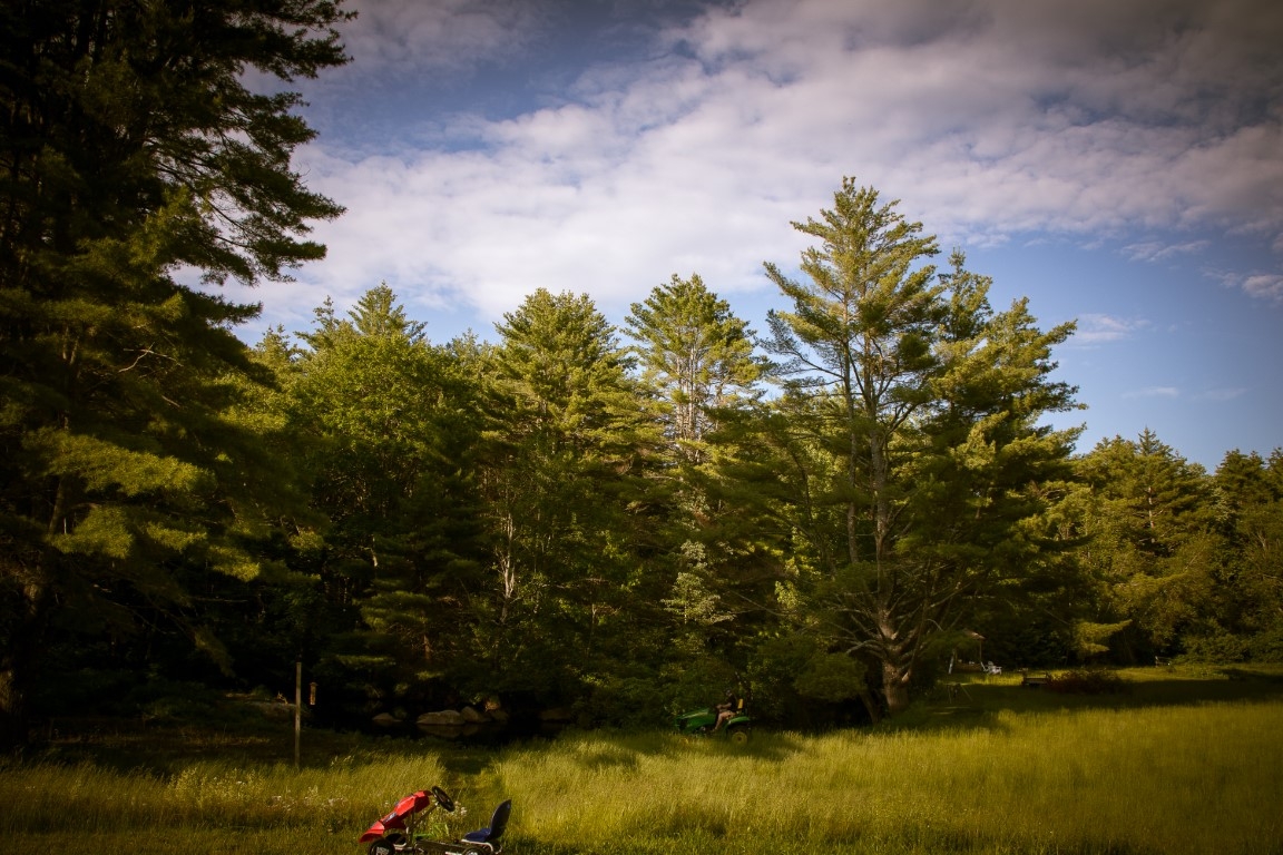

First job I had for the tractor was mowing. I typically participate in "no-mow may" as we have a ton of wildflowers through the yard and neighbors have honey bees. The first mow is usually pretty heavy. I have been tackling it with the flail mower on my Grillo and it does a great job but it takes a long time. I had a mechanical issue and fell even further behind this year than normal, so I didn't mow until June 15th (day after delivery). Tractor was delivered with the mower attached so all I had to do was remove the FEL and BH and off I went.
I figure a few hours of mowing would be a good break-in. Dealer didn't mention anything specific for a break-in and I didn't see anything in the manual either, so 3200 RPM it was.
The grass in the picture is probably the thinnest part that I had to cut. There was a lot of thicker stuff elsewhere but I guess watching me mow quickly became uninteresting so no pics!
I was pleased with the cut, but it naturally left a lot of materials behind. The flail mower does do a better job, but easily would have taken twice the time. There were also a few spots I avoided - some of the wetter areas where I was afraid of getting stuck, and along the road where the pitch gets pretty steep and the pucker factor kicked in.
The hydro is so nice for mowing compared to the gears on the 2-wheel. There are many times I want to keep the engine at a certain RPM to keep the implement spinning, but need to slow down. Mowing with the flail was always somewhat awkward. 2nd gear at full RPM was a touch too slow, but 3rd gear is pretty tall so I'd either be a half throttle or running.
Adding the mower was a luxury rather than a necessity, but after the first mow I'm not complaining. I'm glad I went with the 60" over the 54", it's particularly useful having that bit of extra width when mowing under the fence line and tight up against obstacles. The load-and-go is a fantastic add-on and makes moving and storage a piece of cake. As mentioned above, once I followed the adjustment guide, taking the deck on and off is breeze as well.
Overall: expensive implement, but happy with the result. No ruts in the yard. Scalped in the usual places I do with the flail mower. Used 21" push mower to hit the areas I avoided with the 2025R.

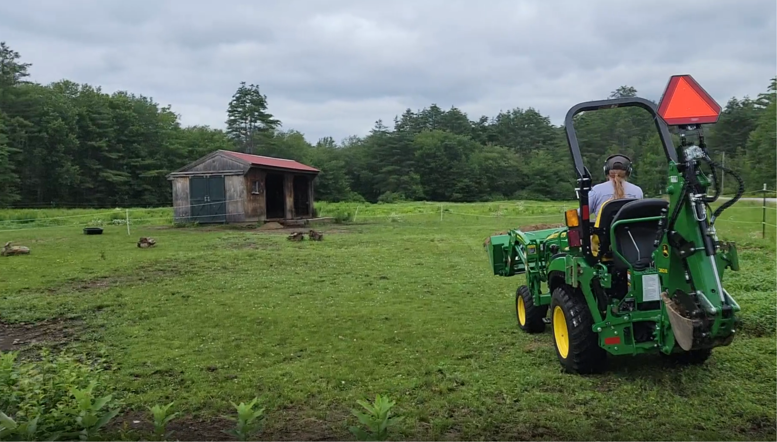

2nd big job was improving the footing on our run-in shelter in the big paddock. 23 tons of rock was dumped
and moved.
I had already set up a wood frame and filled it with dirt, but it had been packed down, rained on, and heavily trodden on over a year or so. It turned into big step-downs and mud.
Those big clumps you see are actually big stumps, they washed into the paddock during the spring flood. I picked those up with the loader and put them back at the wood pile. Nice!
I think it took me about 3 hours to move all the stone, make the grade, smoothing things out, and then scoop all the poop out of the shelter and put it in the low spots. Very happy with the Hydros Plus kit - kept RPMs around 2300 to balance flow rate, ground speed, and noise and it was really nice to be able to reverse, operate the steering wheel, lift, and curl the bucket, all at the same time. I was also happy with the size of the 2025R because I could drive right into the shelter and fill up the bucket with manure without having to touch the ROPS.
(Near) final result:
The ground here is REALLY soft, and I was really happy that with the full weight of the TLB and a bucket full of stone that I didn't leave any permanent depressions. I felt like I made a good choice on the size of the tractor not being too heavy.
Sure beats a shovel!!

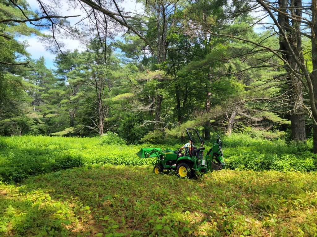

We have a section of land, about 1/3 acre, right up against the river that has a Japanese Knotweed infestation. It's an invasive species up here and very hard to eradicate. Its stalks are similar to bamboo, it grows quickly, tall (8'+), is thick, and has a vast underground root system. I've finally been making some progress on destroying it and reclaiming the land. Because it grows so densely, one of the problems I've been having is mowing into obstacles. In addition to the usual rocks that wreck my blades, past owners of the property have cut down trees (and left them), wind and weather have downed some large branches that are hidden, there are thick bushes such as ironwood that are difficult to get at, oh and some past owners used to dump garbage there so I've found metal rods, gas tanks, wire, and other nasty stuff.
There is a very short window in the spring, after mud season ends but before there is too much growth to see what you are doing, to tackle this sort of project. In the fall, you mostly have to wait until the first frost kills the leaves of the knotweed, and hope it doesn't snow. This means there might be just a couple of weekends in an entire year that are ideal conditions to make progress. I finally started making progress last year, and was able to keep it up again. This year, I started early with my 21" push mower to cut the knotweed down and was able to keep at it every few weeks during the summer, not to kill it but to control it enough that I could get in there and work.
Today's goal was to dig out those few rocks I keep scalping so that I can get in there and aggressively mow with the flail mower, or ever the tractor, without risk of damage.
This turned into a bigger project than I expected. (surprise!) Here I am positioning the backhoe for removing rock #1.
During this project, I spent some time "playing" with the backhoe and trying out some more "advanced" techniques. To work on using all the controls with a light touch, I practiced keeping the teeth parallel to and right at ground level (just scraping the top without digging into it), while at the same time retracting the boom arm, which also means operating the dipper stick and curling the bucket to keep it level. The goal is to be able to go from full extension to full retraction and back while keeping those teeth right even with the soil without digging in. I think the HydrosPlus pump made this possible. I also think a small amount of practice every now and then makes me a better backhoe operator (and saves time in the long run). Plus, it's fun!
The other thing I practiced was moving the tractor with the backhoe. I didn't have any trouble pushing or pulling myself forward and back by manipulating the arms and curl on the bucket, or (aside from some slight puckering) lifting the rear of the tractor and pivoting using the side-to-side swing. I'm not sure if that's a machine-to-machine variation that some have the pressure set higher, or a capability of the 2025R over the 1025R (it shouldn't be according to the specs) but some comments I've seem imply that it's not possible with the 1025R. The pump kit should have nothing to do with it because I have not touched any of the pressure settings. Curious of others' experiences trying to move around with the backhoe?
