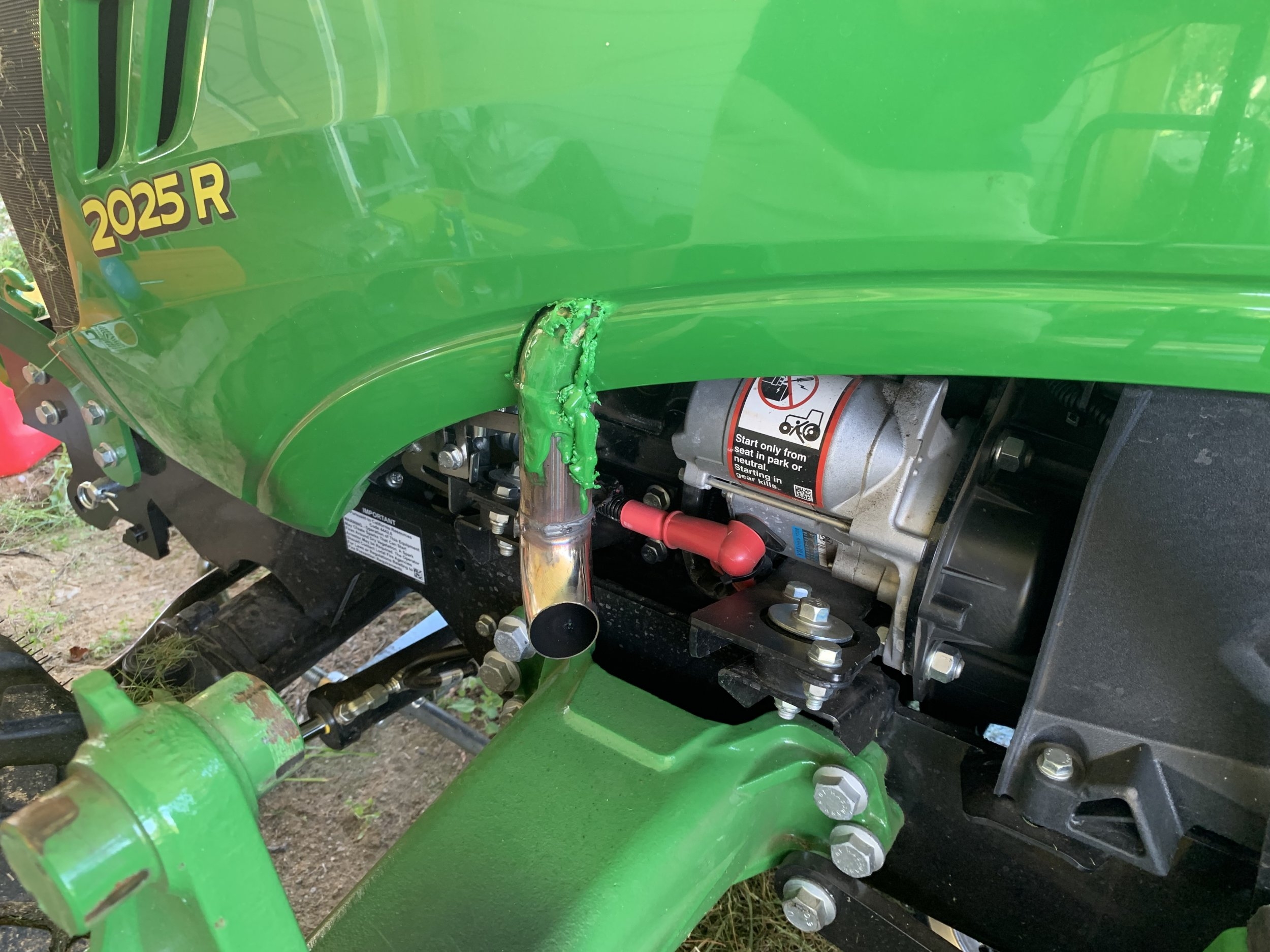

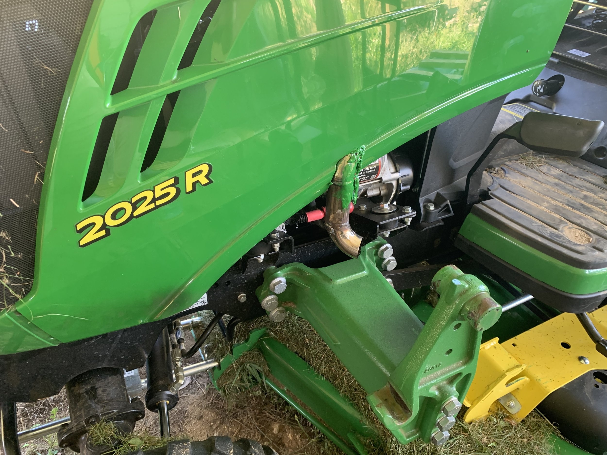

One thing that surprised me at the end of mowing, I reached behind me to hang my ear muffs up on the back and I touched the Summit Hydraulics manifold, and it was hot! Granted I was running full throttle for an hour and mowing hard, but I didn't expect the hydraulics to heat up that much from it, especially since it was a cool night, no sun, and with the Hydros Plus cooler installed (plus the plumbing and manifold is acting as a heat sink and radiator too). Can't imagine how things would have been with the stock cooler on a hot sunny day (even though I mowed exactly that way last season!). I'll try to grab a temperature reading next time I do a longer mowing session. I could really feel the heat pouring out from under the hood too. I worked the turbo hard going through lots of overgrown weeds in the horse paddock. Will be interesting to see how things go with the MCS running at full tilt. Mowing is probably the most consistent high-HP usage for these little tractors.

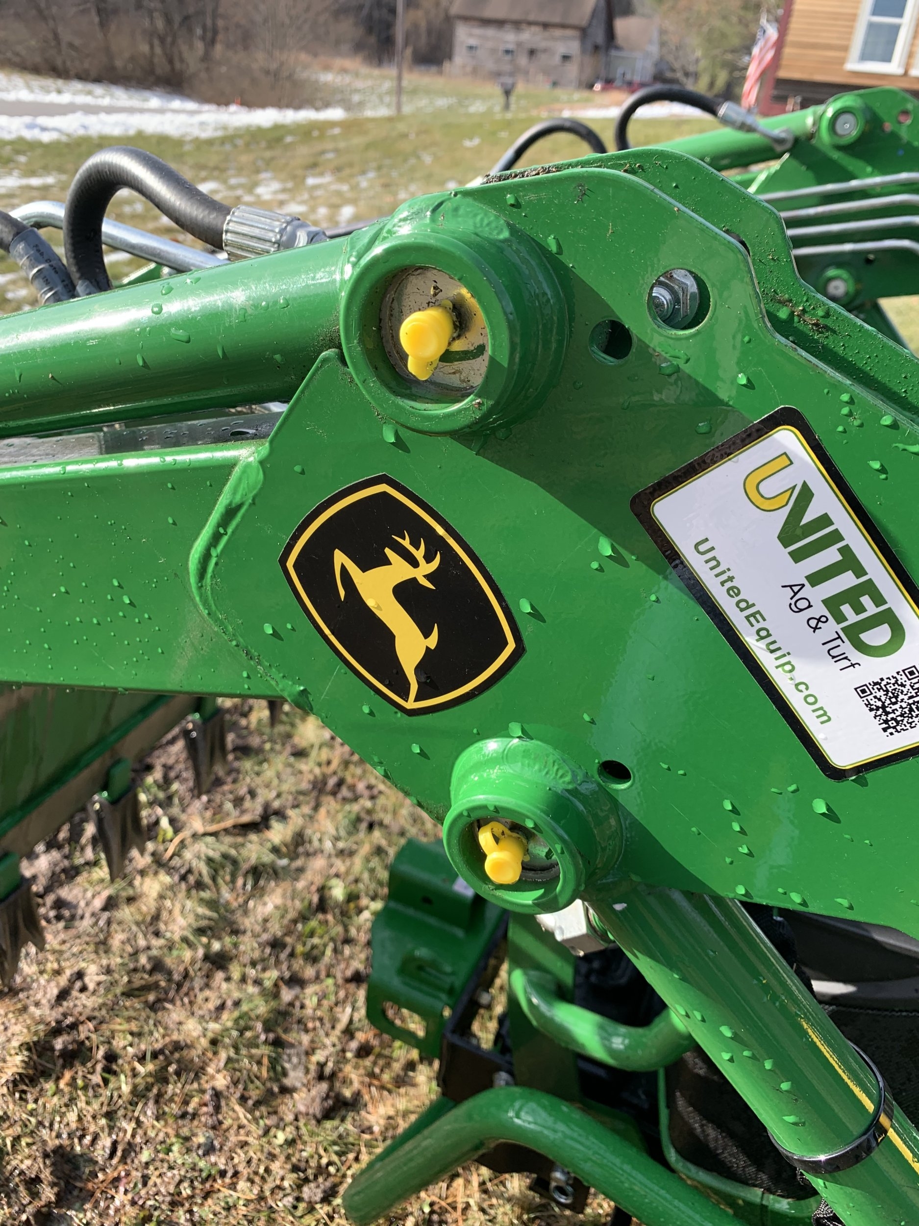

Coming up on 100 hour maintenance. Have a good method for greasing all the driveline zerks, will try to take pictures. I am very glad I have the Hydros+ cooler installed - even with that AND the Summit Hydraulics 4-port rear remote installed (which works as a giant heat sink and radiator), that fluid still gets HOT just driving around for a few hours in 85* temps. I was able to redline the coolant temp, makes me want to add a hydraulic temp gauge.
/ My 2025R Thread #48
Let us know how greasing the driveline zerks goes.
That driveline greasing is the reason i didn't buy a 2025

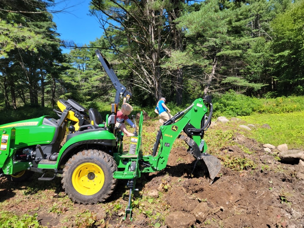

11/2/24 Pre-Snow Work
This is one of the best times of year to get yard work done. I really didn't do much this summer except mow, it was a very hot summer for us here in NH and I didn't get much done. Now the trees have lost their leaves, we've had a few frosts which kills off the undergrowth, it's been dry, and there's no snow yet so it's a good time to get stuff done.
Last weekend I tackled the clean-up of some old buried structure, I pulled out several buckets of bricks, cinder blocks, slabs, and junk. Then about a dozen full buckets of dirt that got moved to the compost pile.
This was just about the last bucket and I found... pipe! Shoulda called dig safe. I have no idea what this pipe is doing out here or what it was used for. It was only buried about an inch deep, I wasn't even trying to dig but rather just scape the pile of dirt to even things out. It looks like it's heading towards the house, maybe was hooked up to a propane line? I'll come out with the metal detector later and see if I can trace where it goes and make sure I get it all out.
Before I finshed cleaning up the garden area, I had to swap the 3-point hitch for the backhoe. This is not as easy as it used to be, as the weight and complexity of the hydraulic top and tilt cylinders, the quick hitch, and all the weight attached to the hitch makes it more difficult. And then the real struggle was re-attaching the backhoe off the BXpanded frame... doing it on dirt SUCKS. I couldn't roll it into position like you would do on concrete, and the tractor moving the backhoe would drive the wheels into the dirt and make everything worse. The BH would slide on the frame too which was a problem. So, can't wait for a concrete pad to replace the dirt parking spot I have now.
Anyway, with the backhoe on, I was able to pull the big rocks out of the dirt pile, put them to the side, and then move the dirt to the compost pile. A limitation of the BH is that you can't climb the pile as much before grounding. I haven't had the BH on all summer, and after having the box blade on the rear, it was a remarkable change in the balance of the machine. It sticks way out back and the center of gravity moves up and back. Going from A to B at high speed on the road was more like piloting a boat through waves than driving a car.
Today's project was pulling out a stump. I dug this out about a year ago, but couldn't pull the stump out of the hole before the snow started. Here I've got the BH maxed out and it's barely budging this stump. The problem is there's a ton of dirt stuck within the root ball. Kinda makes me think about Hydros+ cylinders... but I'm afraid of breaking things.
Brute force wasn't an option (I tried that first). What I was able to do was slowly spin the stump out of the hole, using the leverage of the outer edge to move it bit by bit. Doing this many many times I was able to move it out of the hole and onto the flat.
Once on the flat, I got the forks under it. Couldn't lift it, but with the tractor in 4x4 and the rear diff locked, and the hydraulics maxed trying to lift and curl, I was able to push the stump out of the way. I have no idea what this weights, but it's probably more than the tractor. The front tires are compressed and sinking into the soft wet soil that's near the river.
Then I put the bucket on and filled the hole. Victory! Here I'm parked over where the stump used to be.
I was able to flip the stump up so the dirt can dry and I can scrape it out of the root ball before moving to the burn pile.
Seems like I've got a bit of a leak from the quick connects. I noticed a lot of dirt in this area last week, so I cleaned it up before using again. Now it's quite wet again. Will try to trace where it's coming from but it's definitely the factor 4-port quick connect.
99.8 hours on the clock and I'm still impressed with what this tractor can accomplish. Still hope to get more done before winter and then do the 200 hour service early before I park it until spring.

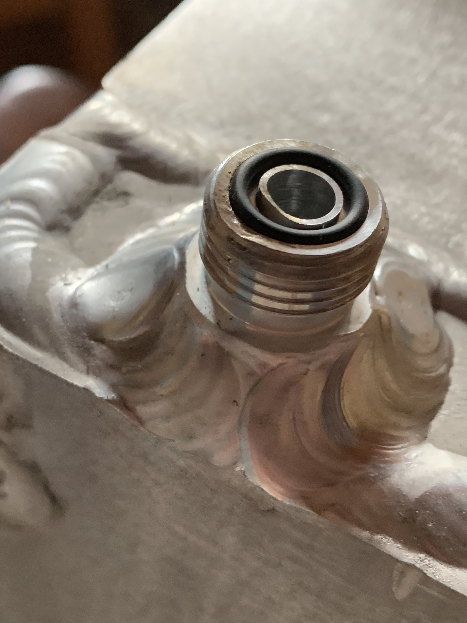

Some encouraging news, I'd emailed my dealer about the leaking single point and I got a call from the service department yesterday. He said it was a known problem and would be covered. He then asked if I knew where it was leaking from, because if it was two or more ports, the entire connector would be replaced with a new unit. He said that it was a known issue with the first generation, which seems to match what was posted in that other thread. I couldn't check then but he asked me to send pictures if I could find the leak.
So I got out the degreaser and got everything cleaned up and dry.
I thought to put a paper towel over the ports, figured it would be easy to see where it got wet (and in the unlikely event that it was spraying out under pressure).
Two spots.
It didn't leak much while disconnected, but I re-connected and it comes out at a pretty good rate, fast enough that I don't want to use it. Still, I can get some stuff done today with this disconnected. Dealer is closed today but I'll send them the pictures and see what they say on Monday.

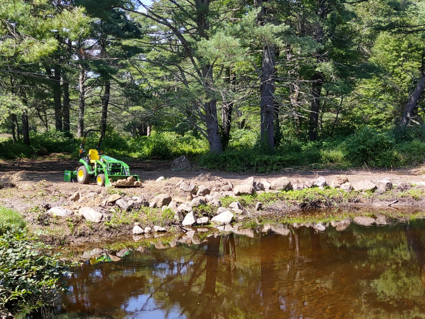

I've been using the backhoe a ton to clear up my river frontage. I can get down along the bank, pull out stuff that's fallen in, and tear out these pesky underbrush clumps, while staying a safe distance from the bank. Hard to tell from the photo, but the stabilizers are about a foot from the bank, which is then an abrupt 3 foot or so drop down to the river. The hydraulic thumb is instrumental in the utility of the backhoe.

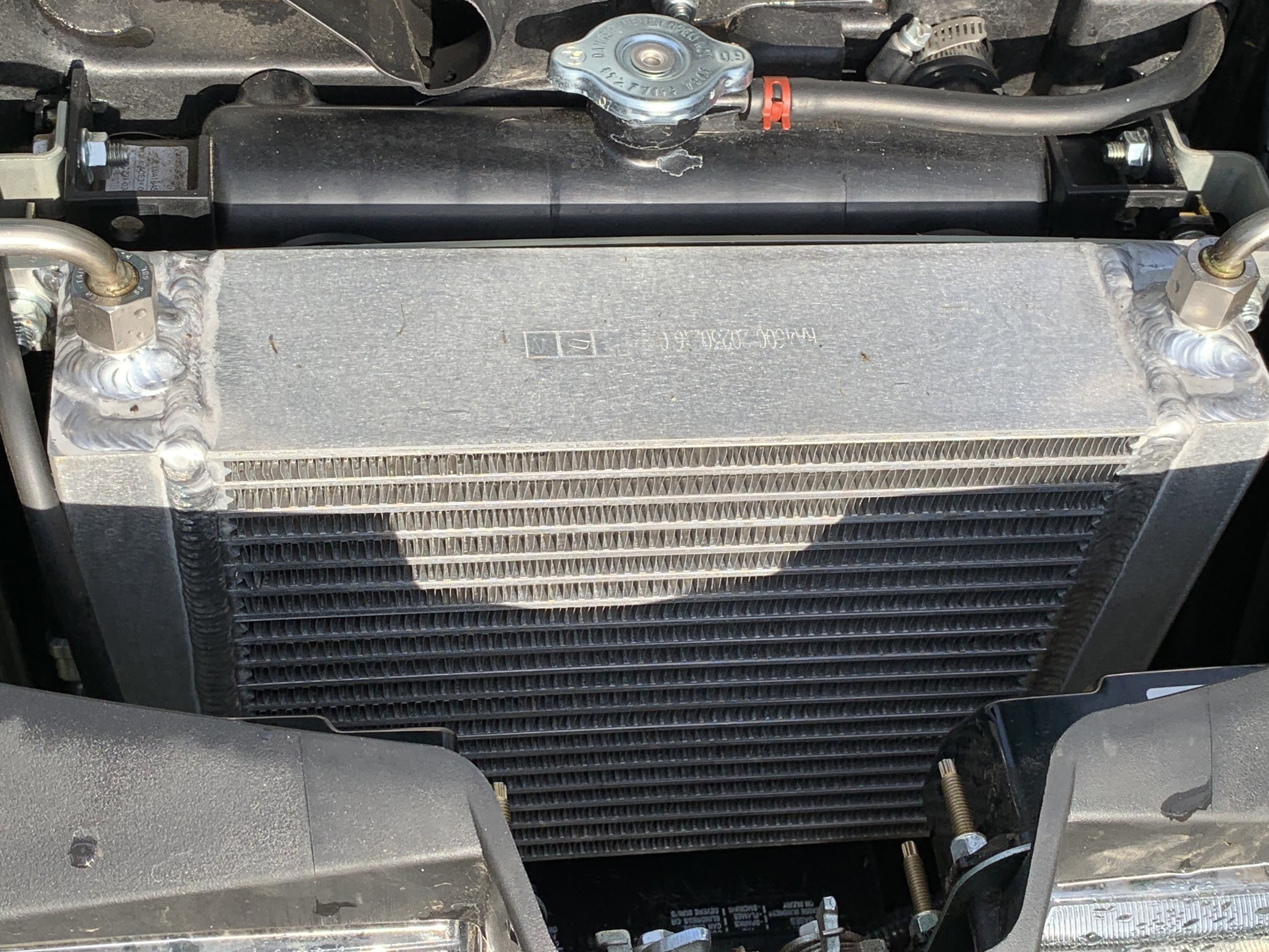

Added a couple more horsepower.

With the rake out front I can get right up to the water's edge.
I'd pull clumps away from the edge into a row, and then pull the whole row as a pile by back dragging over it. Really appreciate the extra ground clearance of the 2025R when out in the woods dealing with this brushy stuff. I can't imaging enjoying being any lower.

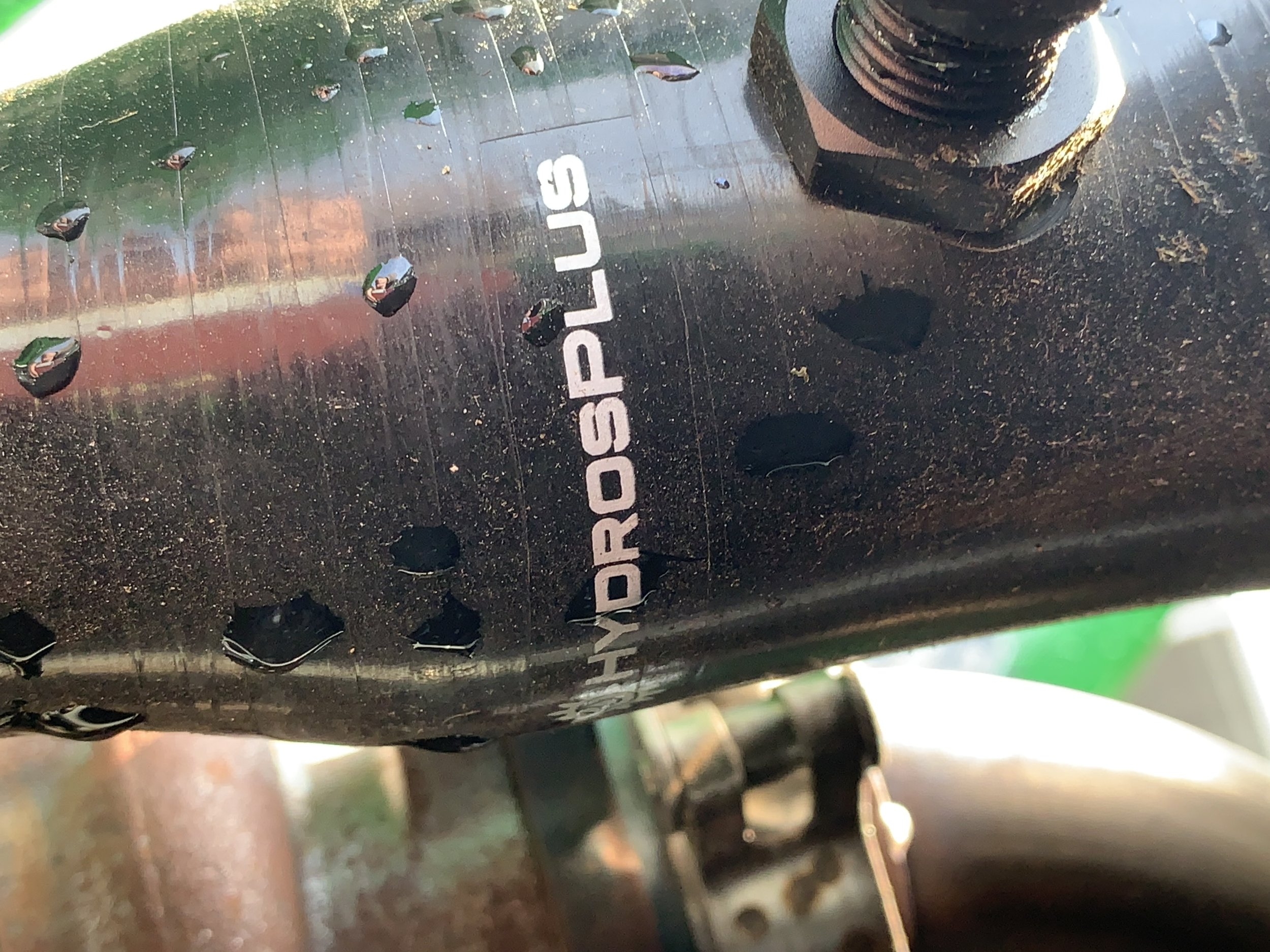

* The Hydros+ air tube for the turbo is slightly rubbing in two spots. I'll take pictures later, one is the oil delivery tube banjo fitting and the other is a clamp. It must have moved slightly since install since I would not have positioned it as-is with interference.

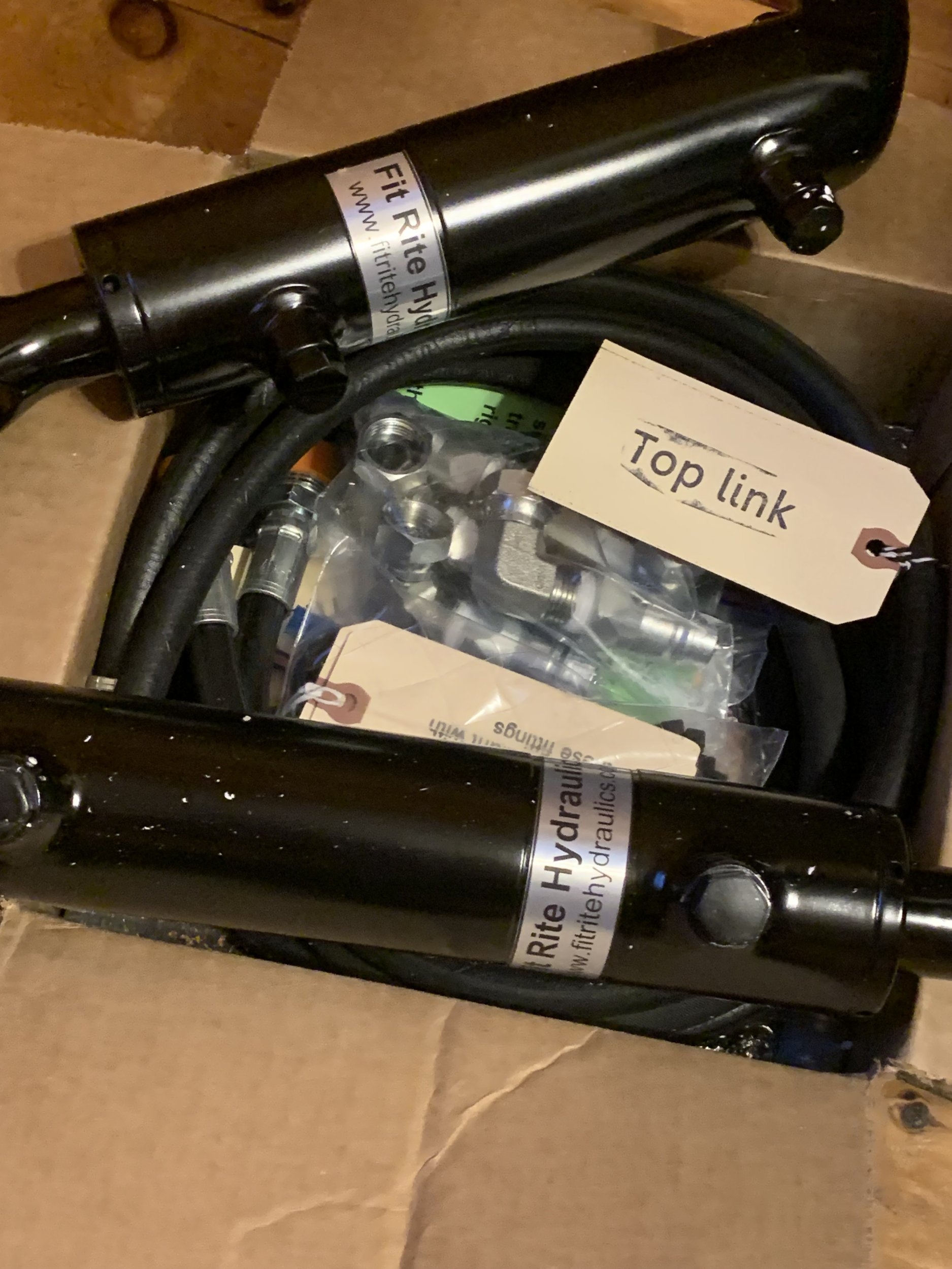

The more I work with the FEL and BH, the more strongly I consider the Hydros+ upgraded cylinders. But, it gets the job done.
