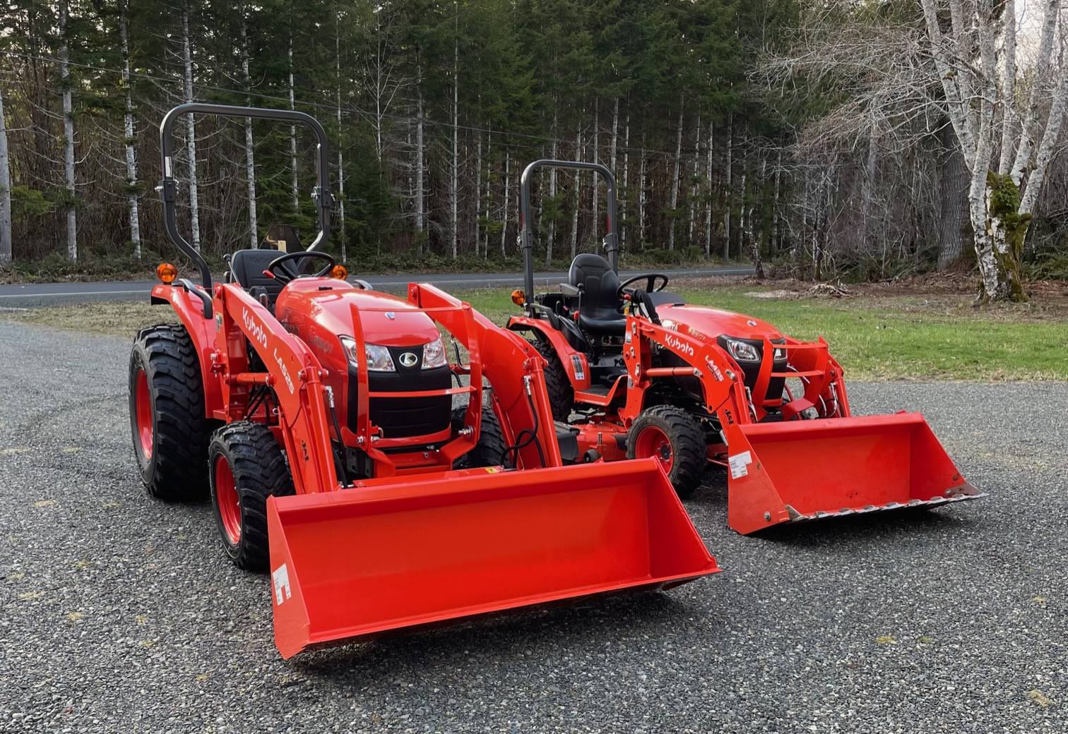

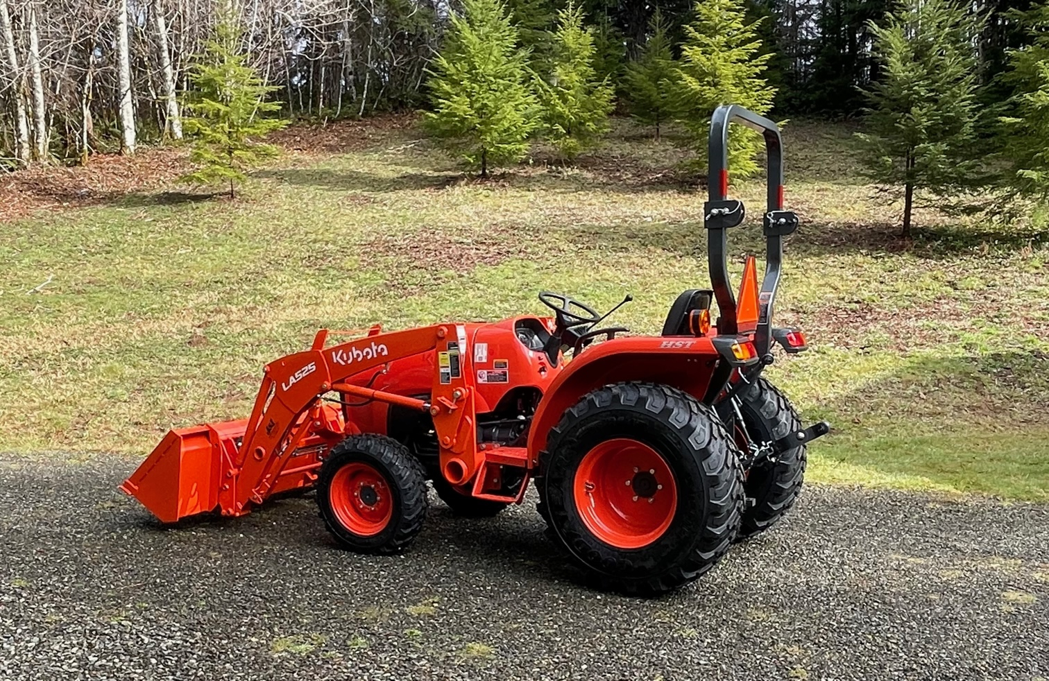

My Kubota L2501 HST 4WD is my second tractor (third, if you include the garden-tractor variety).

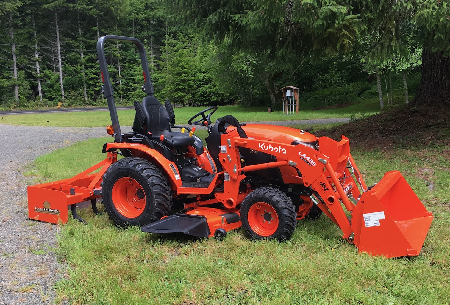

When I first began shopping for a tractor I focused my attention on the sub-compact variety. I wanted a small, all-in-one machine, that could fit anywhere, feel comfortable, do tractor things, but also, mow the lawn.
Mowing the lawn was a very important consideration at this particular time in my property ownership career. I was fixated on acquiring a versatile tractor capable of mowing the grass since I had grown tired of having to stop in the middle of my mowing chores to fill the gas tank on my garden tractor. A truly loathsome inconvenience! I wanted to make certain that whatever tractor I purchased would have enough fuel capacity to mow my entire property on one tank of fuel and I knew a small diesel powered tractor wouldn’t have any issue accomplishing this task. That said, I was also beginning to realize the need for a real tractor to help with property management, improvements and maintenance tasks. At this early stage in my understanding, I didn’t have a bona fide vision, or grasp of a tractors true capabilities.
Friends, neighbors and co-workers familiar with my property quickly lured me away from purchasing a small sub-compact tractor and suggested I go bigger, much bigger. Most folks were urging me to buy a medium to large compact or, even a small utility tractor. But, doing so, meant having to purchase two separate machines. One for tractor work and one for mowing duties. The thought of purchasing two machines seemed completely unnecessary and incredibly expensive. Further complicating my decision making ability was due to my ignorance and inexperience. At the time, I didn’t fully understand the limitations of a tractor’s size and weight. Consequently, I was unable to fully comprehend the reasoning behind each of the tractor recommendations that were being offered to me. Purchasing a small tractor, with a mid-mounted mower, seemed to make a lot more sense. Respectfully, however, I couldn’t entirely disregard their suggestions since I knew they were all based on decades of operating experience from very knowledgeable individuals that really wanted to help me buy the ideal tractor for my property.
After cross-shopping many brands, tractors and tractor sizes, I eventually made a decision. A decision that pretty much disregarded all the advice and suggestions I received. A decision purely based on my own enormously extensive inexperience. My decision was to purchase a brand new Kubota B2601 HST 4WD tractor equipped with a front end loader and of course, most importantly, a 60” MMM (mid-mount mower). In the end, I just didn’t think a larger tractor was necessary. I’m just mowing the lawn for heavens sake!
I was tremendously proud of my decision because I technically bought a larger tractor than I was originally planning to purchase. I bought a compact tractor, not a sub-compact tractor! In my mind, this slight increase in tractor size was surely enough to appease the generous souls that offered me their advice and wisdom. See I listened! Hooray for me!
Though, in reality, I didn’t listen. The B2601 was nowhere near as big, or as heavy as the tractor I was originally encouraged to purchase.
As disappointed as some individuals were regarding my decision, they were still happy I purchased a tractor. Because any tractor, is better than no tractor! And honestly, purchasing the B2601 wasn’t a horrible decision after all. It was a great tractor and served me well, but it just wasn’t the ‘right’ tractor for my property and uses. The B2601 simply lacked the lift capacity, the size and the weight required for removing medium to large stumps, carrying logs, carrying stumps and the heavy ground engagement work that was still needed on my property.

I purchased the Kubota L2501 for several reasons. First and foremost, bang-for-your-buck. You get a lot of pure tractor for the money. The L2501 is a substantial, raw and robustly designed machine made for arduous tractor work. The combination of its size, weight, lift capacity, and maneuverability are near perfect for my property. The L2501 has an impressive track record for trouble free operation, exceptional build quality and amazing reliability. In addition, the L2501’s three cylinder diesel engine delivers exceptional fuel economy and also produces an impressive amount of torque for its size, especially considering it is a naturally aspirated. Having owned several overly complicated and expensive modern diesel powered cars, trucks and SUV’s, I appreciate simplicity. The L2501’s engine is thankfully, a simple mechanical diesel and is not equipped with modern diesel emissions equipment, or electronics. Meaning it does not have an ECM (engine control module) or DPF (diesel particulate filter) and doesn’t require emission Regens (a process that converts soot to ash within the exhaust system) which create excessive heat, wastes fuel and mandates high RPM engine operation. A huge bonus for sure! Furthermore, another benefit is the L2501’s popularity. It’s one of the best selling tractors in the USA and has very good resale value (an important consideration when you’re not fully confident in your purchasing decisions, like me).
All of these characteristics seemed extremely well suited for my property and my intended uses. Plus, I was already familiar with the Kubota brand, I have a phenomenal dealer less than 40 miles away and the L2501 was the tractor that many folks, including my Kubota dealer, originally recommended.

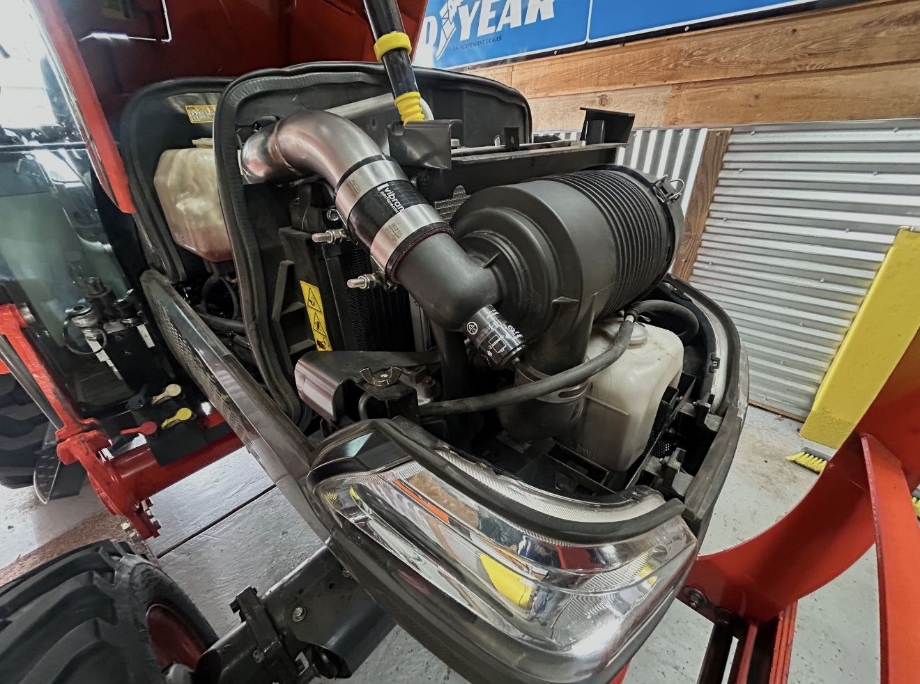

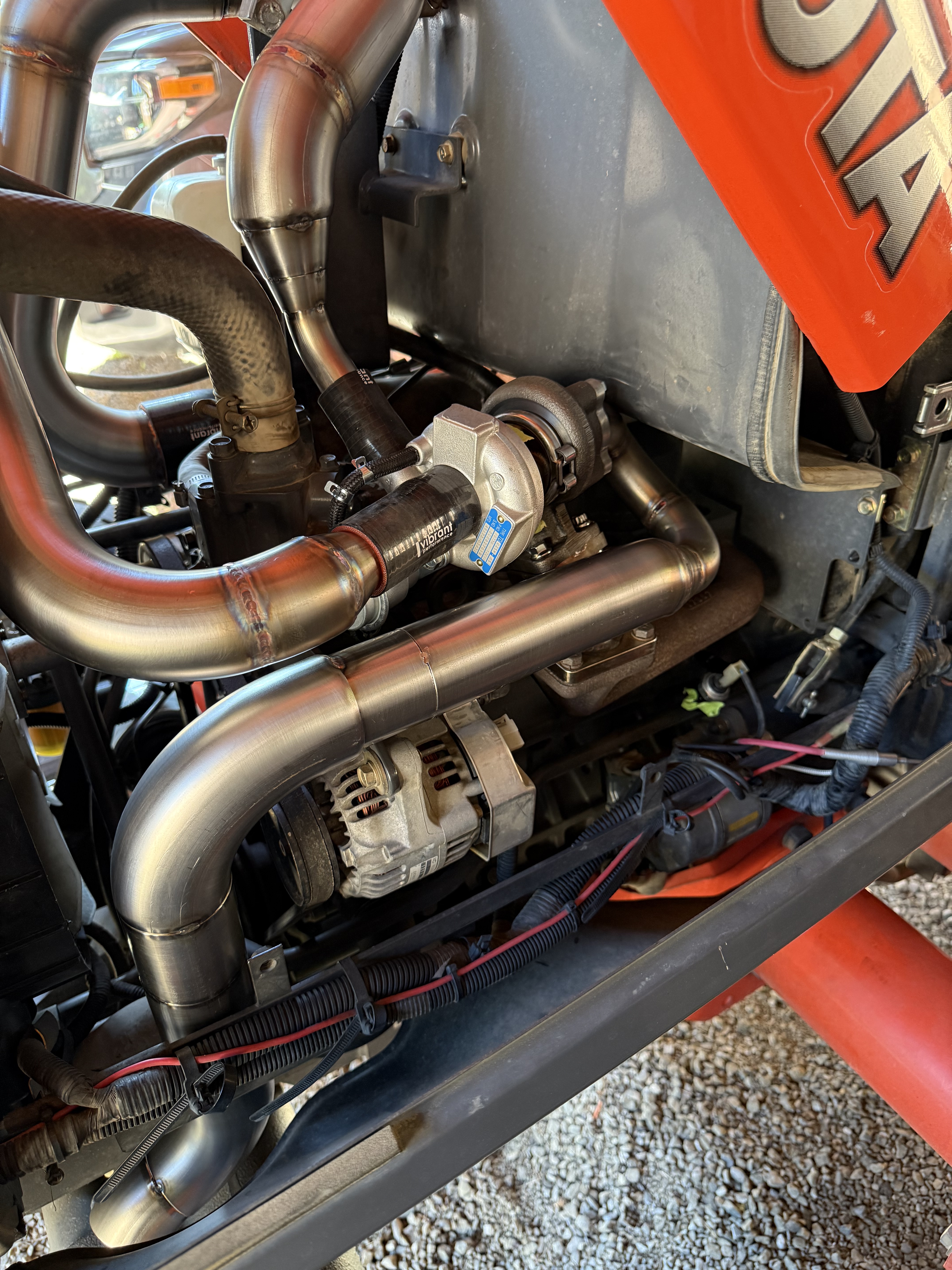

You should perform a leakdown test on your machine at some point as the turbo install will erode the piston ring land on the top ring only and compression will suffer especially if you use much power over sustained time. These folks will help you also.
I have another 400 on it blowing snow wide open full tilt and have yet to have another issue but haven't done another leakdown test yet, again, perform a leakdown test not a compression test.

Great suggestion. It all depends on application and setup. Did you ever monitor your EGT temperatures? Sounds like you may have had excessive run away EGT’s during hard operation. That’ll kill any engine.
Anybody installing this Turbo kit will need to monitor EGT’s. The end user is responsible for tuning. You can combat high EGT in two ways; reduce fuel or add more boost PSI (adjust boost actuator on Turbo). Both can be accomplished on this setup.

You'll notice 3 basic differences on Kubota NA vs. boosted pre tier 4 engines.
1) intake manifold, NA has a runner type or non plenum manifold, the boosted always have a "log" type manifold or one with a plenum, simply a large area that evenly distributes the pressure to each runner. So where a naturally aspirated engine has a vacuum at each intake valve a boosted engine has pressure at each intake valve, at load that is. I learned this from a Dodge Cummins truck pull champion, he showed me how the Cummins manifold needs a plenum because the rear cylinders get much more charge without it and they are usually the first ones to fail.
2) Oil cooler, there are no piston oil squirters on the pre-emission Kubota engines, not sure about the newest ones, please correct me if I am wrong.
3) Pistons with that hard insert on the top ring, to help with the major increase in combustion pressure.
As far as I could tell that is about it, they usually run the same timing spec and fuel injector although the rack setting is much higher with the boosted engine as you found out.
No I don't have a pyrometer, I've quickly opened the hood after a very hard pull and the boost tube is cold as ice. I would have melted a piston if it had the exhaust gotten too hot.
I didn't want to re-invent the wheel, just needed more power because 39hp on a 5500 pound machine is not nearly enough.
