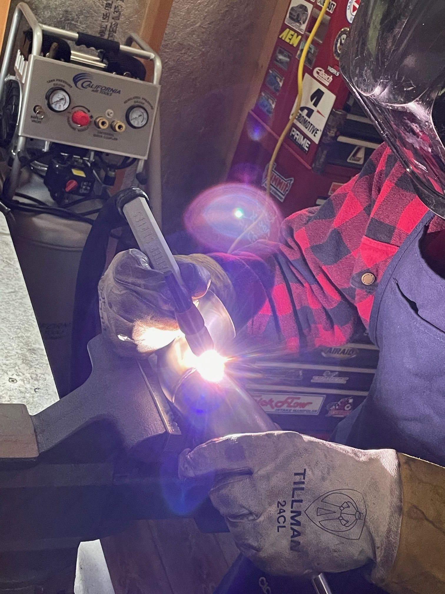

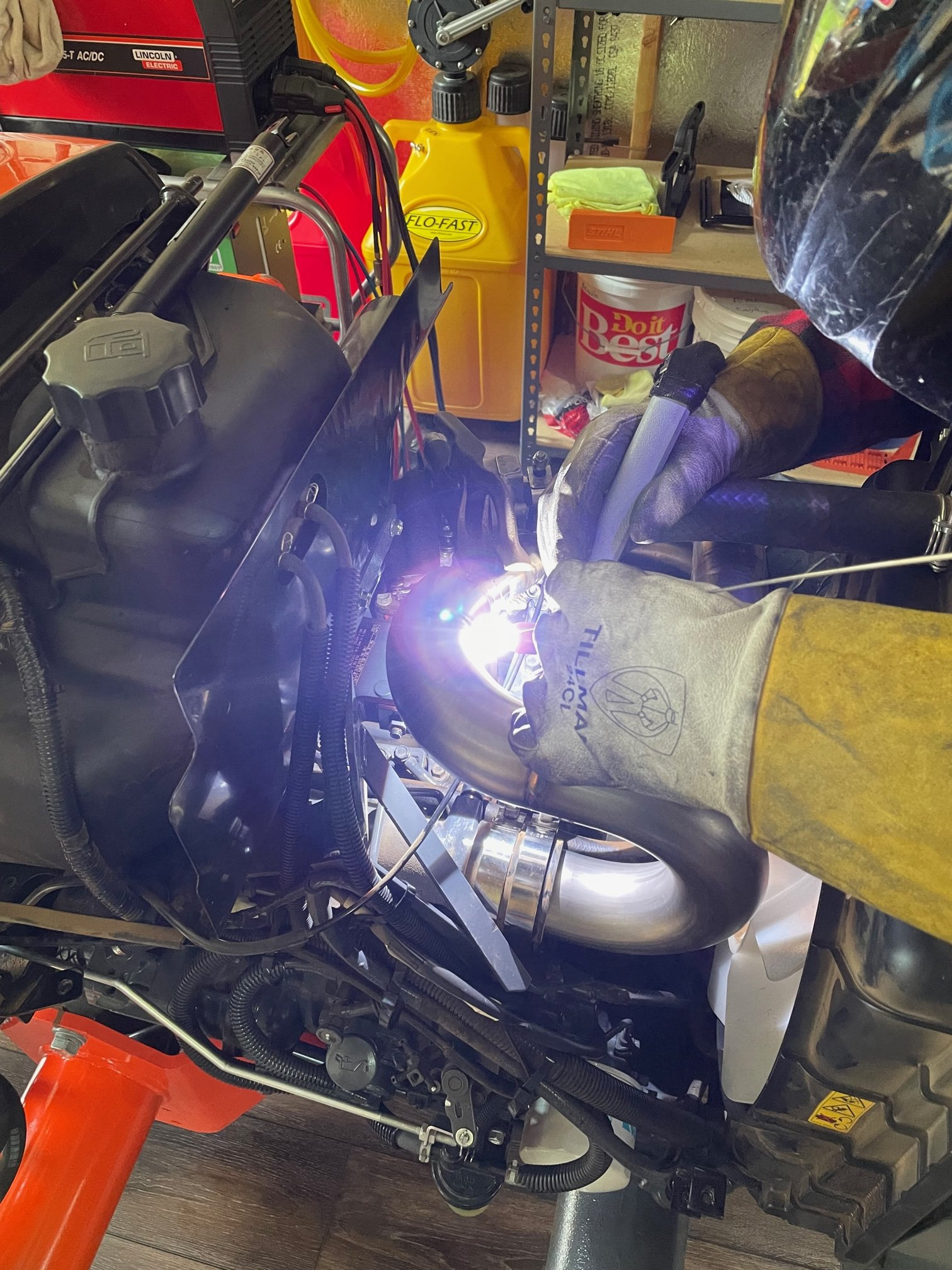

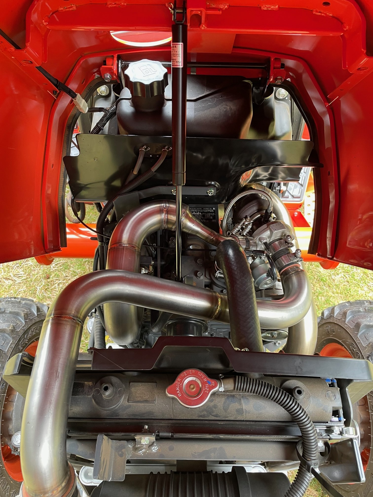

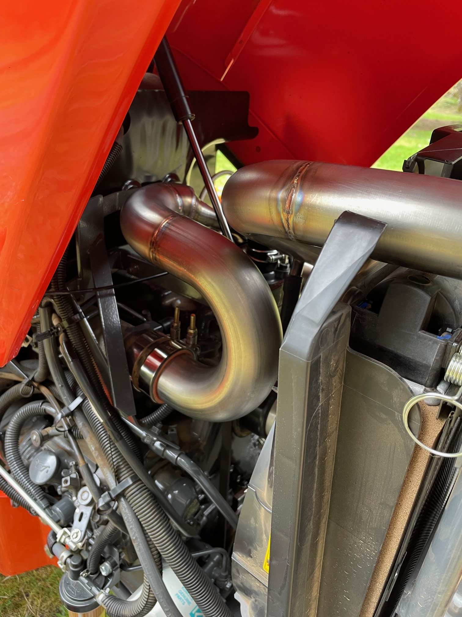

Over the weekend we updated and improved the Turbo Charge Pipe for the L2501 Turbo Kit by reshaping the piping so the factory Hood Prop Rod Absorber can be used and function as intended.
It's gonna make opening the hood so much easier!
No more broomstick!
Mike
   / Kubota L2501 Turbo: A Journey Defined - The Tractor, The Comparison, The Modification, The Results
#112

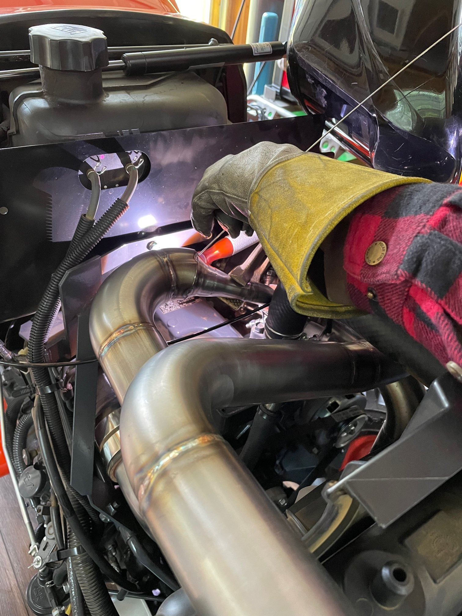

We redesigned the Turbo Intake Charge Pipe so the factory Kubota hood prop rod absorber can be used and function as intended;
This redesign was a necessity! Opening the hood was extremely awkward without the assist of the absorber and holding it up with a broomstick was utterly ridiculous.
Now, all is well! :)
We also added an extension to the Exhaust pipe exit to further send exhaust fumes away from the operator station.
I'll share some pictures of that modification soon.
Mike

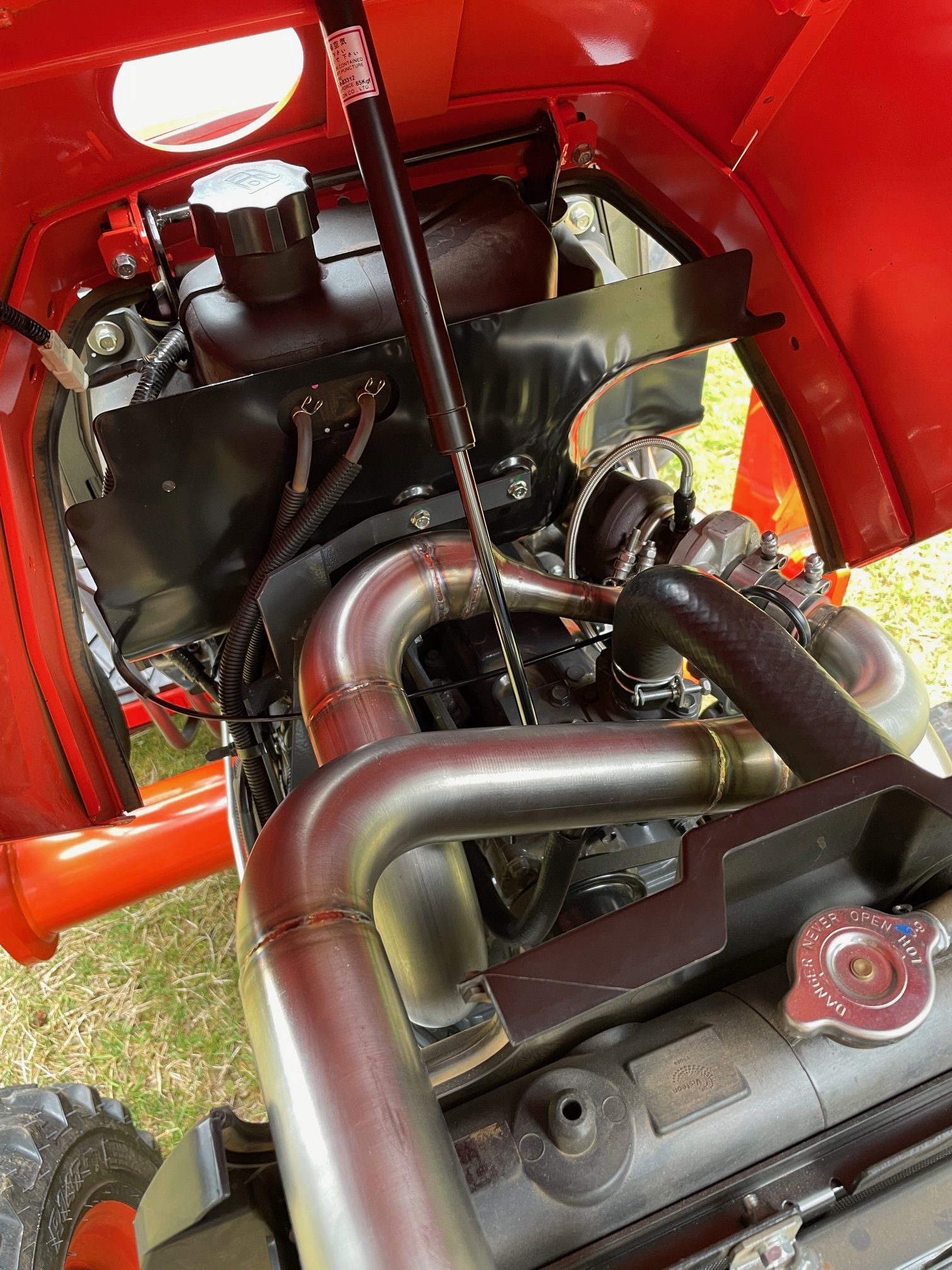

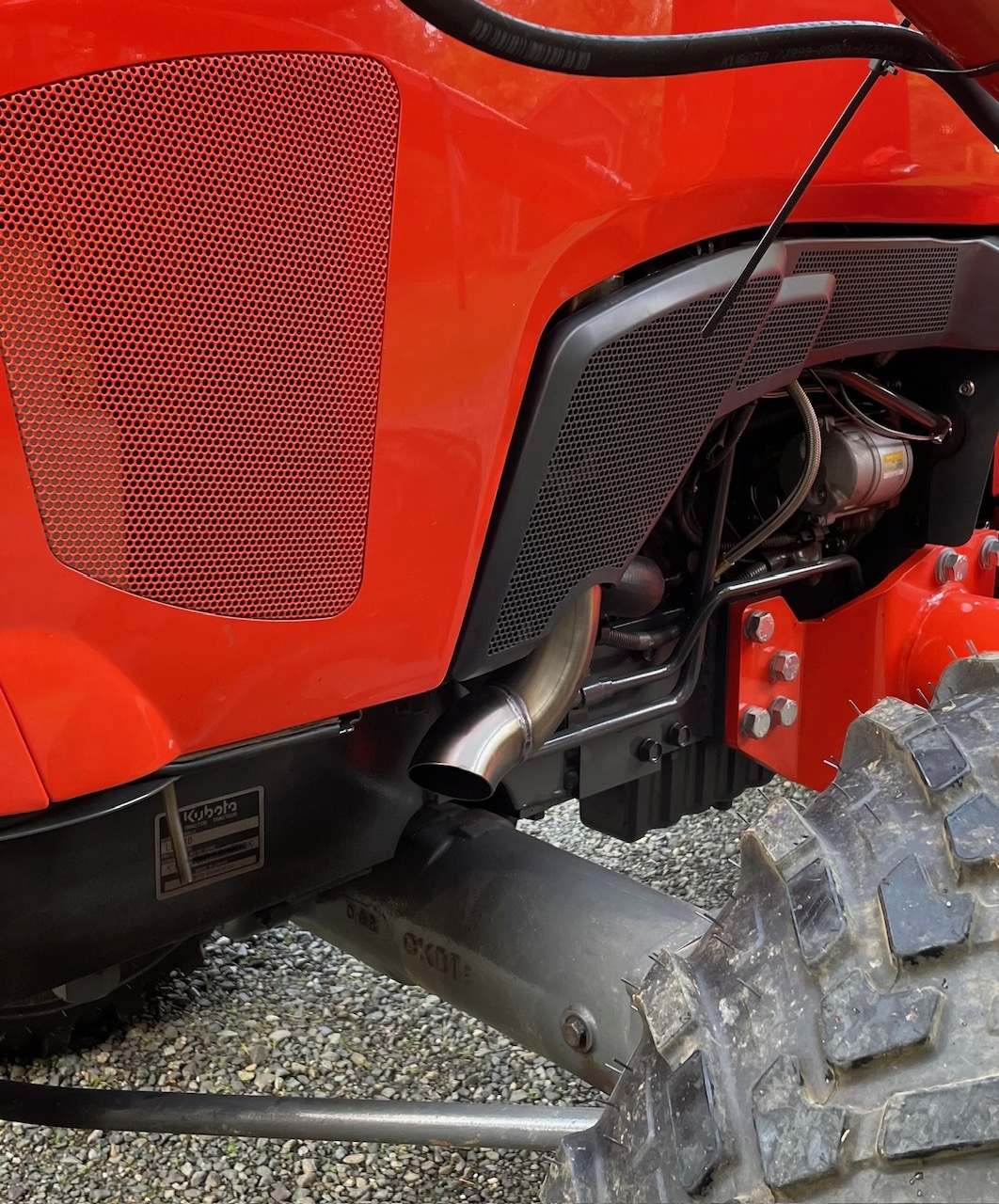

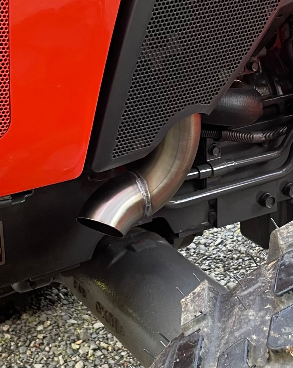

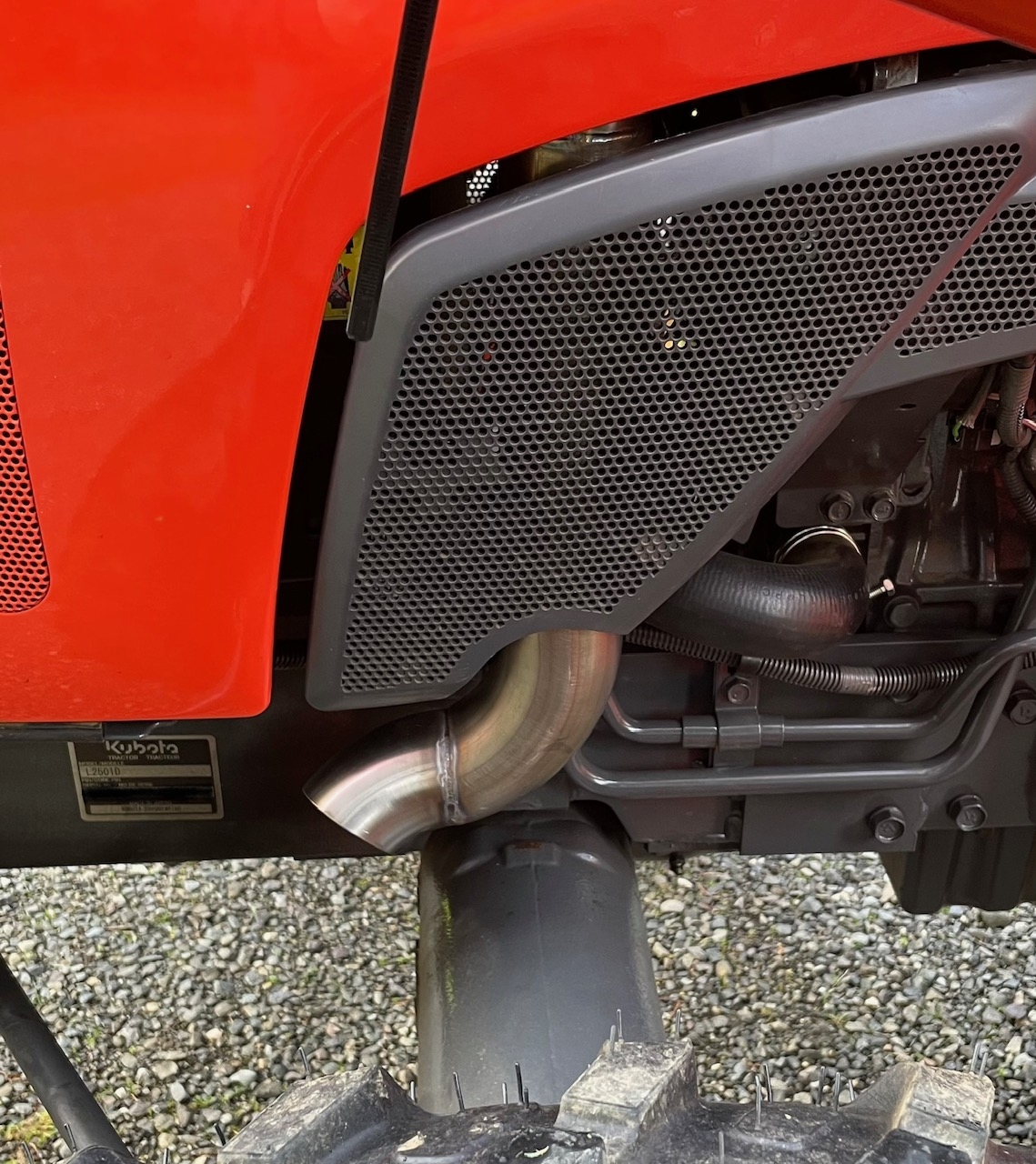

Here are some pictures of the new updated L2501 Turbo exhaust;
The update has further improved to keep the exhaust fumes away from the operator station and IMHO, also improves the aesthetics of the Turbo package.
Mike
   / Kubota L2501 Turbo: A Journey Defined - The Tractor, The Comparison, The Modification, The Results #115
Blends in just like stock. With the slightly downward point do you get much dust blowing up?
#116
Not too much (and I’m sensitive to those things). I think it’s slightly better than stock in severely dusty conditions.
Mike

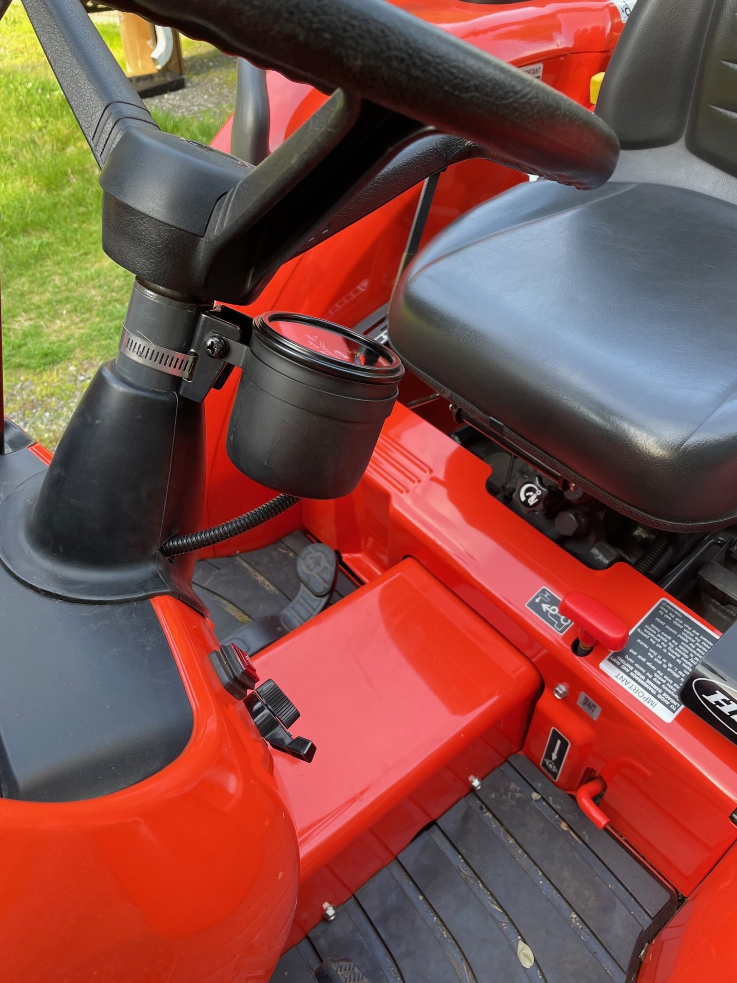

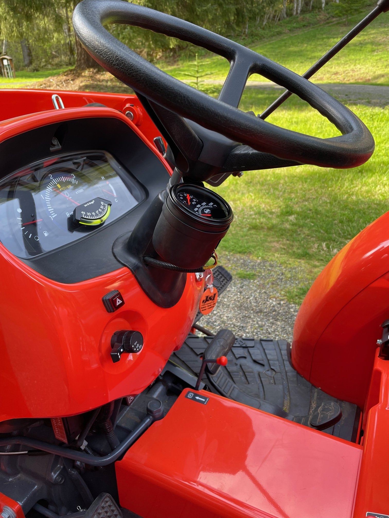

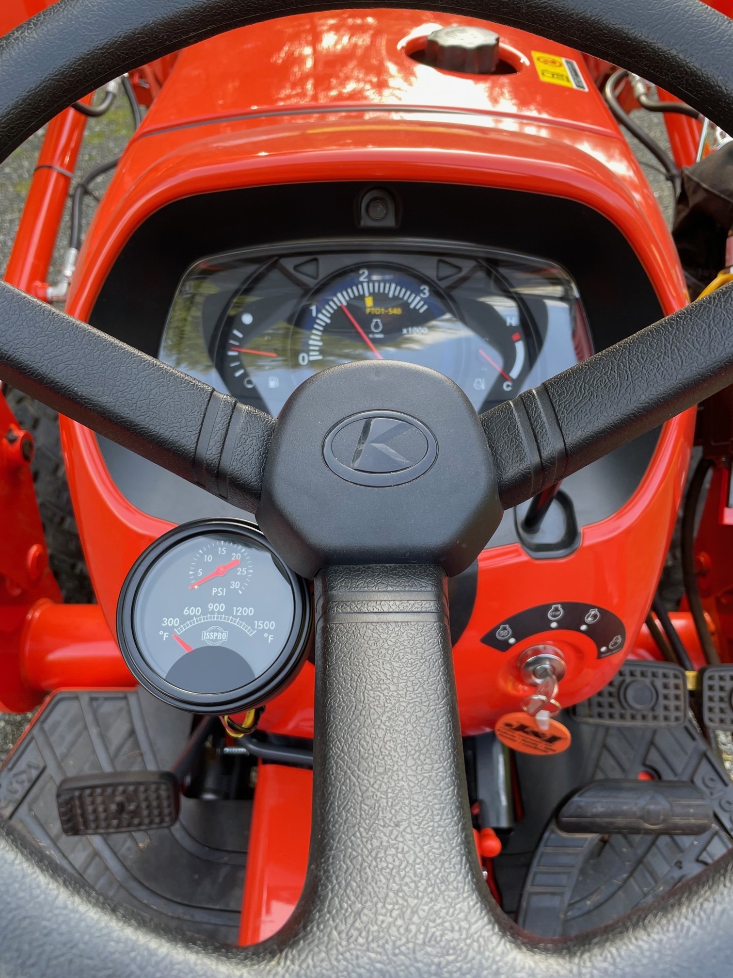

Here's the new ISSPro Boost/EGT gauge combination setup I have installed on the tractor for the L2501 Turbo Kit;
I really like this particular gauge setup. Having the ability to read both boost pressure and EGT temperatures on the same gauge is a real bonus and it definitely beats my previous two gauge diagnostic setup I had installed on the tractor previously. The IssPro is a marine gauge so it should resist the outside elements well and hold up to normal tractor use which is really good since my diagnostic gauges didn't like the elements.
The boost section of this particular gauge isn't the most accurate but, boost is the least important element to monitor. The EGT readings however, are reliable and very consistent to the readings I was recording on my diagnostic gauge.
That said, I wouldn't want this gauge to replace a diagnostic gauge for tuning purposes. For tuning, I highly, highly recommend the use of diagnostic gauges.
This is a great gauge setup for long term use and engine health monitoring! Anybody considering the installation of a Turbo Kit on one of these tractors is going to have to monitor EGT's for the duration of the Turbo installation to ensure engine health and longevity. Hard to beat this setup!
Mike

Very Impressive. In fact, every post on your project(s) is full of good information. Thanks.
Why would the diagnostic gauge be so much better for tuning? I'd like to start by getting some baselines on the M59 when the EGR valve is in the circuit and when it is not.
rScotty
#119
rScotty
Simply put, accuracy.
The ISS Pro setup is good for ‘monitoring’ the engine performance but, the gauge is a little slow to react to instant changes in boost PSI and EGT temperatures.
The diagnostic gauges I use are instantaneous and are incredibly accurate. For tuning purposes, you want to use the fastest and most accurate instruments to make adjustments and/or verify results.
I hope that helps clarify the reasoning behind the alternative gauge setups.
Mike
