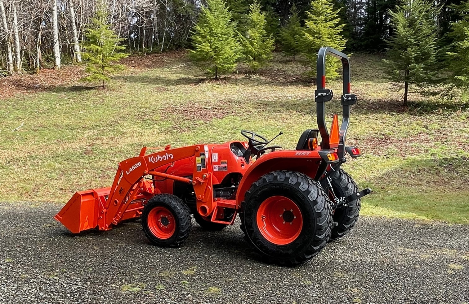

My Kubota L2501 HST 4WD is my second tractor (third, if you include the garden-tractor variety).
I’m operating my tractor on 5 acres of undeveloped heavily wooded forest land. The property itself is roughly 500ft above sea level and the terrain consists of flat areas along with moderate and steep hills to the north and northeast.
My goal with the property is to transform the wild untamed forest and create a park-like atmosphere and appearance without disturbing too much of the natural beauty.
My tractor is used to grade and level land, till dirt, move dirt, move brush, skid logs, transport trees and logs, make trails through the forest, maintain our gravel driveway, remove stumps, run a PTO powered wood chipper, run a 15KW PTO backup generator and to load and unload miscellaneous materials and products from delivery trucks.
Thankfully, I have a ZTR mower (zero-turn riding lawnmower) to maintain the grass, weeds and light brush.

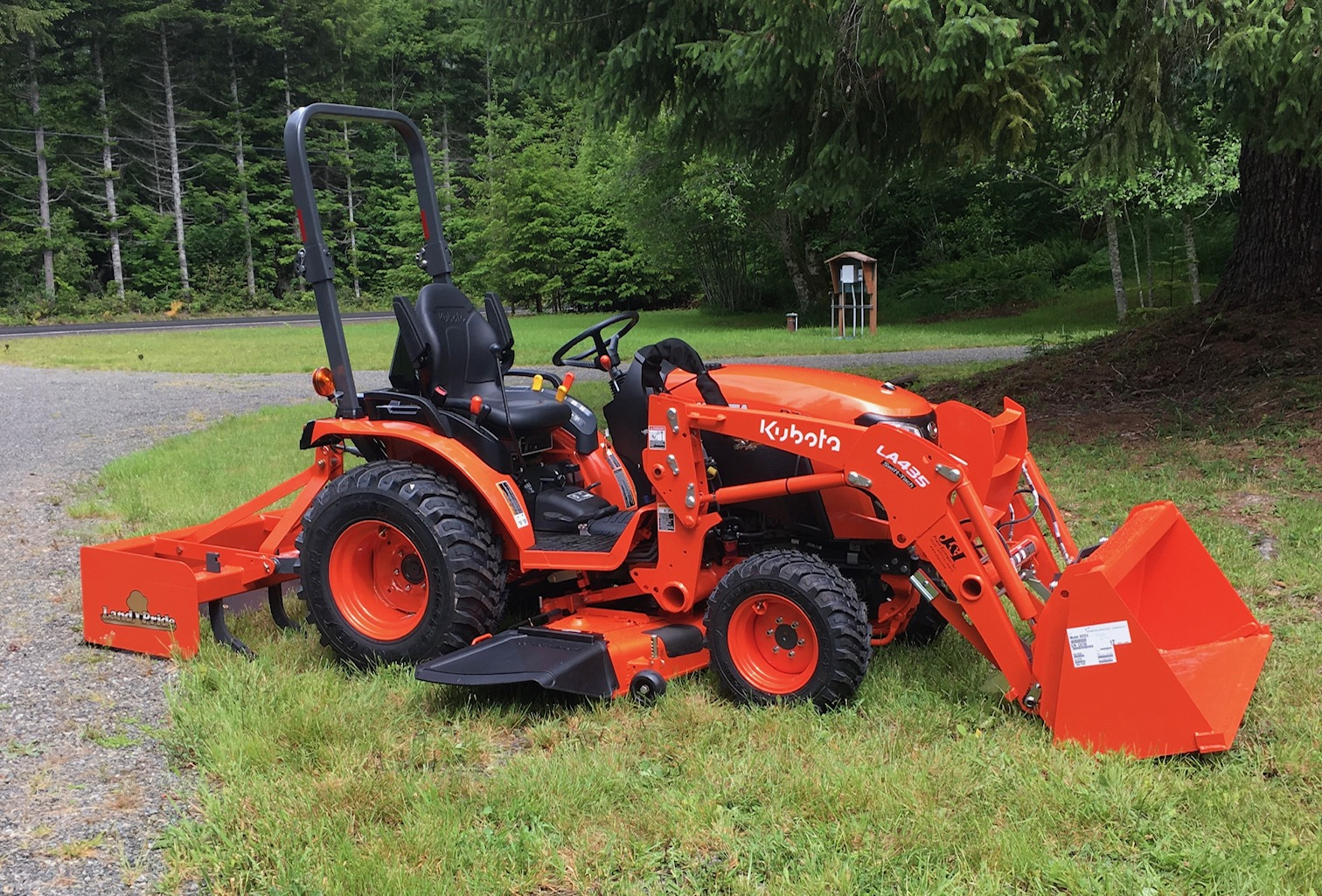

After cross-shopping many brands, tractors and tractor sizes, I eventually made a decision. A decision that pretty much disregarded all the advice and suggestions I received. A decision purely based on my own enormously extensive inexperience. My decision was to purchase a brand new Kubota B2601 HST 4WD tractor equipped with a front end loader and of course, most importantly, a 60” MMM (mid-mount mower). In the end, I just didn’t think a larger tractor was necessary. I’m just mowing the lawn for heavens sake!
I was tremendously proud of my decision because I technically bought a larger tractor than I was originally planning to purchase. I bought a compact tractor, not a sub-compact tractor! In my mind, this slight increase in tractor size was surely enough to appease the generous souls that offered me their advice and wisdom. See I listened! Hooray for me!
Though, in reality, I didn’t listen. The B2601 was nowhere near as big, or as heavy as the tractor I was originally encouraged to purchase.
As disappointed as some individuals were regarding my decision, they were still happy I purchased a tractor. Because any tractor, is better than no tractor! And honestly, purchasing the B2601 wasn’t a horrible decision after all. It was a great tractor and served me well, but it just wasn’t the ‘right’ tractor for my property and uses. The B2601 simply lacked the lift capacity, the size and the weight required for removing medium to large stumps, carrying logs, carrying stumps and the heavy ground engagement work that was still needed on my property.

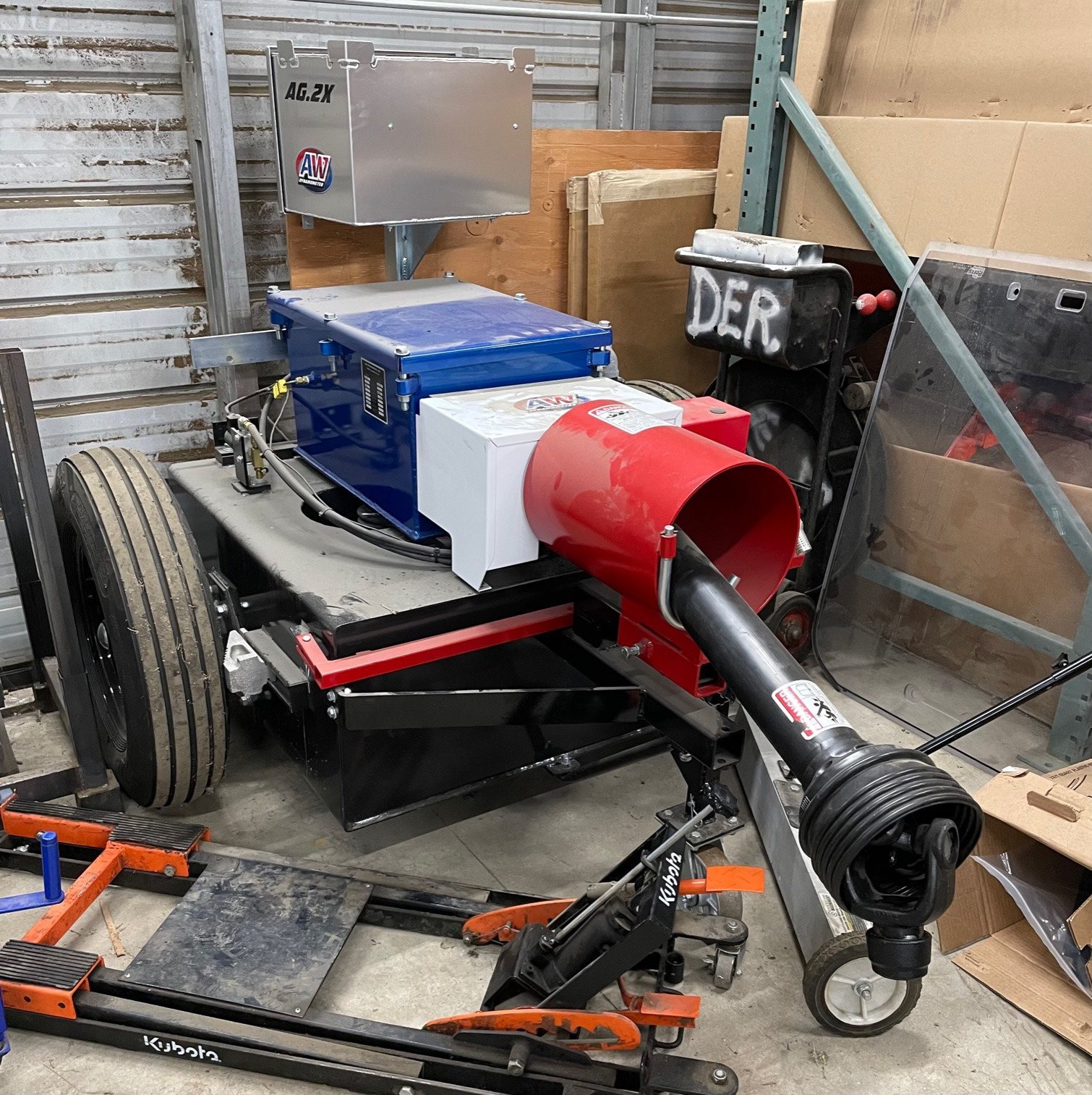

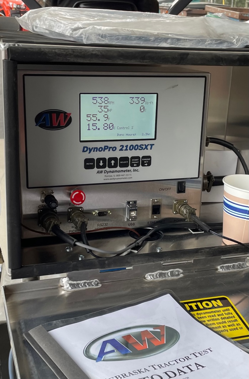

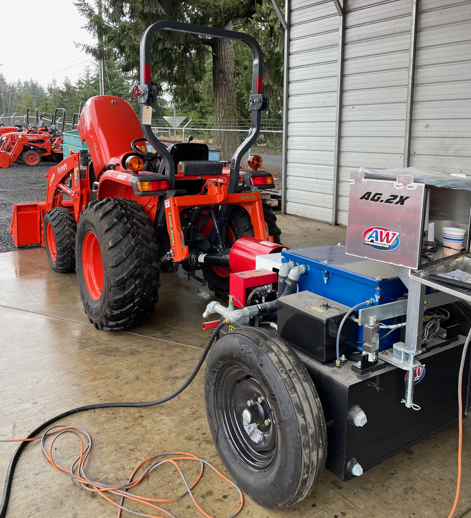

The following performance data is based on actual independent PTO dyno results. I am simply using this information obtained from several sources as a foundation to estimate the additional power these modifications can potentially produce. Since each of these modifications require a fueling adjustment determined by the individual performing modification to increase power, your mileage may vary.
We know from the results of a recent PTO dyno session that an L2501 produced 31 HP and delivered 25 PTO HP modified with an injection pump timing advancement and a fuel adjustment. That’s a 20% increase in power! And $733 per PTO HP! Essentially, this modification produces the same power and performance as a L3301 / L3302, for FREE!!!

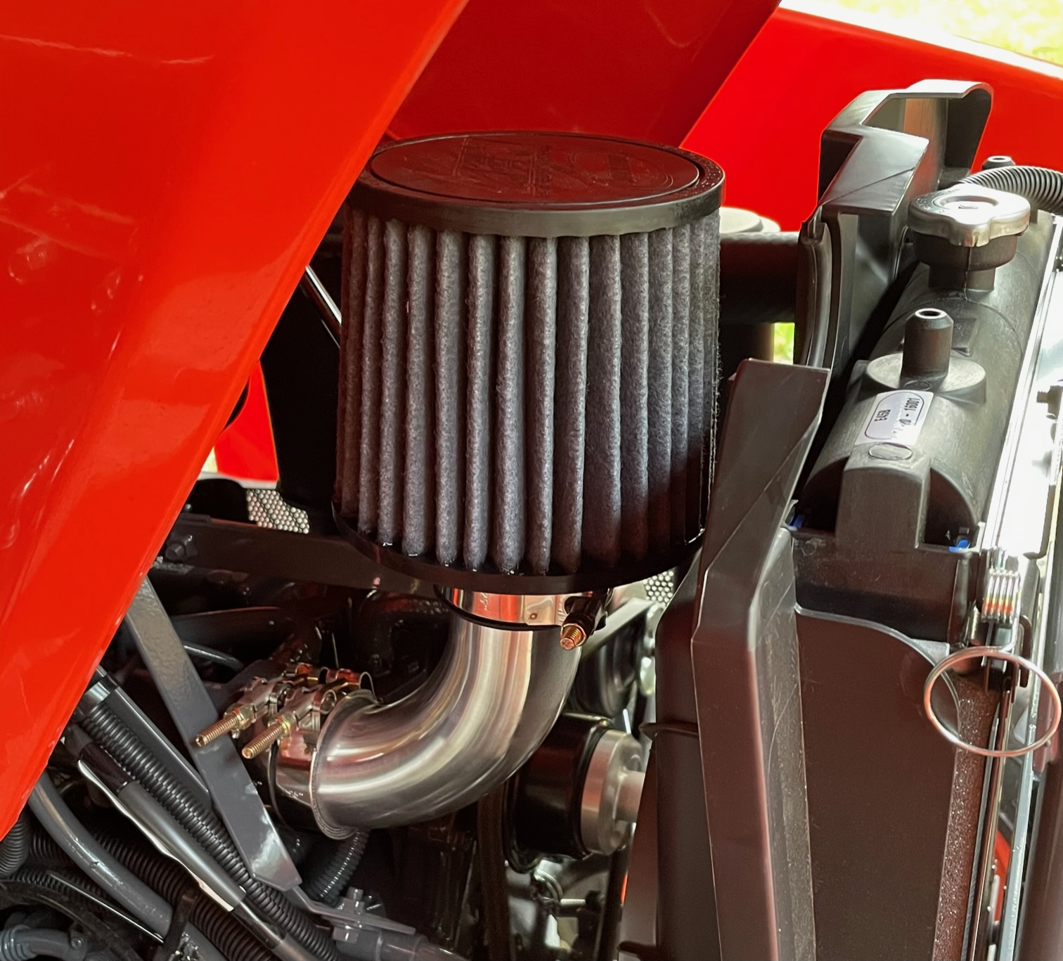

In the very early stages of my research I read that the factory L2501 intake and air cleaner assembly is highly restrictive. Upon learning this news, I figured it was time to experiment. I replaced the factory intake hose and air filter housing and fabricated a new high flow aluminum short-ram intake and finished it off with a high performance aftermarket off-road air filter designed to handle the extreme dusty conditions encountered in Baja and Rally racing.
As I’ve mentioned previously, my big hill is my L2501’s nemesis. The tractor doesn’t appreciate the challenge of traversing this obstacle and always struggles to make it to the top carrying a load. The custom intake noticeably improved the tractors ability to climb the hill in (M) gear. The newfound ability wasn’t anything earth shattering, the tractor still struggled, but the RPM’s would only drop a few hundred RPM’s, instead of several hundred RPM’s.
There were some drawbacks, however. The engine and intake noise was noticeably louder with the custom intake. I never thought to measure the increased racket but, I can tell you it was a little uncomfortable operating the tractor without wearing ear protection. And with further testing, I found there were some issues with air filtration. After many hours of hard use in dusty conditions, I found evidence of very fine dirt film in the intake tube. It’s probably nothing to be alarmed by but, I never saw any sign of dirt particles, or film inside the stock intake system. So, I removed the short-Ram intake and reinstalled the OEM intake assembly and air cleaner for piece of mind.
Due to the questionable air filtration properties found with the aftermarket high performance air filter and the general assumption that a tractor will be used in dusty conditions, I knew I wanted my Turbo system to utilize the OEM intake assembly and air filter, even if it costs some performance (I’ll get to that later). Naturally, it’s much better to have superior air filtration protection than the alternative.

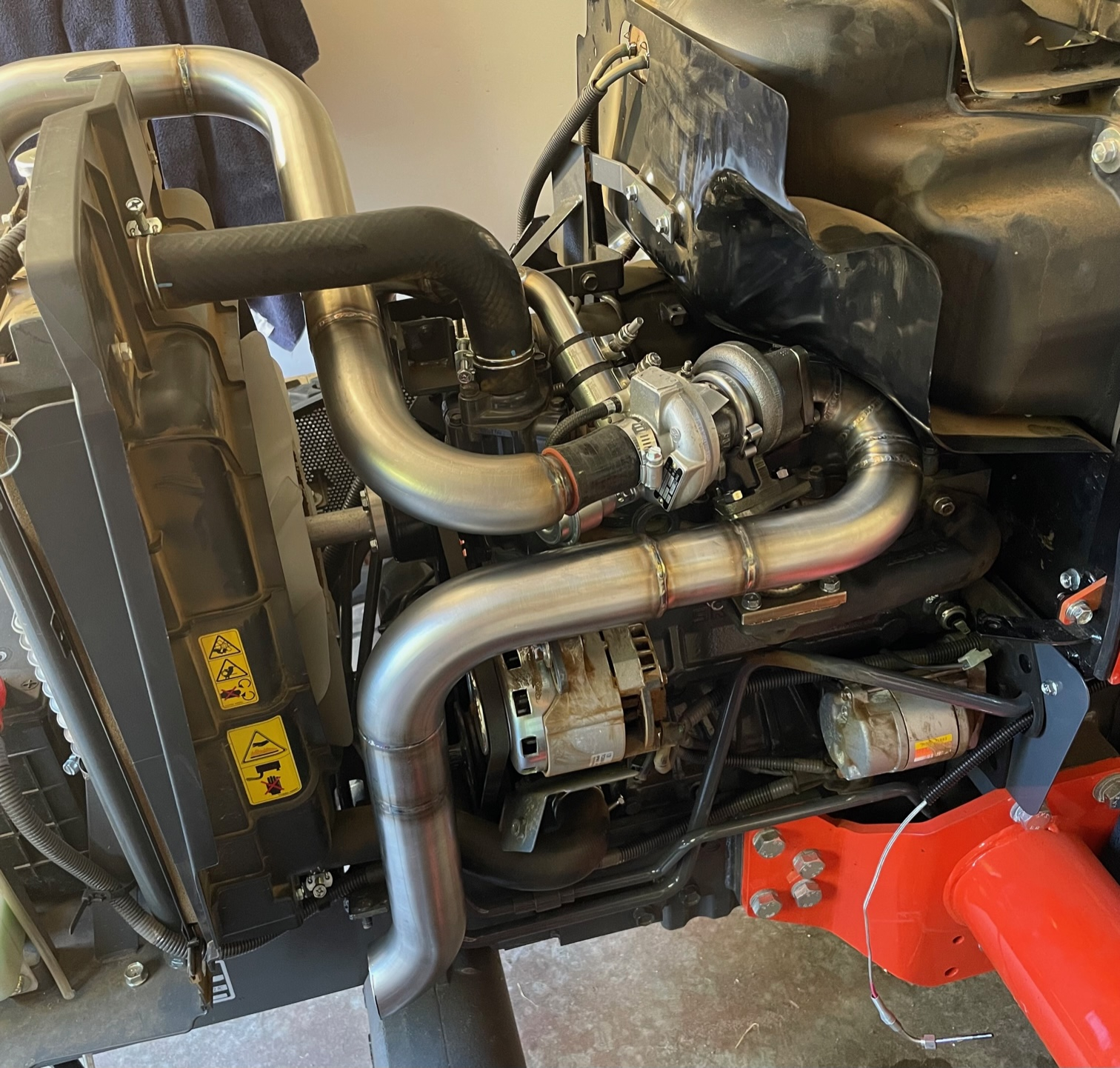

I want my Turbo system to maintain a stock unmodified appearance. Meaning, I want to make sure all factory body panels remain in place and the Turbocharger system itself, including all piping and tubing components, fit snugly under the hood, no cutting, modifying, or debauchery required. Continuing with the “stock appearance” theme I recognized the importance of keeping the exhaust pipe in the factory location. By doing so, it will help keep the exhaust fumes away from the operator while running the tractor. I’m sure we all agree, this is a keen resolution and we’ll make it happen!

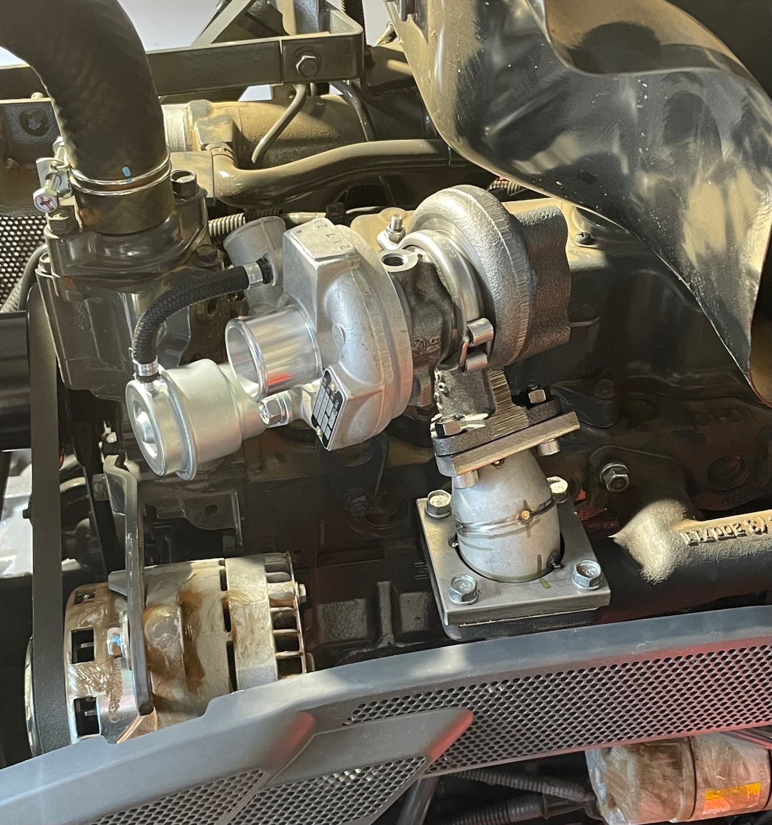

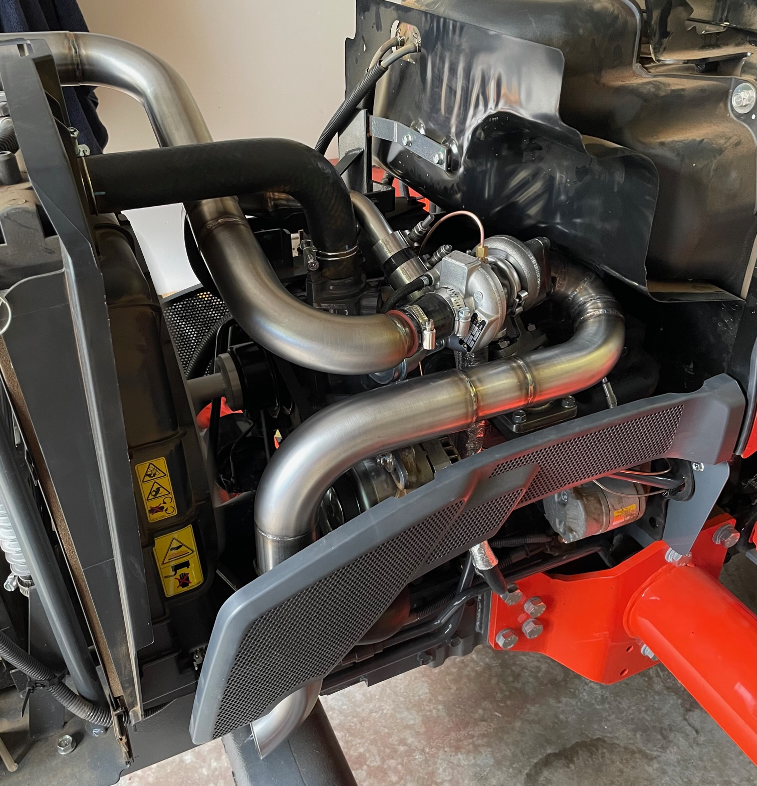

Next, we turned to mounting the Turbo on the L2501’s factory exhaust manifold. I know, I know, this topic sounds incredibly boring and ridiculously unnecessary but, it is truly an important consideration. The Mitsubishi MHI TD025 Turbocharger will not simply bolt on the L2501’s exhaust manifold. Of course, this discovery is unbelievably disappointing news! To resolve this issue, we had to decide to either fabricate a custom Turbo exhaust manifold, or make some type of an adapter to mount the Turbo to the factory exhaust manifold. A gloriously awe inspiring extravagant custom stainless steel tubular Turbo exhaust manifold would be wildly awesome and incredibly impressive, but with material costs, time and labor, it would also double the cost of the Turbo system.
So, an adapter it is! Heavy sigh.
Most guys in this situation will simply make a “sandwich” adapter to mount the Turbo to the exhaust manifold. It involves taking a piece of steel plate, drilling some holes, bolting it to the exhaust manifold and installing the Turbocharger on top. It’s cheap and effective. However, that’s not what we’re doing, we’re fabricating a proper adapter! Why?
A couple reasons. First, a mandatory requirement for my Turbo system is providing a provision for an EGT (exhaust gas temperature) probe, also called, a pyrometer. The pryometer will be used to monitor engine performance, engine health and fueling adjustments required for tuning purposes. The best location for the EGT probe is in the exhaust collector before the Turbocharger. This way, the probe can measure the temperature of all three cylinders together (not just a single cylinder) before the gases reach the Turbo. Had we decided to pursue the cheapest possible solution, an adapter plate, we wouldn’t be able to provide a provision for an EGT probe. That ain’t gonna happen!
Secondly, there are some performance benefits with a properly designed and engineered Turbo adapter. So, assuming we’re successful in this endeavor, this hard work will payoff. For one, the Turbo inlet diameter and the exhaust manifold outlet diameter are not the same size. By installing a properly engineered Turbo adapter, we’re able to transition the tubing diameter gradually maximizing exhaust flow, improving velocity, which results in faster Turbo response and spool characteristics, ultimately improving performance. Excellent!
I realize this sounds easy but, it takes a lot of additional design, engineering and fabrication work to make a proper Turbo adapter. Fun! Well, not really.
All of these foolish Turbo adapter ideas greatly affect the location and position of the turbocharger in relation to the engine, engine components, exhaust manifold, firewall, hood and hood side panels. We have to make certain that not just the turbo, but all the other turbo components will have enough clearance and will fit under the hood without issue, or interference allowing everything to work in harmony. Wonderful! Not surprising, it took more time than planned but, we eventually got the adapter fabricated, installed and the Turbo properly positioned under the hood.

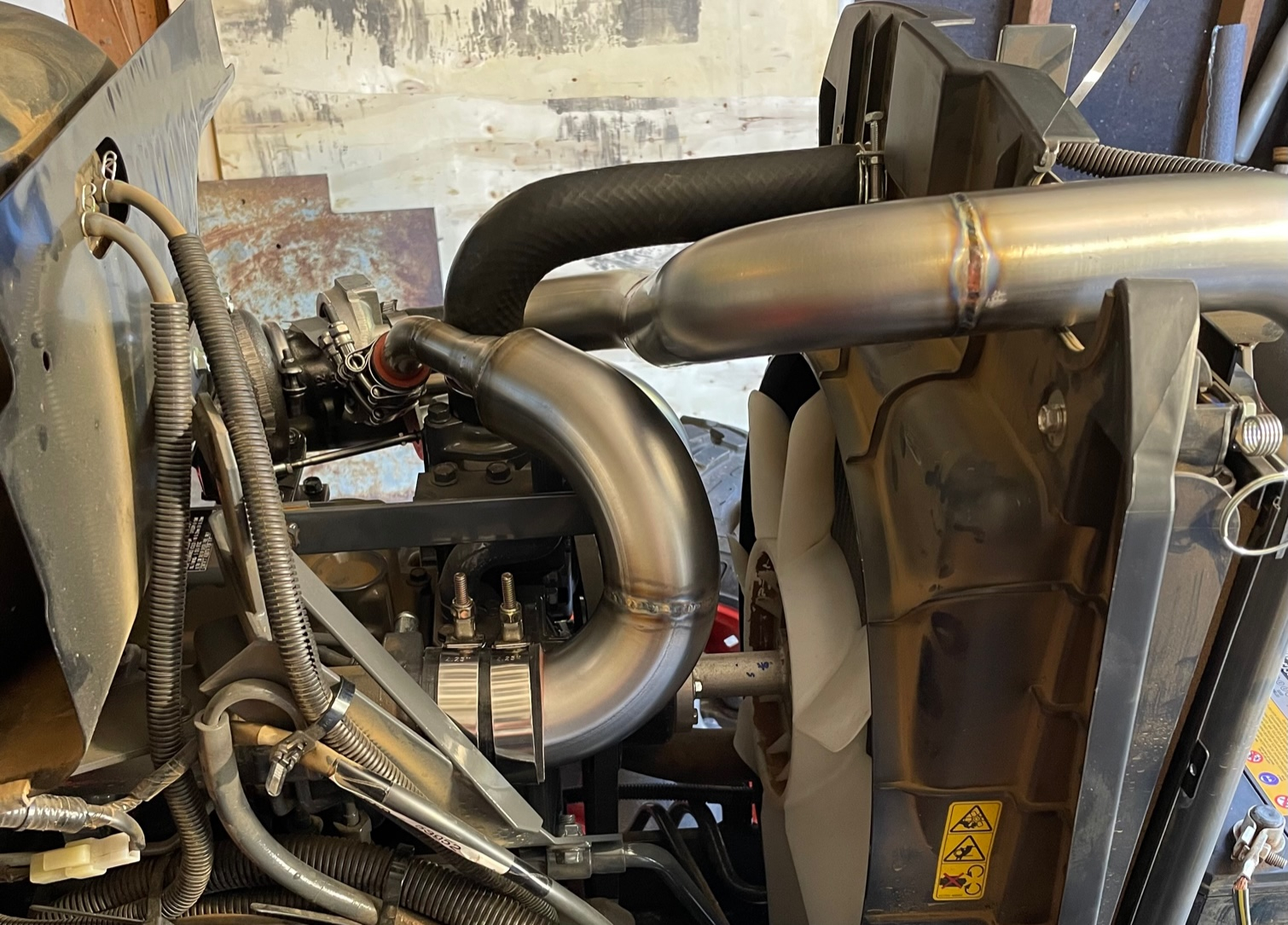

The next big challenge was the Turbo down pipe and exhaust. All things considered, pushing the Turbo forward just a couple inches would make things so much easier. But, since we’re cheap bastards and I decided against building a fabulous custom stainless steel tubular Turbo exhaust manifold, moving the Turbo forward, is not possible. So it took a colossal amount time and effort to fabricate the down pipe and shape it in such a way to maximize performance, fit the tight confines under the hood with acceptable clearance and allow access to the mounting hardware. But, we did it! Thank heavens!
We’re very happy with the results.
How about the Installation? What is involved? How long does it take? Can anyone do it?
It’s one thing to design, fabricate and build an entire Bolt-on Turbo system. But, it’s a whole new challenge for someone completely unfamiliar with the project to install it. Thankfully we had that in mind. We wanted to make sure the Turbo kit is easy to install (and remove if necessary).
The installation itself consists of several steps starting with the removal of the front loader, the hood and plastic hood side panels. It’s a good idea to have a buddy help with the unruly hood.
Once those obstacles are removed, you just need to remove the muffler, factory rubber intake hose pipe and CCV (crank case ventilation) hose. With those items in the garbage (stored in a safe place), it’s time to bolt on the Turbo adapter, followed with Turbocharger and the down-pipe assembly. Once these items have been bolted down, it’s time to install the intake piping. Can it really be this easy? Indeed! Install the new CCV hose to the engine crankcase vent tube and intake pipe and then place the vacuum plug on the intake manifold vent nipple. Now, install the Turbo oil drain and feed fittings and hoses. Congratulations! That’s it!
The entire installation takes about an hour. Honestly, I may have left out a step or two but come on, it’ll take two hours max, if you’re totally unfamiliar with the tractor.

It wouldn’t be fair if I didn’t include a baseline EGT test. So, without further delay here are the EGT readings I recorded when 100% stock.
L2501 HST 4WD (LA525 Loader w/ 66” QA Bucket, Liquid Tire Ballast) - ALL STOCK, NO MODIFICATIONS (40* ambient temperature).
Recorded EGT’s:
Idle = 200-300*
Traveling on flat ground (M) = 300-500*
Loader and grading work (M) = 500-700*
Traveling up hill carrying medium load (22* Slope, 40% grade) (M) = 600-738*
Peak EGT = 738*
Now, let’s compare the Turbo EGT’s but, with the factory fuel setting. NO ADDITIONAL FUEL HAS BEEN ADDED. We just installed the Turbocharger system and ran the tractor.
L2501 HST 4WD (LA525 Loader w/ 66” QA Bucket, Liquid Tire Ballast) - MHI TD025 TURBO SYSTEM - 4PSI - Factory Fuel Setting (83* ambient temperature).
Recorded EGT’s:
Idle = 250-275*
Traveling on flat ground (M) = 275-500*
Loader and grading work (M) = 500-625*
Traveling up hill carrying medium load (22* Slope, 40% grade) (M) = 575-700*
Peak EGT = 700*
As you can see, nothing really has changed. The EGT’s heat up a bit quicker but, overall, the temperatures are running around 0-75 degrees cooler with the Turbo installed combined the factory fuel setting. I’m assuming this is because there is more air getting forced into the engine with the same fuel volume. Right now, with the Turbo and factory fueling, there is zero smoke coming from the engine, regardless of conditions. The engine is consuming all the fuel it can get and begging for more.
We’re just getting warmed up!
Let’s add some fuel!
I started with a 1/2 Turn, counter clockwise to increase fuel volume. This setting resulted with a peak of 6 PSI and 3 PSI of sustained boost pressure. No smoke was observed during testing and surprisingly, EGT’s dropped under load going up the hill in (M) gear. Strangely, maximum EGT observed was 631 degrees. Weird.
More puzzling, I wasn’t happy seeing only 3 PSI of sustained boost pressure. I began questioning why I wasn’t maintaining more boost pressure. Was it fuel? Or, was it some issue related to the Turbo system? At this moment I started questioning the capacity of the OEM intake assembly and air filter. Could it flow enough air for the Turbocharger? I quickly removed the OEM intake assembly and ran the Turbo open-air (no filter) to see if the factory air intake assembly was causing a restriction.
The tractor did in fact pick up an additional 1 PSI of boost both peak and sustained with the same fuel setting, but only 1 PSI. 1 PSI isn’t monumental. This proved a few things; one, using the OEM air cleaner assembly and filter is perfectly acceptable. Two; with such a small gain in boost pressure, it isn’t worth using an aftermarket performance air filter, especially considering the air filtration issues I experienced previously. And three; I need more fuel. I reinstalled the OEM air cleaner assembly and prepared for additional testing.
I gradually increased the fuel volume to 1 full turn, counter clockwise. This setting resulted with 7 PSI peak and 4 PSI sustained boost pressure. No smoke was observed during testing. That’s not enough sustained PSI. I still wasn’t pleased with the results.
L2501 HST 4WD (LA525 Loader w/ 66” QA Bucket, Liquid Tire Ballast) - MHI TD025 TURBO SYSTEM - 7 PSI - Fuel setting, 1 Full Turn (75* ambient temperature).
Recorded EGT’s:
Idle = 275-300*
Loader and grading work (M) = 500-630*
Traveling up hill carrying medium load (22* Slope, 40% grade) (M) = 500-640*
Peak EGT = 640*
I then increased the fuel volume to 1 1/2 turn, counter clockwise. This setting resulted with the same 7 PSI peak but, 5 PSI sustained. Now we’re getting somewhere! There was some smoke observed at startup and a puff or two during operation. Not bad. I was happy to be making progress, but, still unhappy with the results.
L2501 HST 4WD (LA525 Loader w/ 66” QA Bucket, Liquid Tire Ballast) - MHI TD025 TURBO SYSTEM - 7 PSI - Fuel Setting, 1 1/2 Full Turns (82* ambient temperature).
Recorded EGT’s:
Idle = 250-300*
Traveling up hill carrying medium load (22* Slope, 40% grade) (M) = 500-641*
Peak EGT = 641*
Shockingly, the numbers really aren’t that different. Why? I just can’t place enough load on the tractor to make it work hard enough to sustain boost pressure. Even going up my big hill in (M) gear carrying a load isn’t enough to maintain a load on the tractor. Crazy!
My testing parameters are flawed.
Luckily, a forum member reached out to me with a remedy. He suggested to run the tractor up against an unmovable object to create a heavy load on the tractor. Ahhh, that makes sense! He also suggested adding even more fuel. Done! In addition to his suggestions, I decided to add a new test too. Going up my hill in (H) gear carrying a load! Two new tests! Let’s see what we have now.
The results came pouring in!
L2501 HST 4WD (LA525 Loader w/ 66” QA Bucket, Liquid Tire Ballast) - MHI TD025 TURBO SYSTEM - 9 PSI - Fuel Setting, 2 Full Turns (64* ambient temperature).
Recorded EGT’s:
Idle = 250-300*
Loader and grading work (M) = 500-680*
Traveling up hill carrying medium load (22* Slope, 40% grade) (H)= 500-779*
Immovable object = 985*
Peak EGT = 985*
More is better. I increased the fuel volume to 2 1/4 turn, counter clockwise. This setting resulted with 10 PSI peak and 8 PSI sustained boost pressure. There is some smoke observed at startup and a puff or two during operation, but there is no visible smoke under full load. In all seriousness, the tractor is begging for even more fuel. I swear there’s more boost pressure and more power to be unlocked. No doubt. However, we’re recording just over 1000 degrees peak EGT and that’s right where I want to be and that’s as far as I’m going (for now).
L2501 HST 4WD (LA525 Loader w/ 66” QA Bucket, Liquid Tire Ballast) - MHI TD025 TURBO SYSTEM - 10 PSI - Fuel Setting, 2 1/4 Full Turns (78* ambient temperature).
Recorded EGT’s:
Idle = 250-300*
Loader and grading work (M) = 500-730*
Traveling up hill carrying medium load (22* Slope, 40% grade) (M) = 500-650*
Traveling up hill carrying medium load (22* Slope, 40% grade) (H) = 500-812*
Immovable object = 1,033*
Peak EGT = 1,033*
Overall, I’m very pleased with this setting and the performance I’m feeling. The L2501 Turbo, is awesome!
Whatever bro. EGT measurements, testing and comparisons blah, blah, blah, blah, blah.
Are there any performance gains with the Turbo installed? Does the tractor work better? Can it do more stuff?
It’s gonna be a minute before I can get my tractor to a PTO dyno. However, I can share the perceived gains I’ve experienced with the Turbo system installed.
Initially, I was expecting more overall performance. I assumed the tractor would behave similar to a car or truck equipped with a Turbocharger setup and would produce additional power in all working conditions, even without a load. But, that’s obviously not the case as illustrated with the final EGT tests. The tractor has to be under a heavy sustained load for the Turbo to really function. So, while driving and operating the tractor in normal conditions, you really can’t feel any difference. Literally, 90% of the time doing minor tasks, it feels like a completely stock L2501, which isn’t a bad thing. But, when you need power, it’s there!
L2501 vs Hill.
First and foremost, having the ability to carry heavy loads up my big hill in (M) gear was an important consideration for improvement and a specific task my tractor continually struggled with incessantly. With the Turbo installed, the L2501 has zero issues carrying a heavy load up this hill in (M) gear. At 2,200 RPM the tractor maintains speed and boost pressure all the way up and over the hill. The RPM’s remain constant and the L2501 absolutely refuses to bog down regardless of the load it’s carrying. It’s a relief knowing I no longer have to crawl up this hill. With (M) gear functioning to my expectations, (L) gear is no longer needed. My L2501 Turbo has conquered the big hill and that makes me a very happy operator.
Pushing the envelope, I decided to run my tractor up my big hill carrying a load in (H) gear. In all seriousness, this was a stupid test. The path up the hill isn’t made for speed. It’s uneven and rocky. Trying to go fast isn’t wise. But, I had to give it a shot. For the first time ever, the tractor was able to climb the hill in (H) gear. But, it wasn’t pretty, about halfway up the hill, the Turbo dropped boost pressure, the tractor bogged down and I lost speed and momentum. Regardless, the tractor didn’t give up and it made it to the top of the hill to deliver a load of large branches to my brush pile. In (H) gear? That’s a first! Nemesis no more! The L2501 Turbo is a beast!
Another important consideration was transportation speed in (H) gear. I’m pleased to report the L2501 Turbo can maintain ground speed on flat and hilly paved surfaces and I have full use of (H) gear for transportation purposes. The tractor hilariously takes off rapidly from a stop and accelerates to top speed almost instantly and continues to maintain speed without issue. The tractor shows no sign of bogging down. The Turbo will immediately deliver 9-10 PSI and slowly taper off to 5-6 PSI because the load drops off very quickly after take off. There’s just not enough load without doing actual work to sustain boost pressure.
The L2501 Turbo powers my wood chipper in heroic fashion. During my testing, the tractor didn’t bog down once and it chipped everything I could stuff down the shoot, including whole saplings. There’s some serious power coming from the PTO, it is performing exceptionally well.
Overall, I have not logged nearly enough time on the Turbo system to provide any full conclusions. So, those revelations will come in time. What I can say is that I added the Turbo system to produce more power in challenging conditions. It has in fact delivered.
I know at the end of the day, most of us aren’t in a hurry to get our tractor work done quickly. Our tractors and the work we do with them, is our therapy.
However, I know there are times, when I’ve been on the tractor all day long and it’s starting to get late. The sun is beginning to set and I only have a few more buckets of material to move, a couple more brush piles left to transfer, a small pile of branches left to chip, an acre left to mow, a half acre left to grade, or a quarter acre left to till, a little more power and a little more speed wouldn’t hurt.
Thankfully, I have an L2501 Turbo to do the job.

I had been searching for a facility to test my tractor’s performance for quite sometime. I was utterly bewildered upon discovering that very few tractor service facilities in my area have a PTO dynamometer. Shockingly, even my local Kubota dealer did not have a PTO dynamometer available. Not even for diagnostic purposes? Crazy. Originally I thought, since I live in what could be considered ‘tractor country’ with tons of agricultural businesses in my surrounding area that this type of equipment would be commonplace. Nope! That wasn’t the case at all.
You see, I was in desperate need to find this particular piece of equipment because a PTO dynamometer measures a tractor’s performance by applying a calibrated and controlled braking force on the tractor’s PTO (Power Take Off) while measuring the speed of the rotation. Measuring the speed and power under a specific load allows the amount of torque produced by the engine at different speeds to be calculated. It’s a fairly complex piece of equipment and quite necessary to prove, or disprove the actual performance of my Turbocharged L2501.
I contacted countless tractor service facilities outside of my local area searching for a PTO dynamometer. Unfortunately, I wasn’t having any luck. Heck, at one point, I even contacted a PTO dynamometer manufacturer and inquired about the cost to buy my own PTO dynamometer. But, after learning that they cost upwards of $30,000, that idea was quickly dismissed. Refusing to give up I continued to probe and collect clues from potential service facilities inquiring about a PTO dynamometer to test my tractor until I finally heard the words I needed to hear….”Yes, we have a PTO dyno. Yes, it is available for customer testing”. Woohoo!
The super friendly and helpful folks at Jennings Equipment, Inc. in Chehalis Washington, a Kubota dealership, were the ones that finally answered my call and were able to fulfill my request. They in fact had the elusive PTO dynamometer that I needed to evaluate my tractor’s revolutionary performance modifications and put them to the test.
Not only did they have a PTO dyno, but they have an AW AG.2X series Dynamometer featuring the latest high tech 2100SXT DynoPro computer system. This particular PTO dynamometer is arguably the best and most accurate PTO dyno in the industry today. Bonus!
Hold on a second! Before I disclose the final results, perhaps I should share my original performance goal with this Turbo system. Simply stated, my goal was to surpass the performance output of the L3901 / L3902. These tractors produce 37.5 HP and 30.6 PTO HP respectively.
You said no blather? Common man! Let’s get on with it! How’d it do?
The tractor was hooked up to the AW AG.2X dynamometer and ran for a short time to make sure everything was securely attached to the tractor, functioning properly and recording the essential data.
After the initial setup, we warmed up the tractor to operating temperature and ran it for two merciless hours of testing. The percentage of load was increased incrementally as we continued to monitor engine diagnostics, boost pressure, EGT temperatures and the subsequent performance data. The tractor was ran under full boost and a heavy load for a solid hour. There were no surprises. The engine coolant temperature remained consistent and cool throughout the testing and Turbo system performed beautifully with zero issues whatsoever.
Once again, the Turbo setup;
L2501 HST 4WD (LA525 Loader w/ 66” QA Bucket, Liquid Tire Ballast) - MHI TD025 TURBO SYSTEM - 9 PSI - Fuel Setting, 2 1/4 Full Turns (42* ambient temperature).
Folks, meet the Kubota Standard L Series L2501 Turbo or, perhaps more accurately described as the Standard L Series L4401 Tractor powered by a Turbocharged D1703-M-DI-E4B engine!
The AW AG.2X dynamometer recorded:
PTO = 35 PTO HP
PTO Torque = 339 LB-FT
Engine Horsepower = 44.1 HP
Engine Torque = 109.8 LB-FT
Peak EGT = 1,185*
That’s right! 35 PTO HP!!!
The Turbo kit produced a 45% increase in power! We’ve gone from a measly 19 PTO HP to a gargantuan 35 PTO HP! Yep, that’s Huge!
We achieved the 35 PTO HP at the factory 2,105 RPM PTO setting, our target RPM. Absolutely fantastic! We recorded a maximum of 1,185* EGT, a safe temperature for sustained usage. Excellent! We recorded a maximum boost pressure of 9PSI under full load. Perfect!
In addition, at just a 10% load, the tractor is producing a whopping 26 PTO HP at 2,105 RPM’s. That’s worth repeating. At just a 10% load, the tractor is producing 26 PTO HP. What does that mean? The Turbo system is making so much power and torque that the tractor doesn’t even have to work hard to run most PTO implements. Simply remarkable!
