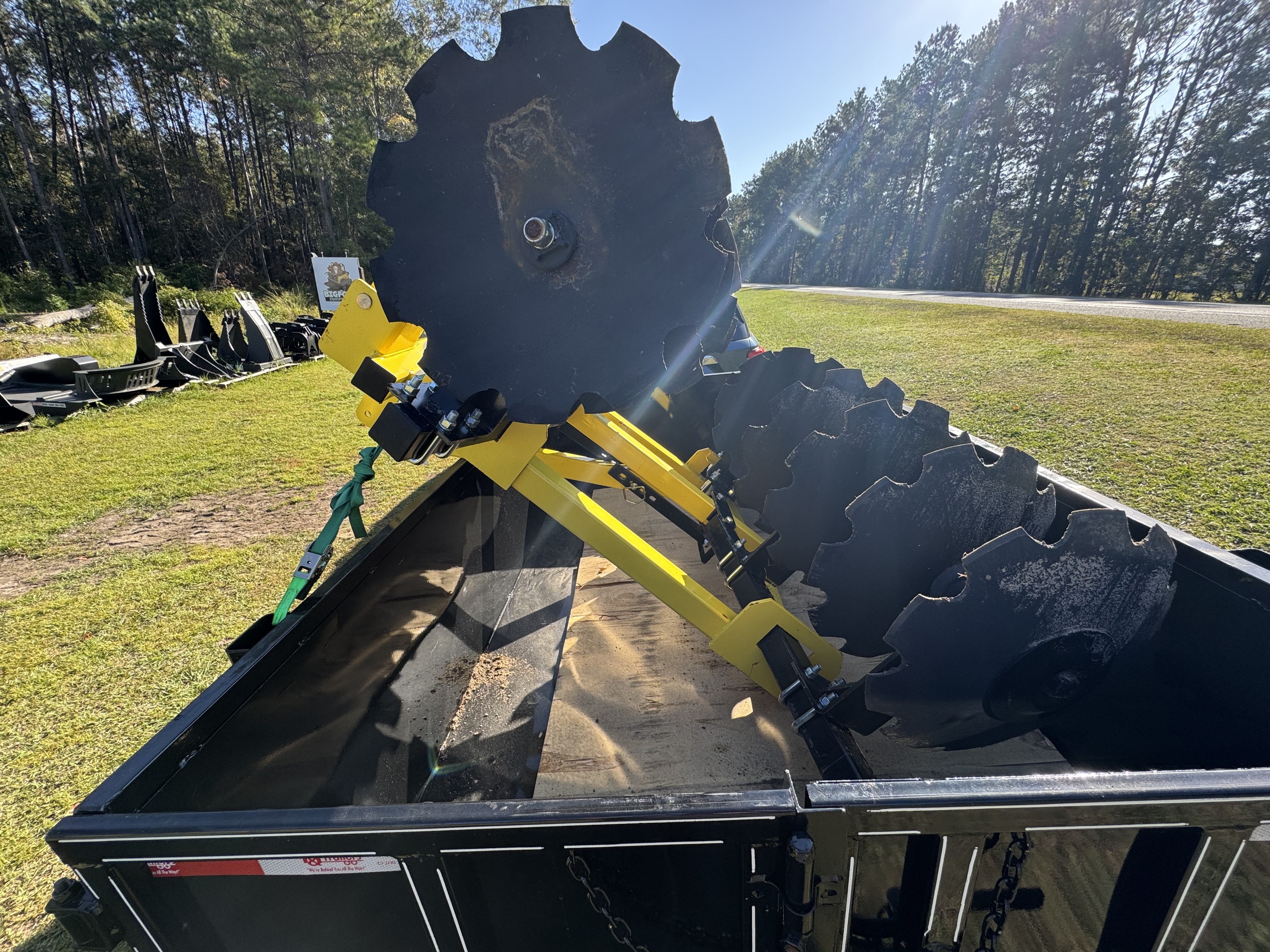

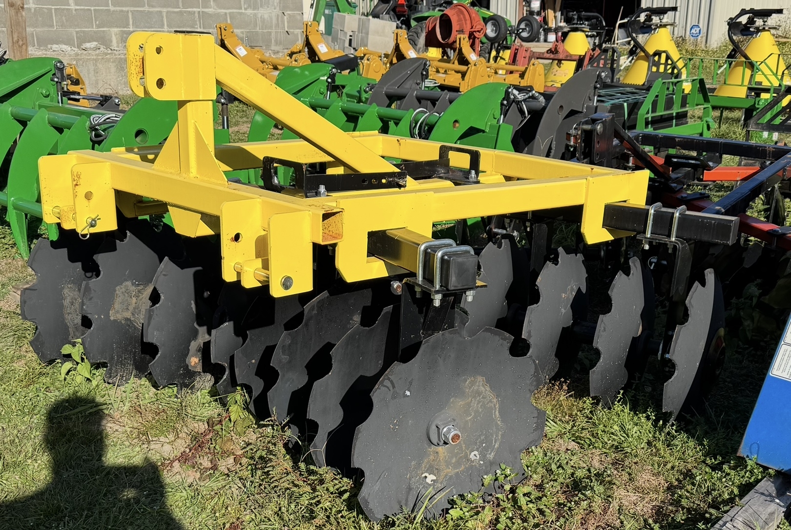

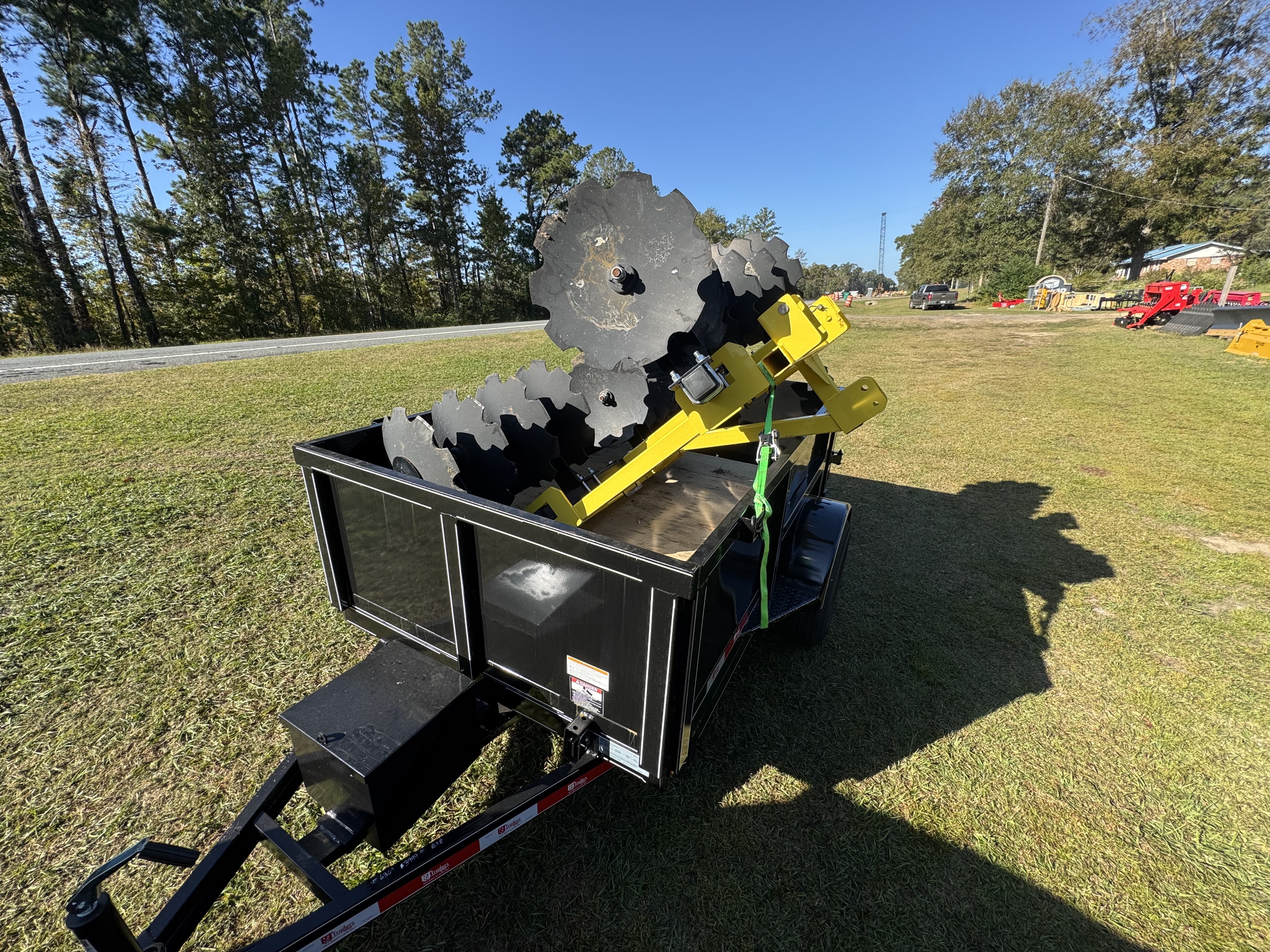

Thanks for the feedback. I ended up passing on the Jbar. After looking at umpteen harrows at the Sunbelt Expo last week, I had decided to hold out for a 16/22 Brown harrow. However, while surfing FB Marketplace, I came across something interesting.
A new Atlas 16/22 harrow with tube frame at approximately 960 lbs. I think it only has a 1” axle vs the Brown 1-1/8, but otherwise it’s a beast. That said, for my limited use, I’m betting it will be fine. Price wise, it was less than 1/2 the Brown so it was hard to pass up. Had to cram it into the trailer I had handy but it worked. LOL
EDIT: As I’ve tried to find this harrow online, I’m not finding it anywhere. The Atlas 1500 16x22 online looks different and lists a weight of 1,680 lbs and 7’. I measured this one at 6’ but it’s obviously 16x22 and appears to be made by Atlas. I don’t have a way to weigh it, but it might be way heavier than I thought based on what I’m finding. I’m thinking it may be an older model Atlas 500 series that they don’t make anymore.
