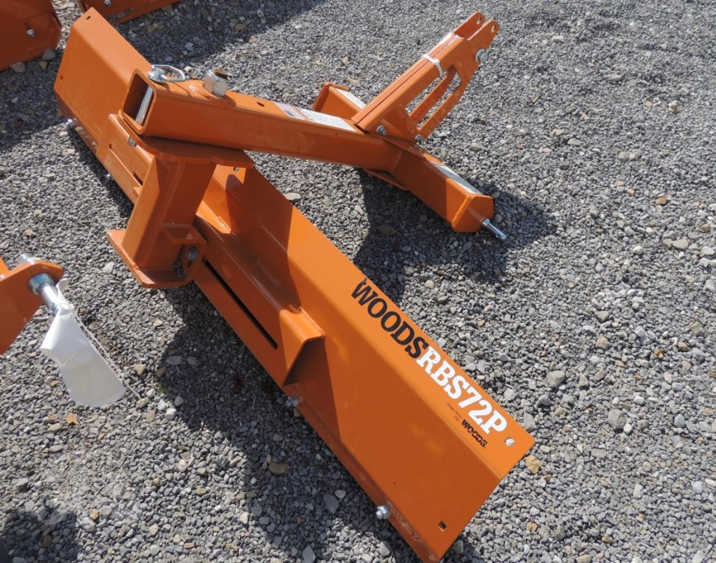

I'm considering a light/medium manually adjustable rear blade and I'd like input on offset adjustments. Land Pride and Woods have variations of slotted bolt adjustments on the moldboard for offset and tilt. I'm concerned about needing a wrench every time I want to make an adjustment and the possibility of the bolts sliding in the slots as I work, but the slots would allow infinite adjustability. Dirt Dog/Rhino has a pin on the 3 point hitch that allows the entire arm to swing. To me this seems preferable because the pin won't work loose like a bolt can. However, these brands are harder to find near me. Should I try to find one with a pin or is the Woods design fine if I don't want to change the offset frequently? I'd also like the option of skids and end plates so that's why I'm looking at certain brands.
Check out Everything attachments. I have their light duty 7' blade, one can use it as an offset and angle at the same time; works great for cleaning out a ditch on the farm.

I have a Woods HBL96-2. It has available skid shoes, end plates, gauge wheels etc. it’s also fully adjustable via pins. Weighs 600lbs and cuts really well due to weight. Bought it used a few years ago and have been very happy with it.
I agree with others that you’ll use features way more often if they are simple. Having to unbolt the blade to offset was something I’m not willing to do since I move the adjustments a lot depending on what I’m trying to accomplish on any given task.

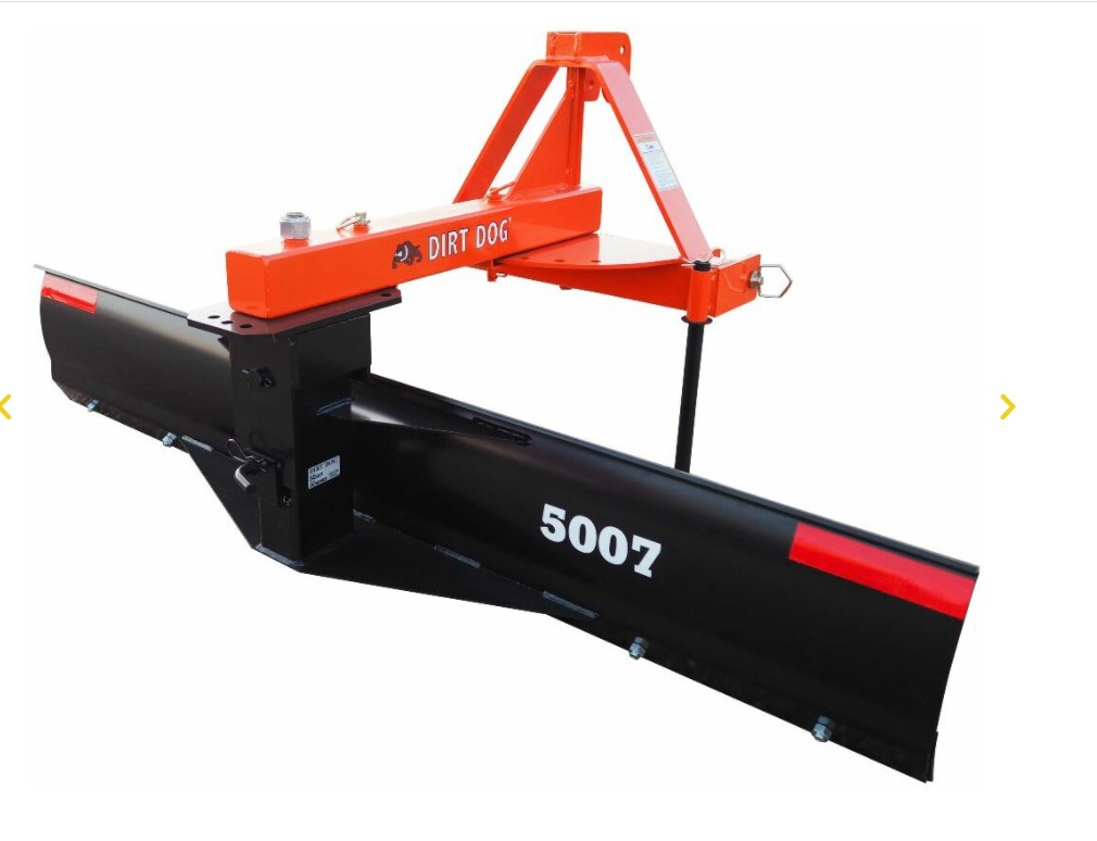

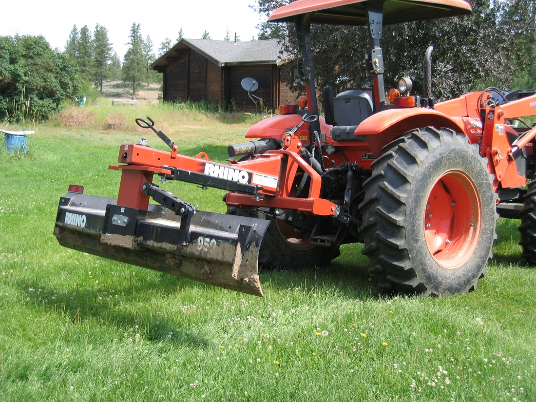

Thanks, that's the kind of insight I'm looking for. After a little more research, it looks like the Dirt Dog/Rhino doesn't have end plates or skid shoes as options on the 50 series, does anyone know of a brand where I can get pin adjustments for everything and at least end plates? I guess I could modify end plates but would prefer not to if I'm buying new anyway.
I'm not familiar with end plates for a scraper blade but I would guess the edge is probably hardened steel. If that's the case it would be hard to make them. If you want the ability to put end plates on it it's probably best to buy a blade that you can get end plates for.
Personally, I've never used a scraper with end plates. I don't know how useful they would be.
A scraper is great for breaking stuff loose and for scraping but for leveling and moving materials around a box blade is the way to go. While the scraper with end plates looks similar I would question how well it works, as the scraper has a thin sharp blade good for digging while the box blade has a blade thats a few inches wide so it doesn't really dig in. I don't think I could get by without a scraper and box blade, although I don't know what you're trying to do with the scraper.

A good heavy rear scraper blade is a far more versatile blade for road maintenance than a box blade.
