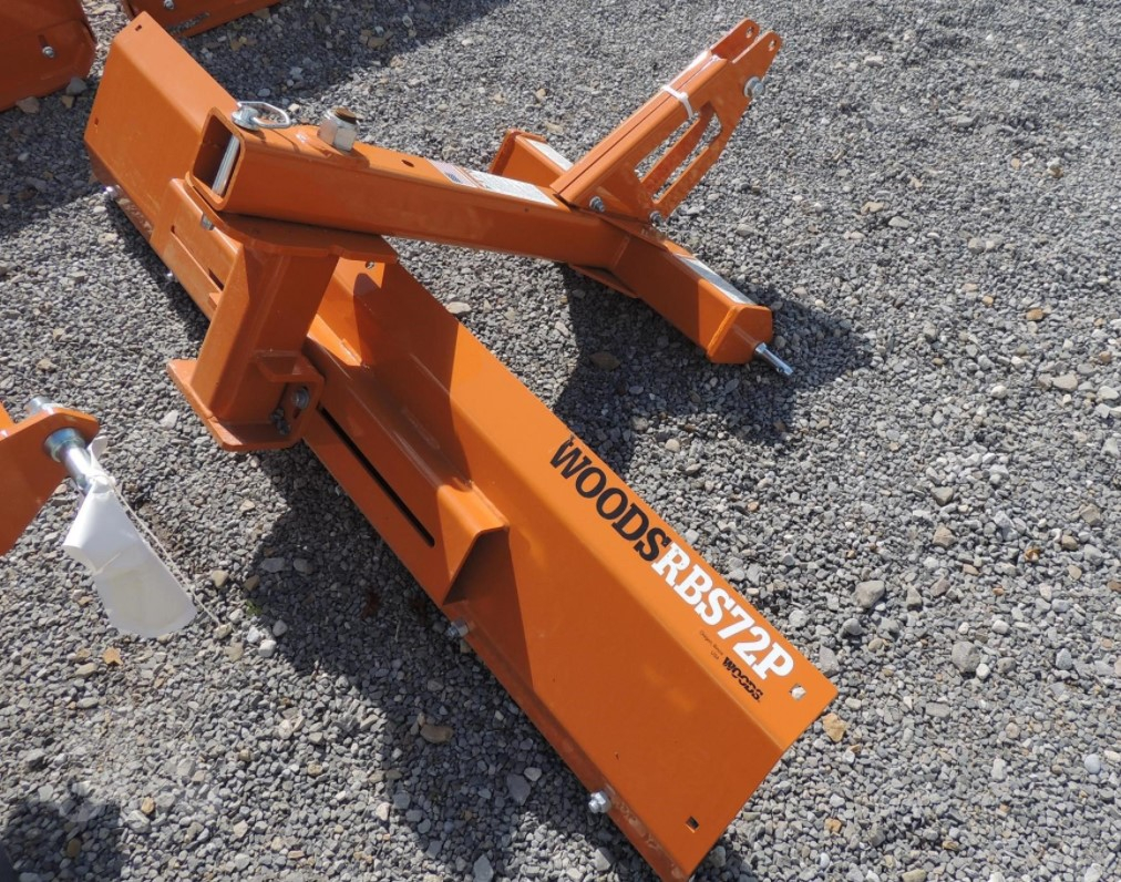

I'm considering a light/medium manually adjustable rear blade and I'd like input on offset adjustments. Land Pride and Woods have variations of slotted bolt adjustments on the moldboard for offset and tilt. I'm concerned about needing a wrench every time I want to make an adjustment and the possibility of the bolts sliding in the slots as I work, but the slots would allow infinite adjustability. Dirt Dog/Rhino has a pin on the 3 point hitch that allows the entire arm to swing. To me this seems preferable because the pin won't work loose like a bolt can. However, these brands are harder to find near me. Should I try to find one with a pin or is the Woods design fine if I don't want to change the offset frequently? I'd also like the option of skids and end plates so that's why I'm looking at certain brands.

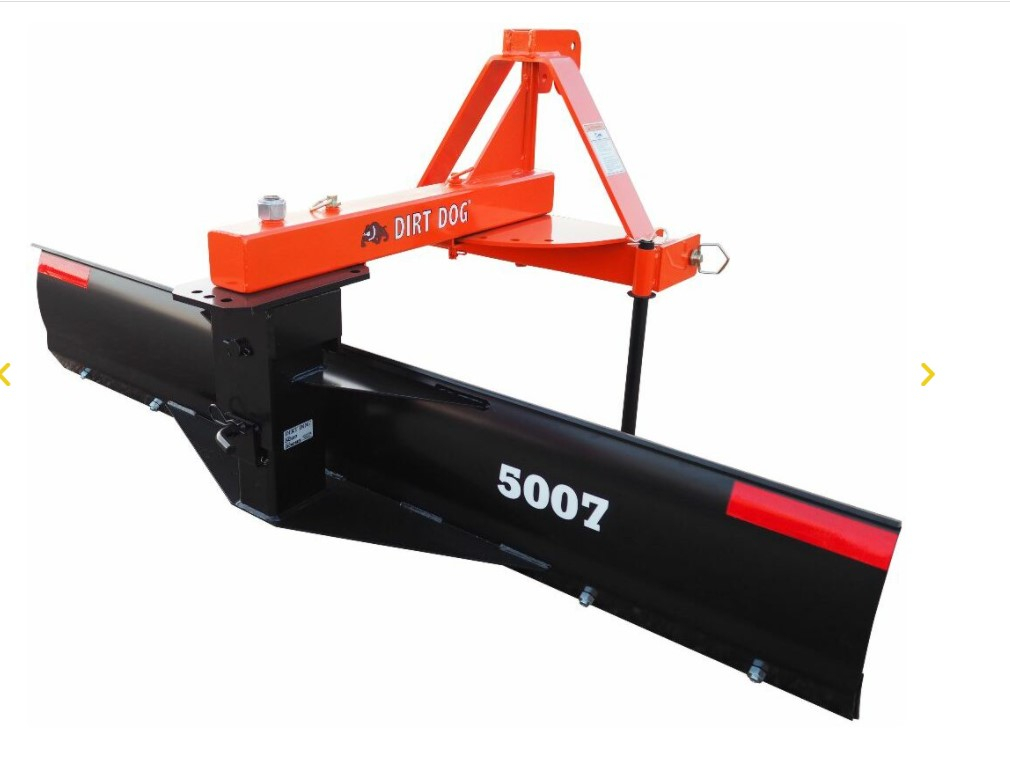

Thanks, that's the kind of insight I'm looking for. After a little more research, it looks like the Dirt Dog/Rhino doesn't have end plates or skid shoes as options on the 50 series, does anyone know of a brand where I can get pin adjustments for everything and at least end plates? I guess I could modify end plates but would prefer not to if I'm buying new anyway.

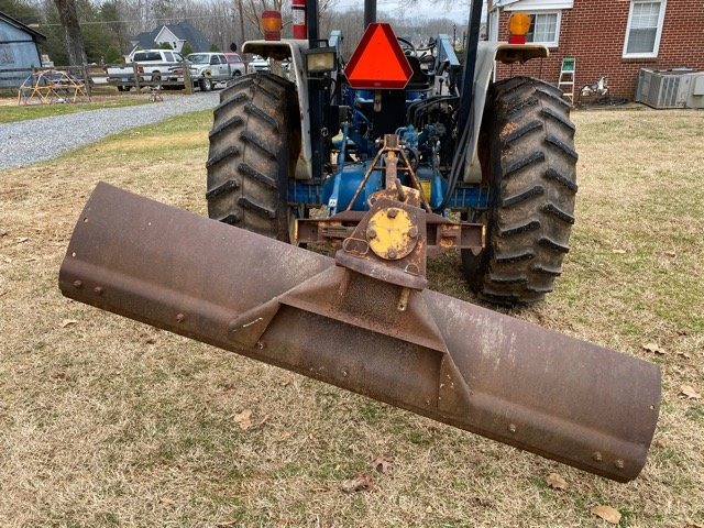

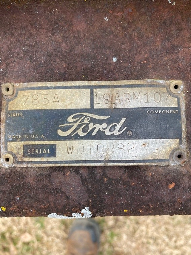

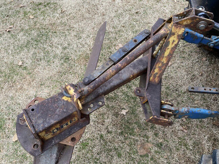

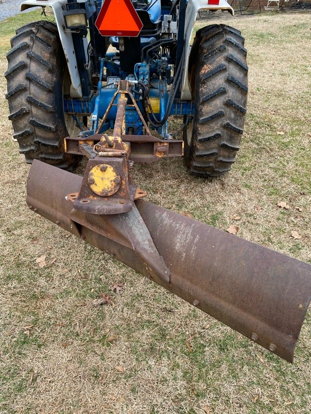

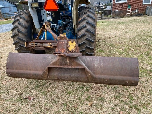

Search the local classifieds and local dealers for an older one. I found this Ford 785A at a local used dealer. They are a lot heavier than new ones these days. This one offsets either way, tilts, angles, etc. all with pins.

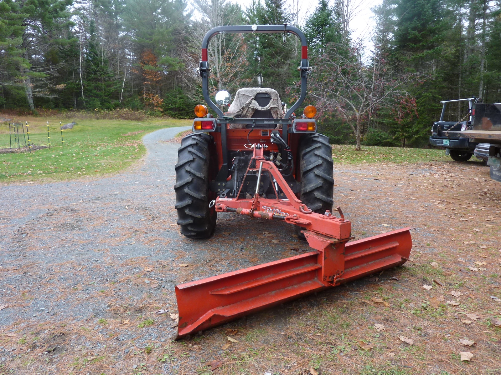

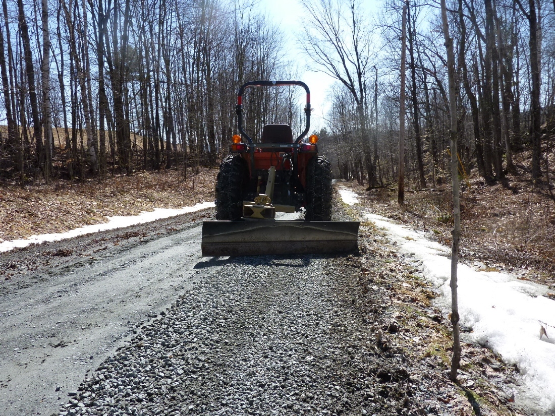

Being able to offset the blade can be a very handy feature but if you will need to switch from offset to balanced often then I think you should strongly consider a wider blade. That said I have two offsetable blades. I only use the offset in special situations like during mud season and I don't want to break down the edge of the road but I want to clean up the edge so water will run off.
That's a LandPride where you unbolt the mold board and slide it over. I'm running it backward on the soft road. It is a little cumbersome to set up but OK because I keep it offset for the entire job.
The other is a TufLine blade which swings for the offset. It is much easier to set up with the ratchet screw. I offset it in the winter pushing snowbanks back or ditches with my bigger tractor. You lose some adjustability with the angle adjustment because when you offset you are already at 45*. To get the blade straight you go to the 45* hole then if you want to further on the angle there is no hole. If you can picture what I am saying. That's not usually a problem crowning a road because you are moving the dirt to the center. But for snow you want to move it to the edge.

Gordon, thanks appreciate the comparison. I think Woods is a little easier than Land Pride because you don't completely remove any bolts, you loosen two bolts and it slides on a track. More cumbersome than a pin, but I can probably live with it since it comes with the other options of skid shoes and end plates. So far haven't found a manufacturer than has it all on a medium weight blade that doesn't involved hydraulics.

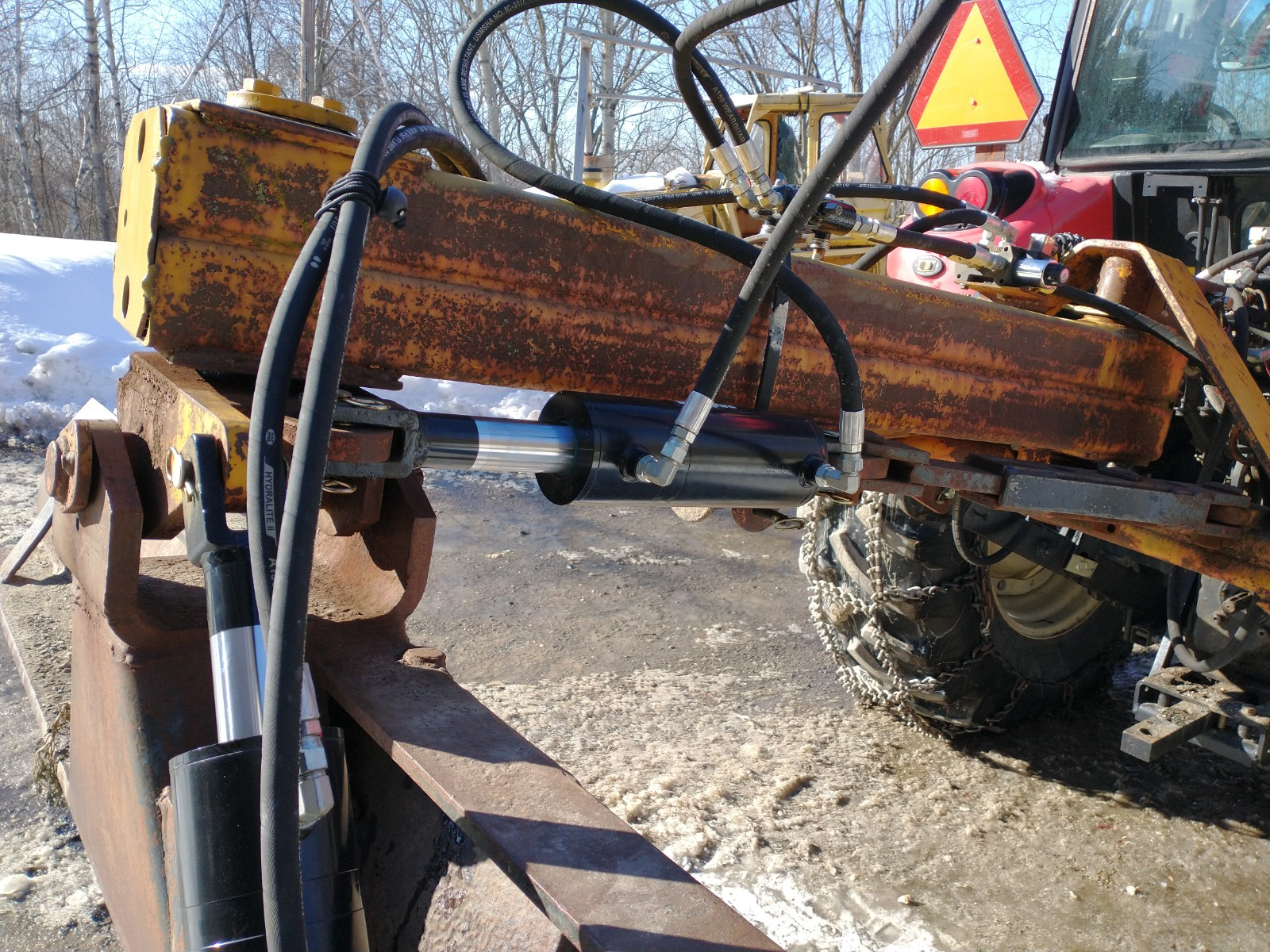

Blades have to be constantly adjusted, they are not a set it and forget it piece of equipment. I went with the pin type rhino and sure glad I did. I'm considering adding hydraulics now because of the constant adjustments needed when building roads. By what you need and don't settle for less is my motto.
