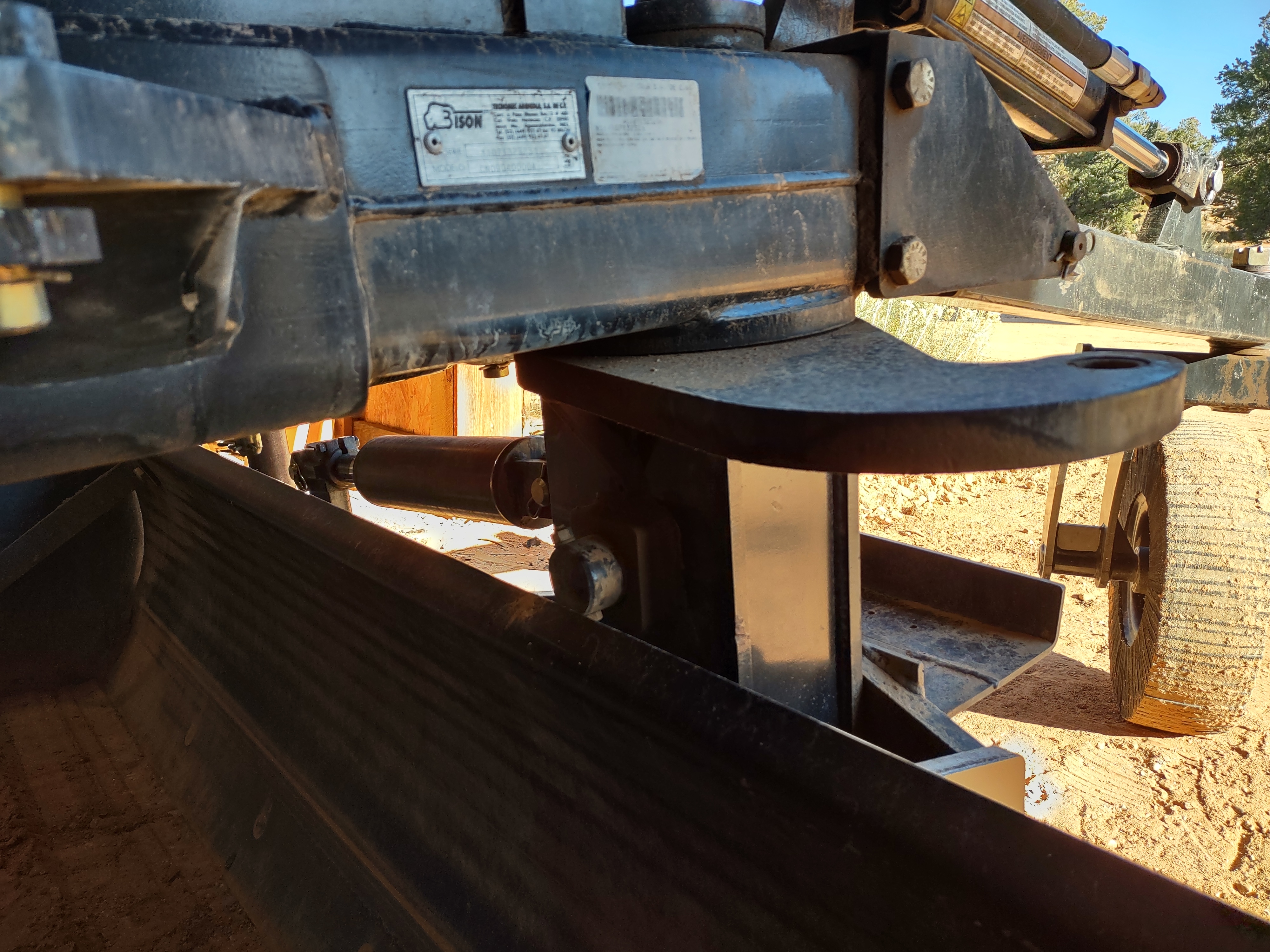

Can you post some pics of the back of the blade? Especially the angle mechanism and how everything attaches to the top beam. I don't understand why the side plates on the beam aren't parallel to the top beam.

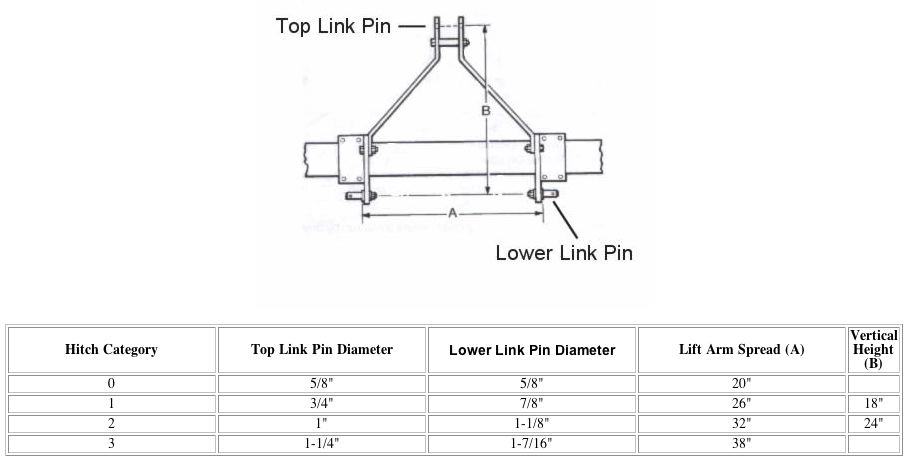

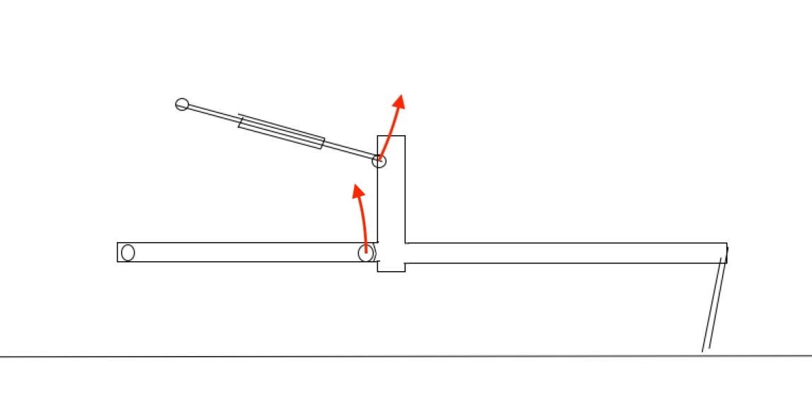

Often when there are two top link holes on the implement, the bottom one is for a quick hitch hook and the top hole is for a top link.
Because of the hitch geometry, the lower the top link pin is to the lower link pins, the more tendency for the rear of the implement to go down as the implement is lifted.
See dimension "B" for category 2.
Looking at this diagram below, with the top link too low on the implement, you can see how the top link moves rearward as it lifts, causing the rear of the implement to go down as the front raises.
Having the gauge wheel on the rear of your blade makes your system even more sensitive to this problem.
