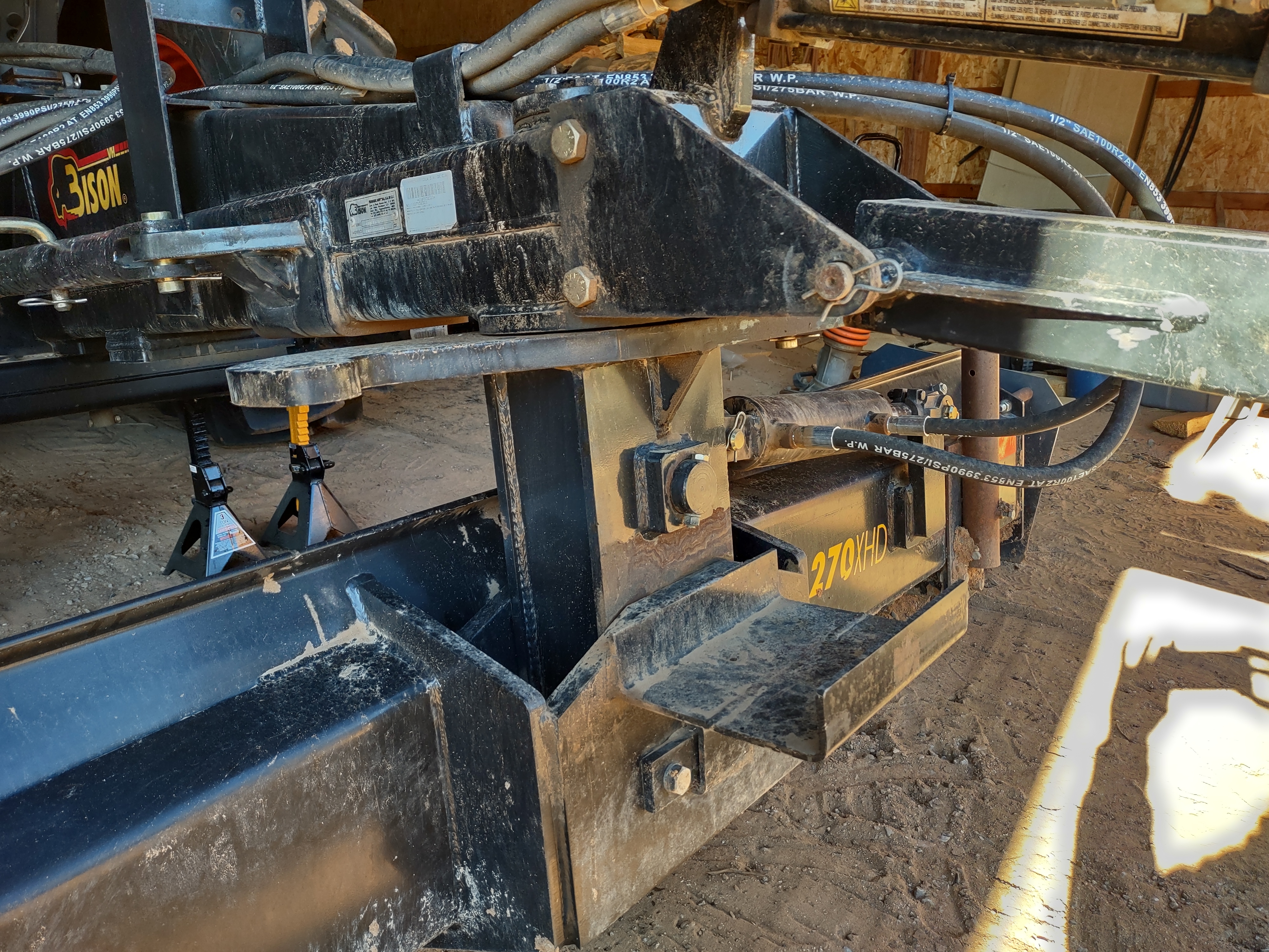

Can you post some pics of the back of the blade? Especially the angle mechanism and how everything attaches to the top beam. I don't understand why the side plates on the beam aren't parallel to the top beam.
Here are some pics. You can see the side plates are angled relative to the blade. I bought it used and it has some modifications, so those side plates might be something the previous owner modified... just a guess.

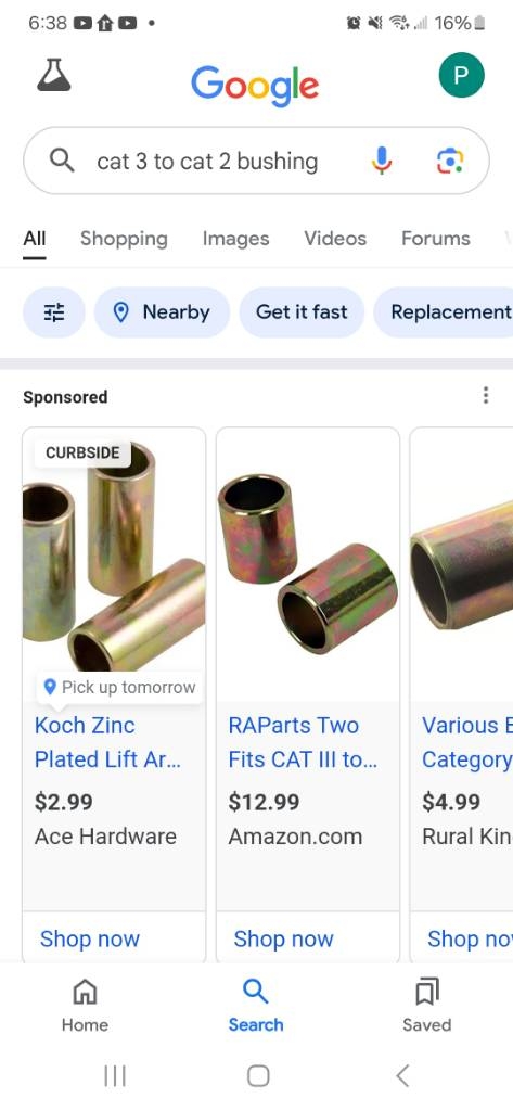

Is it just called a Cat 2 to Cat 3 spacer? I can't seem to find something that would work?
Basically I'm looking for a stepped pin that fits the cat 3 hole on the implement, but then steps down to a cat 2 diameter to accept the top link. Then it needs to have a sleeve bushing to go from cat 2 (inner diameter) to cat 3 (outer diameter) so it fills the cat 3 hole on the other side of the implement's top link.
Does that make sense? Or do I just need a longer cat 2 pin with two cat 2 to cat 3 bushings that I can slide on both ends?
   / Having trouble installing/removing & adjusting rear blade on 3 pt. #26
Cat 3 to Cat 2 reducer bushing is what you need, and you will use a cat 2 pin
Forget what the end plates are doing. You need to get the main framework level to the ground. If you don't, every time you angle the plow it will change the tilt of the plow. First, put the upper link in the top hole on the plow frame like other's have stated.

Thanks guys! I got a Cat 3 to Cat 2 bushing from my local dealer, but it was too long so I had to cut it in half.
Also changed the lower link pins so they no longer float and I adjusted the top link. Everything looks good now and no rotation when raising/lowering.
