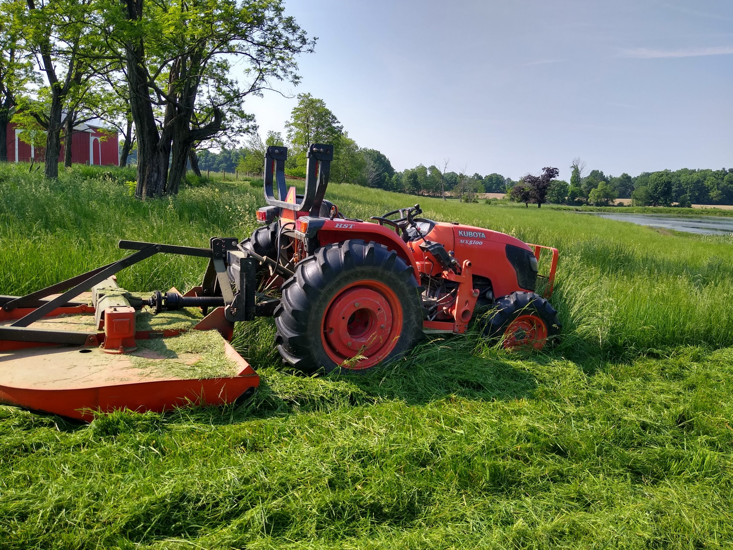

But here is my 1620# cutter that I mow 300-400 acres a year with

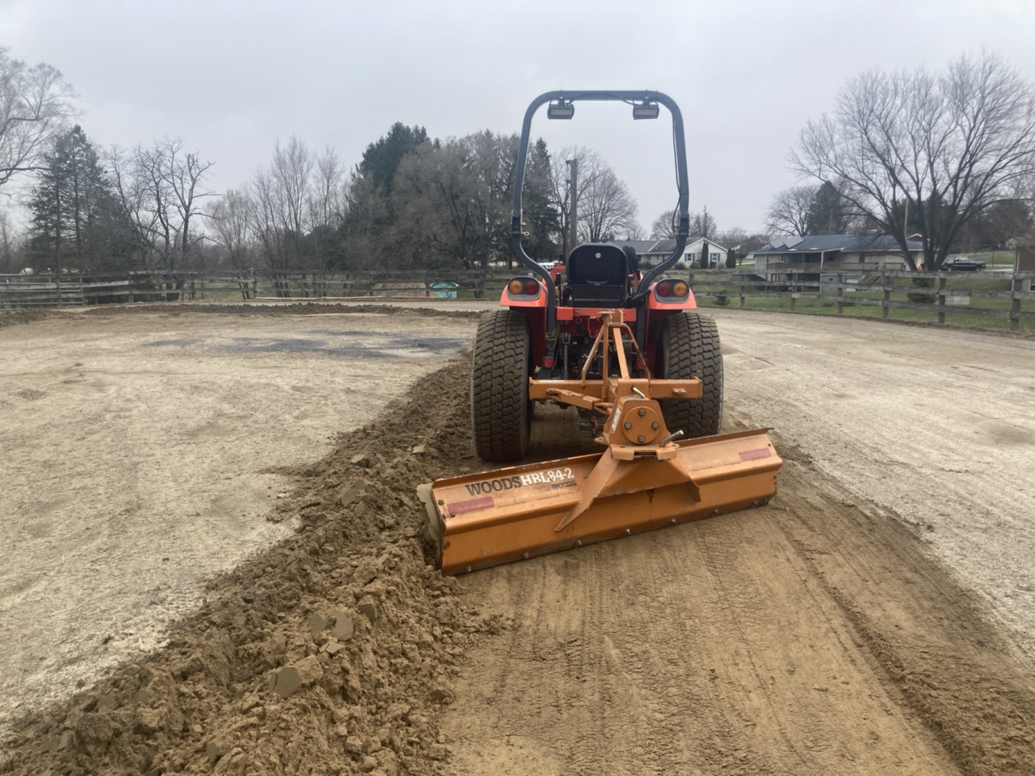

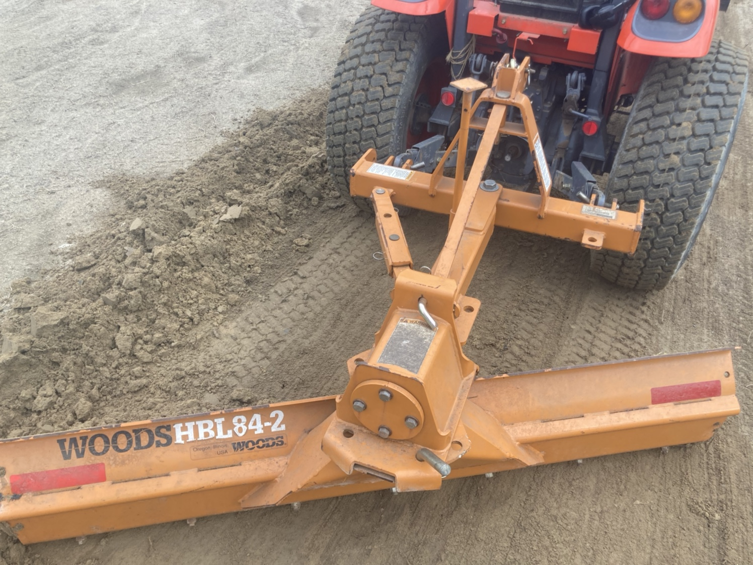

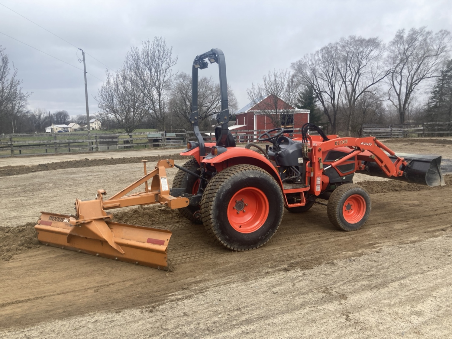

I borrowed on old 7 foot blade that only angled, it was pretty light but worked well scraping the footing in the arena. So then I bought a Woods 7 footer last week and find it too heavy for my uses. Not only does it feel really heavy when transporting (manual says it’s 565lbs), it digs in too much in the material I’m moving. I have to adjust the level constantly, can’t let it float like I could with the lighter blade. Also, the lower lift points are really high so I had to adjust my lift links and it still scrapes on inclines. This blade would be great in harder material, but my uses are loose material and light snow so I’m going to get a lighter one. Live and learn.
There is no such thing as too heavy of a blade as long as your tractor will lift it. It’s all about technique. If the blade is cutting too much into gravel when you’re removing snow, just turn the moldboard around 180 degrees and float it with the back of the blade. Also don’t float it with the cutting edge forward if it’s cutting too deep or consider gauge wheels like some folks are recommending. A heavy blade can work for many uses, but too light of a blade is near useless for road grading. It just bounces and chatters without doing much.
