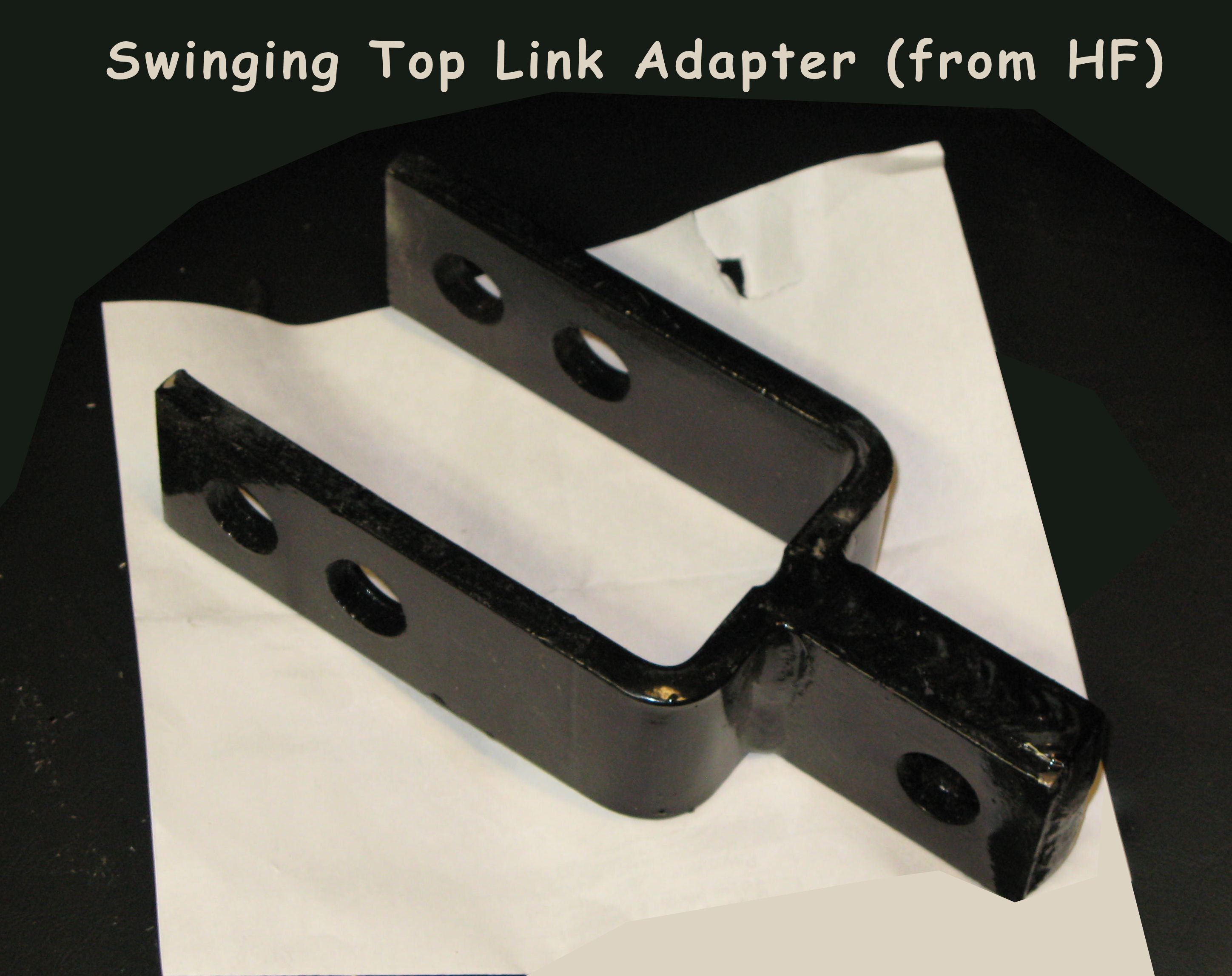

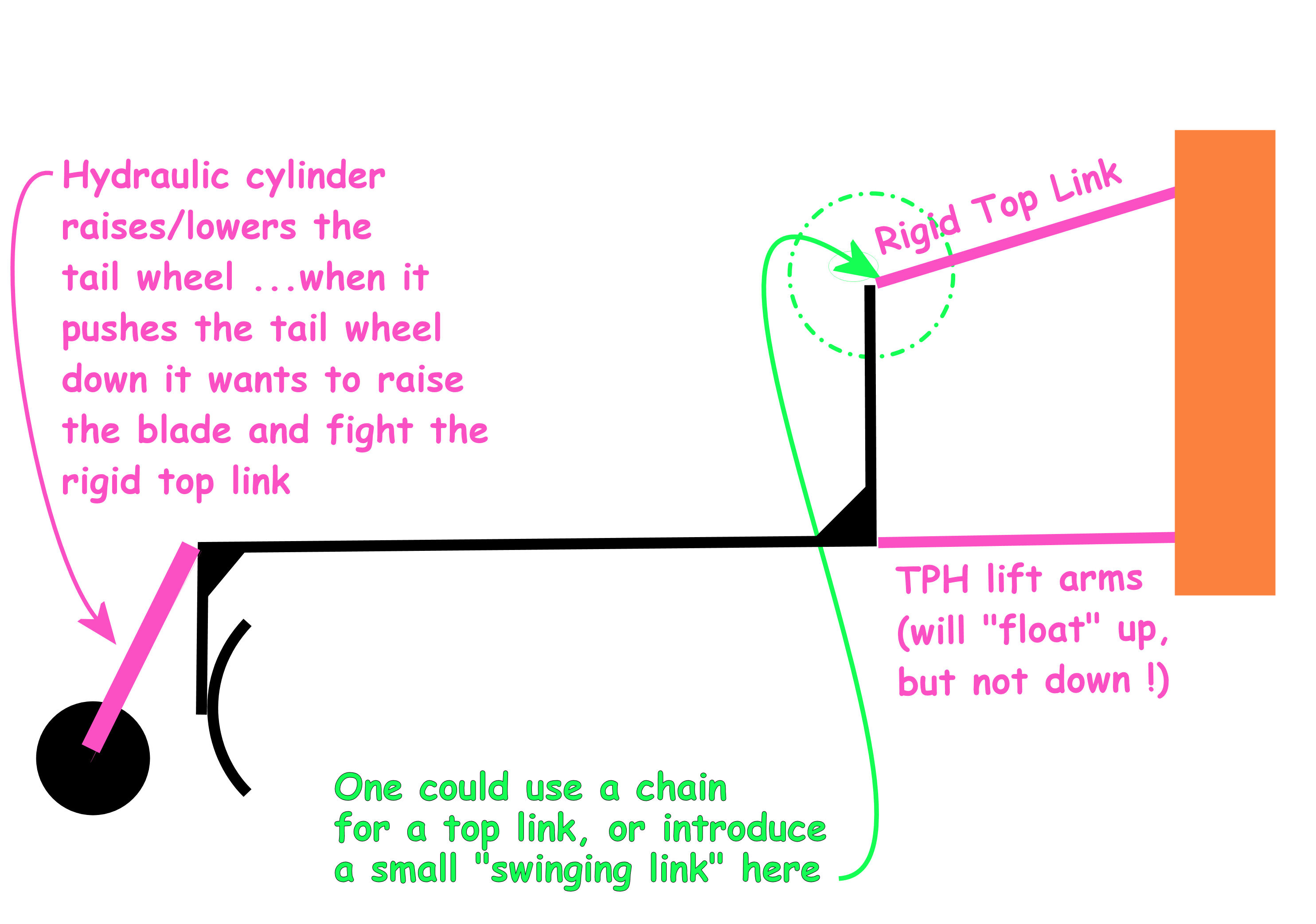

One other thing, if you read the manual carefully, it says "important ...you can leave off the toplink when using the gauge wheel" ...perhaps it means to say, you should/must disconnect the top link. In fact, if you can visualize the geometry, when I lower the gauge wheel to keep the blade just above the surface (as for snow on gravel drive) the gauge wheel fights the top link. I don't want to disconnect the top link because I need it to get the height in travel/carry condition. A chain would work, I suppose, but I have T&T and want to keep the hydraulic top link. My solution is to use a swinging top link in between ...in fact, it is the top link adapter part often discussed with respect to the Harbor Freight quick hitch ...and, that bit of play seems to do the trick.

The "swinging top link" is an adapter or extender for the top link. It is a wishbone shape to connect between the top link cylinder and the implement. Something similar is often used with the HF quick hitch to connect the top link to the implement. The result is a little give in compression but would be active on lift. The effect would not be as dramatic as using a chain for the top link, but still provide some flex.

The "swinging top link" is as was described above. The reason: if you go to the landpride website and look in the owner's/operator's manual for the hydraulic gauge wheel, you will see an admonition/suggestion about removing the toplink. The reason is that extending/lowering the tailwheel wants to raise the blade slightly, which fights the (rigid) toplink. I did not want to lose the hydraulic toplink feature (which you need to raise the blade appreciably for travel, so I use the wishbone-shaped link (which I ordered from HF).
I have a befco finish mower with the same swinging link, and also my rotary cutter ...needed because the back of the mower wants to kick up, depending on the terrain, and it would fight the otherwise rigid toplink. ( ...see my feeble drawing)

As to the lift issue, as you can see in Joel's pics, the long square tube that mounts the blade (between the 3PT attachment points) is high to allow the blade to swing 180* under it, this makes the front mounting points high. To make the bade swing "flat" this tube must be horizontal, the only way to do so is with the top link adjusted pretty long. The hydraulic top link would be nice, you could suck it in for travel. Of course this makes for lots of rear remotes! Angle, offset, tilt, guage wheel and now toplink. This whole issue isn't as big a deal with hydraulic tilt (which I don't have)-you can keep the top link short and compensate with the tilt cylinder. I have to switch working directions too often when doing snow, it would get old doing this manually. I should pull the tilt adjuster, put in some limit straps (chains) and allow the tilt to float, I haven't gone there yet.

The "wishbone" is the toplink adapter for Harbor Freight's quick hitch ...it doesn't seem to show up on their website, you have to call ...I don't have the part number handy but other threads on the HF QH have discussed it.
