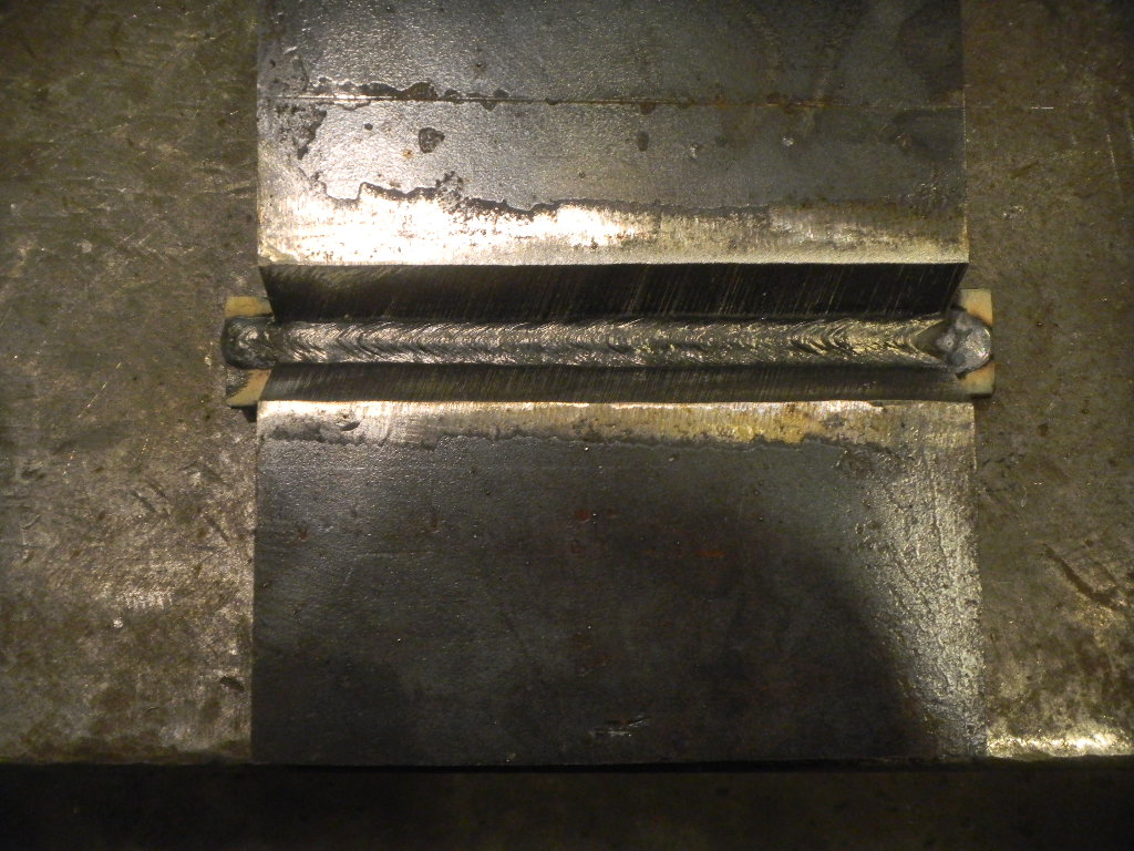

Hope SA didn't give up on us! This is using 110v on 1/8in... push (right to left) vs pull (left to right). Settings the same, manual 6/60 volt and wire speed. Did the push late at night so steadiness not so good but noticed a couple of differences. Bead is wider and flatter on push. I also tried upping the voltage about 10% and dialing down the wire speed to 50 and a got a crap bead. Not even worth sharing.

It looks like you're doing a back and forth motion like you would with 6010 when pushing? There are times when that can work with MIG but for now just try to have a steady weave or even circles to get a uniform width bead. Pushing should be wider and flatter and more volts will give a wider bead too but that doesn't mean you can just crank the volts up.
I feel that my motion is more exaggerated than need be. Having fun with patterns, angles, and such and comparing welds... banging on them and not being real productive at all! :D
