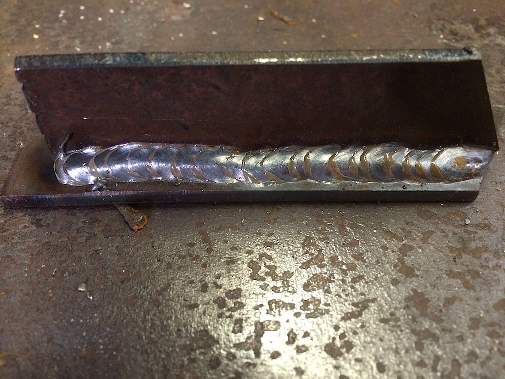

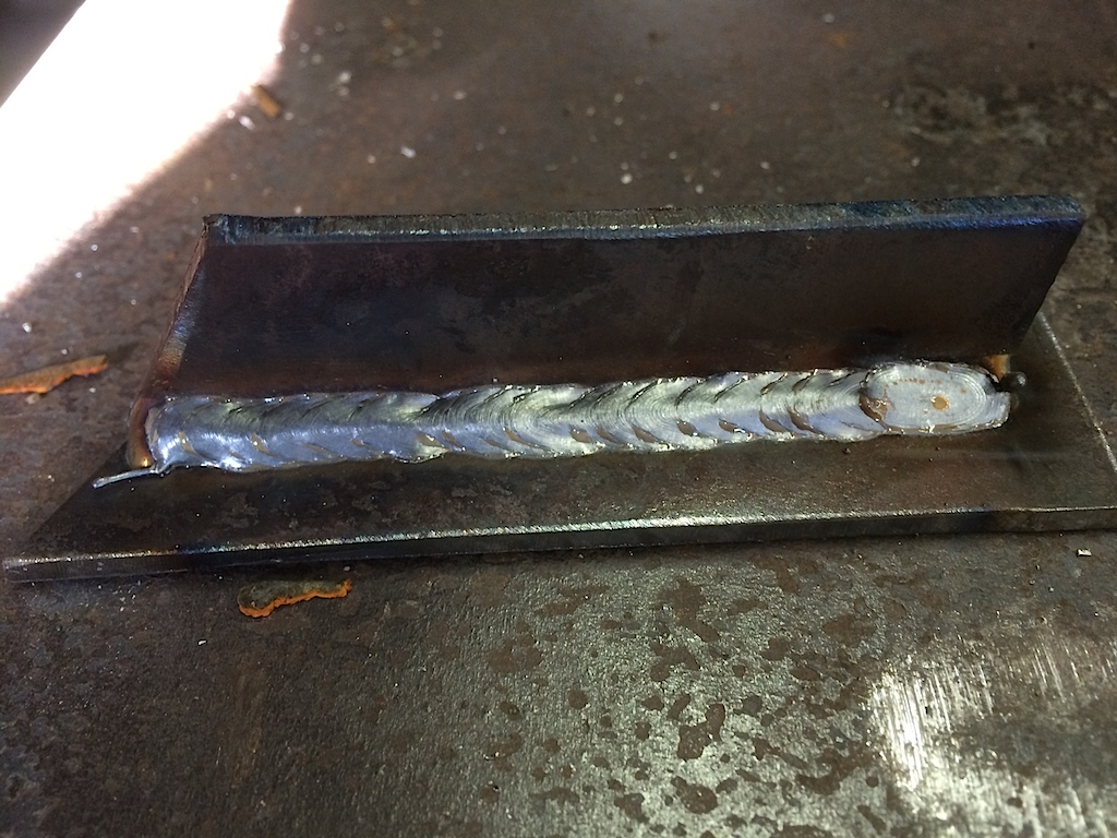

Okay SA, you got me going so I decided to go out in the shop and weld up a 1/8in piece of scrap using my Miller 211 on 110v. It's 90deg plus in my garage but I couldn't stand the local news anymore tonight anyways.
One side weld was set on Auto feed for 1/8in .030wire. The other side was done off the Miller chart inside the case... manual setting is 6/60 on the volt scale and wire feed (whatever that means?). Which weld do you 'like' better? Can you tell any difference? One better than the other? Voltage setting was about 10% higher on one side. Wire feed I have no clue since auto feed setting doesn't tell you what the rate is so no idea. I also have no idea whether this post has any value at all... but it sure felt good to weld than whine.

They're both decent welds. Maybe a little slow on travel speed. Typically more volts gives you a wider flatter bead. I'd guess the second weld had the higher volt setting because it's a little flatter profile.

Hey Arc, I will take 'decent' as a compliment... I am still and probably always will be a 'hack'. Actually the second pic was a bit lower volt setting (manual setting) but like I said, I don't know what the wire speed was on the first one, so the second pic could have been at a slower wire speed (making it hotter, right?) hence flatter? I think my travel speed was about the same for both. Curious though... I thought my travel speed was good (totally based on looks) but could you tell me why you think 'a little slow'?

dragon I agree with Arc weld. The picture on the left looks like slow travel speed. Or like we talked about when you were here. Too much wire in the puddle. Even tho more wire means more amps, you have to have more volts to wet it out. I forget, are you right or left handed? If right handed try starting on your right side moving to the left, pushing the puddle.

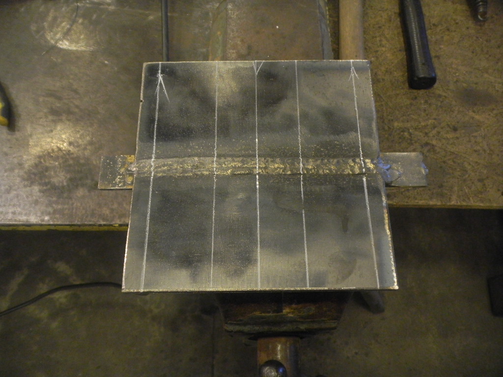

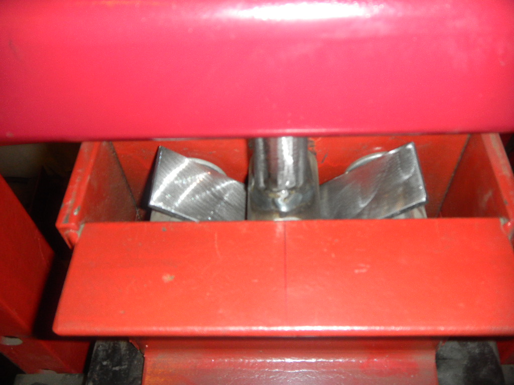

I look forward to the face and root bend tests. The hammer blows thing is a bit too variable for me...(who is swinging what hammer changes things a lot).
Also it has been stated in other threads that to "push" the capabilities of a particular welding machine you consider the material prep and fit in the process. I would like to see that too.
Who has what particular ax to grind isn't interesting to me at all, I am interested in gleaning useful information. Weld on!

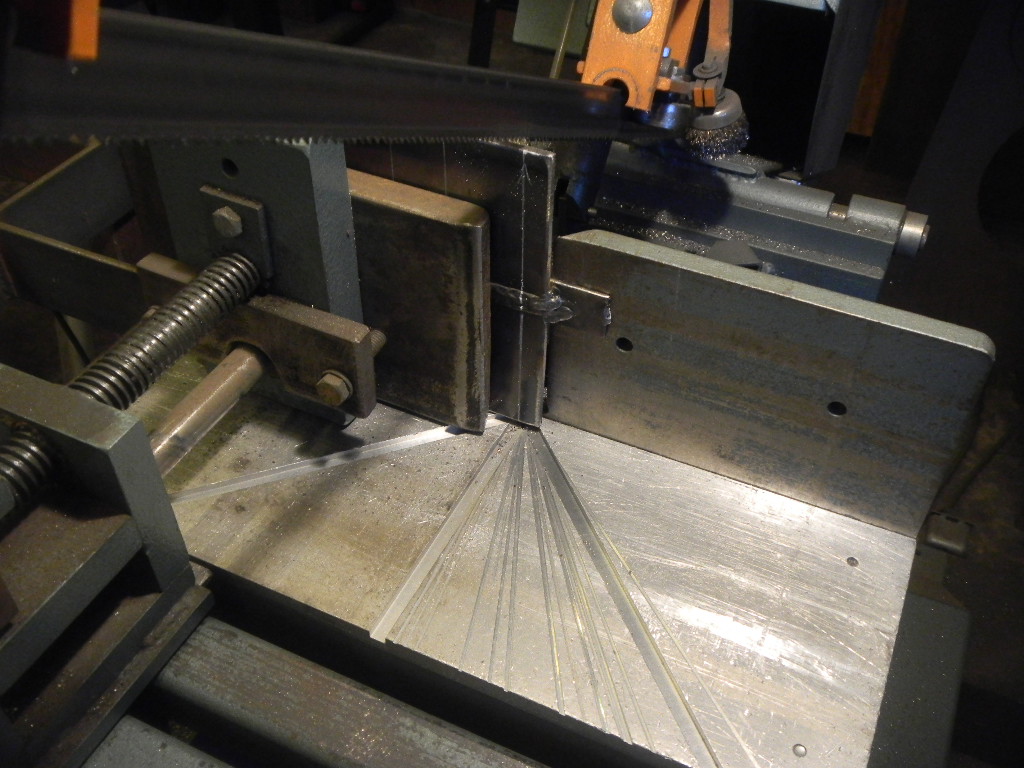

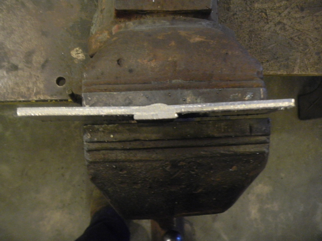

Even tho this is only 3/16-inch material, with 37 1/2-degree bevel. I'm sure it's pushing the limits of this machine. I don't have any 1/4, or 3/8-inch material. Next few days I'll go to town and pick some up.
I sure wouldn't want to do very much of this, slower than the second coming of Christ:shocked:! I almost fell asleep a couple times:laughing:. These coupons look very good to me:cool2:!
