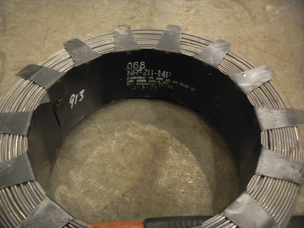

Dave I'm not kidding, I almost fell asleep, it was so slow! On the job we never got anything smaller than .068" wire.
I really like this little gun tho.:cool:

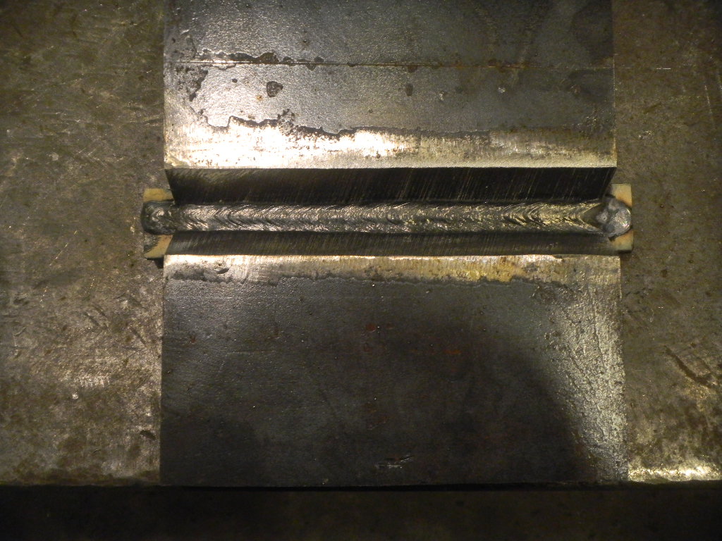

Well I stand corrected!:eek:
Even tho this is only 3/16-inch material, with 37 1/2-degree bevel. I'm sure it's pushing the limits of this machine. I don't have any 1/4, or 3/8-inch material. Next few days I'll go to town and pick some up.
I sure wouldn't want to do very much of this, slower than the second coming of Christ:shocked:! I almost fell asleep a couple times:laughing:. These coupons look very good to me:cool2:!
Nice!
Now with 3/16" plate and three passes to get the necessary quality weld shows that with proper prep and proper techniques, the little machine can do quality work. How many folks would go to the effort of what you did and the necessary cleanup between passes.
NOW the question I have is: How many folks would do three passes on 3/16" material? Or would they run one pass and call it good enough without getting a good tie-in and fusion into the base metal?
I remember when learning to do O/A welding from my father back in the dark ages you can weld thick stuff but it is a multi-multi-pass exercise to say the least even with a #4 or 5 tip.
So a pass for every 1/16 inch in thickness with the little machine is good.
Well a lot of sheet metal is in the ballpark of 1/16" (16 gauge) so makes sense I suppose.

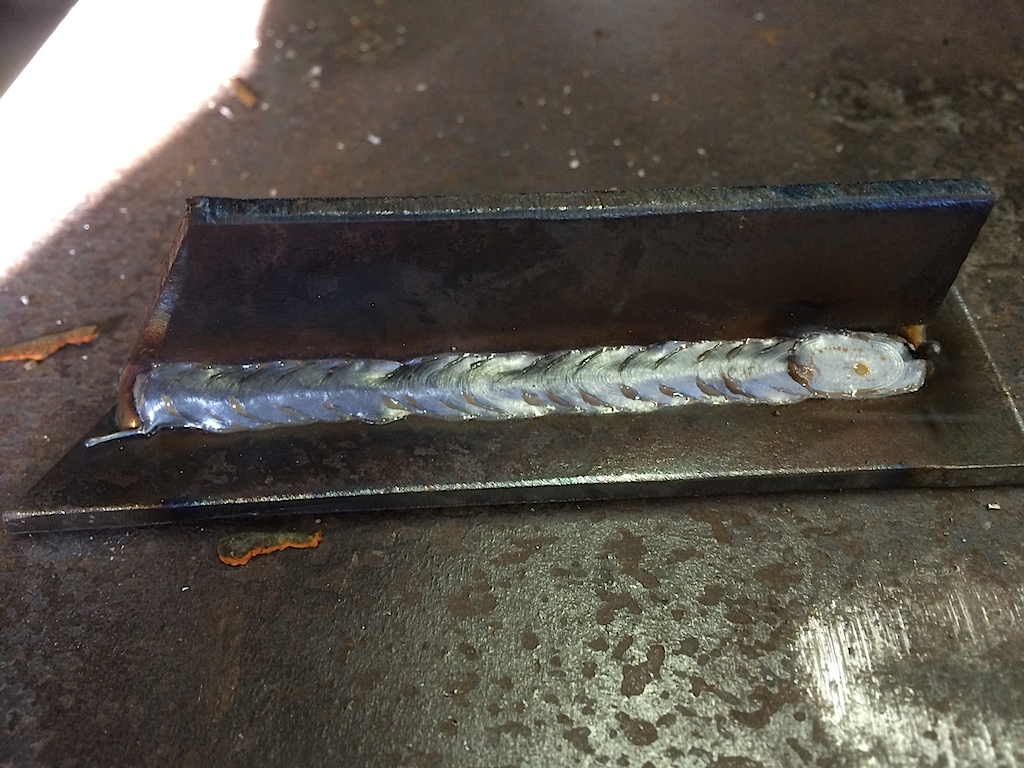

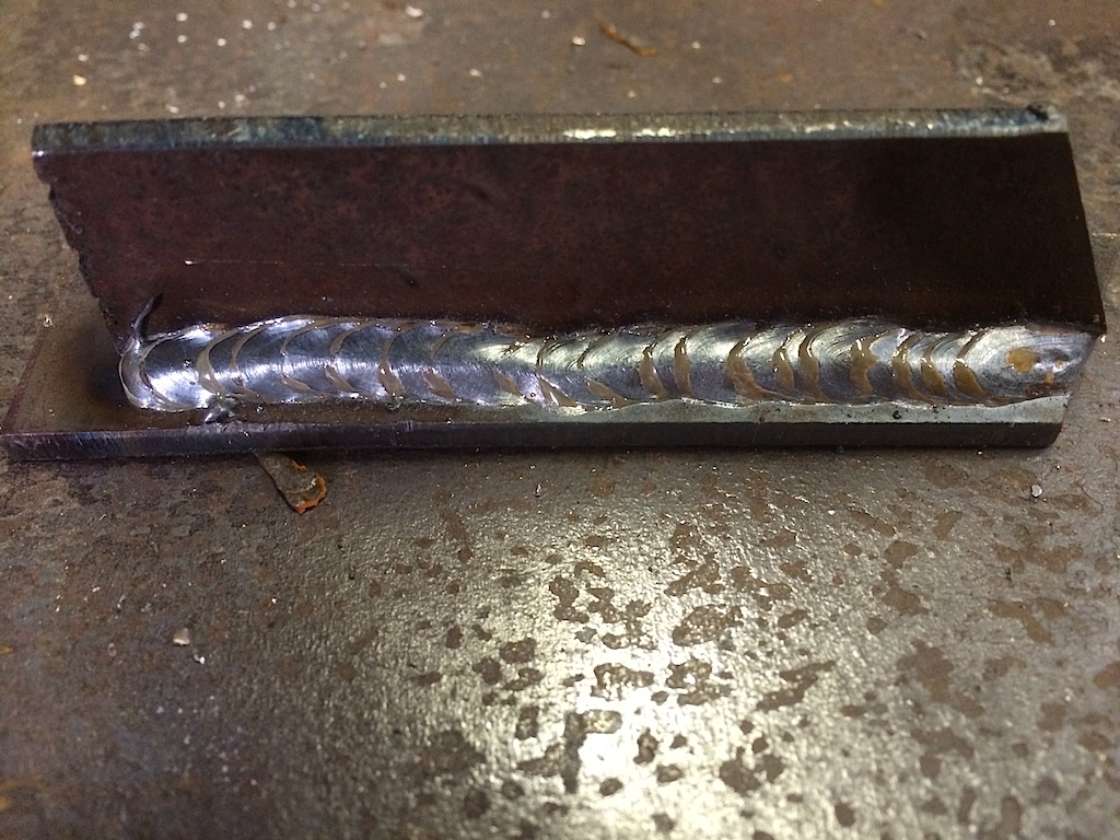

dragon I agree with Arc weld. The picture on the left looks like slow travel speed. Or like we talked about when you were here. Too much wire in the puddle. Even tho more wire means more amps, you have to have more volts to wet it out. I forget, are you right or left handed? If right handed try starting on your right side moving to the left, pushing the puddle.
I can tell you right now your 211 will weld circles around this little Lincoln of my brother-n-laws.
As you can see by all the over spray on it, he is a retired body & fender man who does a little work in his garage. He took this little Lincoln as partial payment for a job. I think he might have got stuck!:laughing:
Thanks again SA!!! Yeah that was left to right and I was pulling a little to see. I am right handed and totally forgot about going right to left. I guess I need to think about reading the puddle in Chinese! :laughing:

Pushing will have a little less penetration but give a flatter bead as well. The welds shown may have been very close to perfect had they been pushed instead of pulled. Still good looking welds. Decent was meant as a compliment but I should have stated they are very acceptable welds.
