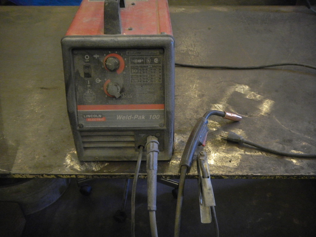

Look what I got!:D
Let the playing, testing, learning begin. :cool2:

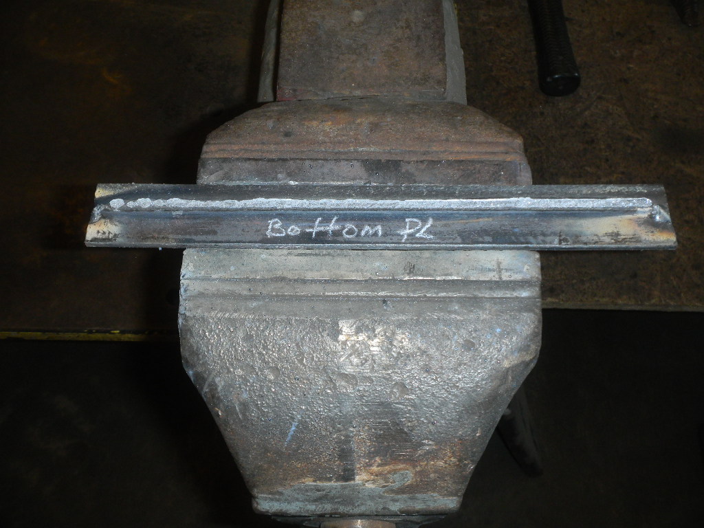

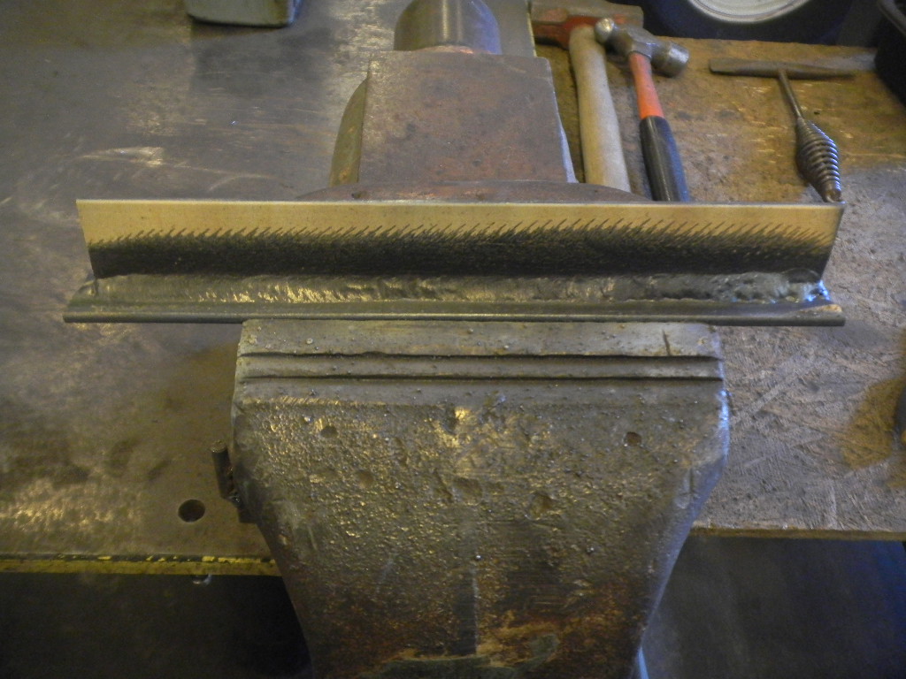

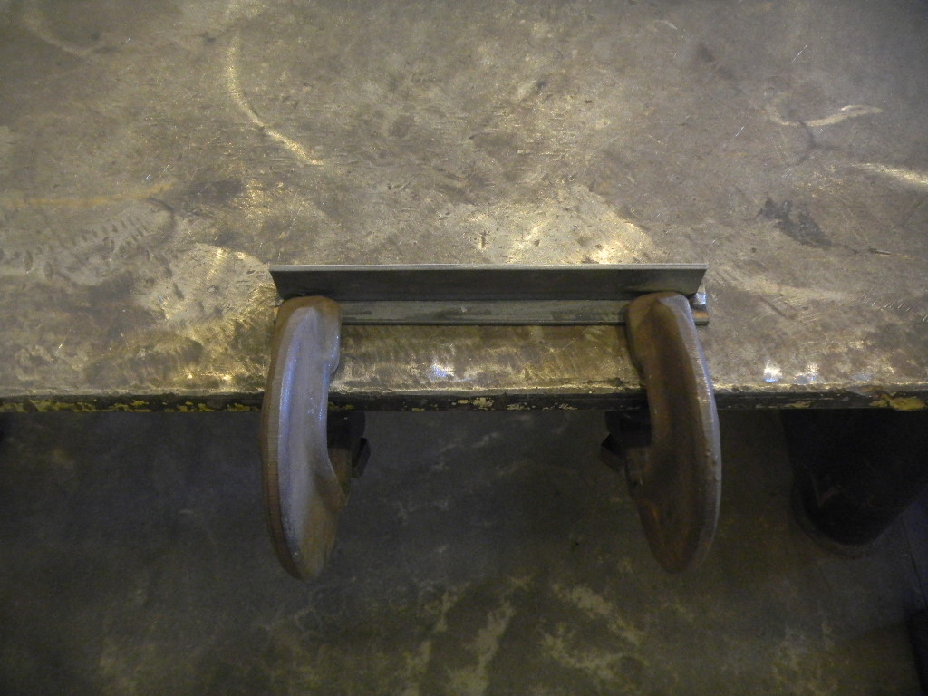

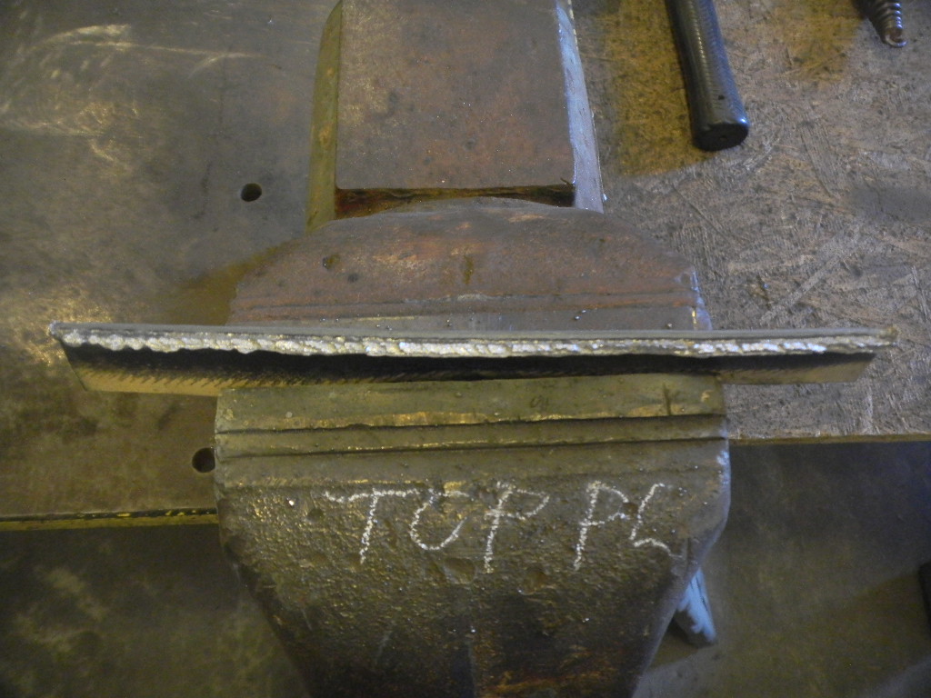

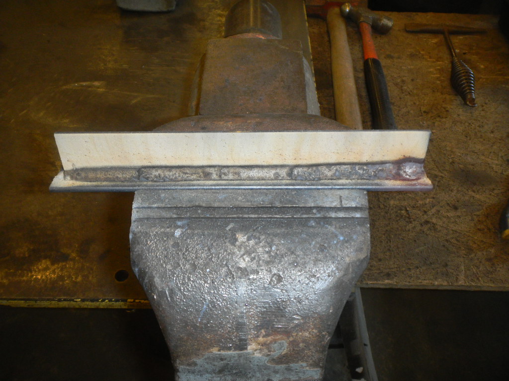

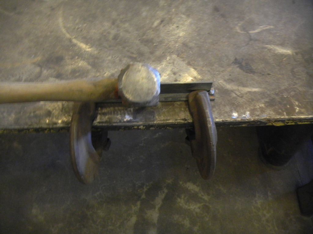

First test:
10-GA fillet weld break test. This is a flux core only machine, which is a good thing! You get a little more bang per amp, and volt with self shielded wire.
Had the voltage all the way up, and the wire speed about 1/2-way. .030" E71T-11
7-blows with a 4-pound hammer.

Interesting, is there a way to quantify this a bit more?
/ 120-Volt Mig welder. #9
I'm working on my video. Too hot here for the last couple weeks...and too many irons in the fire. Will finish it asap.
/ 120-Volt Mig welder. #11
Shield can you say a bit about what is in the pictures. Just a line on each would be useful. And, is 7x4 "standardized test whacks" good, bad, indifferent? Did the weld break loose, or bend. I can't quite see for sure. thx!
#12

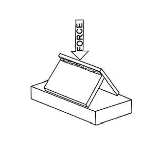

Actually I was surprised it took 7-blows. If you look close at the picture of the top plate. There is next to no penetration at all.
This is not a very scientific test. The fillet weld plate should be put in a press.
I found some 3/16-inch thick plate, I cut up some coupons to do a face and root bend test tomorrow.
Destructive Testing of Welds

Yes, interested in what 100amps can do on 3/16in. Please do report.
