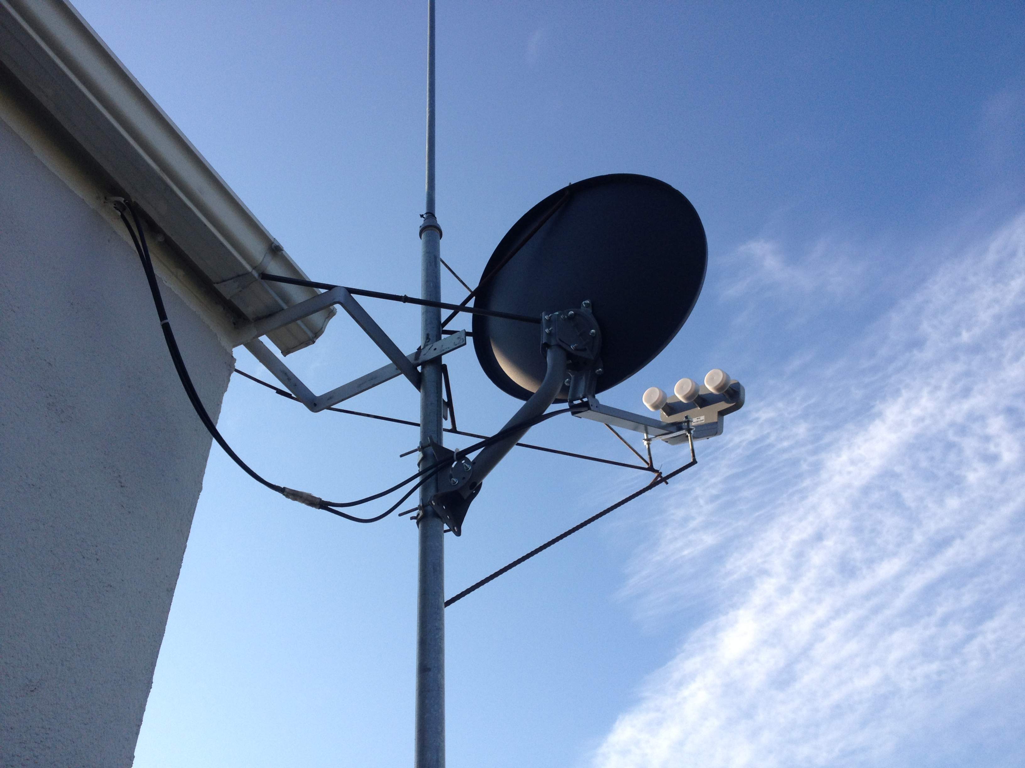

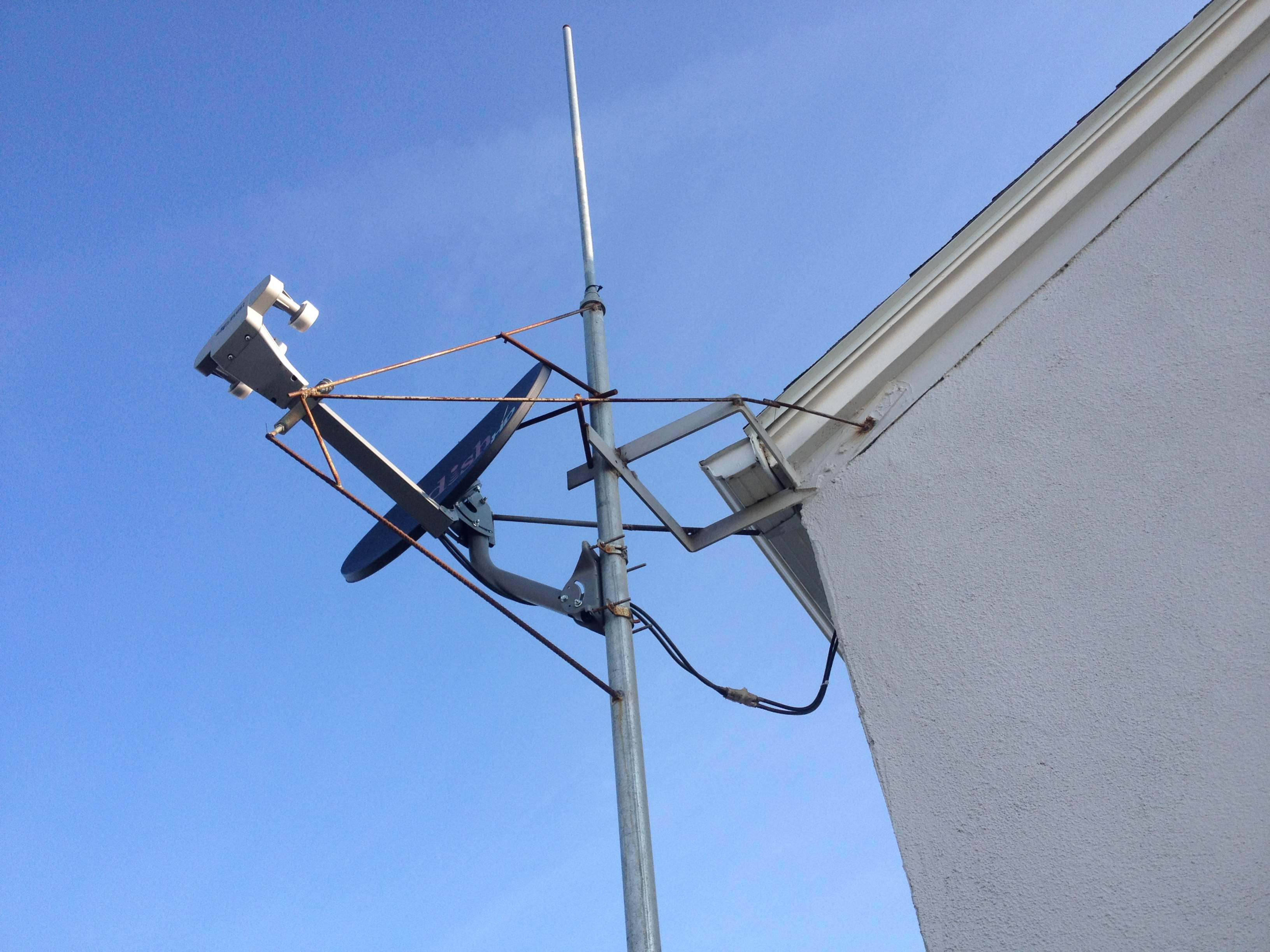

Here is a pic of one of the odd projects I have done with a 110v welder. So it's blowing about 40+ and snowing like crazy, below 0. For some reason my satellite is out but there is a football game on that I want to watch. I go outside and the dish is shaking in the wind. Then I have the brilliant idea of stabilizing it with some scraps of rebar I have laying around. As you can see I have a couple of attachment points. One being where a clamped 2 pieces of steel onto the dish and another where I welded a small bolt on a piece of rebar and used an existing hole in the actual dish. I had the 110v welder (Hobart 125 mig running .035 flux core) in the bucket of the tractor and I was on a ladder. In the end it worked and seems to keep the dish stable in the wind. But is it's ugly so I will probably fix it one of these days.
Now, that's being a dedicated football fan. I don't think an act of congress would have gotten me out of the warm house and up on a ladder in that kind of weather. :laughing:
It must have been a good weld to have held up in those conditions. :thumbsup:

I'm a college football junkie. Big deal in Oklahoma and Nebraska. I'm sure you understand living in Texas.
The welds are rough with no prep and some on galvanized pipe but they held. Yet another situations that does not require a perfect weld to be functional.
View attachment 386401View attachment 386403
I like it! Antennas are not pretty to begin with (maybe K0ua will disagree :laughing:) I wouldn't waste my time on an improvement, especially now that it is football season again.
