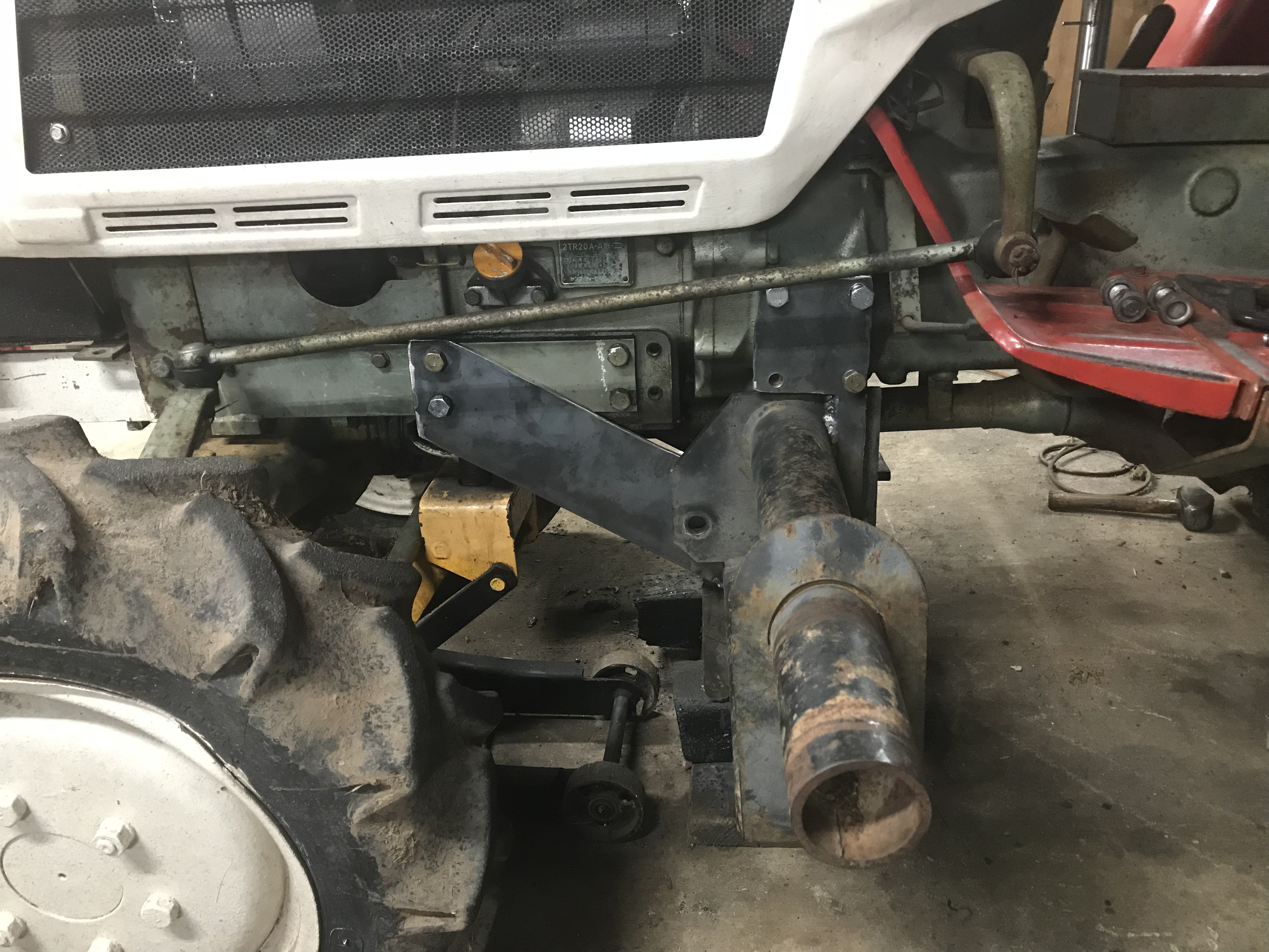

Mocked up the YFL1500 cross member tonight on some wooden blocks to see how I am going to attach it to my YM2000BD. This is that loader I drug off of a parted out 336D.
The ends of the cross member tubes stick out to about the width of the rear tires, the bottom of the loader feet clamp around those tubes about an inch inward on each side.
I am going to bring some cardboard home tomorrow so that I can make some templates to cut out some 3/8” plate to make side supports that go from the cross member up to the 2nd set of vertical bolts on the tractor engine/frame area.
I will also use some 1/4” plate to make 2 brackets to mount to the 4 bolts under the transmission, and possibly later decide to run two pieces of square tube back to each side of the draw bar for extra strength.

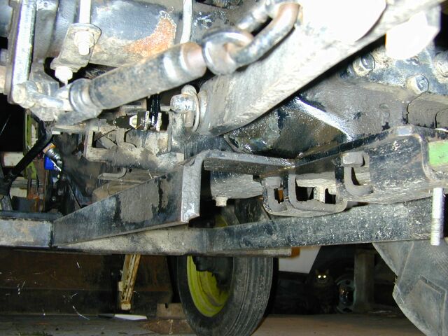

You need that structure back to the rear axle so you you don't split the tractor at the bellhousing.
I took this photo to show the old-guy step I added. (with oversize rear tires it is a narrow, high climb to get aboard). The photo also shows one of the members to the rear that alleviate the split-the-tractor stress at the bellhousing. The only stress there is simple downward weight.

And just like that, the cross member for a 336D now fits a YM2000BD!
Even though I had some 3/8 plate available, I had to resort to using 1/4” due to available tooling.
I am going to the metal yard in the AM to source some metal to make some tie ins from the cross member back to the rear draw bar assembly.

That looks great!
Interesting - you have bolt holes to support the loader in the sides of the bellhousing, just ahead of the clutch cross-rod. My YM240 doesn't have those holes. (photo). The similar downforce bears only on two bolts threaded upward into the bottom of the transmission. I like yours better.

That looks great!
Good work!
I was contemplating also making a mounting to those 4 holes in the bottom of the transmission, but I am pretty confident that with this way I won’t need to, also going to add in the supports back to the draw bar, which should completely tie it in.

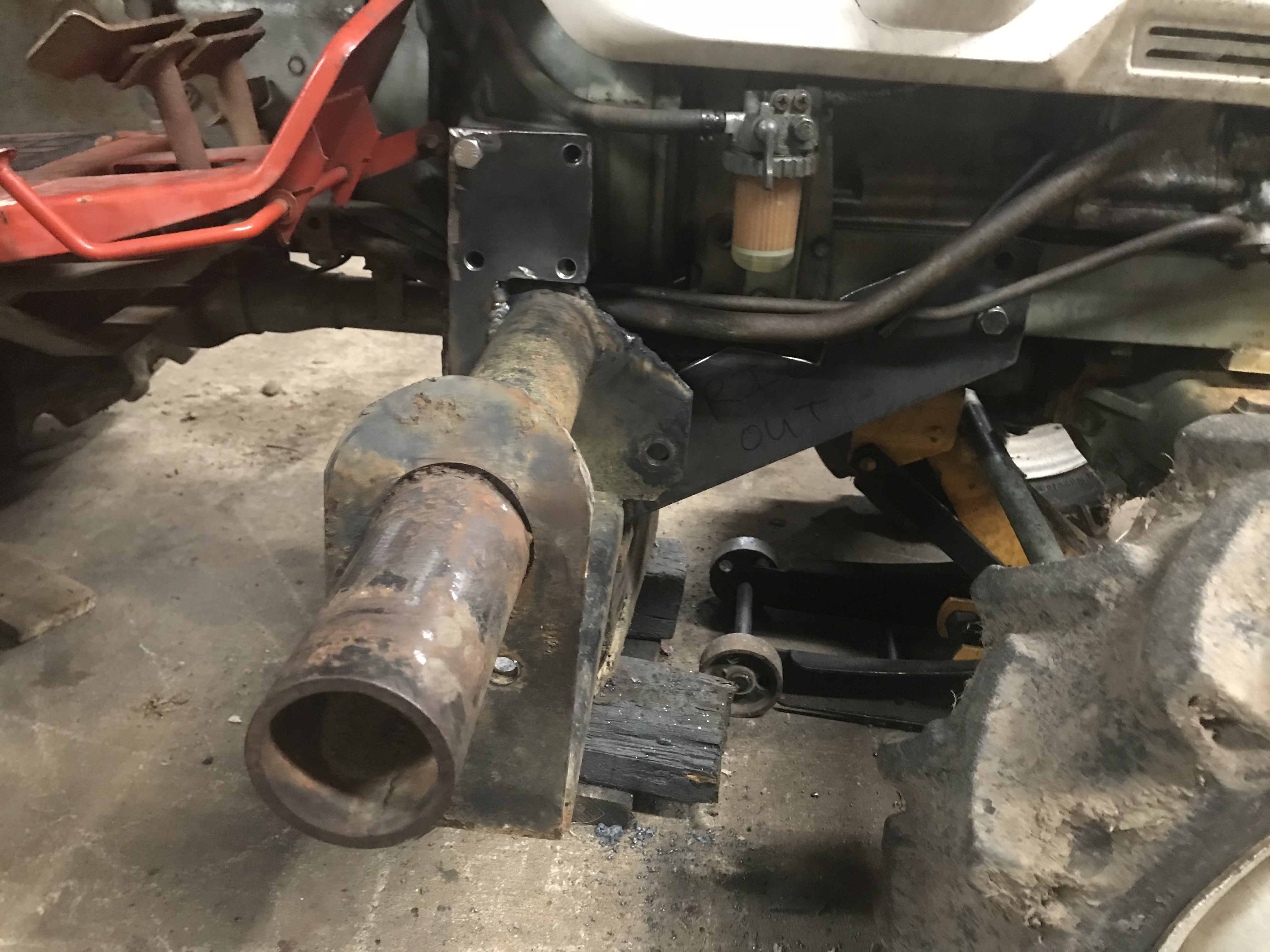

Alright, well here she is!
Once I get it final bolted in place I’m going to make a cross piece to tie in the straps on the rear.

My 3110 doesn't have braces that attach to the rear like this. I only have a mounting bracket about mid ways of the transmission.
Get all that and then, plumb the HYD system and you should be good to go on the loader !
I hope the loader valve and cylinders are in working order as well

The loader valve is pretty much a goner, I ordered the same one Hoye sells from Surplus center for half the price. Cylinders look like they will be OK after new hoses and some grease on the joints.
