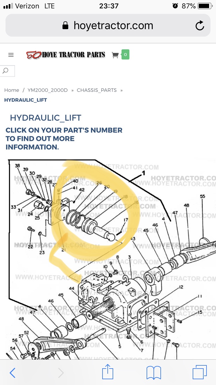

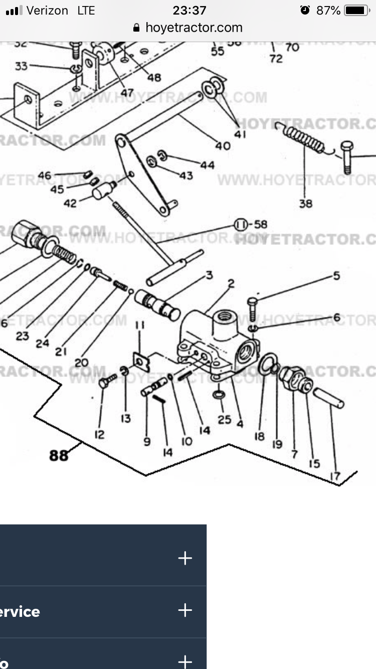

Clemson, you say the “top of the tranmission” I assume you’re referring to the 3 point control valve that the banjo bolt for the HP line goes to? (See first image). If so, I’ve already had this off and apart.
After the engine rebuild, it was stuck solid internally and 3 point was just up. The piston inside of there was stuck. I was able to get it freed up, but there is still (#24 in pic) retained inside the piston. It does appear that it IS supposed to stay in there according to the parts diagram.
I was referring to removing the piston that is retained behind the lock out valve, and inspecting all of that. (See 2nd image, circled in yellow).

UNTIL, I hooked the box blade back up on the 3 point to test some things out. Upon raising it fully, obviously with the handle all the way back, the 3 point comes all the way up, and then strains the system/hits relief valve or whatever. Even with the speed control lever all the way closed under the seat, the box blade will still fall on its own (slowly though). So the speed control lever seems to work, but there is basically no fine control of the the 3 point.
I need to figure out if I need to replace the 3 point control block on top of the trans (where the lever pushes against) or the actual piston that is behind the lock out turn valve setup inside the front.
