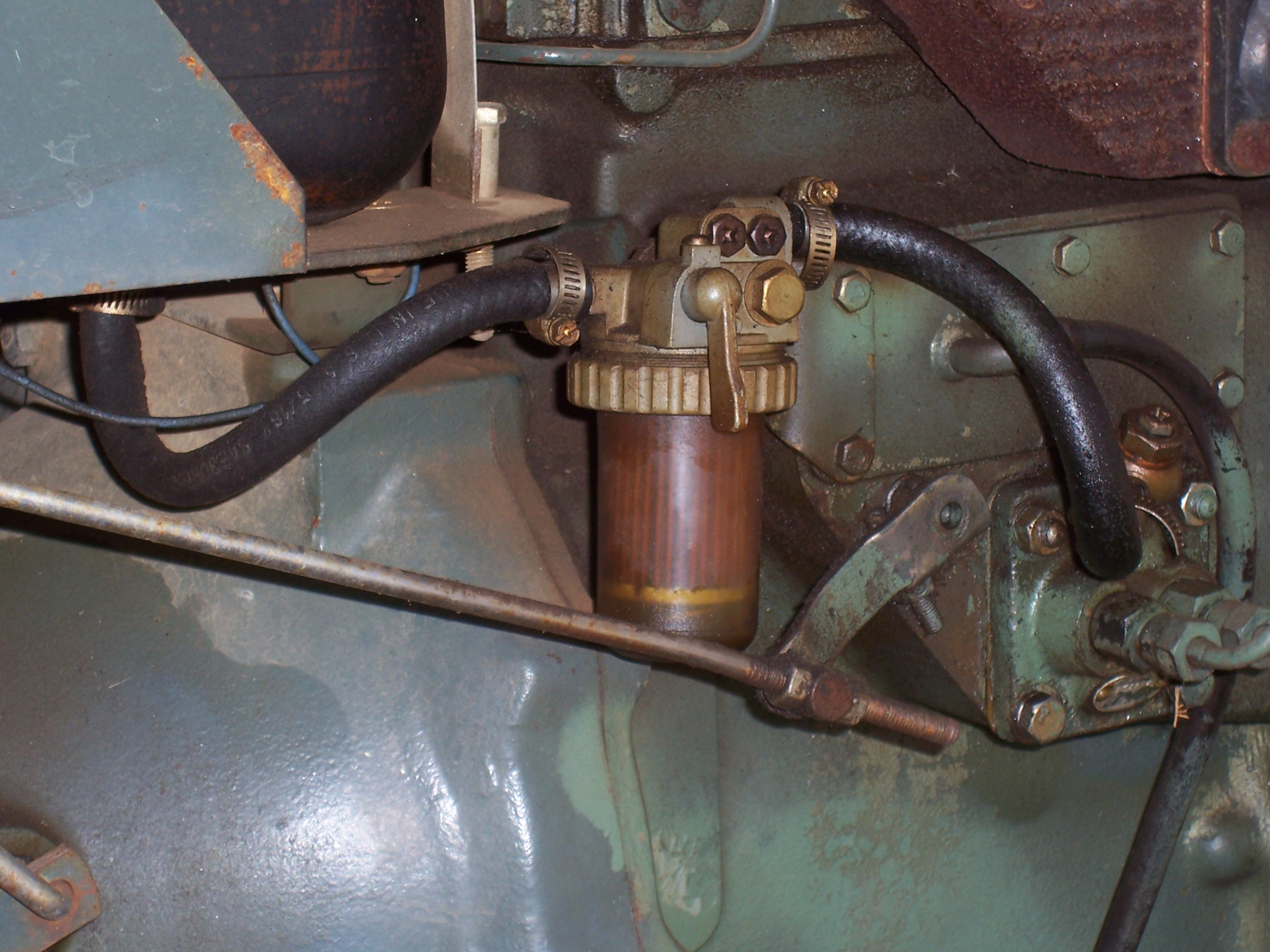

For you to loose all fuel pressure sounds like a broken clogged fuel line before the Inj. Pump. May want to run a direct new Fuel line straight from the Tank to the pump. Your going to have to bleed the pump. If it runs you can almost rule out the Injection pump itself. and go back through it.

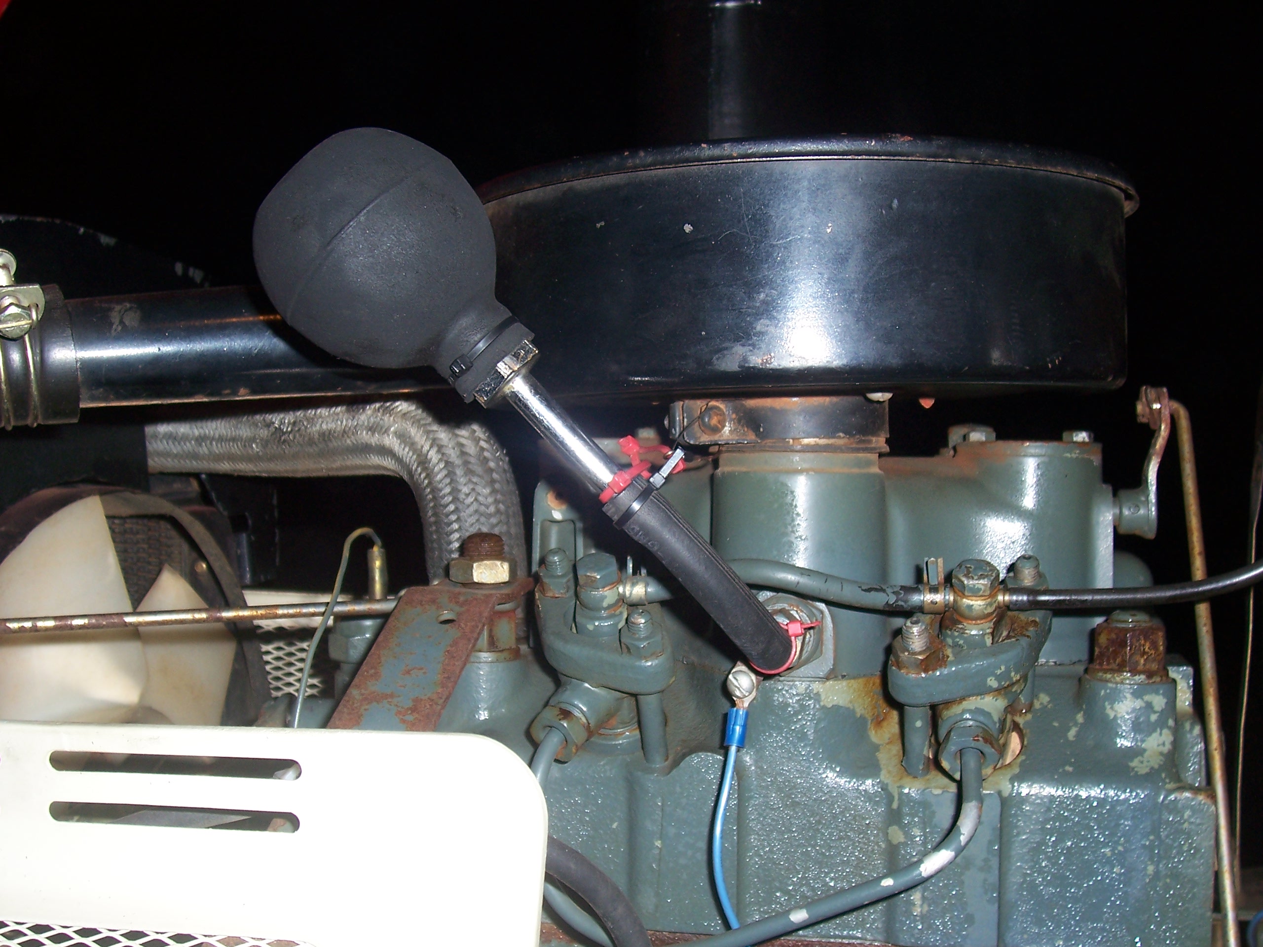

This is the Thermal start and the wire to the back of the Ing switch. Turn the Ign. key to Aux. to get power to the Thermal. 10 secouds should be enough to get hot! Rarely ever do I have the need to use it and have had to on occasion. Org. fuel Sys. And how I use the Thermal if I would need to. Never replaced the plastic cup reservoir. After I start it a squirt the remaining fuel back in
to the Tank.;)

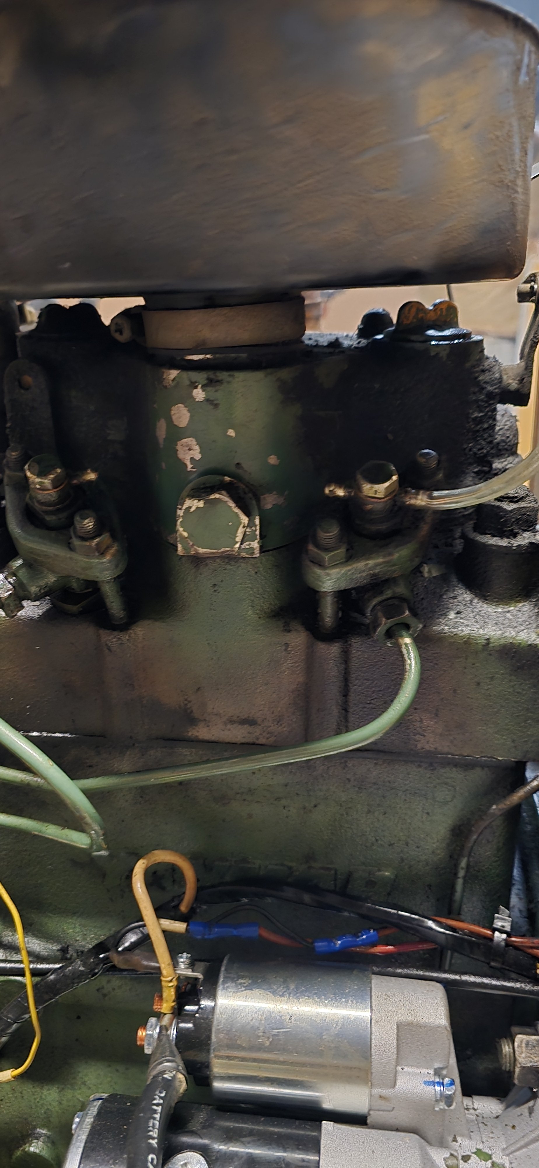

For those of you who have not seen my earlier posts I bought an old used Yanmar. It was supposedly just run out of fuel and the guy couldn't get it started again. Well, nothing is ever that simple. I found out the guy probably burned up the starter trying to start it, so I had to go on a small adventure to find one. Finally, find one and it works great. I turned it over and got it started after priming but then it slowly died after about 5 seconds. i even lost all sign of smoke out of the stack. so I crack the lines by the injectors and find I have no fuel pressure. I tried working the governor arm and taking out the pump to inspect it but idk what good pump and bad pump look like from the outside lol. anyways, I'm assuming its a bad fuel pump that finally gave way. Please, tell me im wrong because this is getting expensive fast. If it helps I could take pics I just forget in the moment. Thankyou guys for all the help you've been giving me.
to the Tank.;)

ok so now im sure. my motor doesnt have the thermostart. its got a big green plug where its supposed to be

So it's good to know I'm not crazy. My ym1600 doesn't have thermostart. I guess, I'm just supposed to rely on the decomp lever. I fixed the fuel issue. I didn't bleed the pump inlet well enough. Now I'm just throwing white smoke and sorta popping off. A couple times it almost idled but I didn't want to burn up the starter and as soon as the starter shuts off the motor dies. It just seems like a cold blooded deisel now. Which, brings me to my next question. why the heck don't I have glow plugs or thermostart?

... why the heck don't I have glow plugs or thermostart?
Apparently that Yanmar was first sold in a location with a mild climate so it didn't need the cold-weather option.
If you have a heat gun - or steal your wife's hair dryer - prop it in place to thoroughly warm the intake manifold. Or prop it to push warm air into the air filter's inlet. This will duplicate the Thermostart's function.
White exhaust is unburned fuel vapor.
Don't use ether on these small displacement diesels!!!!! It can shatter the rings.

Not sure you don't have a thermostart element. Notice the blue wire going up to the intake. Would appear to me that is a themostart element. They lock like this. Help Me Understand Yanmar Thermostarts Maybe you just need the reservoir. Thermostart Tank
