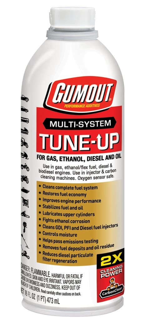

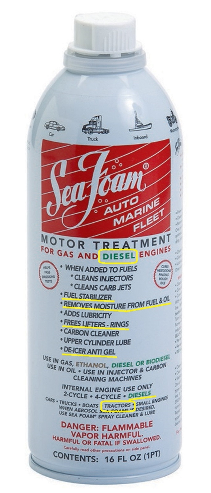

I do the Seafoam additive before and during winter, and the Gumout Multi-System Tune Up from Spring thru Summer. This gives the best results. I tried the PowerServe with so-so results and gave up on that brand.
